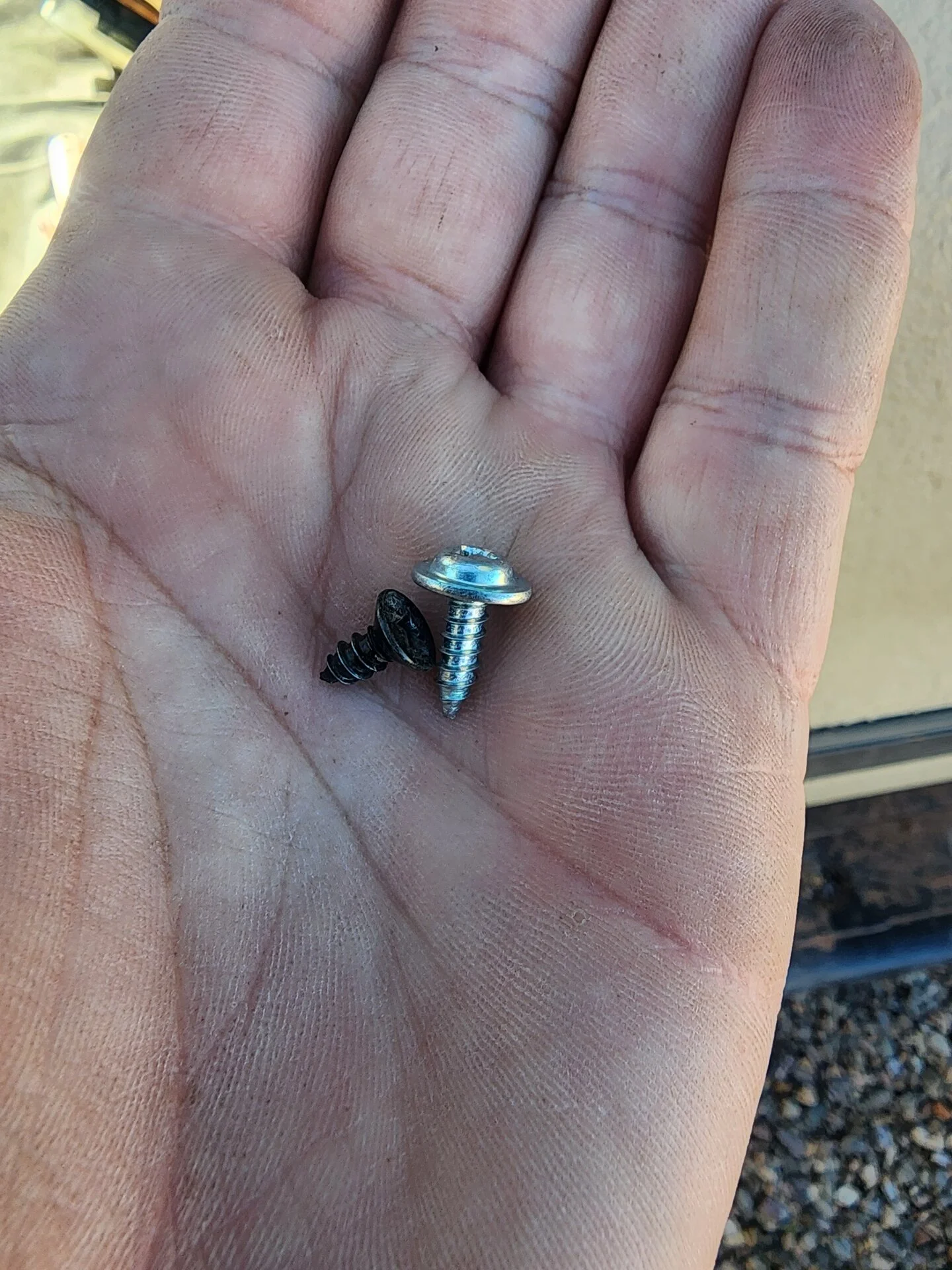

I pulled the rear door panel off this morning to inspect the locking mechanism to order parts. Of course, I dropped the little door handle screw, part # 93520-54010,
in the gravel. I hate working in gravel. I spent 10 minutes searching for it with a big magnet, but it is gone. Any idea on the threads pitch or availability on this little guy? I am happy to replace it with something from the hardware store.

I got ambitious today and pulled a screw from another door. The damn thing is like a wood screw or something. They are available but I can't stand the thought of paying $14.00 shipping for a $1.00 screw.

take one of the screws to home depot or a hardware store and just match it up, theres nothing special to the handle screws
I tried, can't find a screw that short that isn't too skinny. But I also live in the middle of nowhere and only have 1 little hardware store to look for screws.
get a longer one and cut it down, you probably need a #8 size. or you could fill the screw hole with jb weld or something like that and drill a new hole for a smaller screw

It should be a Ø4-mm, countersunk head, self tapping sheetmetal screw, 10-mm long. I keep a box of miscellaneous screws from junkyard trips, but this one isn't in my stash, or I'd send you one.
If there's a yard nearby, find a Toyota and rob it. It's a common body screw.

Yeah, I found self tapper sheet metal screws at the local hardware store they were just too skinny. I will figure something out.

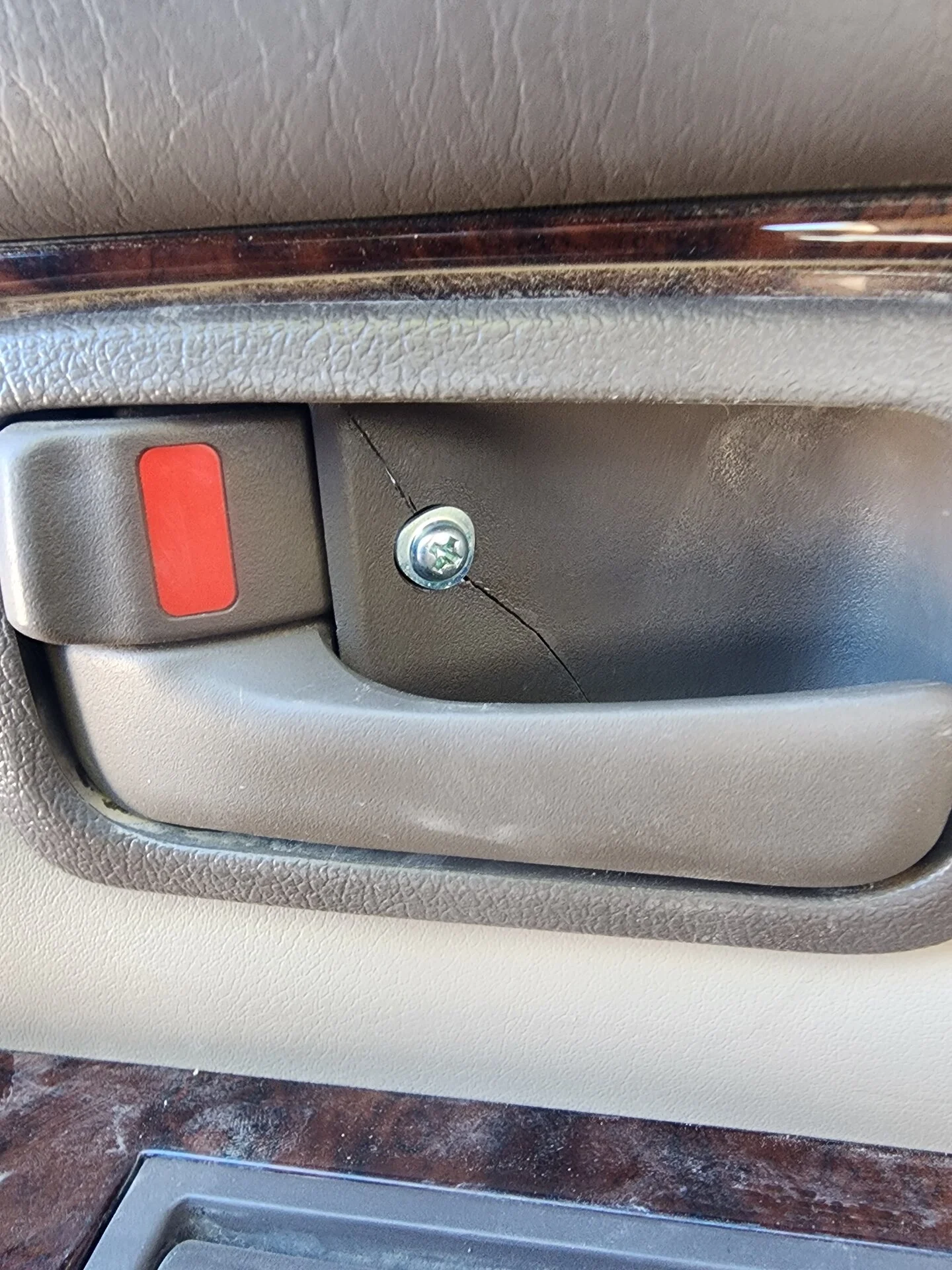

Found a screw that will work but it cracked my trim 😞
I thought those were NLA. I have to order 3 pairs...
