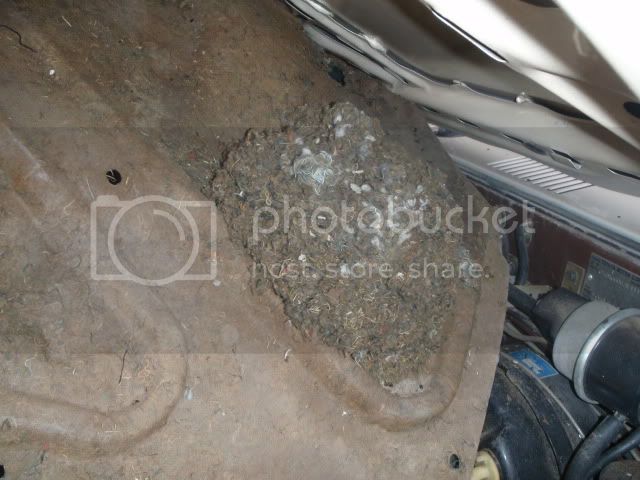

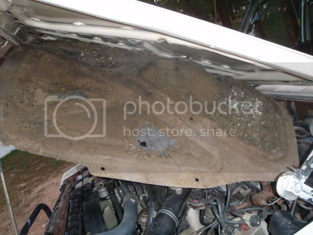

Because the truck had been sitting outside for so many years, it developed a nasty little problem from the local wildlife- Deer mice. they made nests in the hood liner, on top of the manifold, near the valve cover, in the air cleaner, and under the seats of the truck.
pics of the mess:
when i pulled the hood liner down, this is what i found:

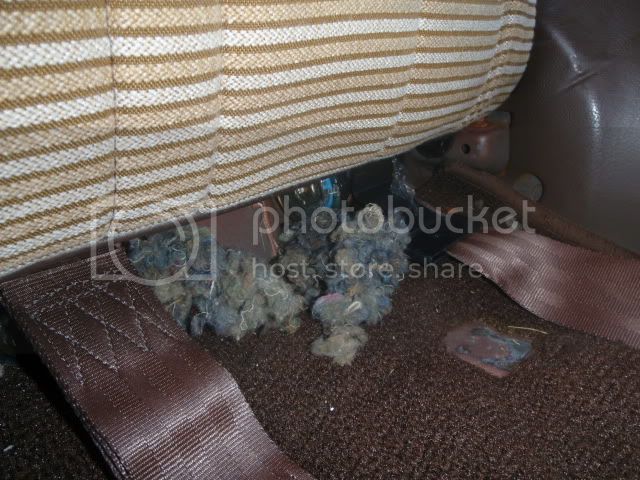

under the back seat:

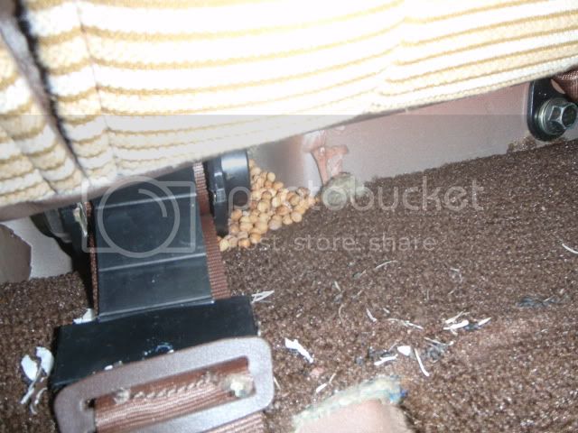

stashes of seeds and nuts were found all throughout the truck:
SO, we had to pull out the heavy artillery and do some mousing
I ended up catching about 4 mice that had made the trip home with me, from Aspen to Colorado Springs, and went about cleaning up the nests and seeds from the truck- quite a nasty job, but i got it done.

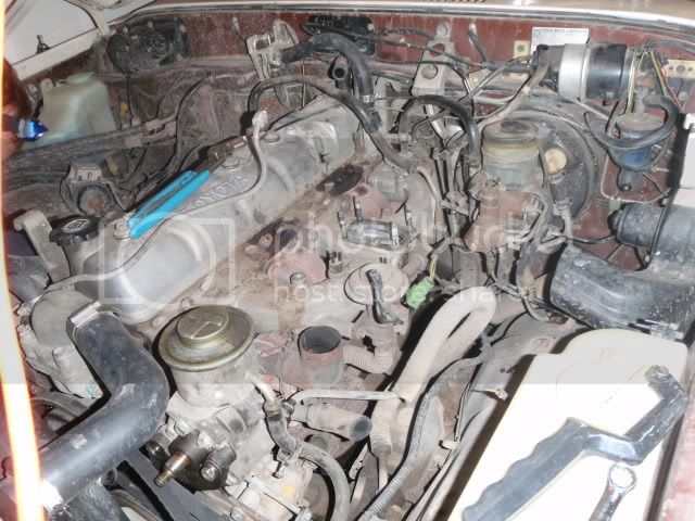

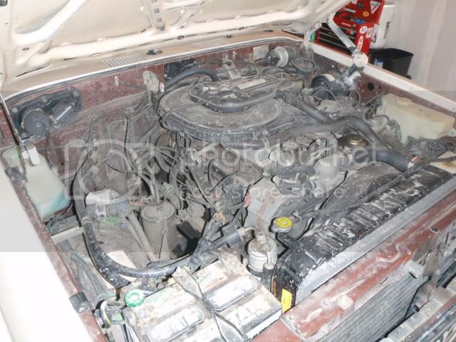

Here she was, quite dirty as you can see:

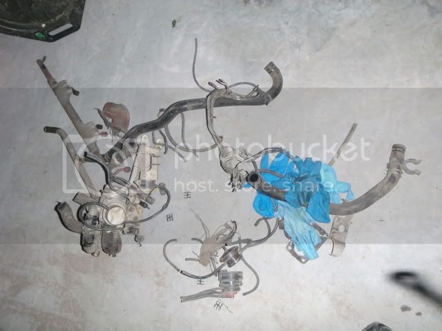

Pulled the Air cleaner and Carb, air rail, and smog assemblies:

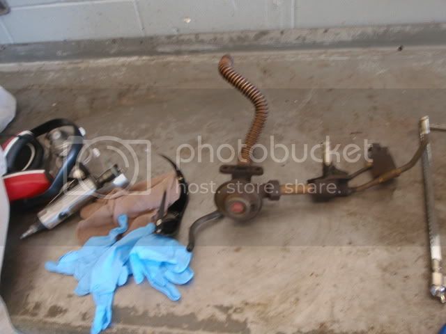

Here's a pic of some of the smog equipment that came out of the rig:

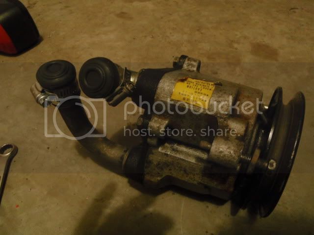

I started by disassembling the Smog pump, and de-viening it
pulled the viens:
after cleaning up the pump, and lubing the bearings with some white lithium, i sealed it all up
after the smog pump was squared away

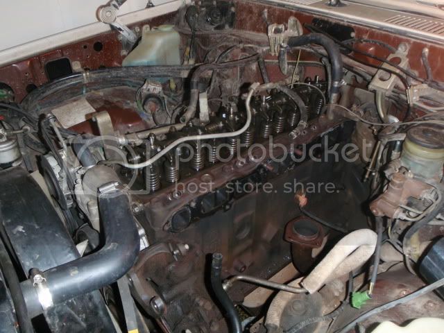

I took the engine down to the valves, and pulled the Exhaust manifold in order to square away the EGR components and check valve clearance. The head was in good condition and the valves were in surprisingly tight clearance due to this Rig's relatively low use and low miles.

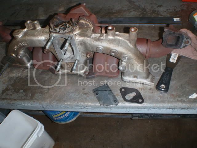

a pic of the intake- exhaust manifold assembly
I squared away the EGR assembly by following Jim C's recommendation so that the PCV system was left in tact to clear the crank case of harmful moisture and acidity.

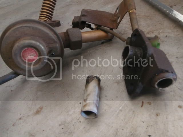

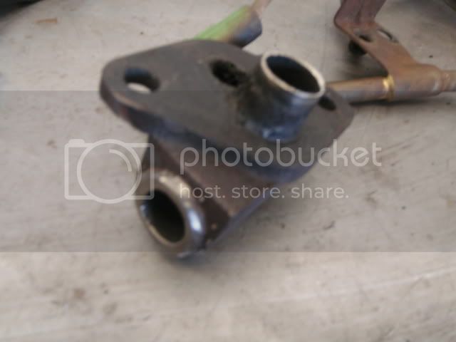

Pic of the egr assembly:
Cut the egr pipes so that about 1/2 was left on the manifold side to line up the gaskets, and cut the valve side flush so that it could be plugged and welded up
I sourced a block off plate for the J-tube side of the exhaust mani from Man-A-Fre, as well as gaskets for the assembly from SOR.

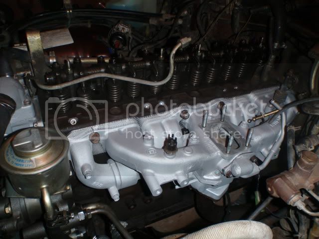

After the EGR system was squared away, I restored the Manifold assembly with some Hi-temp paint. It came out great.
Restored Manifold mounted up with new gasket against the head:

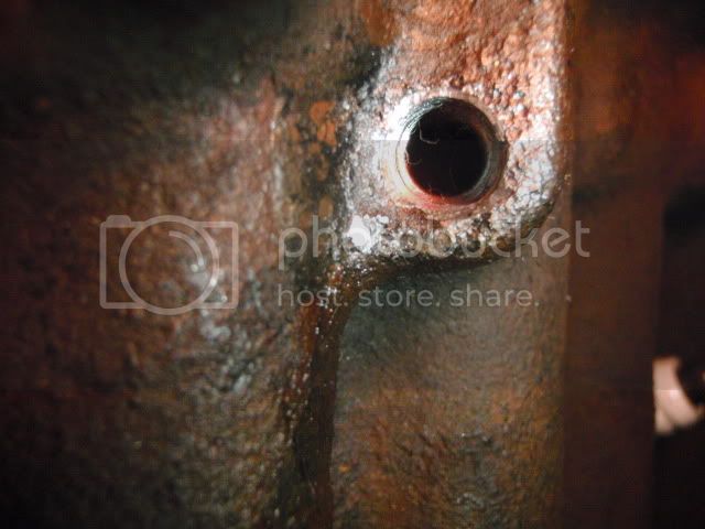

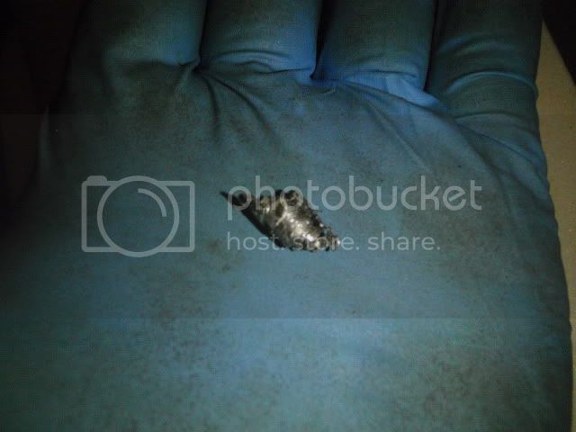

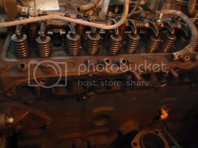

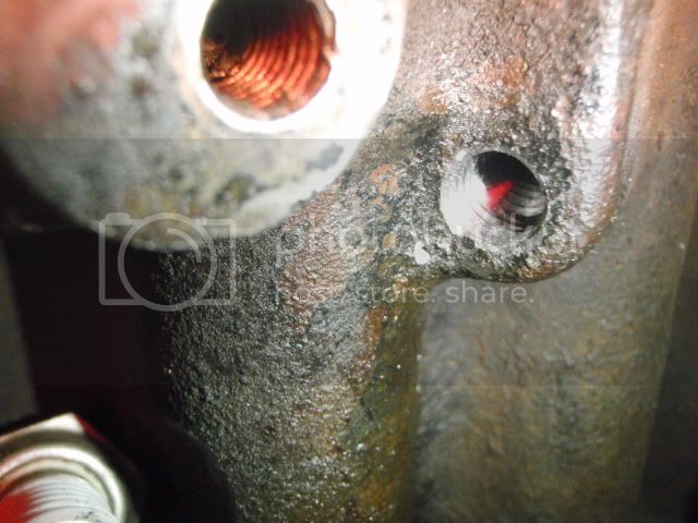

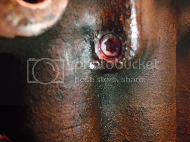

Next up was to square away the galley plug in the head. I figured i should take care of the plug while i had the truck down for the build, and then it would be good to go for a million miles of care free driving.
As many of you know the galley plug can work its way out of the head, allowing the engine to purge all of its oil very rapidly leading to catastrophic engine failure. The way to mitigate this potential problem is by removing the galley plug, tapping the hole with threads using a tap set, and then plugging it with a set screw.
For this procedure, i used Eporter's galley plug fix thread located here:
https://forum.ih8mud.com/60-series-wagons/351460-my-first-galley-plug-fix.html

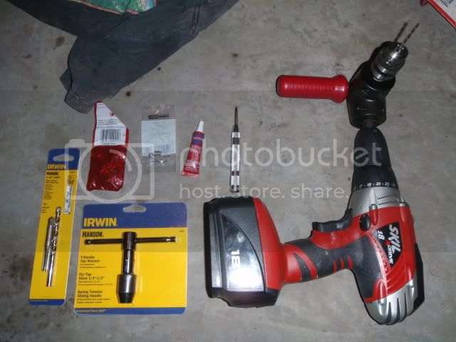

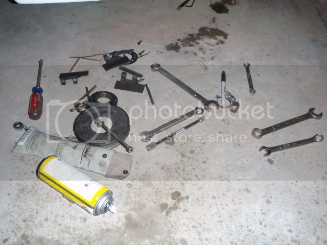

SO, i gathered up all the necessary tools for the fix and tackled the work:
everything needed to fix the galley plug

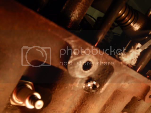

Here you can see the plug as it was in the head when i started:
as you can see, it was not leaking or weeping oil, in fact it was in very good condition, but for peace of mind and prevention of an engine failure i went through with the procedure.
started by using a center punch to punch through the plug, and by using the 90* drill attachment and a 1/8" drill bit to drill through the plug.
eventually with enough drilling, I used a screw which i twisted into the plug and i was able to pull it out.
The plug was actually quite difficult to remove from the head on my truck, which leads me to believe it would have probably been fine for another 100,000 miles, but ya never know with these things, so i was glad to get it out.

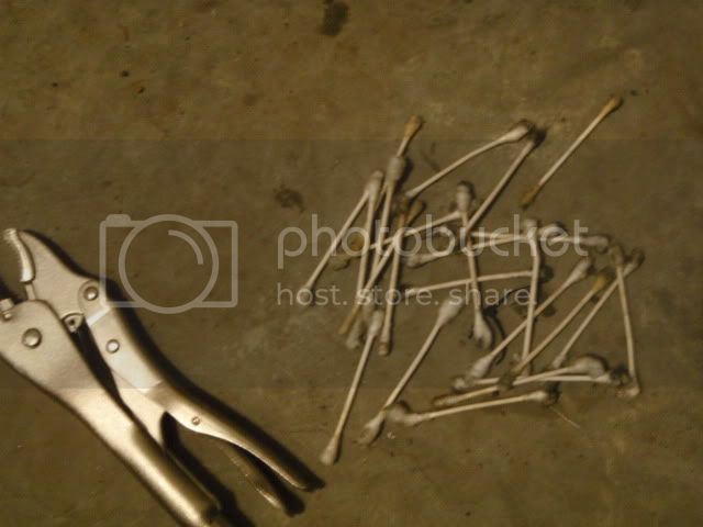

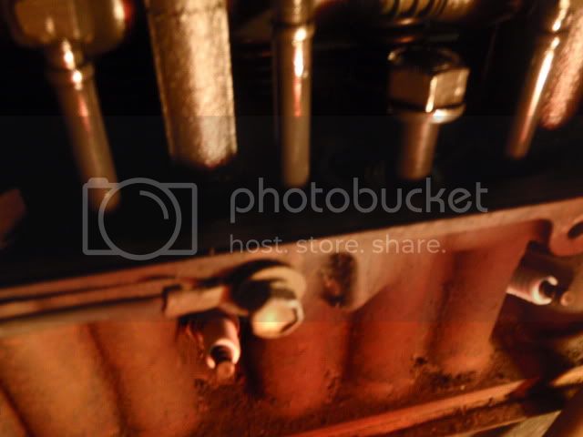

Heres where the nerve racking part started.. when you are threading a hole in your Engine's head using a tap by hand, you gotta be pretty careful to do things by the book and not mess it up. if you mess this up, you're pulling the head off the block and sending it to a machine shop to fix your **** up. :flipoff2:
Take your time, use plenty of grease in the flutes, and cutting oil in the hole. when the tap starts to bind, back it out and clean the flutes on the tap, and re-grease. work your way in a 1/4 turn at a time. Each time you pull the tap out, clean the hole with q-tips and brake cleaner to clean the threads out. GO SLOW and dont mess this one up.
Pics of the galley plug hole beginning to be tapped
Use plenty of q-tips to clean the threads as you go so you dont pull an :whoops:

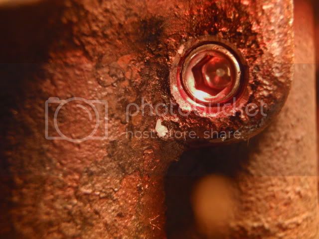

Look at those beautiful threads:
(i know that sounds ridiculous but when you are tapping something as crucial as the head on your Motor, it's a little nerve racking, but it is very satisfying when you complete the job and its a job well done.
I tapped the threads almost - but not totally through the galley hole, so that the set screw that is used to plug the head will bind into the metal to form a tight seal. I used 2 set screws: the 1st binding into the head, and the 2nd binding into the 1st, to form a tight secure seal. I also used Red Loctite on the screws to make the fix permanent
Cleaned out the threads (for the thousandth time) and put the screws in:

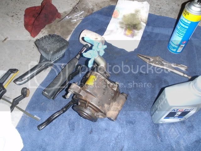

With the Galley plug fixed, EGR system squared away, Manifold restored, Smog pump gutted, i moved onto cleaning up the engine and fixing a few little things here while i waited for the Carb and distributor to come back from TLC performance.

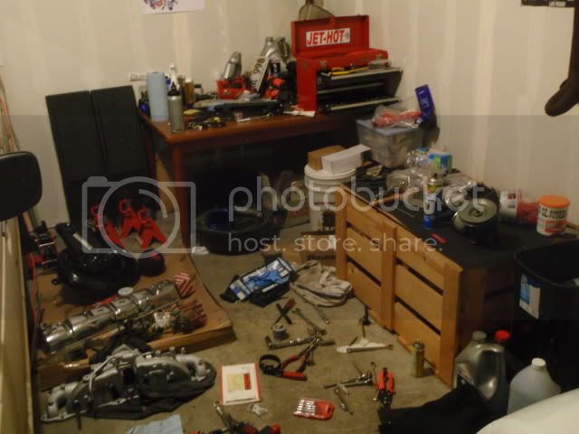

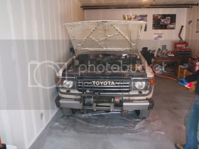

Pic of the Master's workshop AKA my garage
(there's a method to the madness)

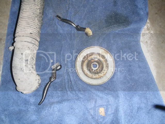

Cleaned up the powersteering pump, and pulley:

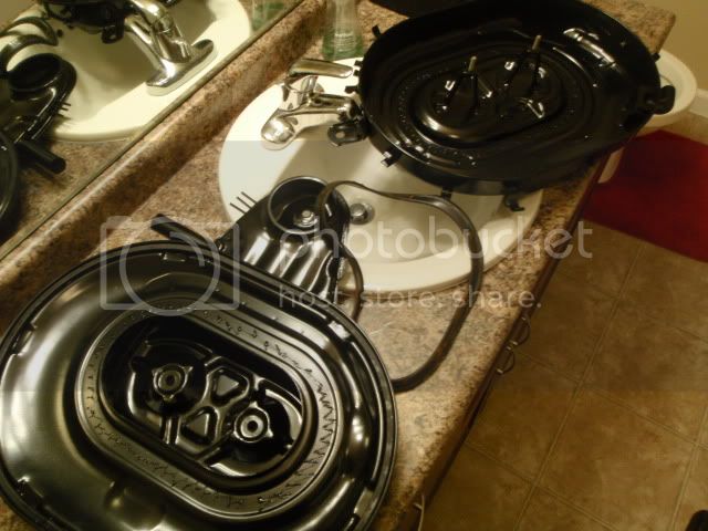

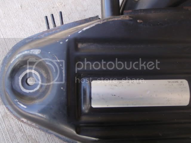

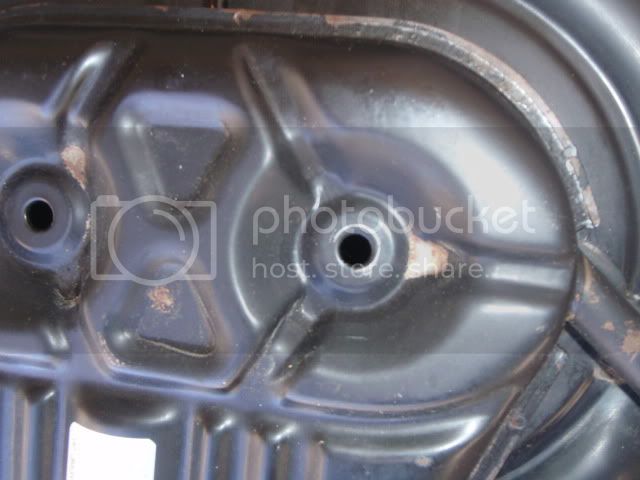

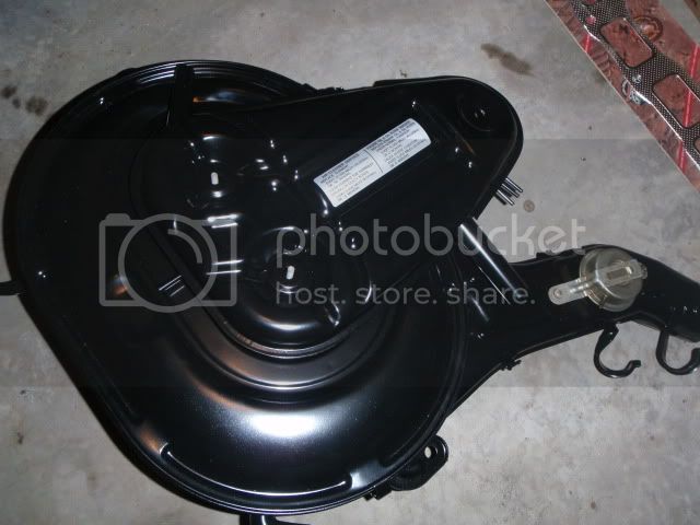

Next was the air cleaner assembly. The Air cleaner was pitted, rusty in spots and looking pretty bad, so I had it sand blasted, Powder Coated and sourced a new air cleaner decal from Specter Off Road
Before:
After:
I think it came out really good.

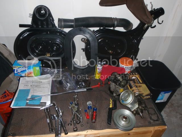

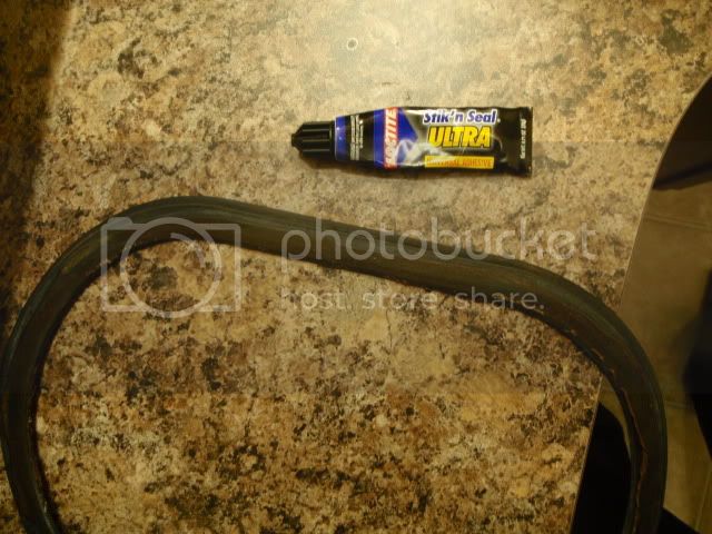

Also, I replaced all the seals on the Air cleaner housing. I used Loctite Stick n' Seal all weather and heat proof adhesive to glue the new seals onto the air cleaner housing
some of the cleaned up parts awaiting assembly

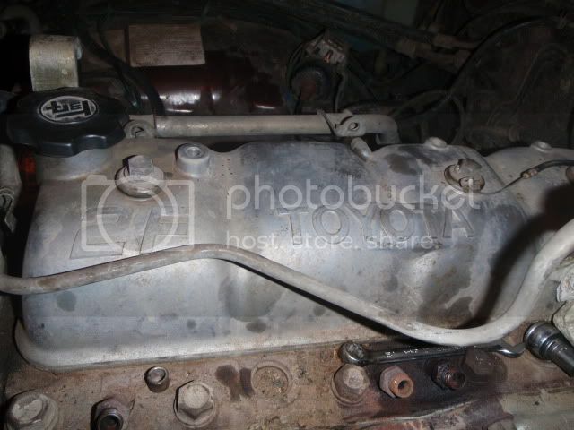

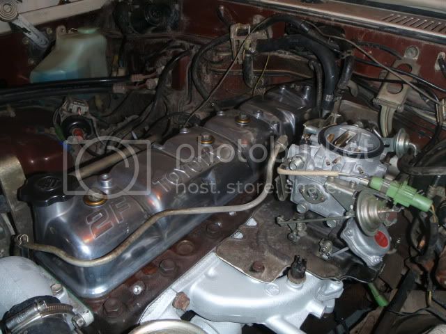

The valve cover was looking pretty filthy as well, so i went about restoring it with a buffing wheel, metal polish, and plenty of elbow grease. I also replaced all the top bolt seals and the gasket on the cover.
Before:
After:

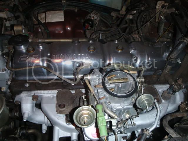

as you can see in the pics, the Carb is also installed, took about 12 weeks to get it back from Jim C. He's a busy guy, but its worth the wait.
Replaced all the carb gaskets on the plenum, and the top ring seal that mates to the air cleaner assembly.

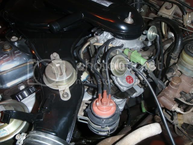

Here’s a pic with the air cleaner on and the HAC (high altitude compensation valve) installed on the aircleaner.

I had a question for you about the HAC's vac line that routes to the 2* advance on the dizzy:
does that line need a check valve or splice into the manifold or anything?
upon review of Elliot B's vac line routing pics it appeared that he had it Tee'd into the manifold for additional vacuum. when i tried that, it applied so much constant vac on the advancer it changed the timing when at idle.
i changed it so there are no check valves or T's in the line. it now routes straight from the HAC to the dizzy. is that correct?
No, that won't do anything. Route it just like the schematic on p.3-31 in emissions FSM.
It should change the idle timing above 4000'.
