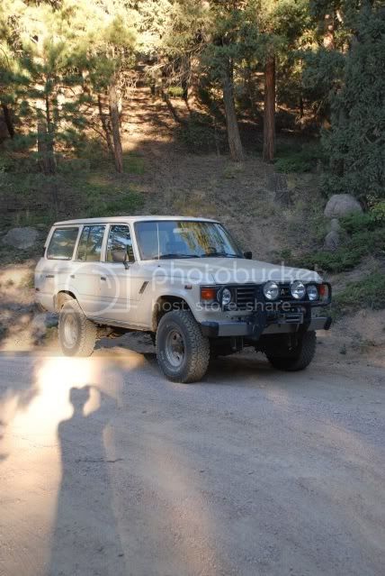

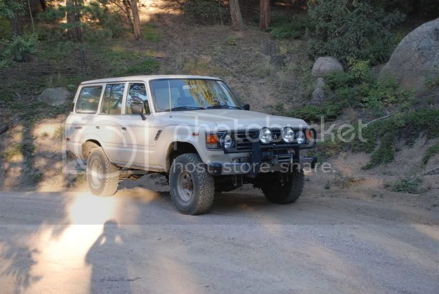

Some updated pics of my Rig:

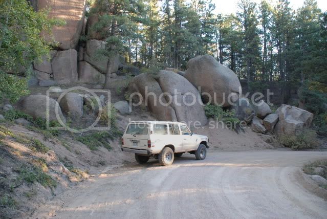

my last caming trip

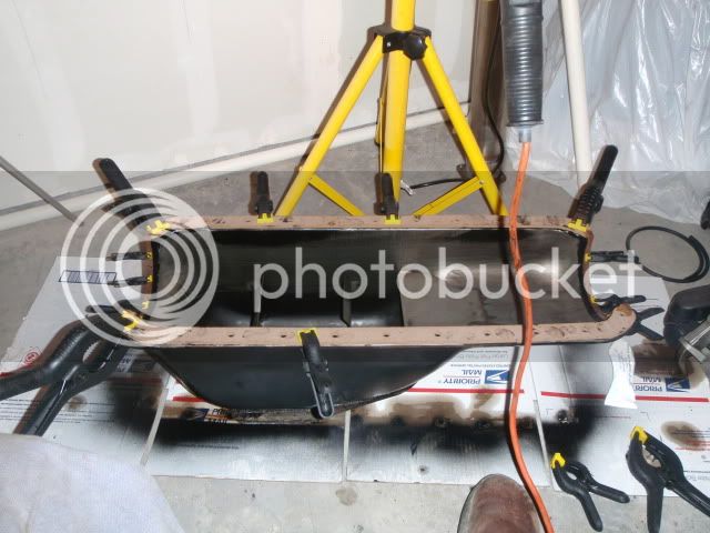

New Oil pan gasket:
^^ RTV'ing the new cork gasket on, used a multi pack of clamps from Lowes to hold the gasket in place, let it dry overnight, then put the pan up.

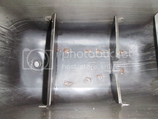

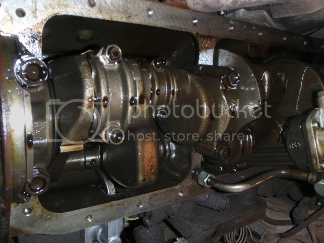

Inside the pan, there were some globs of original RTV, dunno why or if they were there to seal something, but i re coated each spot with fresh RTV
old RTV:

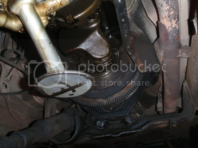

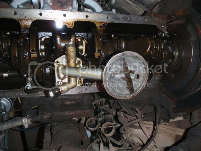

shot of the crank and Oil pick up tube

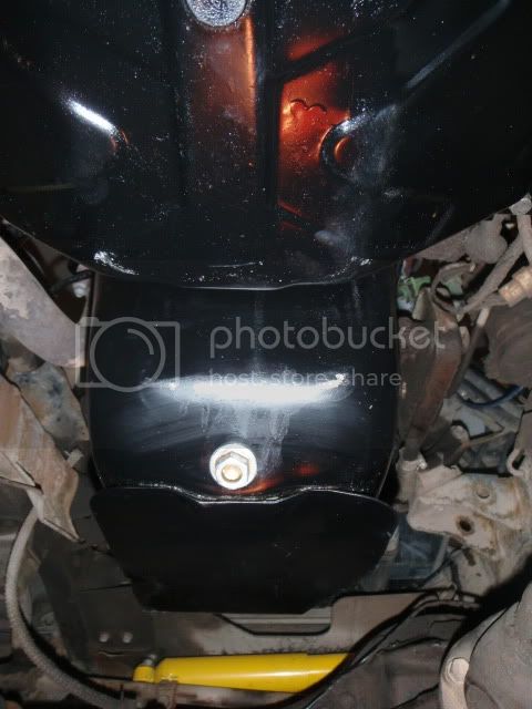

when the pan was out, i painted it & and the flywheel inspection cover
think it came out alright :grinpimp:

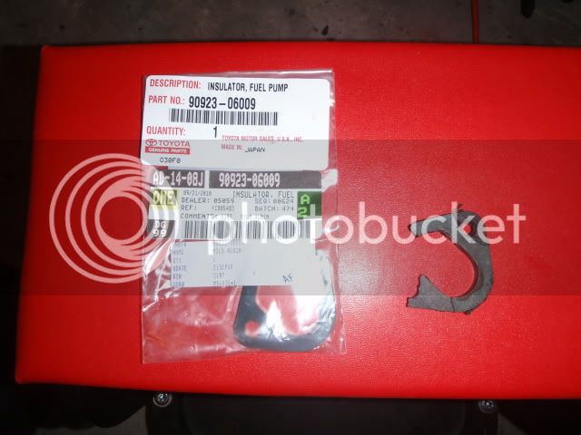

at the same time, i did my fuel pump gasket, because the old one looked like this:
it crumbled into pieces when i pulled it out, needless to say my FJ60 leaks alot less

*FWIW-Pure Theory and Conjecture
What seem to be strategically placed globs of rtv in the base of most of the '60 series F engine oil pans..
My old Shop Manager got mad when we would clean those out. He stated that a Toyota Engineer said they were there as a means to have a point of buildup for sludge and debris to collect and stop the small stuff from going right up into the oil pickup screen. Seriously, look at the path of the pickup versus likely oil flow and how that could be entirely reasonable in an ideal and magical Toyota Geek Engineer's Mind.
:meh: It's where the weld spots for the skid on the pan are..wouldn't the oil prevent it from rusting? Was Toyota worried their spot welds would pinhole leak from the center point, or if the skid were to be torn/knocked off it could leak, who knows..
Then again, isn't that what a good filter and reasonable driving is supposed to do? :D
My logic: the engineers had to afford food to go with the rice, so if it make's them last longer, why not? :D
Superstition or not, I never questioned that it took an extra hour-half of paid time to do them again after we tanked it. (Glue Setup Time before coming into contact w/ oil.)
I love this sort of old rumor stuff. ;) :flipoff2:
^^ Yeah i have no idea why those are there from the factory, other than like you stated- to perhaps seal up where the skidplate was spot welded
either way, i re-sealed all of those points with fresh Toyota RTV
