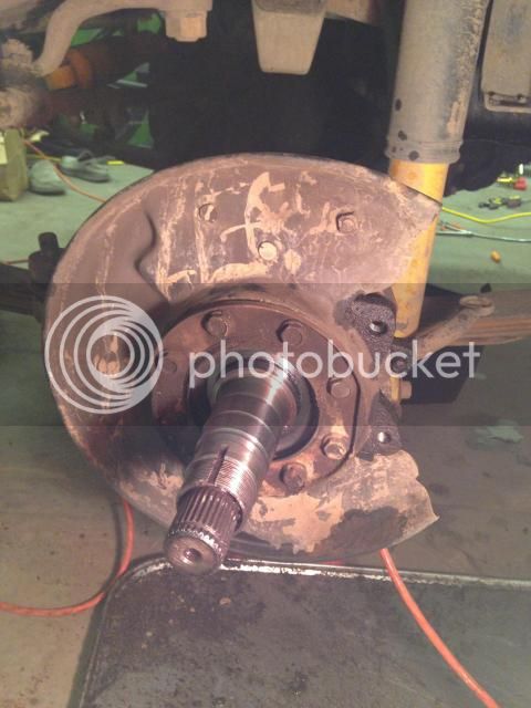

30 years of Cruising later, it was time to service the knuckles on the rig.
My inner axle seals were completely shot and she was dripping a quagmire of grease and diff oil onto my garage floor. (did a full axle rebuild kit, including new Trunion bearings, wheel bearings, knuckle wipers and seals, spindle seals, all new gaskets, basically every seal in the whole setup and Marlin crawler inner axle seals.)

Torn all the way down:

Long story short, My rig has never been better. I am pretty happy knowing that it has fresh seals, all new bearings, gaskets and a properly sorted front axle.
It was easily the messiest job i've ever seen in my life but it was well worth the effort.
