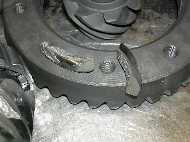

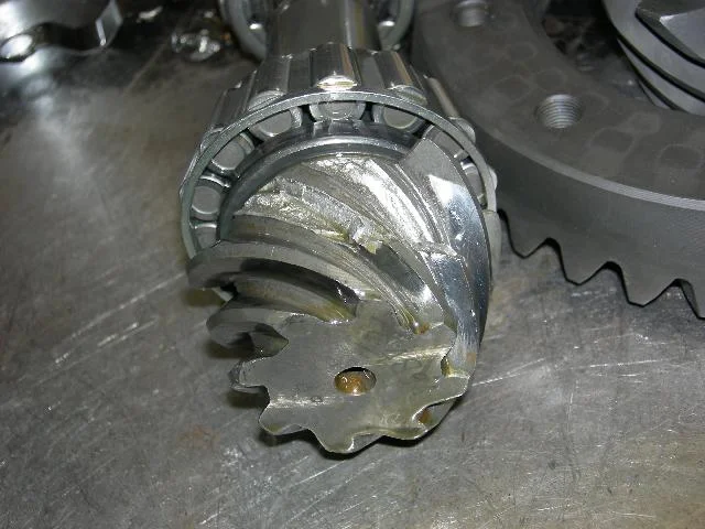

So Kato (Millhouse) took his truck out the other day when it was nice, and rolled to a stop sign, and heard a bang, bang, bang from the rear end. He had been talking about replacing that Detroit in the rear with an ARB, but not this soon. Upon further investigation we found this:
Old and busted....

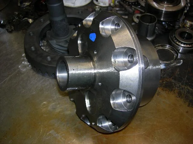

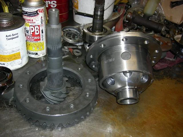

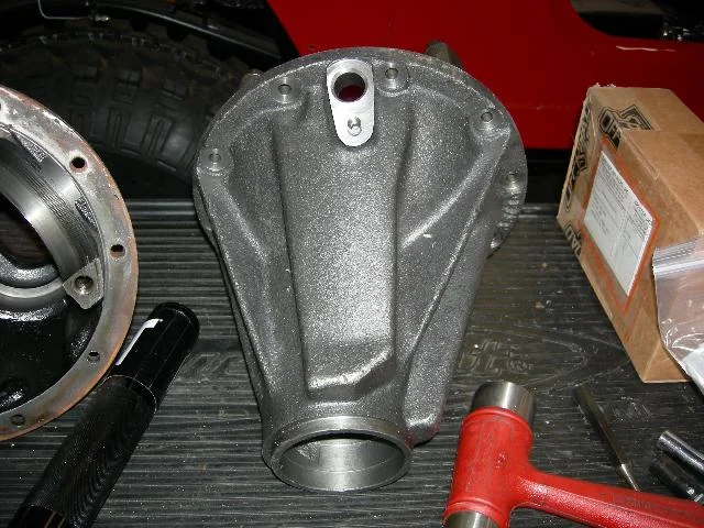

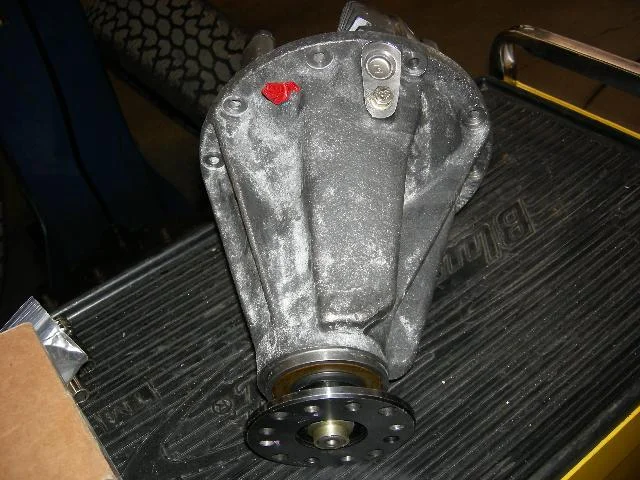

So he decided that a V6 center section was going to be the replacement, since a Hi9 was not in the budget right now. :) Picked up a new center and solid pinion spacer from Marlin Crawler, great customer service from Stuart again. :beer: Picked up the new RD132 ARB that replaces the old RD23, a set of 4:88 V6 gears and replaced the old grooved companion flange with a new one as well.
