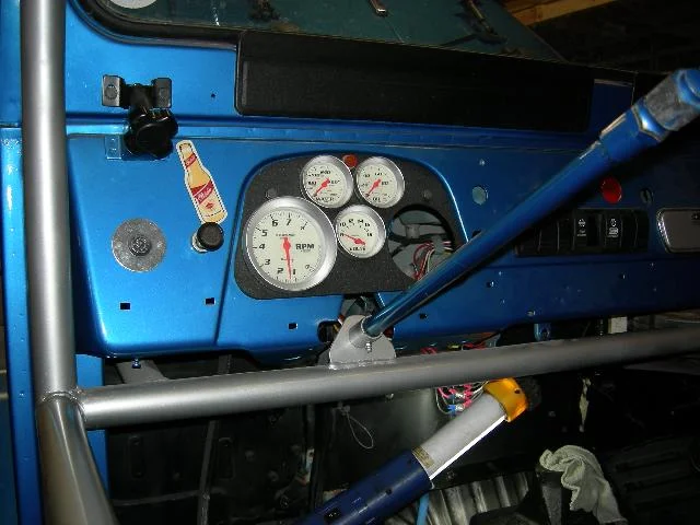

That steering shaft is crazy looking. Does it flop around being unsupported like that?
That’s a good question that Chris would have to answer but keep in mind it has full hydraulic steering so the steering shaft shouldn't see much of a load.
It’s not like he has to manually muscle those big tires….. He should be able to steer with one finger even in the stickiest of situations.
Guess I am not following where you are seeing that it is not supported....There is a grease able support bushing right in the middle of the shaft attached to the A-pillar cross bar. It is a sold steel shaft, I do not know how it would ‘flop around’.....
See pic:

I knew better to think that you guys would make something poorly thought out, it just looked funny with no steering column to hide the shaft. It looks way beefy up close.
