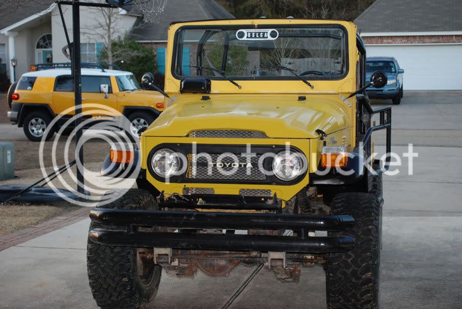

Got most of my last minute list done today. Got the headlight buckets and headlights in (found out the long way that the buckets that fit the fiberglass do NOT fit the metal bib :mad: ), got the turn signals mounted on the fenders and the new thermostat for the fan mounted, wired and adjusted. :clap:
Tomorrow I will be wiring up the headlights and turn signal, fixing the rear tailgate panel so it doesn't rattle and get that skid plate installed. :idea:

The 40 looks awesome. Not sure about Bumble Bee as a name.....maybe if one of those "bees" in the pictures posted by Scott ride shotgun! A couple of questions about the rig. Did you use the frame tie-ins with the roll cage? Also, who makes the rear bumper/swing away tire carrier you've got? I like your mods and am contemplating a few of my own.
Thanks for the kind words.
Well, let's see:
1st, I went with Paul's suggestion and named her Hachi (Japanese for bee) but I do like the idea of one of those "bees" riding shotgun.
2nd, I did not use the frame tie-ins but I may add them later. Mark at Metal Tech said that if the rear wells are not rusted, the plates they use are enough for the rear. My welder liked the fact that the fronts were located right above a support so not sure if I am going to add them or not. Deryl did get the tie ins for his rig from MT both front and rear.
3rd, the bumper / swing-out was on the rig when I bought it from Brian. It was a home made job made from 2X4 box steel. I had my welder move the tire to the driver's side, add the jerry can basket and use a beefy spindle for the pivot which was also swapped to the driver's side. Oh, he also moved the hitch to inside the bumper. In hindsight, I wish I would have made the jerry can basket removable and then had another basket made to fit a cooler. I may go back and have that done. If you want some close up pics of the bumper to build your own, let me know. This is a pretty simple design.
