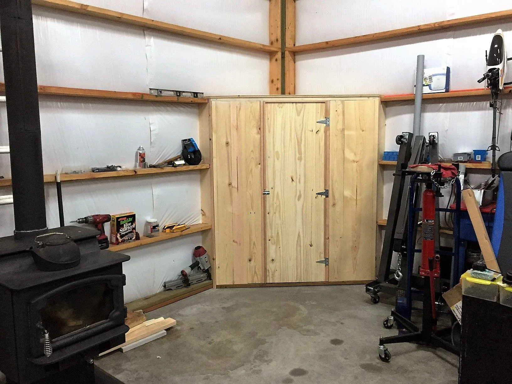

Nice job on your shop stove. I like the wall penetration, keeps roof free of potential leaks. I have the same cast iron kettle. Looking for a stove now, have a propane unit now but want a wood stove to save money for the 40 rebuild.
Stove looking good Mike!
Thanks Bud!
Agree! I hate cutting holes thru a perfectly water tight roof, better safe than sorry. It took me a long while to complete this project but was well worth the wait and I'm very pleased with the results.

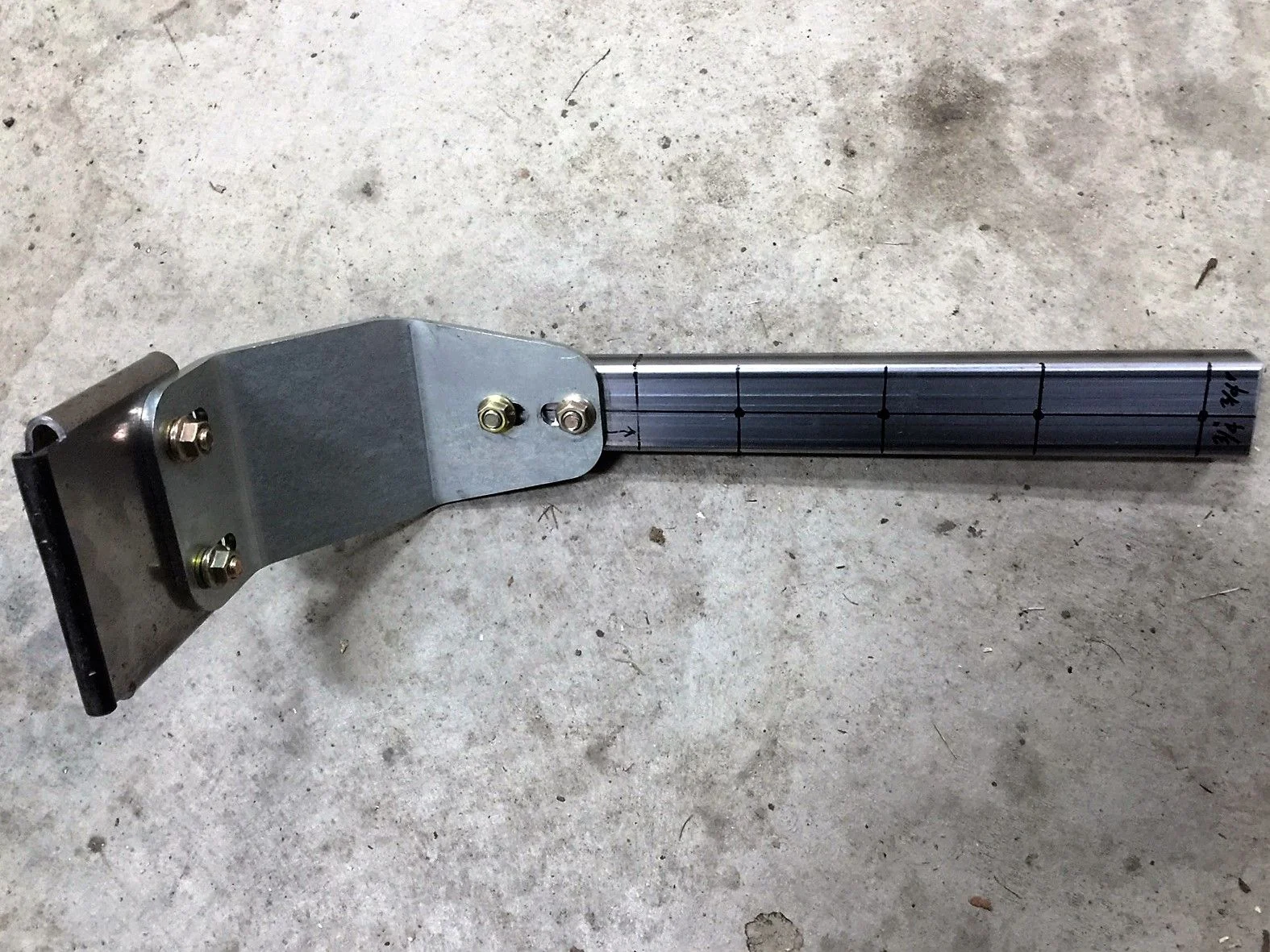

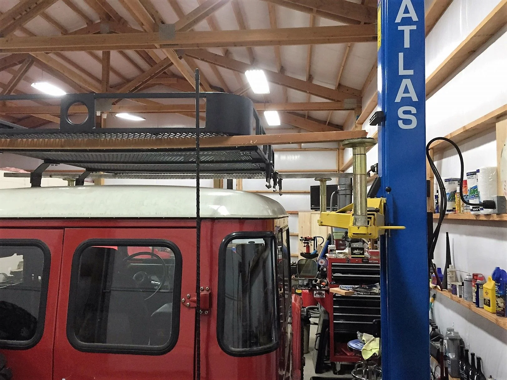

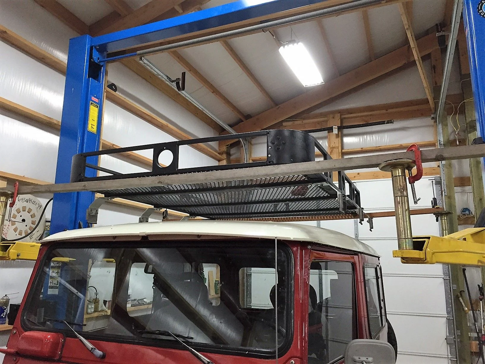

I also started my ConFerr roof rack installation with a few modifications to the roof brackets since the rack is only 54" wide and it needs to 60" for the bracket to reach the roof gutters. I purchased 3/4"x1-1/2" tubing and cut it down to 12" lengths to extend the rack width by 3" on each side.
full
full
3" shy on each side
full
More fabrication to follow.

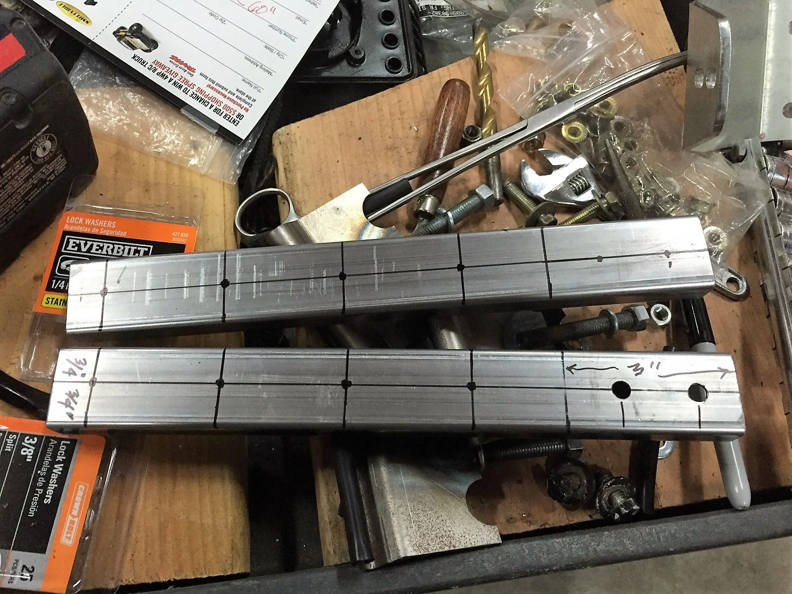

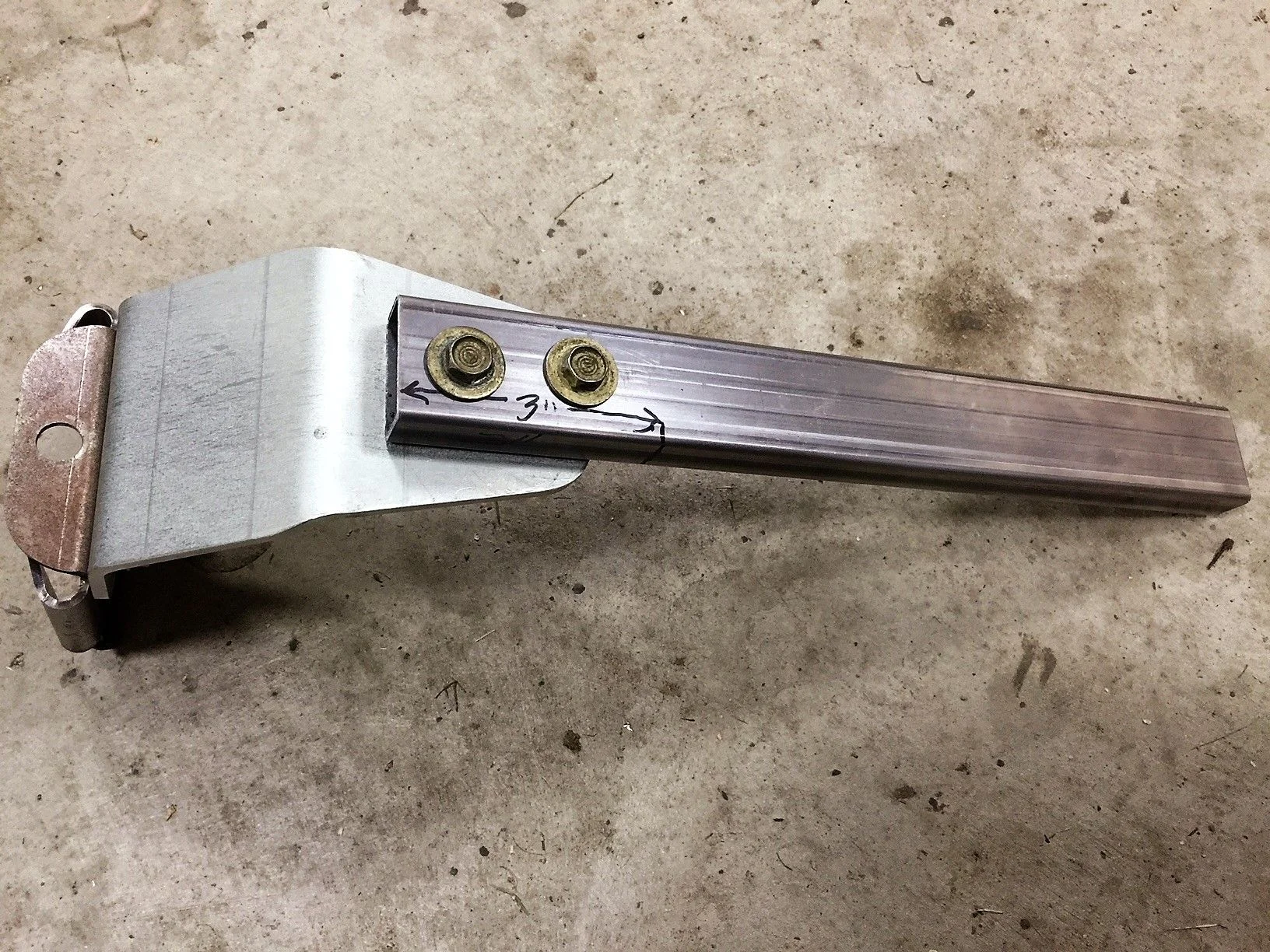

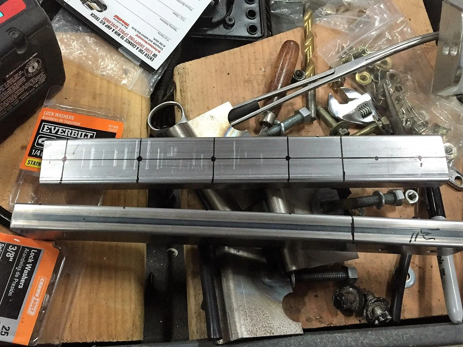

I fabbed (6) 3/4"x1-1/2"x12" steel tubing extensions for the ConFerr roof rack brackets
full
Drilled them to bolt on the underside of the rack
full
full
full

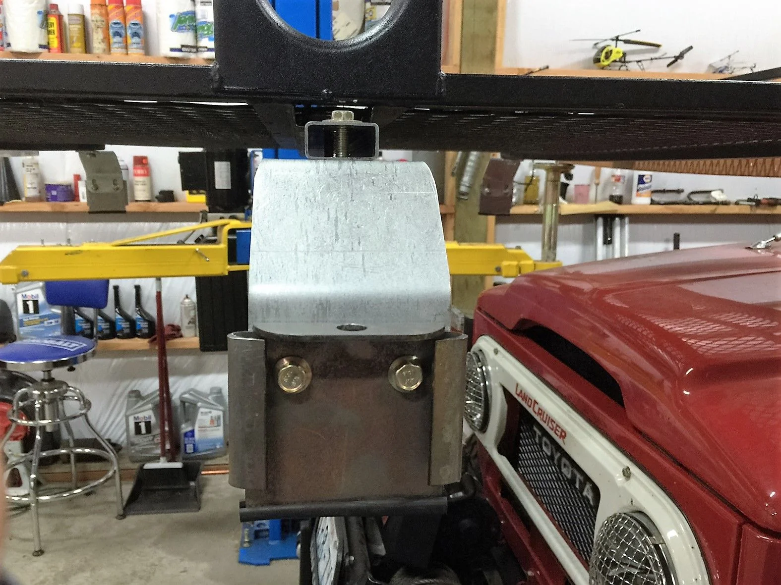

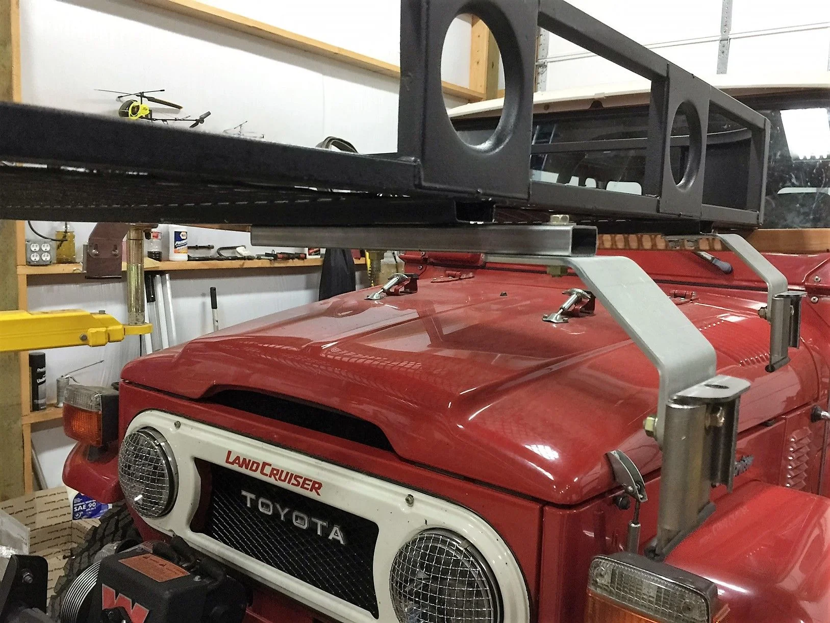

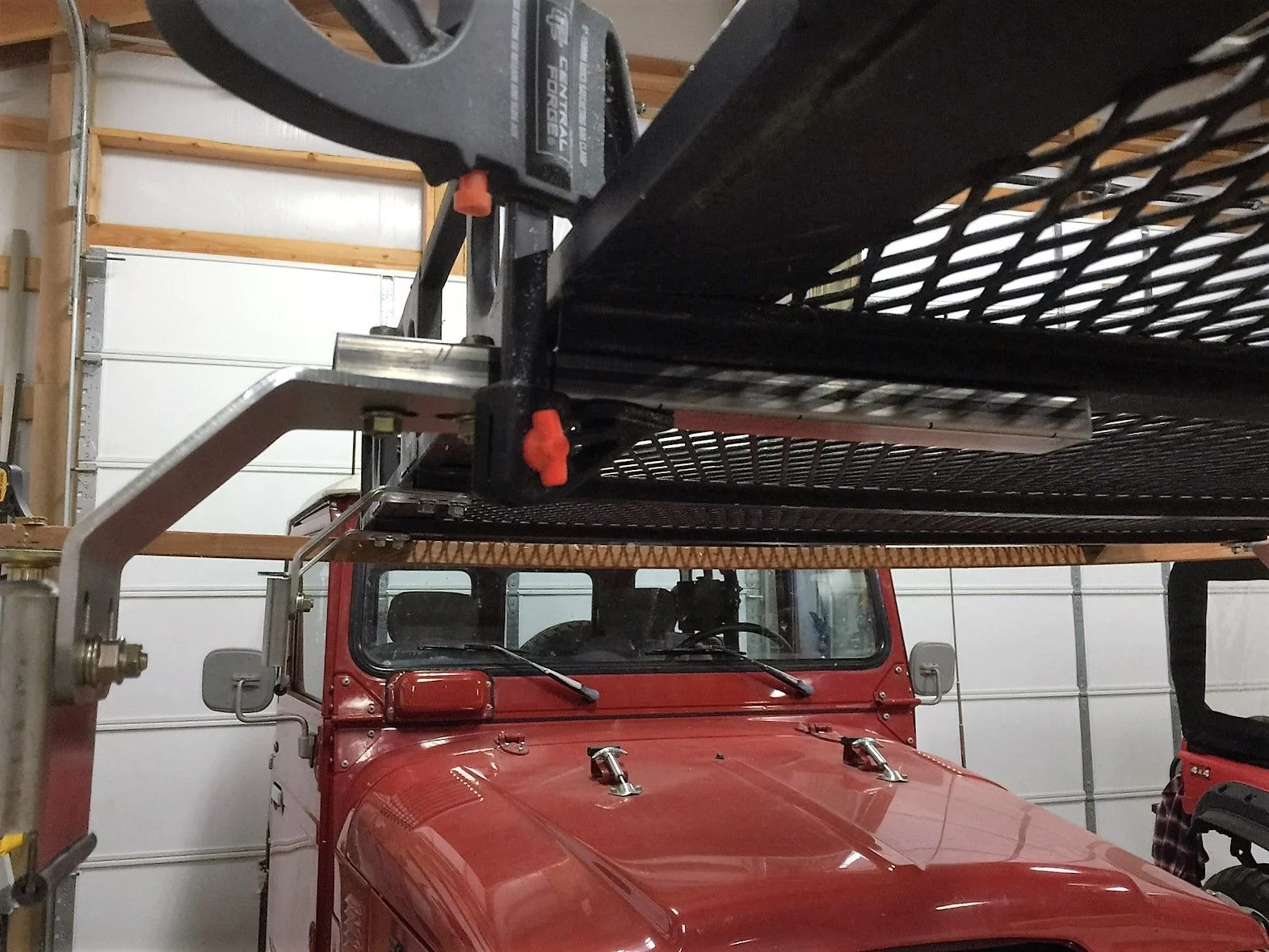

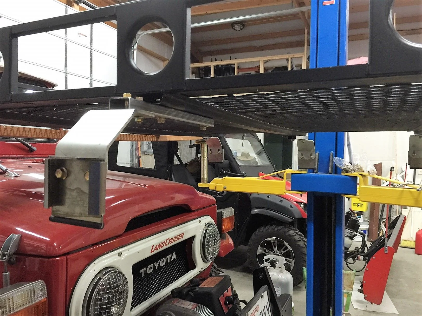

Mock up
full
full
full
One set is done, 2 sets left to do, then prime and paint to match rack
