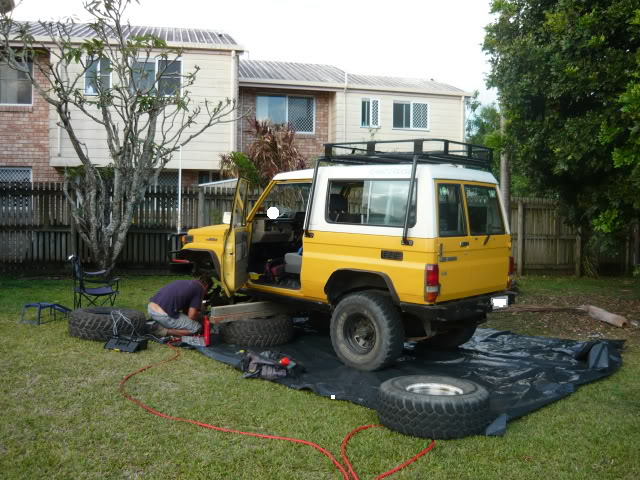

Had a big weekend on the tools and have only just finished cleaning up. I did the front end job which involves:
- full hub rebuild with HD kit from locktup w/marlin axle seals
- Longfield axles,cv and hub gears
- fitting rebuilt calipers
- new rotors
- magnum studs
- move axle forward 25mm
- 3 degree castor wedges
- new tie rod and drag link with new TRE's
- backing plate eliminator
- remove diff center and get lock right fitted (cheers simo)
- rock rings
I think thats all, messy stinky job so hopefully I did it right so I don't have to do it again anytime soon.
I need a bloody shed, I would have loved a hoist too, black plastic does the job for now though
pulling it all apart, diff oil smells like arse
housemate plucking his first cv
all finished, the place where i had the rods made cocked up and made them too long, didn't allow for the jamb nuts to be part of the length so i'll have to pull them off and get them re done because there is bugger all adjustment left.
It handles so much better now its unreal. The cruiser also had its first service on the motor and tidied up quite a few things and now its running like a brand new one. My new carby arrived today and i'll pick it up tommorow. happys days.

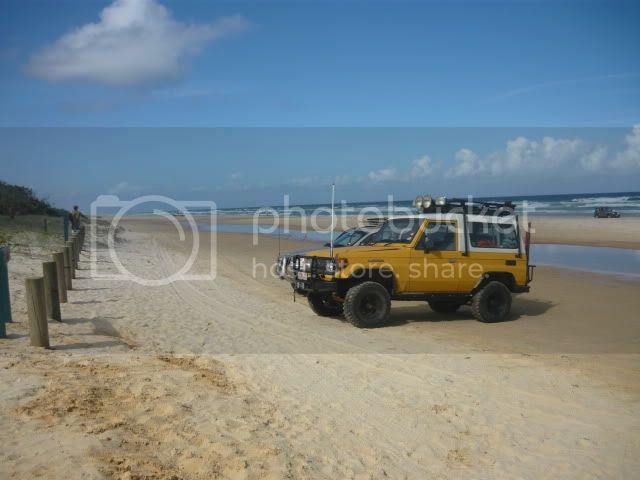

Just got back from Fraser Is. yesterday for the cruiser's first hit out after the build. Everything went well and nothing broke. The weather was bloody good and was an awsome trip. heres some photos.
heres my mate about 500m up North shore
heres some dead cars, they were at the Double Is. point end of rainbow beach
the cruiser posing on the beach
