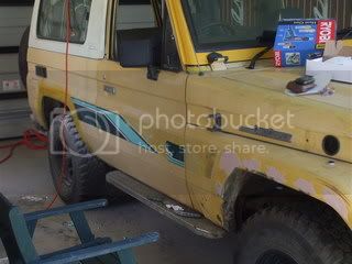

Got my new cruiser back in may. 1985 bj73 with a 253 on gas. Picked it up off ebay in Brisbane, about 1000km from where I live. I got a mate to get a new clutch and windscreen surround sorted a few leaks fixed then drove back. So far have removed the wheel arches and bogged it up, ripped the back seats out and fix the rust under the windscreen.
how i got it
the wheels arches gone

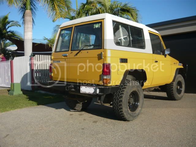

finished product

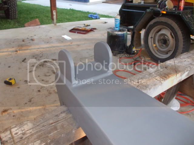

then did a rear quarter chop to make way for the rear bar i was going to make

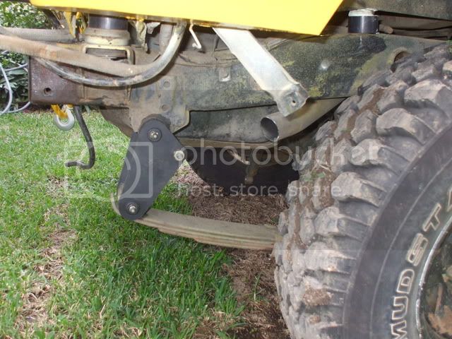

made the rear bar with the tabs on each side for swing aways when i get around to making them

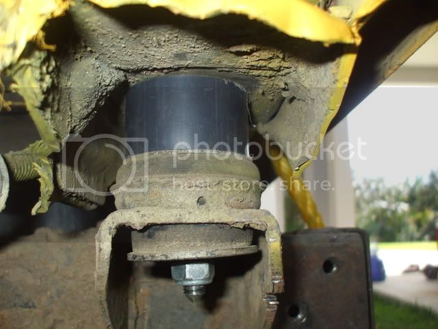

did a 30mm body lift

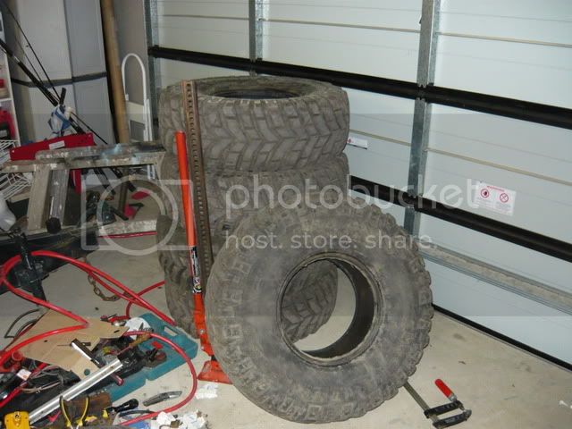

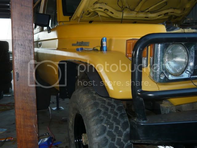

fitted some 33's to fill the guards a bit more
35's for play tires

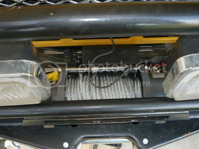

fitted a 12000lb winch

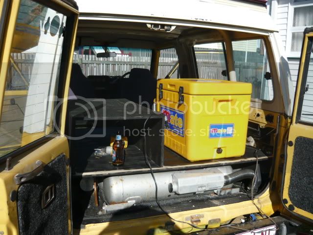

made a water tank to go under the false floor, holds about 55 L

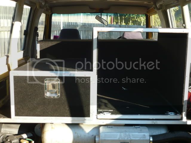

then i started making the strorage system
tidied it up with aliumium angle

Wow, that looks great. I wish I could turn out a bumper just as easy as that! Any pictures of the process of how you made it? Gotta see a few shots with the 35's on too when you start playing :)

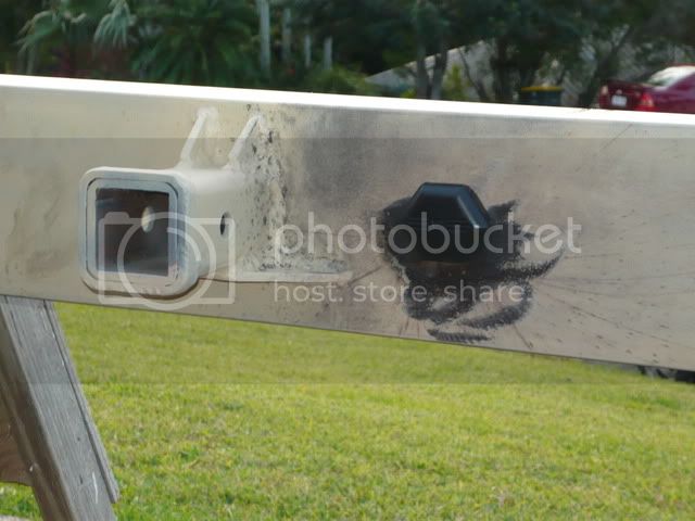

cheers mate! yeah i can't wait to get the 35's on to see how she looks. heres some photos of the bumper build
it was a solid piece of 150mm 'c' section, i cut the taper into the bar and the mitred the corner using the 9'' grinder
then with the 9'' grinder again i cut in the bottom of the taper and cut the corners
welded it all up
mounted it to the car and cut the hole for the tow hitch
added the tabs for the swing aways
i didn't take any photos of it but behind the receiver i welded some 10mm plate with 4 1/2 in holes in it to bolt into the stock tow bar hole. i then bolted it to the cruiser and slid the bumper over it and tacked it on. then i took it off and welded and braced it up. Al it was then was a matter of bogging it and a bit of a sand then a lick of paint.
I enjoyed making it and was pleased with the end result.
