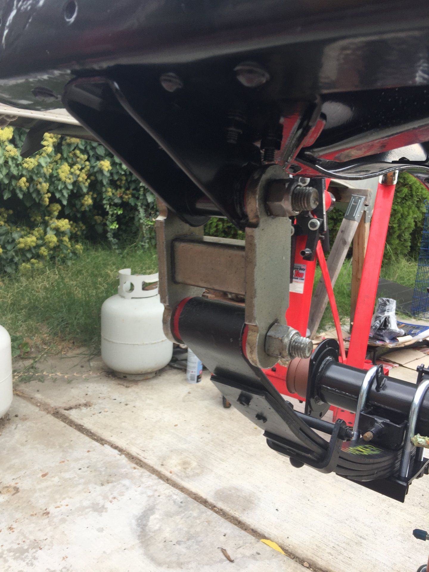

Hoping you guys can help with a couple q’s...
How hard should it be to get the springs into the spring hanger? I had to literally beat them in with a rubber mallet and now that they are in they squeak like crazy when I move them up and down. Frame is powder coated so wondering if that’s the issue...
Does the shackle angle below look like it will end up in the right place when there’s weight on it?
If i remember correctly mine were a bit snug. After removing my original bushings i pryed the mounts open just a shade to make it easier for me to install using the supplied lube. No squeaks with the skyjacker 2.5" kit. Not sure about the shackle angle its hard to tell until there is weight on it.
Thank you Curt. Did you put grease between the outside of the bushings and hanger? What I’ve read on here I’ve read no
I grease my bushings & bolts inside and out periodically. I h8 squeaks.
The front of the spring is laying on a cart. Imposssible to tell anything until both ends are installed.
The spring is connected at both ends but hanging and not connected to the axle yet..was hoping to avoid having to pull this thing back apart if possible!

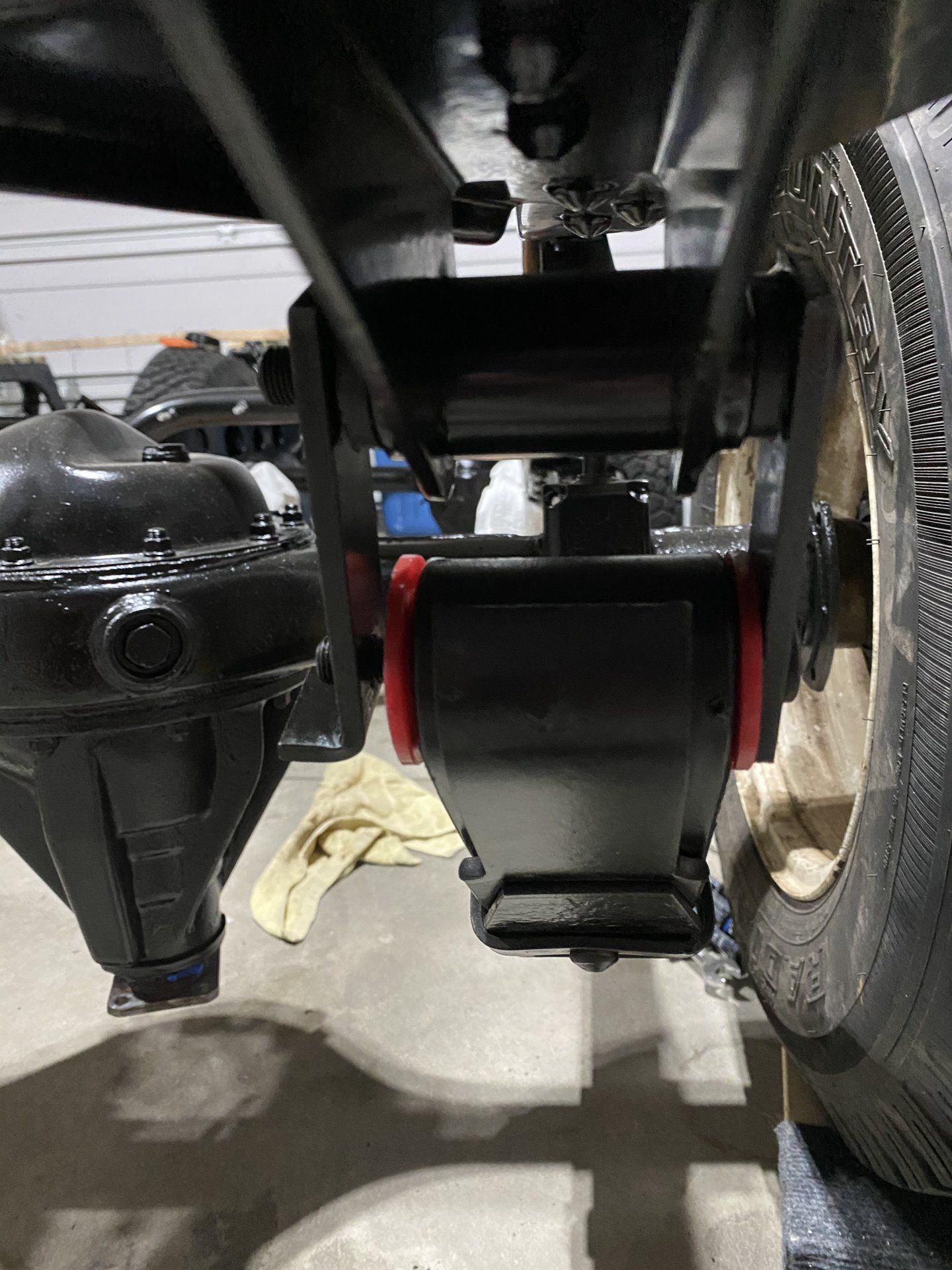

This was mine...front and rear, with axles mounted. Frame was powder coated like yours and and bushings were very tight....lubed inside and outside. My springs are skyjacker 2.5’s
Looks just about like mine now so I think I’m good. Thanks!
