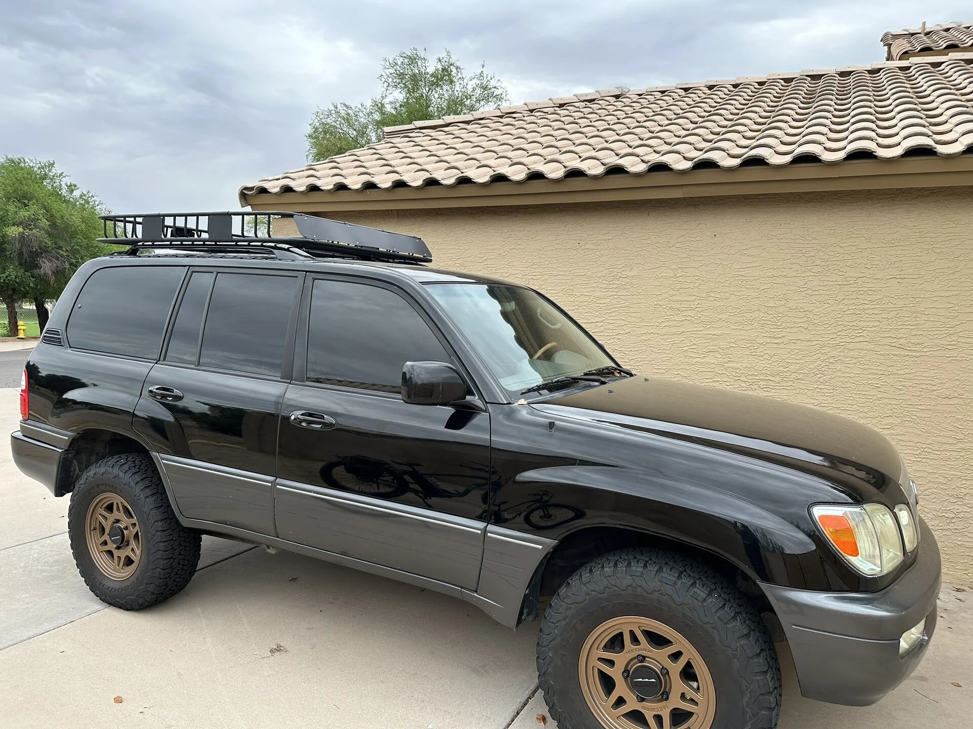

MR316, 17x8.5 +0 on 285/70/17, this is stock AHC in high for reference. Pinch weld is trimmed and heated the fender liner to push it back. Almost no rubbing on “N”, only when wheels are slightly turned and the suspension compresses (even then it’s slight), otherwise no issues daily driving.

Man I’ve been looking at this exact wheel/tire setup on my green LX. Can’t find a ton of people running these though, they look awesome! Anymore pics?
