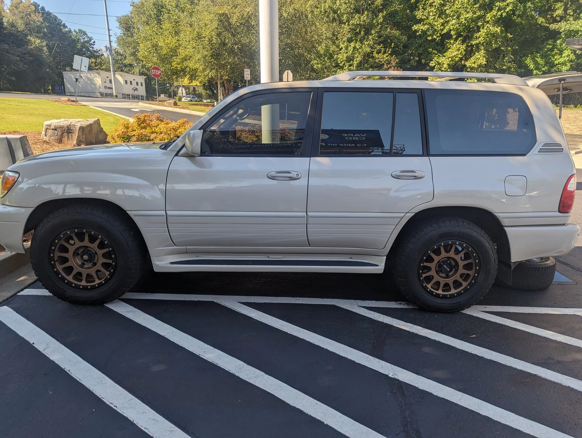

Method 314 17x7.5 +25 Offset
That +25mm offset IMO is the perfect offset for the 100 and 200 series. This is probably the closest reason why I am going to stick with my current wheel set.

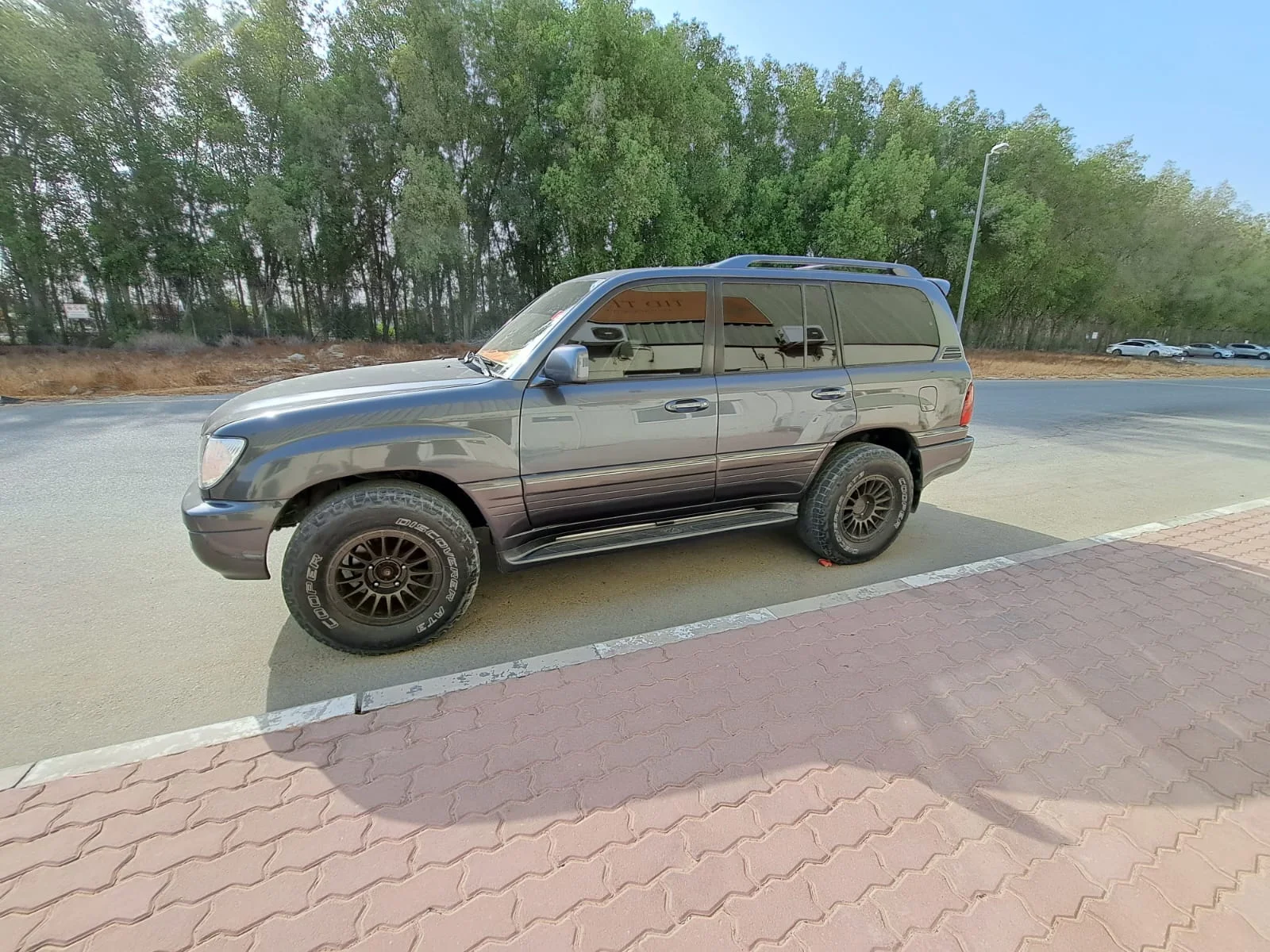

Not Methods but AlphaEquipt Echo (18x9 offset +25mm).
A few months ago I thought I was sure of ditching these for a set of 17x8 offset 0 Bradley V Forged wheels, but after making actual measurements multiple times and looking at different cruisers on zero offset wheels, I realized that zero is protruding too much for my liking (sorry old guy here). Been there done that on -12mm up to -50mm offset wheels when I was younger and I must say it looked really cool but cleaning the truck from the sling of the dirt/mud wasn’t.

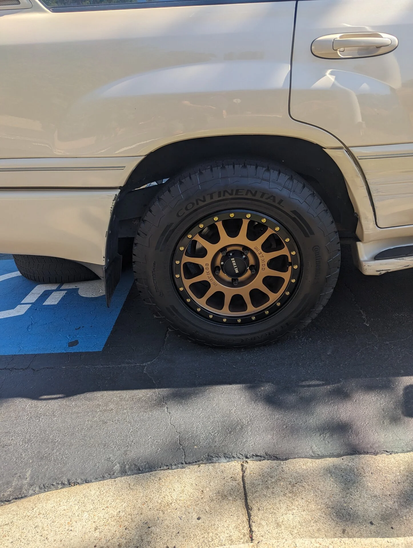

i have the same set of rims. do you have issues with balacning the wheel? Mine seems to vibrate a little at higher speed after installing it on the car. Perhaps some Spigots is what is needed?

I remember reading where @BPS619
said he had to shave down the little nuts on the front hub to make the wheel sit flush.
If you’re having balancing issues that may be a good place to start. Also have you confirmed it’s not your tires?
