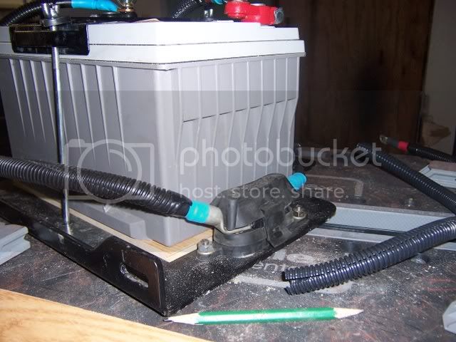

Today I finished installing a backup battery in my Metaltech sliders with the optional Metaltech accessory tray. First let me say that Metaltech makes a super quality product, their sliders are awesome and saved my cats the first week I had them. The accessory tray is built to the same standards as the sliders, it is a very thick plate that mounts directly to the sliders and the frame of the truck with the provided hardware and stainless bolts. I am confident this tray could take the full weight of the 80 with out a problem.
I won’t bore you with the details of my dual battery setup as similar ones have been covered extensively in other posts, let it suffice to say that I am using the Hellroaring isolator (another great product) with a Diehard Platinum deep cell for my main and a Diehard Platinum group 65 for my backup. The group 65 was almost too big for this install and it would be difficult to get a wider battery in this space. I had to trim some of the plastic foot off the bottom of the battery and I also had to put a spacer under the battery so it would slide over the top of the Metaltech brackets that mount the plate to the frame in order to slide the battery over to the passenger side far enough to clear the body. I used a standard battery hold down from Shucks but due to space limitations I did not use the included clips for the hold down studs instead I just fed the studs thru the side of the hold down and then cut them off flush to the top of the wing nut. I then bolted my 150 amp fuse behind the battery and installed a couple long bolts thru the plate in front of the battery to keep it from sliding fore or aft in the event of a collision or rollover. The only other modification I made was to cut off a long bolt that was sticking out from the body and too close to the battery.

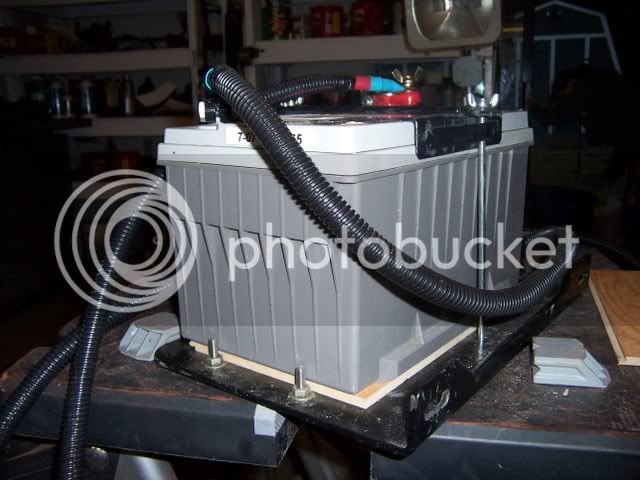

On the bench

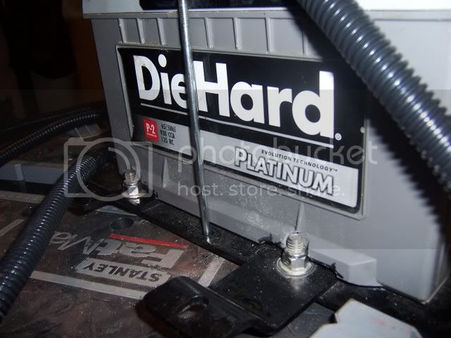

In this one you can see where I ground the plastic foot on the battery
Front

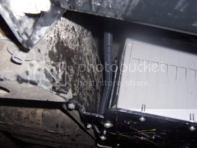

Under the 80
The now shorter bolt in the body

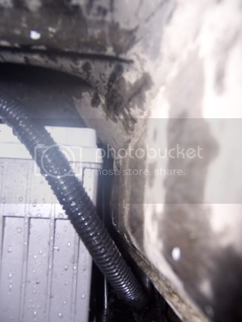

In this pic you can see how tight it is. If you look to the right you can see the bolt I cut off.
