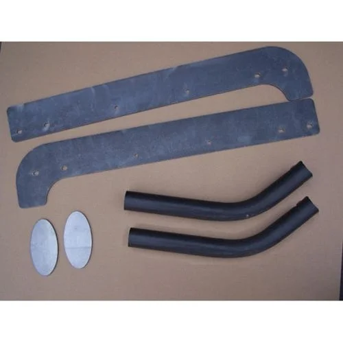

Ok, tired of searching, can't seem to find just the information that I want. I purchased a rear roll cage tie-in kit from Metaltech, but it came with no instructions whatsoever. What I got from them is shown in the picture below. I have a full roll cage with 6 posts and it is already pre-fabbed. The posts terminate in 3"x3" square plates. So my questions are:
1) Does the large plate in the kit go under the wheel well or on top of the wheel well? I'm guessing under but I've seen pics where people have put this on top (the rear 4 posts are welded directly to the large plate). It would seem better to have a plate on top and bottom actually...
2) Why no tie-in for the middle set of roll cage posts? There's only two tubes supplied and these go to the back roll cage posts as far as I can tell. The middle post and back post will be connected by the plate, and if the plate goes underneath the wheel well then the plate will be welded to the rear tie-in, but it seems better to have a direct tie-in for the middle set of posts....
Thanks in advance for any wisdom shared.

Ok, yes was not in the shop on Sunday so did not see your post or your e-mail. We have not had written instructions for the frame ties. When they are used with our cage's the large plate you get in the tie kit is the rear main mount inside the tub. So lets brake it down.
Large plates, go in the wheel well and are bolted through the tub to the roll cage.
Small plates, these elliptical scab (No vertical or horizontal welds on the frame this way) plates are welded to the frame.
Tubes, are extra long you trim them down to fit the location you chose to run them from the frame to the large backing plates.
How to do it all:
  • First decide if you want the tube drop from the tub to the frame in front of the axle or behind it.
  • Next bolt the backing plate in the wheel well to your existing cage.
  • Next locate the best point for your frame tie on the frame. Tack it to the frame where you can remove it.
  • Now trim/miter the tube drop to fit to the backing plate at the tub and the frame scab plate. Tack the tube in place at frame scab and backing plate.
  • Cut your frame tack on the scab plate and unbolt to remove the bolts for the backing plate. Drop the assembly down and finish welding it taking care to not over heat it and distort the assembly. (NOTE: You may wish to paint the whole assemble minus where the scab plate will be welded to the frame)
  • Re bolt the backing plate of the now assembly to the tub, take care to clamp the scab plate to the frame.
  • Fully weld the scab plate to the frame. Done.

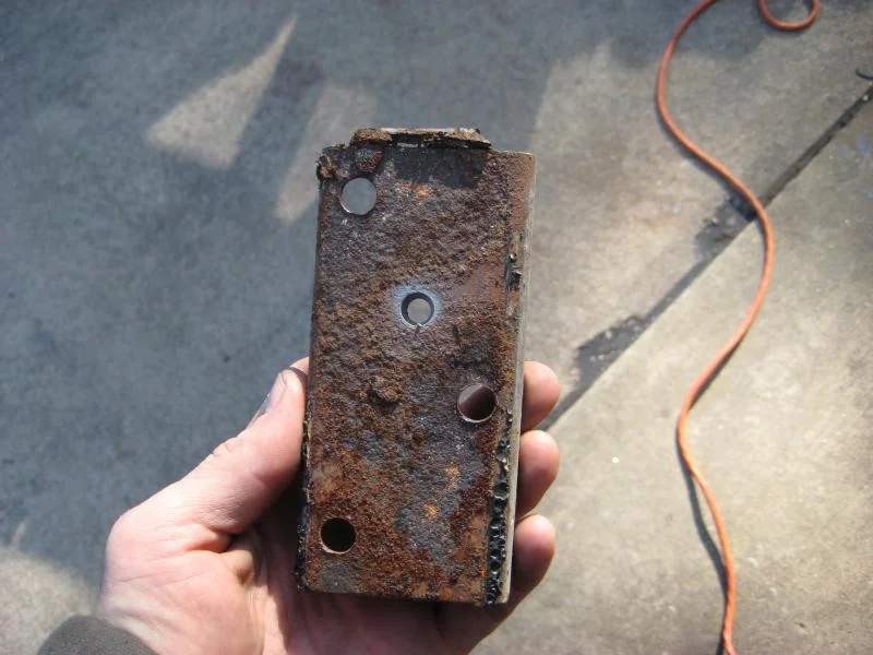

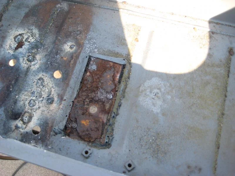

Lake rat: I removed my wheel well supports in prep for the plate. I can't tell you how glad I am that I did that. It was heavily rusted underneath and would have eventually rotted out my wheel wells.
here is a few pics. First is the wheel well and the second is of the underside of my jump seat support bracket.
I will be doing this very soon to my 40. I ordered my cage about a week or so ago. I can't wait. Thanks for the info Mark. Anyone have any pictures of what we are talking about here?
Thanks for the picture, being mine is going to be a trail truck only, I'll cut them out.
Do you still have that part?
I have both the wheel well supports as well as the jump seat brackets. I will still be reusing the Jump seat brackets and one of the wheel well supports for the one that won't be tied into the frame. Not sure exactly how it's going to work, but I might end up not using them at all if the plate seems like ample support. Which part were you referring to?
