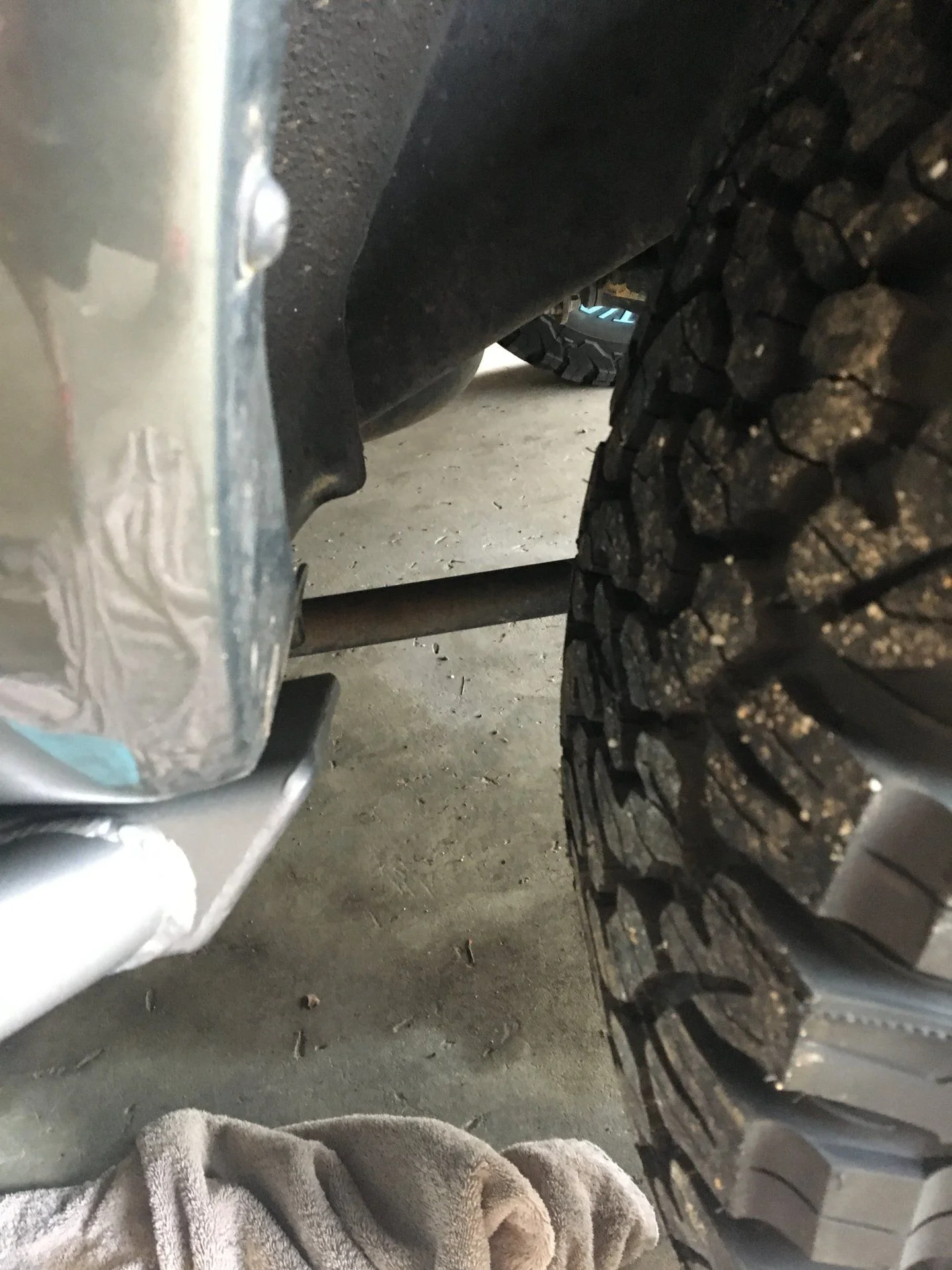

The written instructions from Metal Tech cover most of what you need to do to prepare for this installation. If your truck doesn't have AHC, you could've probably already finished the installation in the time that it will take to read this post. You don't have the AHC obstructions, so you have plenty of frame real estate to line up and mount your sliders. For those of us with AHC, Metal Tech recommends that you bend some hard lines out of the way and the shields protecting the globes. From my experience, you have to remove these shields (the pictures should help clarify this) if you want the sliders to mount in a acceptable position, mount flush to the frame, and not cause your tires (my 285/75/16) to rub lock-to-lock.

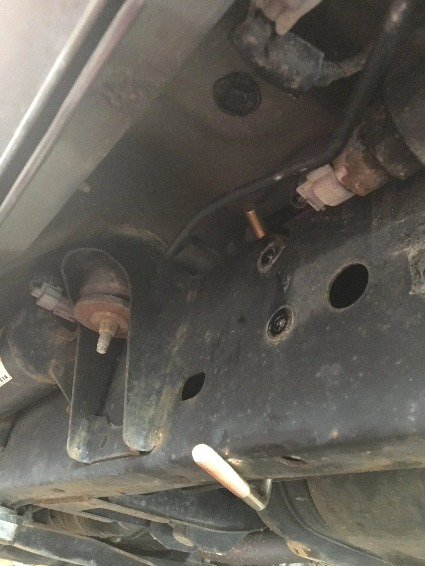

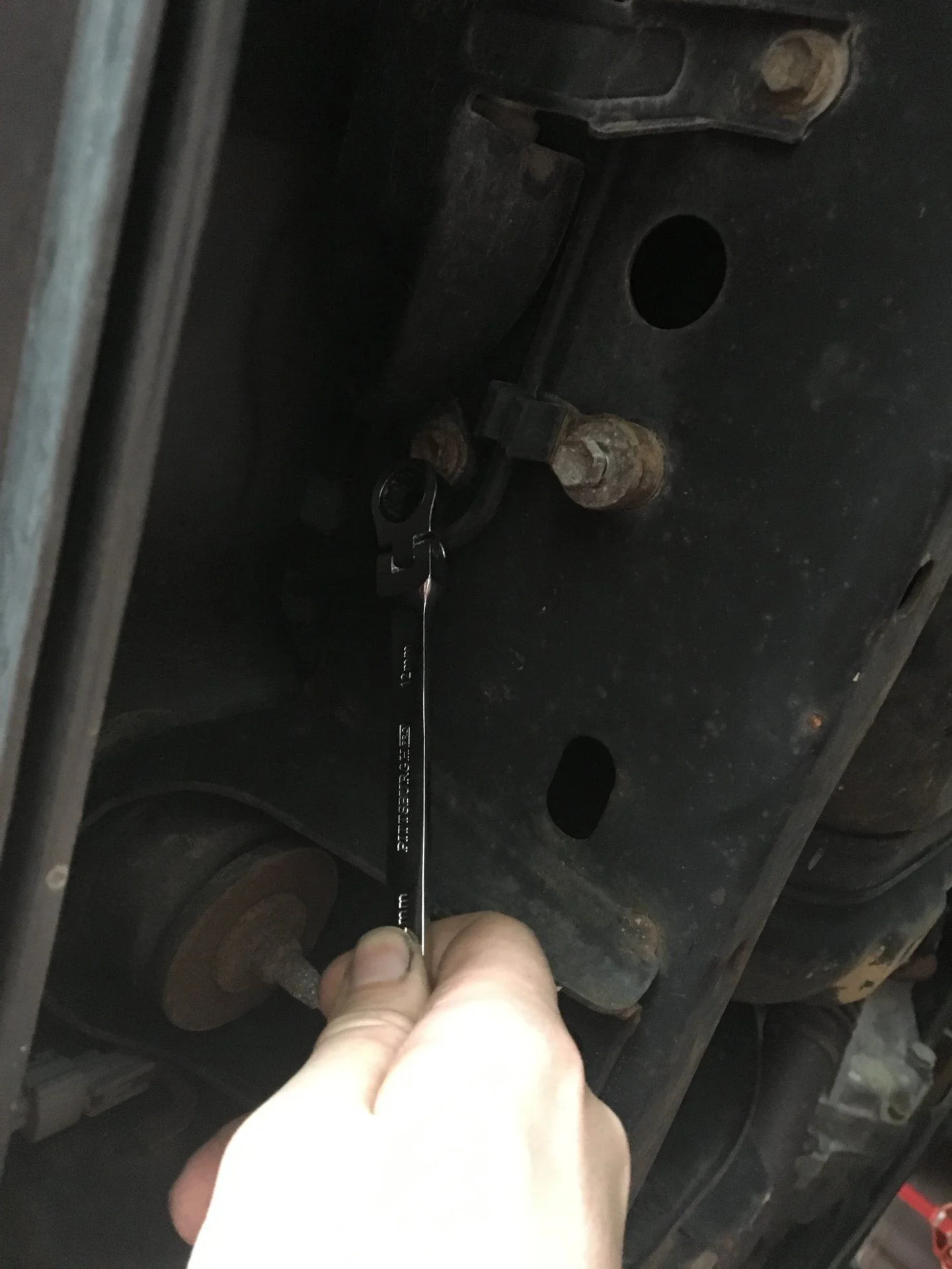

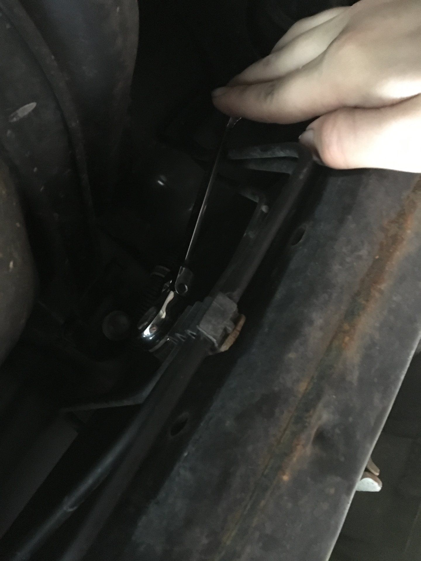

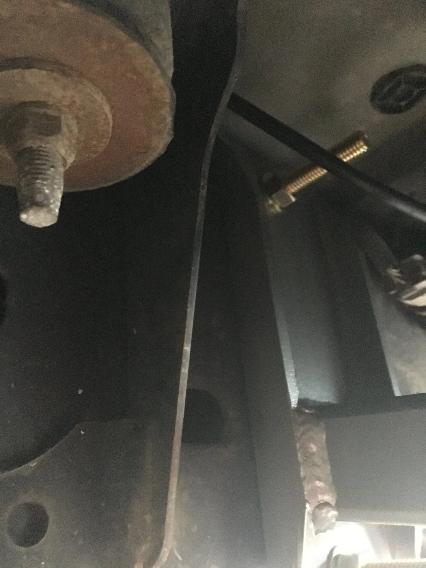

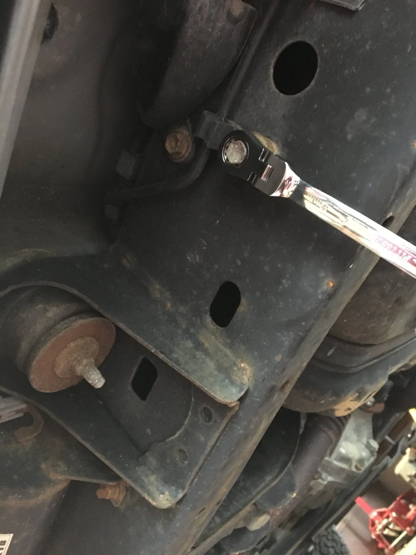

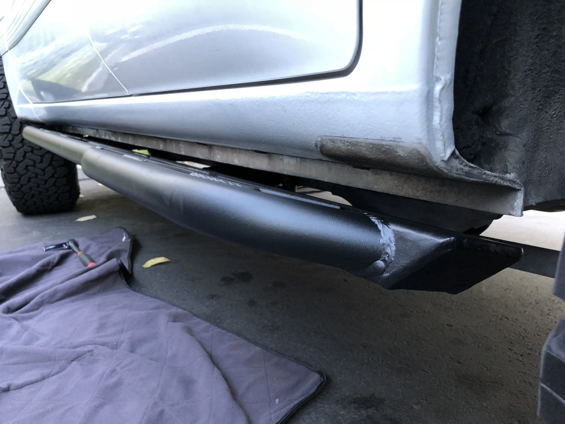

To start off, these pictures are looking at the Drivers side rear mount (where the slider foot mount will eventually rest). Both of these bolts need to be removed. The lower of the two is a guide clip for the AHC Hardline. The higher is the bolt holding on the shield covering your AHC equipment. This bolt must be removed or the feet of the sliders will not mount flush to your frame, and will not allow you to move the sliders far enough back on the truck.
These pictures are what it would look like if you didn't remove the shield (on the passenger side). The slider foot will rest on top of the bolt head, leaving space between the frame and slider. Your slider will also sit too far forward and potentially rub your tire.
Once you've removed the AHC shield and line guide, your frame should look like this

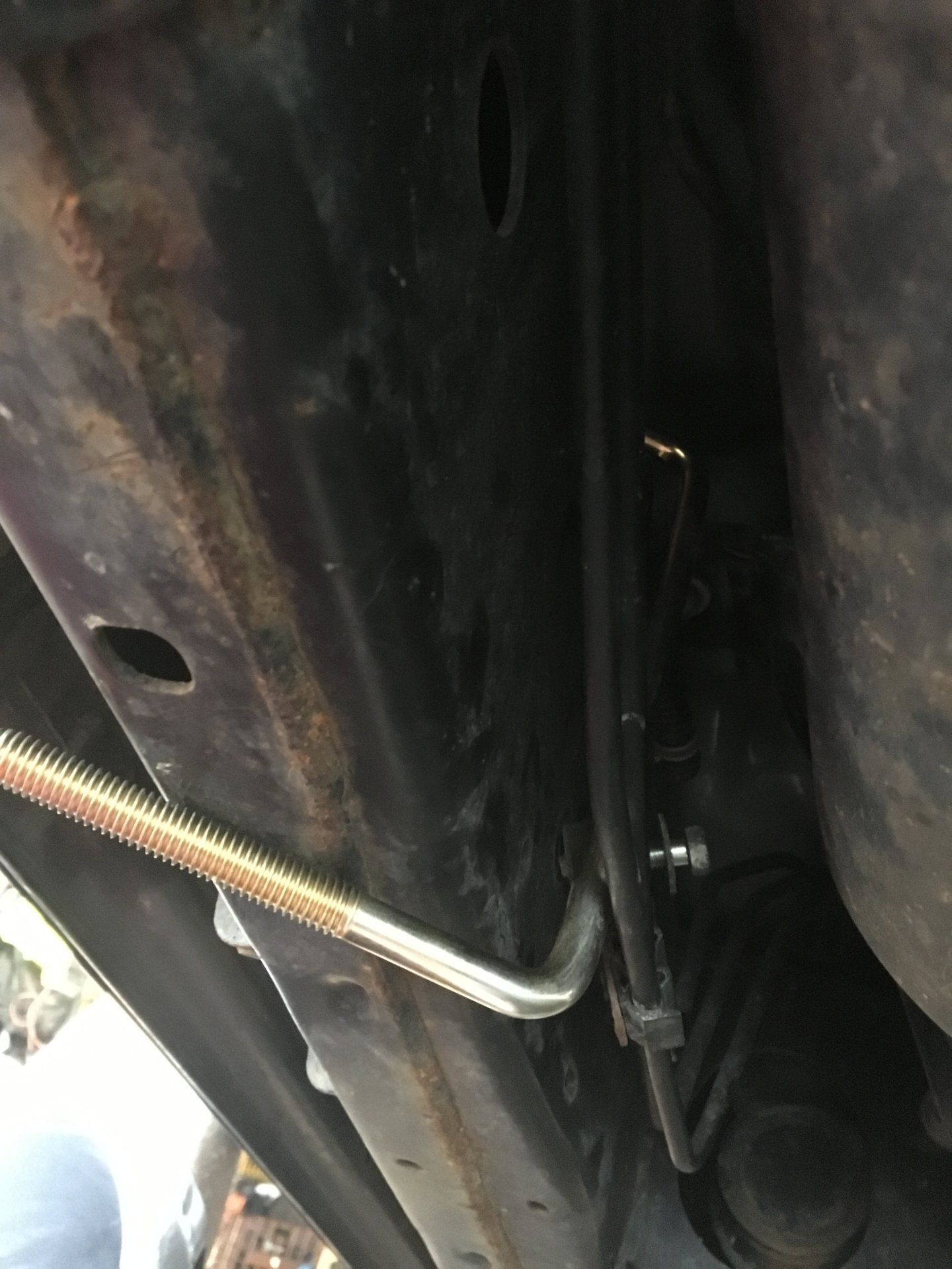

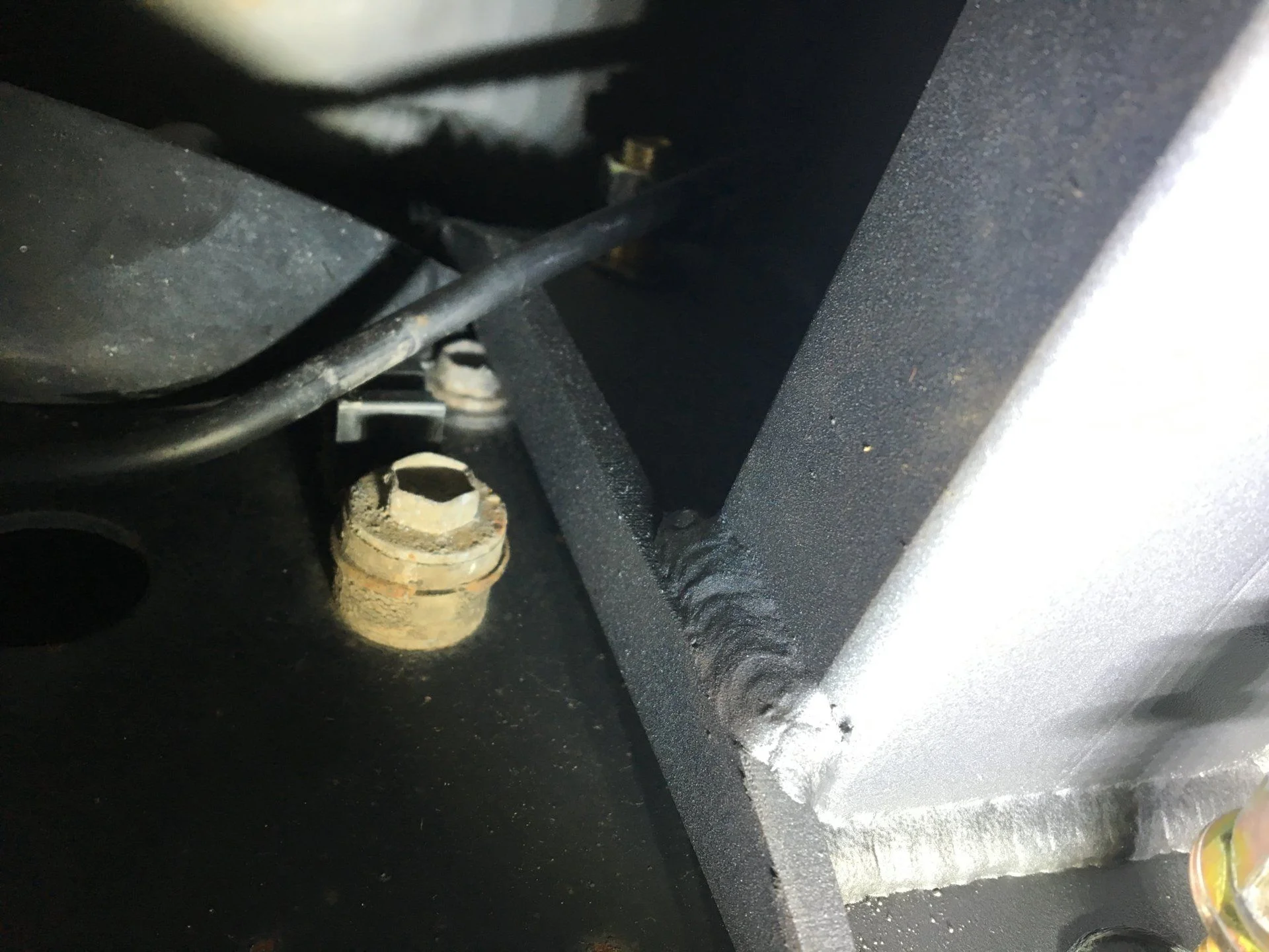

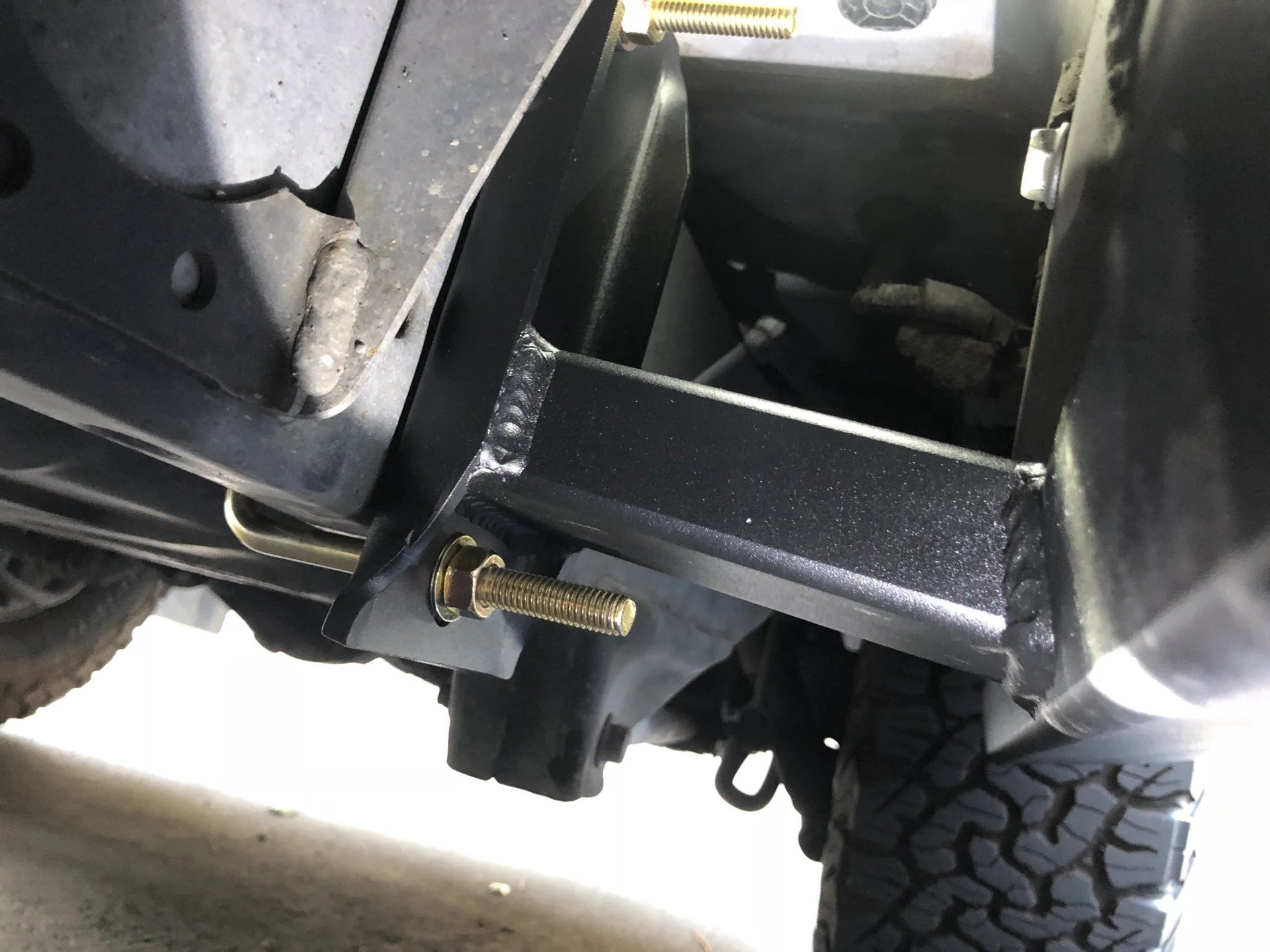

Continuing on the driver side of the vehicle, you need to route the U-Bolts provided by Metal Tech. On the inside of the frame, there are more hard lines and a bolted guide for them. Go ahead and loosen this bolt (10mm) and gently pull the lines away from the frame so you have more room to route the U-Bolt. You will not have to do this on the passenger side.

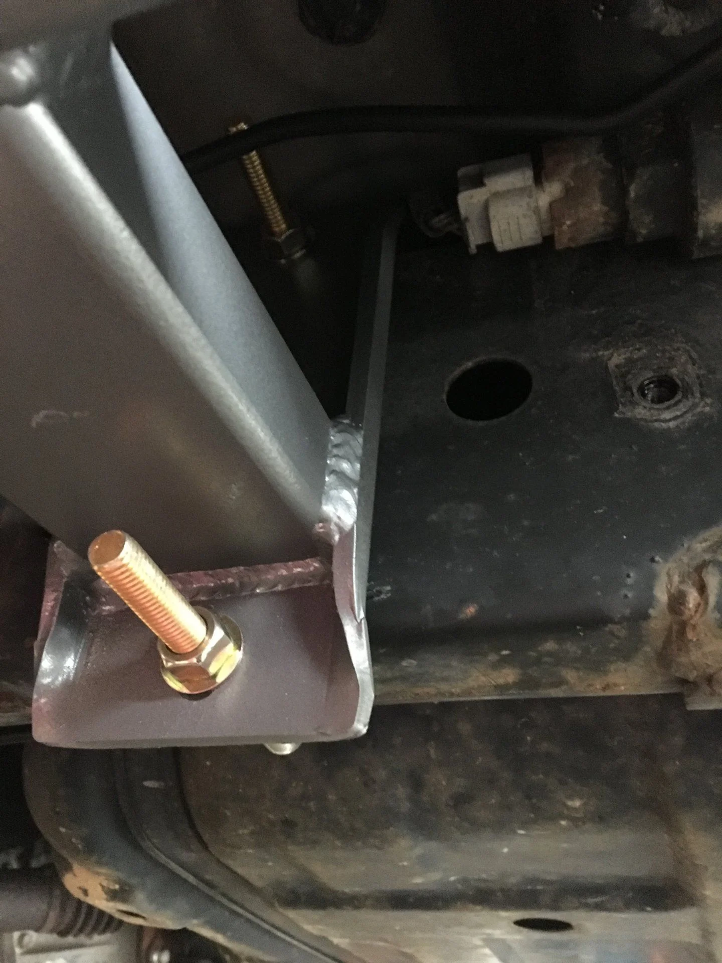

In this last picture it shows the single hard line that has been gently bent up and away from the frame. Your slider's foot is going to go between the frame and this hard line. You want to be careful with this hard line, but it will bend. Pull it far enough away where it wont rub on the slider's foot.
It's very important to NOT have anything between the U-Bolts and the frame in ANY mounting point on your vehicle.

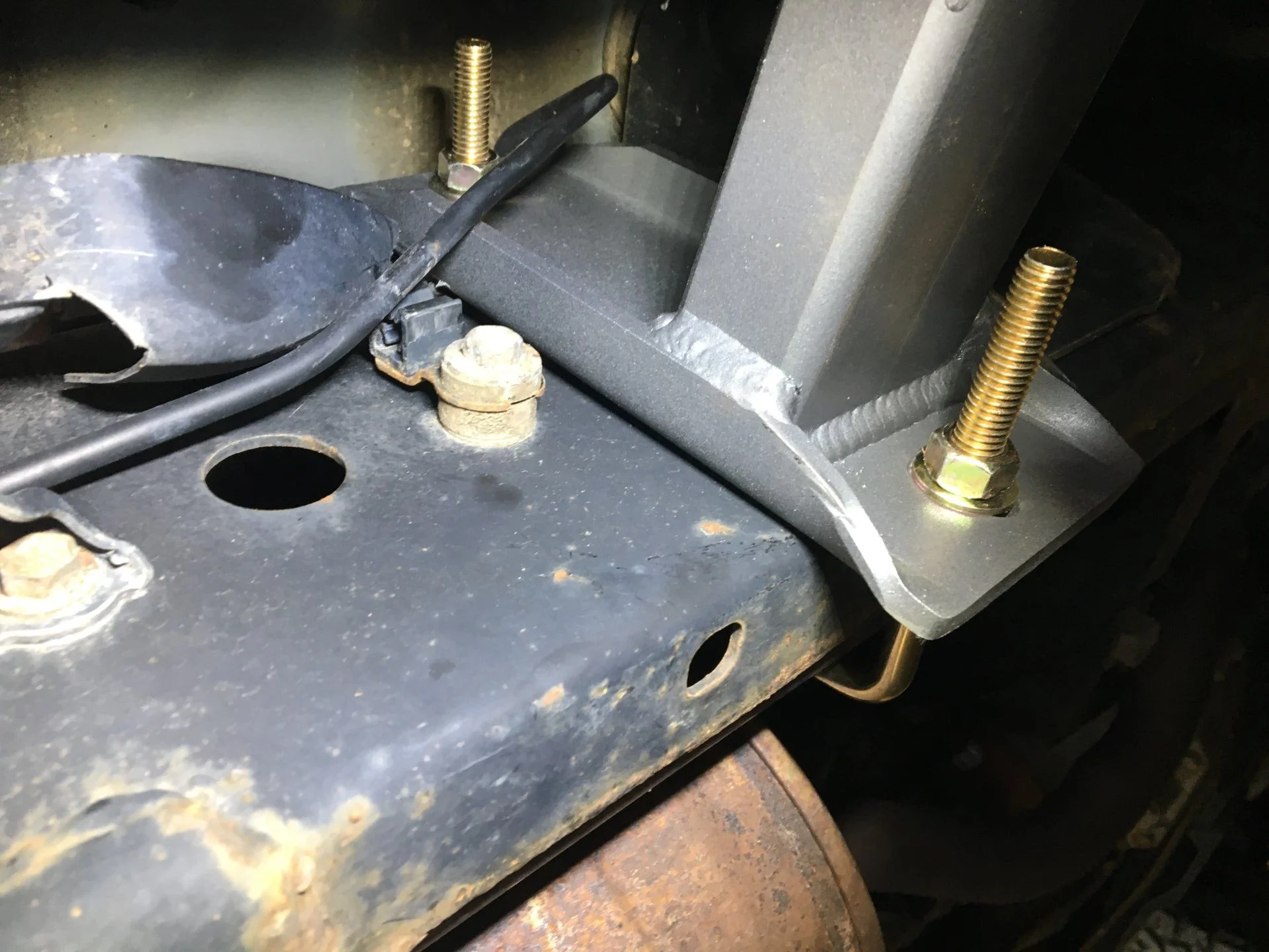

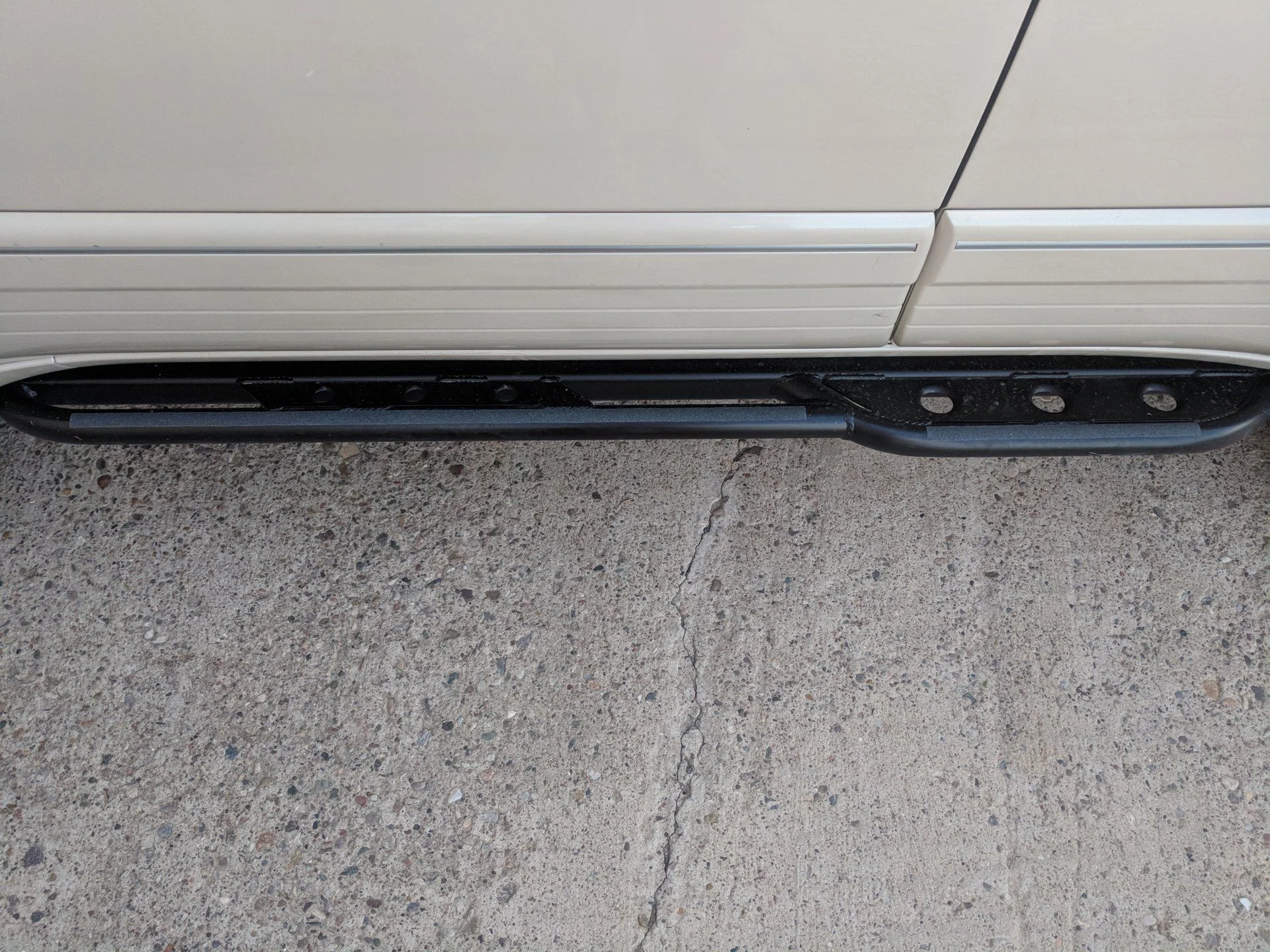

Mounted

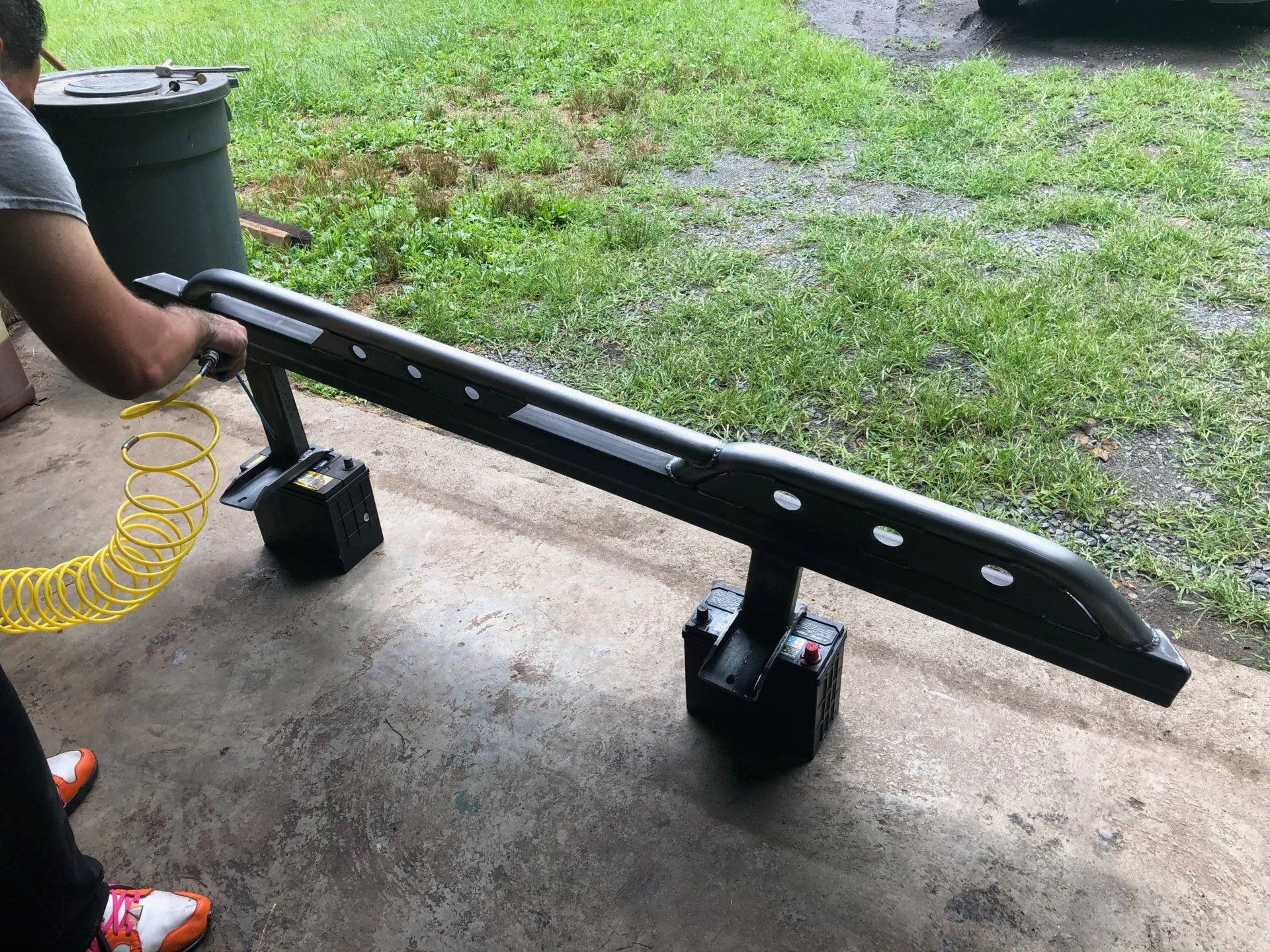

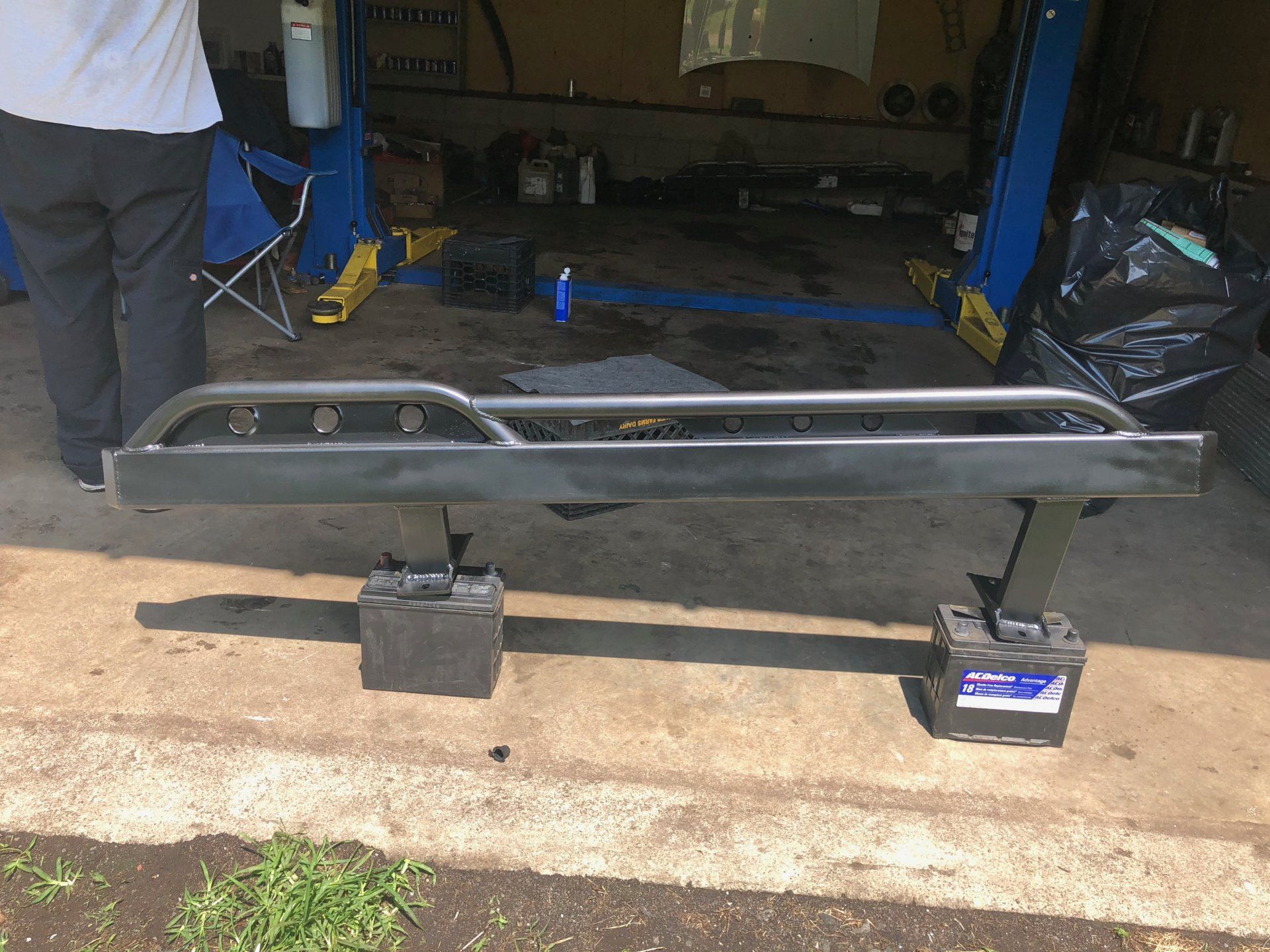

There are no obstructions for the front foot to mount. Route all your U-Bolts before attempting to line up the slider. Mount the sliders loosely with the 12mm hardware provided, make sure the slider is in the right location before tightening everything up. Hand tight.
My front driver side mount.
Front slider positioning.
Rear positioning

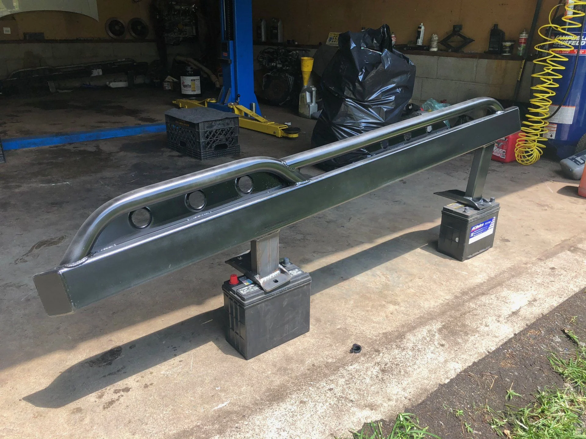

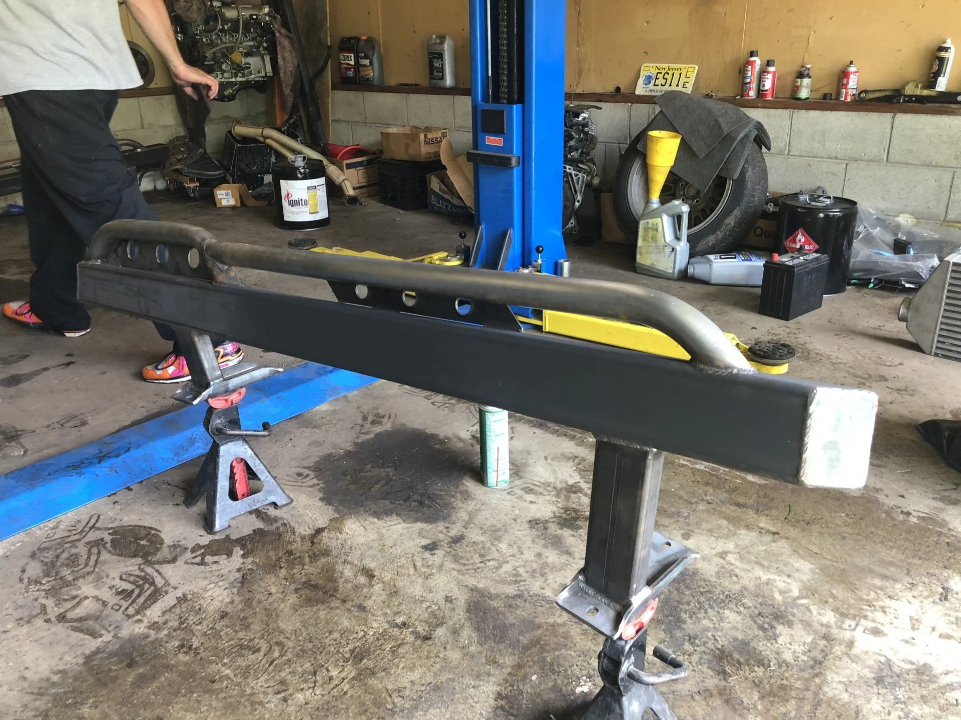

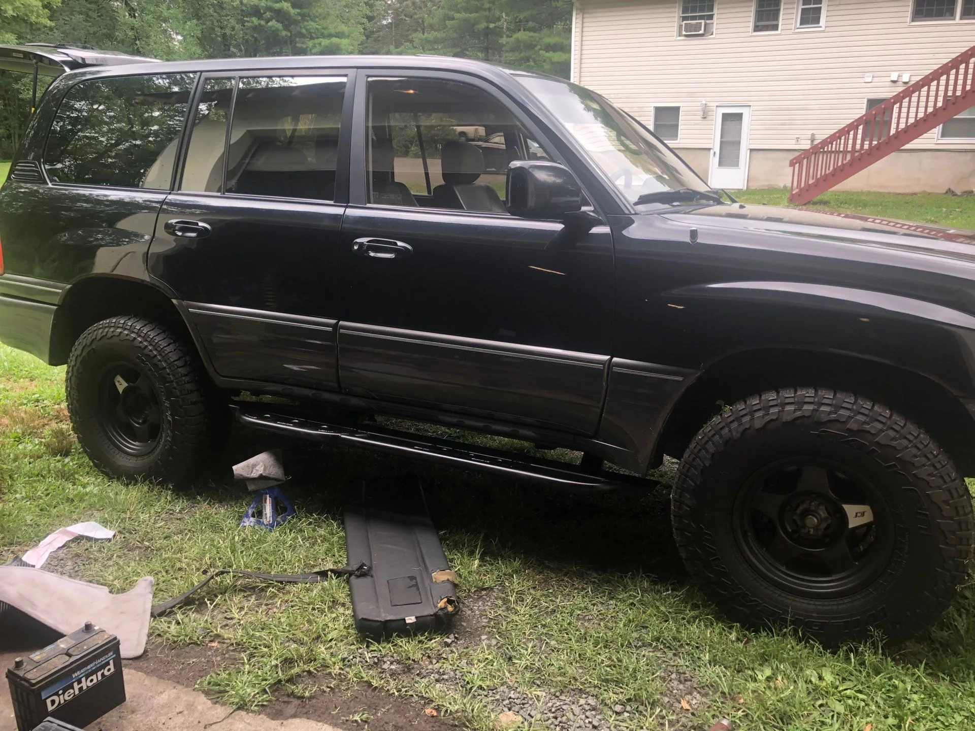

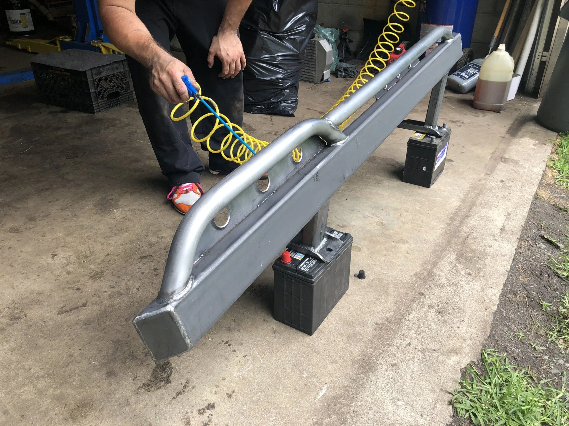

Doing this by myself i found the milk crate helpful, as well as the jack stands on each end. if you don't have these items, another pair of hands would be helpful. Once on the jack stands, the milk crate is just in the way.

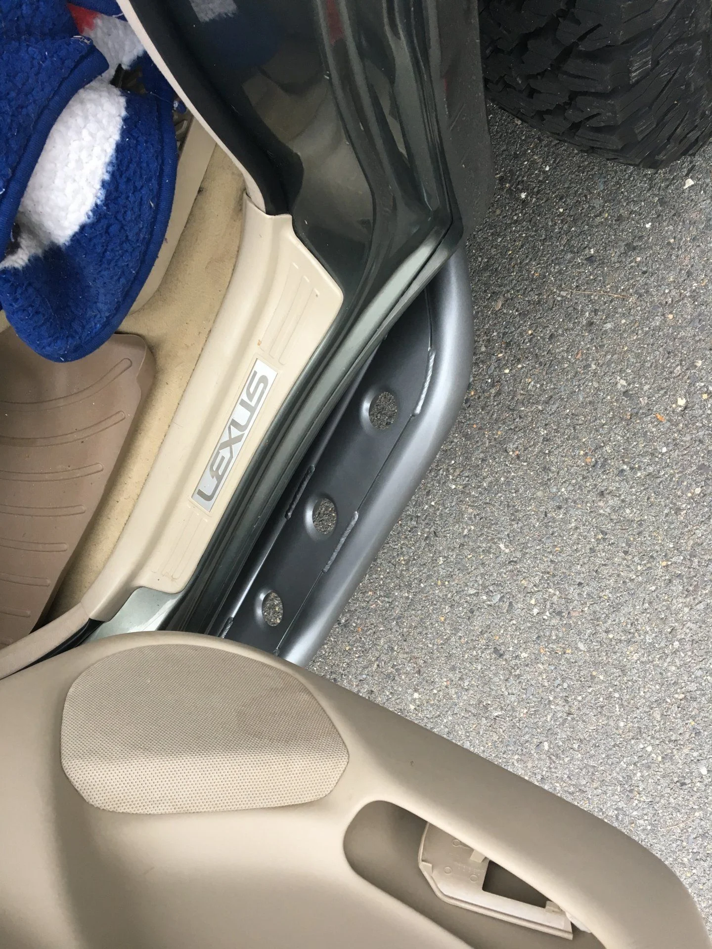

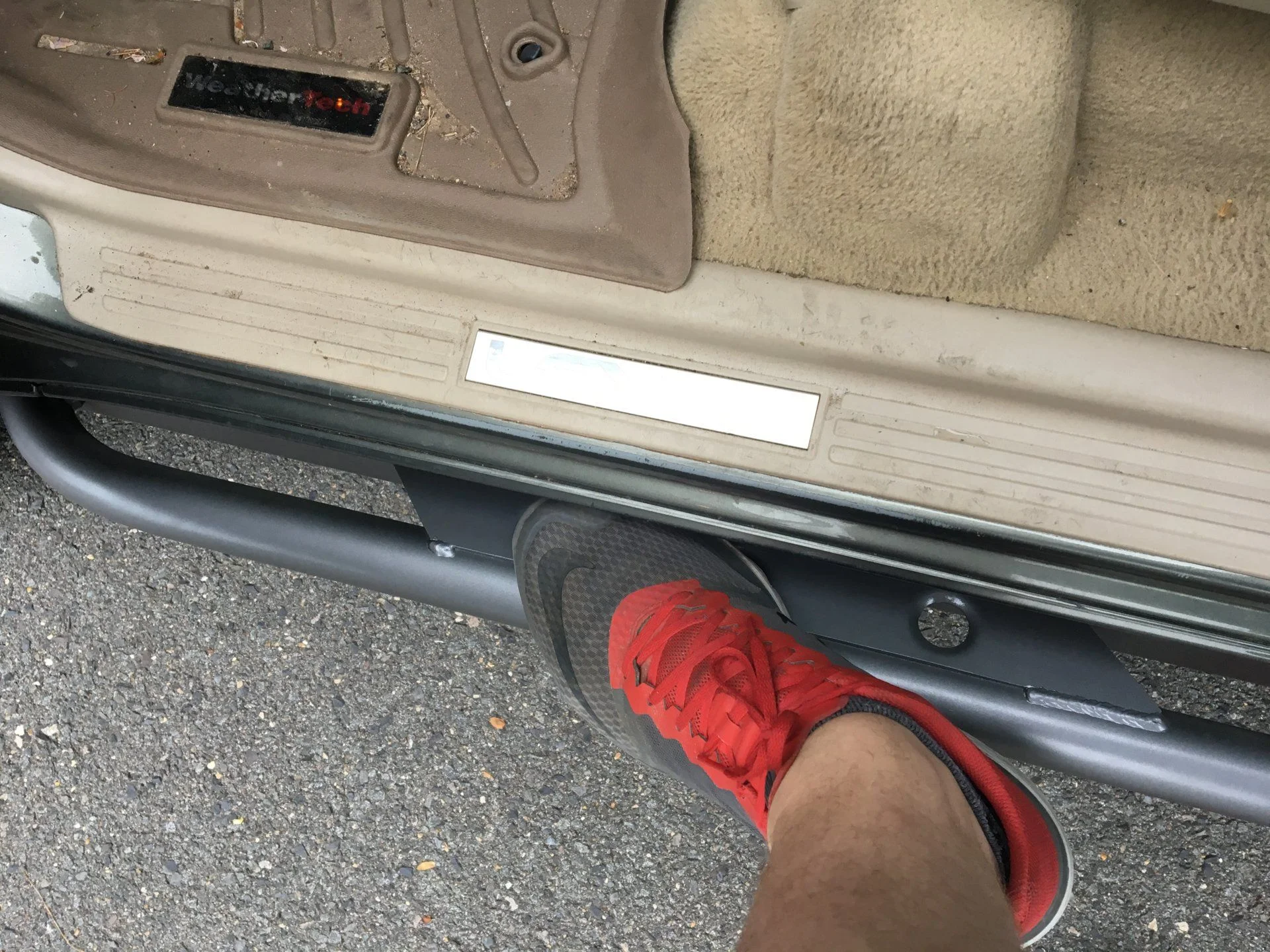

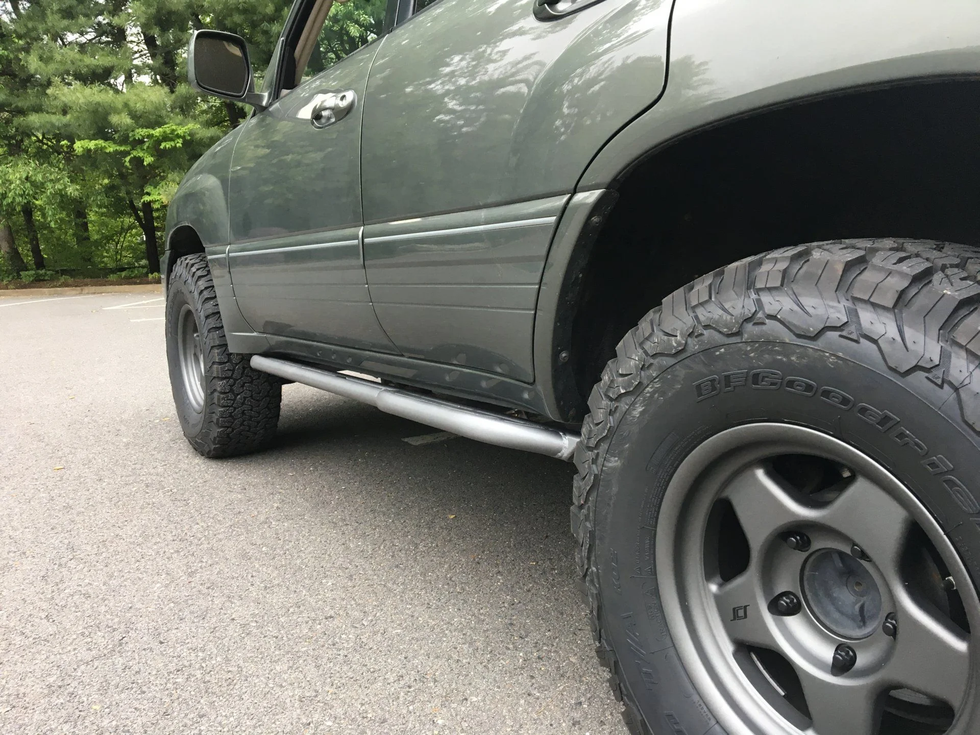

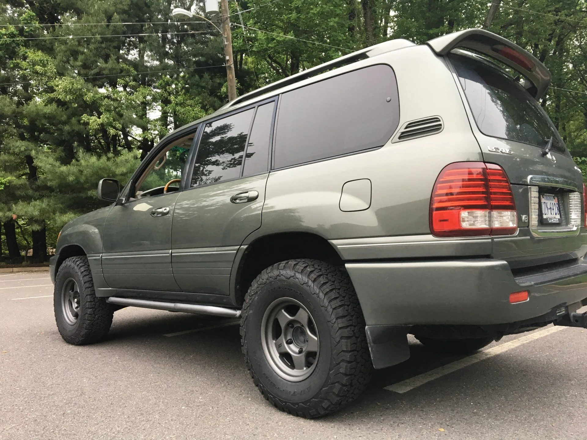

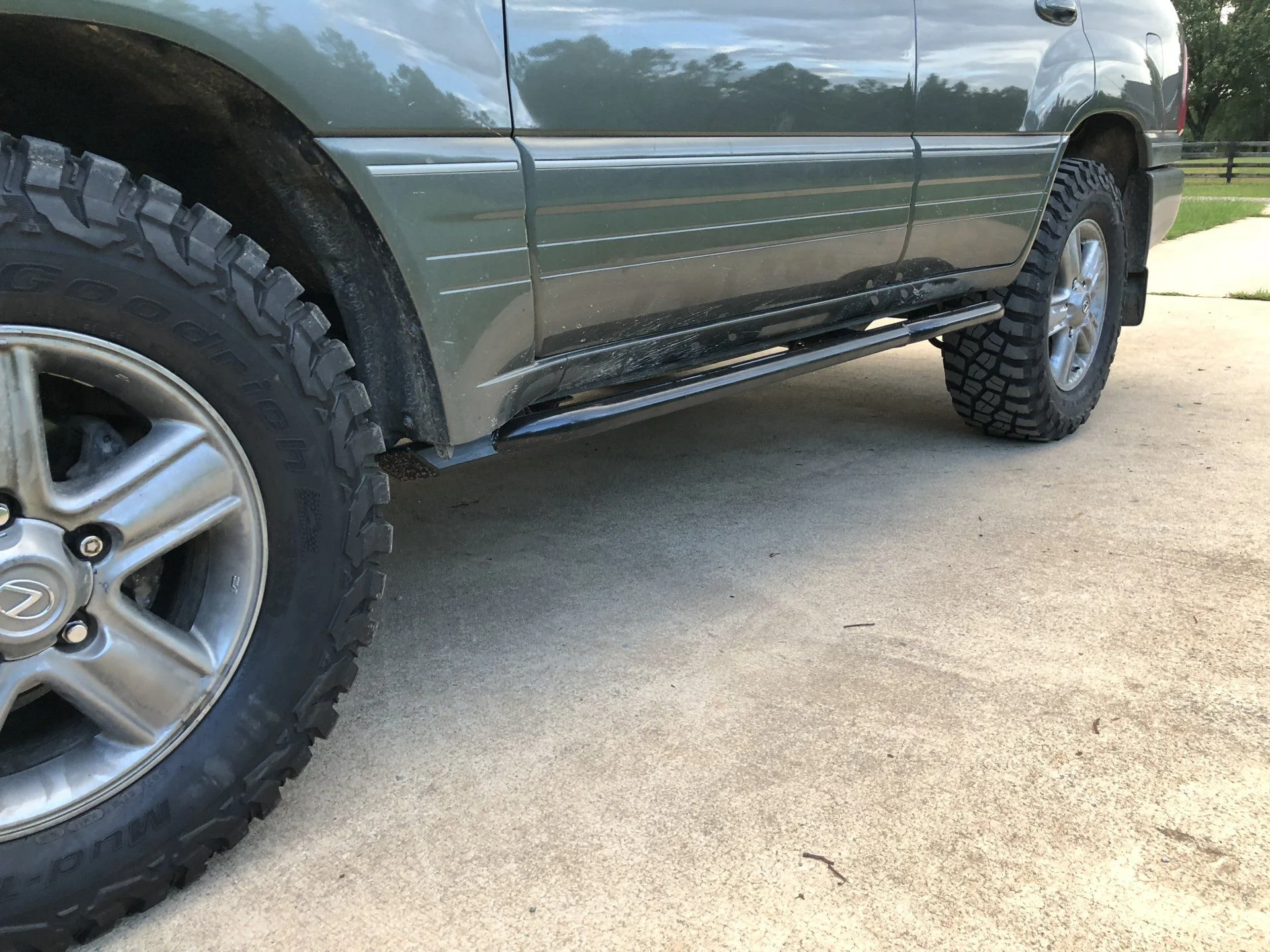

The final product and my size 13 for reference.

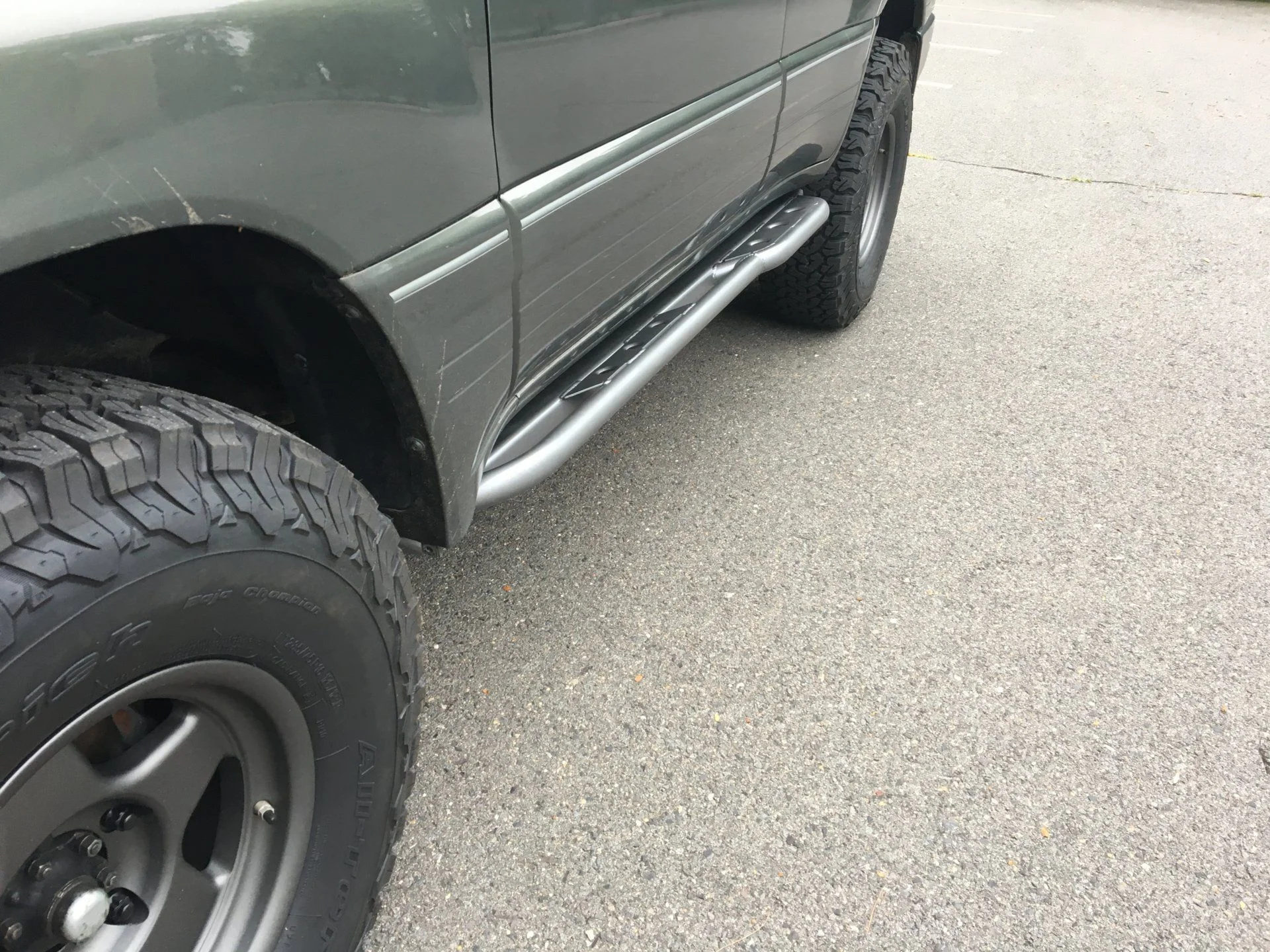

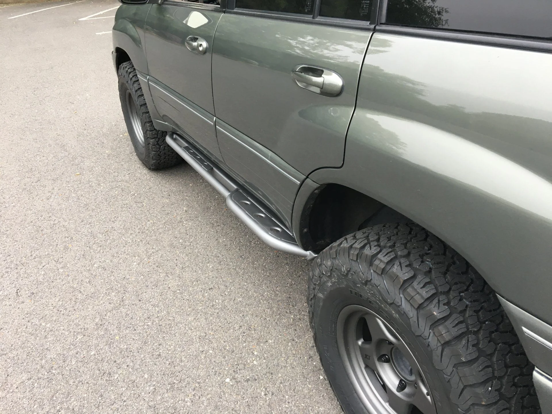

I commend you for not painting the sliders black like evrevery else, myself included. Skateboard grip take is a worthy addition for anyone using these as steps to get in/out or as a perch to load a roof rack.

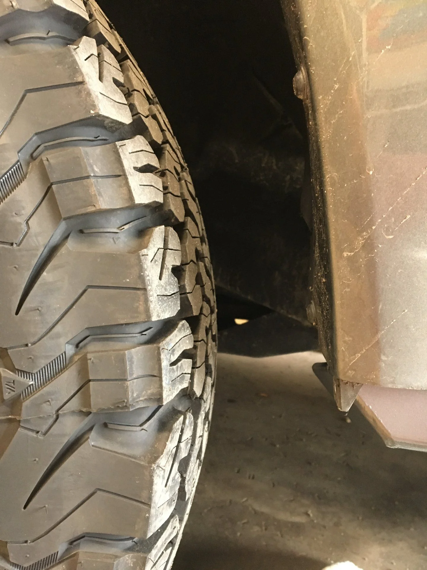

My passengers side slider touched the body and it was noticable while driving. I had to go back in and lossen both front and back ubolts to yank and massage ( tap ) them down with a soft mallet .

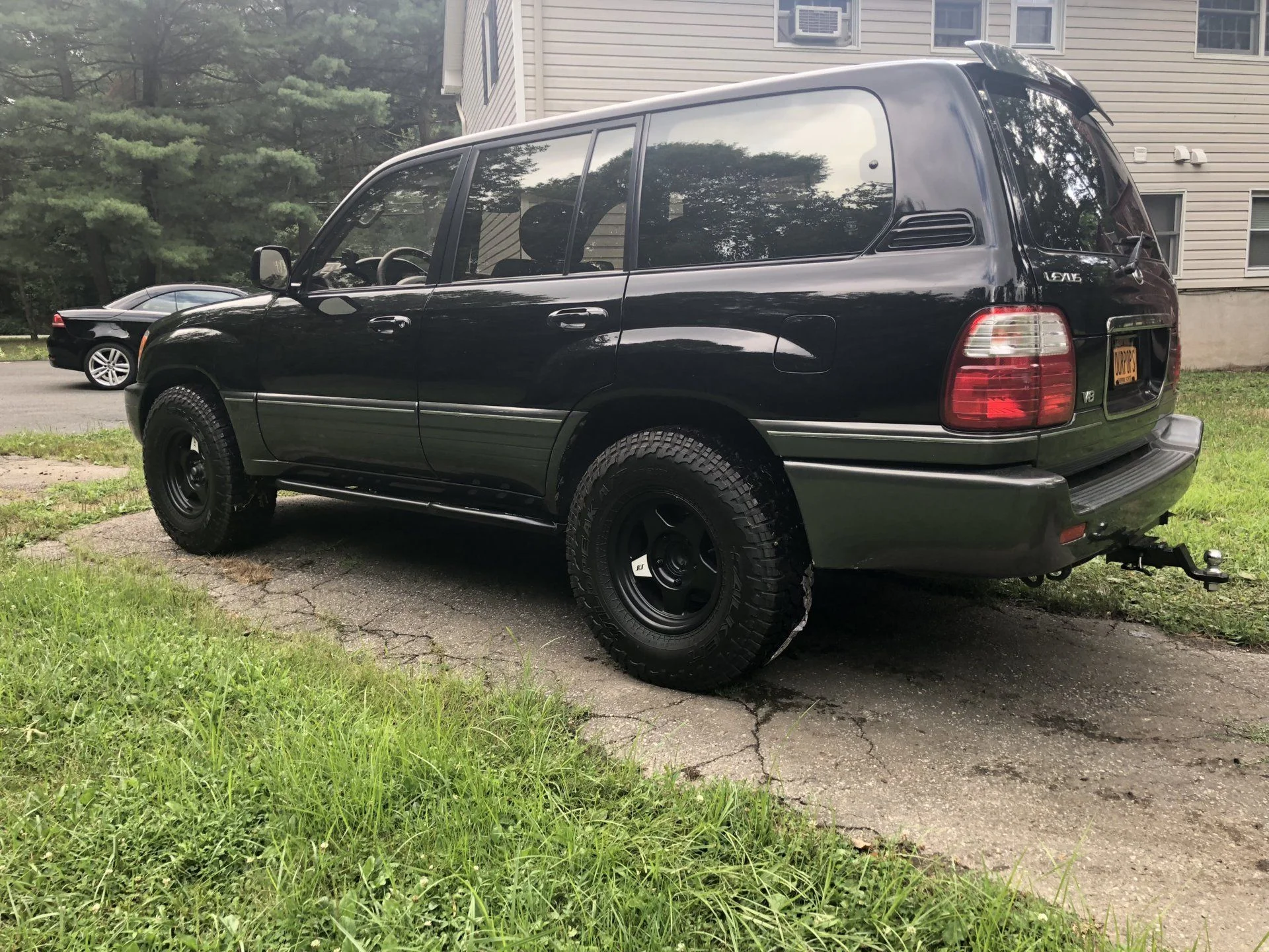

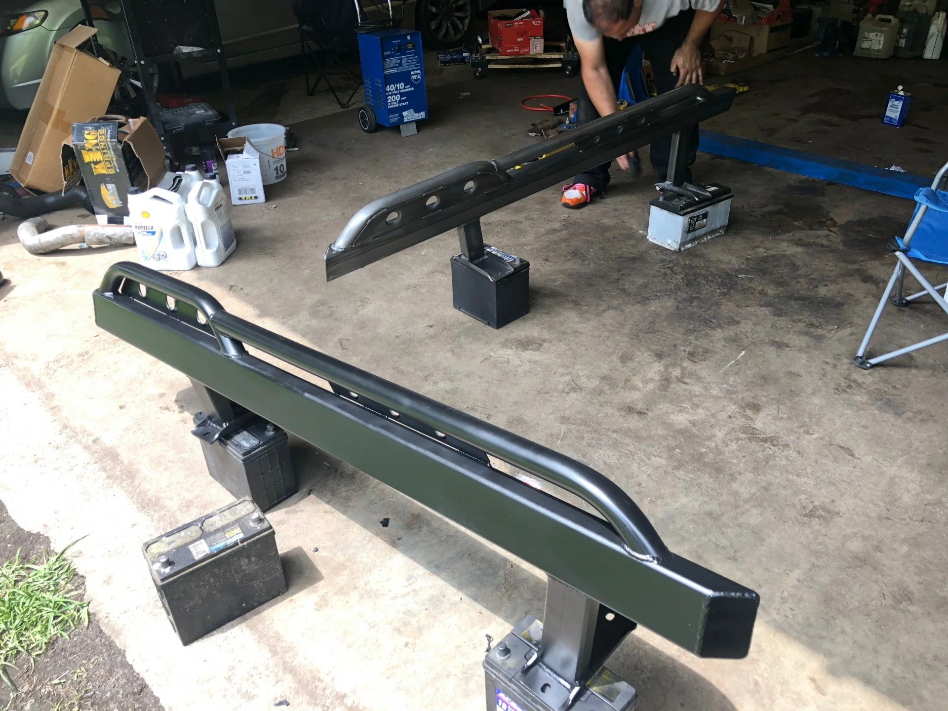

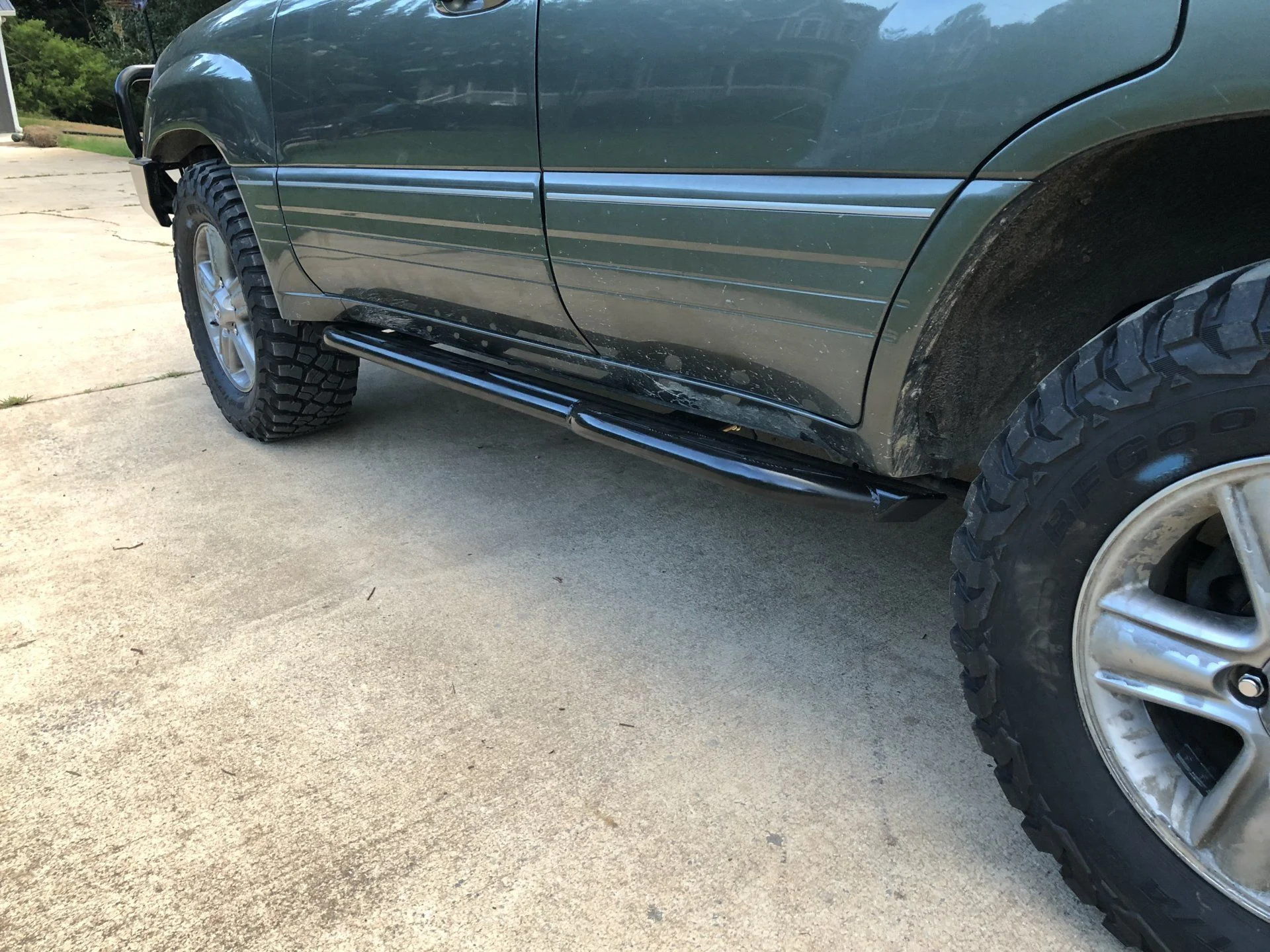

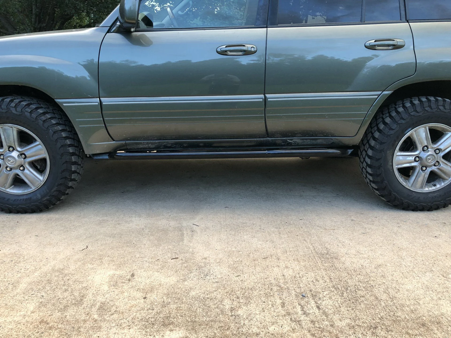

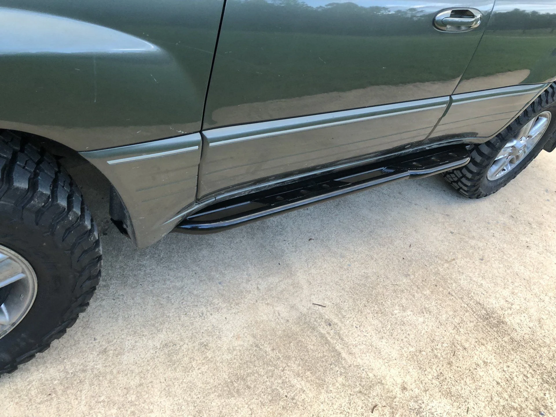

Finally painted mine yesterday and installed today, I have AHC so had to remove the shields and move some lines but not bad. Sliders look good - just a lot heavier than stock running boards so my 1/4 mile times will take a hit
@TTViper Is that a RAW finish sliders installed?
@TTViper What color did you paint them?. I like that color.. It looks more or less gunmetal/ silver
