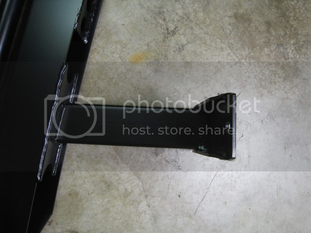

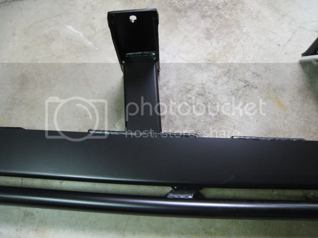

Finally got around to uploading some pics. Most of the stuff previously posted shows them from the outside so here's some better shots of the construction. Note that the legs pass through the gussets so there's not only the weld but also a true mechanical fit supporting the rails. Also note that the rails are unique in that they're a trapezoidal shape formed from laser cut steel that is then bent to shape and welded up.

I wonder why they didn't cup the center sections that attach to the frame. Last night I was reading a thread about an 80 that had MT sliders and the center mounts for the frame wrapped around the rails and bolted at the top. On all the 100 series sliders I have seen, the brackets interface at the frame rails with about .5-.75" hanging down beneath the rails. I think it is referred to as a "rock anchor". I am sure incorporating this feature would drive up costs but MT sliders aren't your run-of-the-mill armor and this would place them heads and shoulders above the competition.
That's a good point Paul. I'm not a crawling guy so it's not as big of a deal to me, but you could probably take both the top and the bottom of the mounting plates and cut them to slope more. They already have a little bit of a slope to them at the bottom so it's not like it's a square edge that would catch, but more of a taper would make a better ramp for rock if they were to get hung on the frame rail.
The rock anchor you are referring to is the MAF caster correction plates they offer for the 80 series.
As far as the frame mounts hanging below the frame out of the 7 years we have had the 80 sliders out on the market the mounts have not been an issue in terms of rock crawling. If you are dragging on your frame then you have bigger problems then a sliders mounts hanging below the frame.
Thanks for the response. Like I said, I have never seen a 100 with them mounted any different from how you or any other 100 slider manufacturer makes them. I just thought it looked cool on the sliders I saw made for the 80. The Metal Tech sliders still look to have the most thought put into the design.

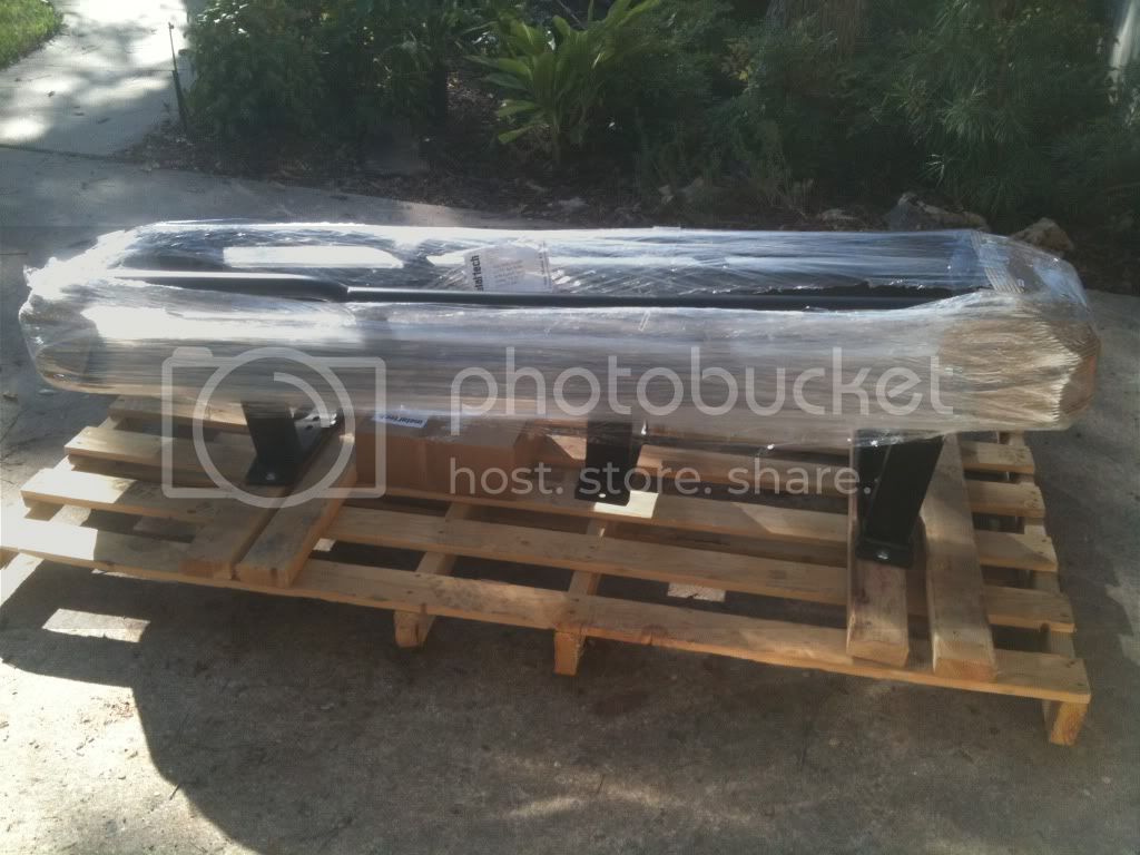

Well wrapped and bolted to the pallet

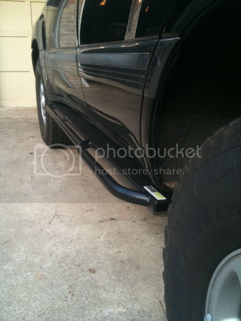

Installed Sweetness!
Im gonna have to get used to setting my foot on them when I get out to keep them from rubbing the back of my pant leg.
