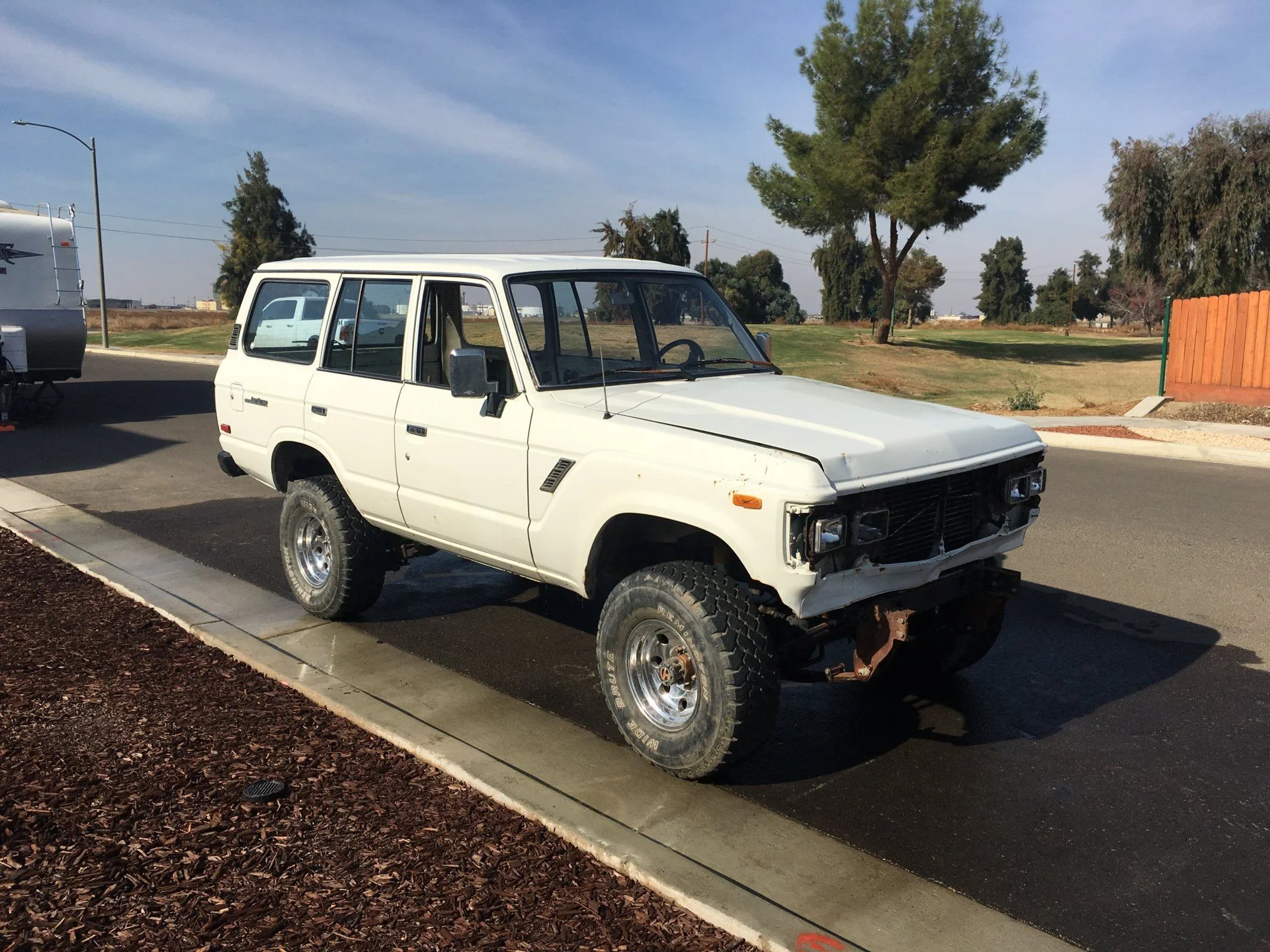

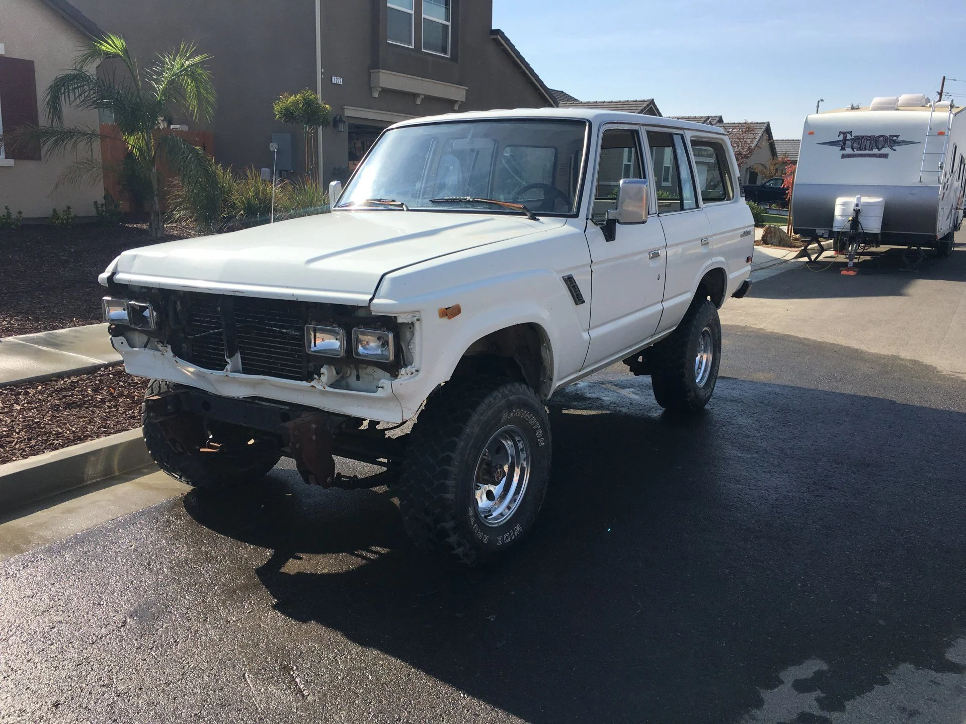

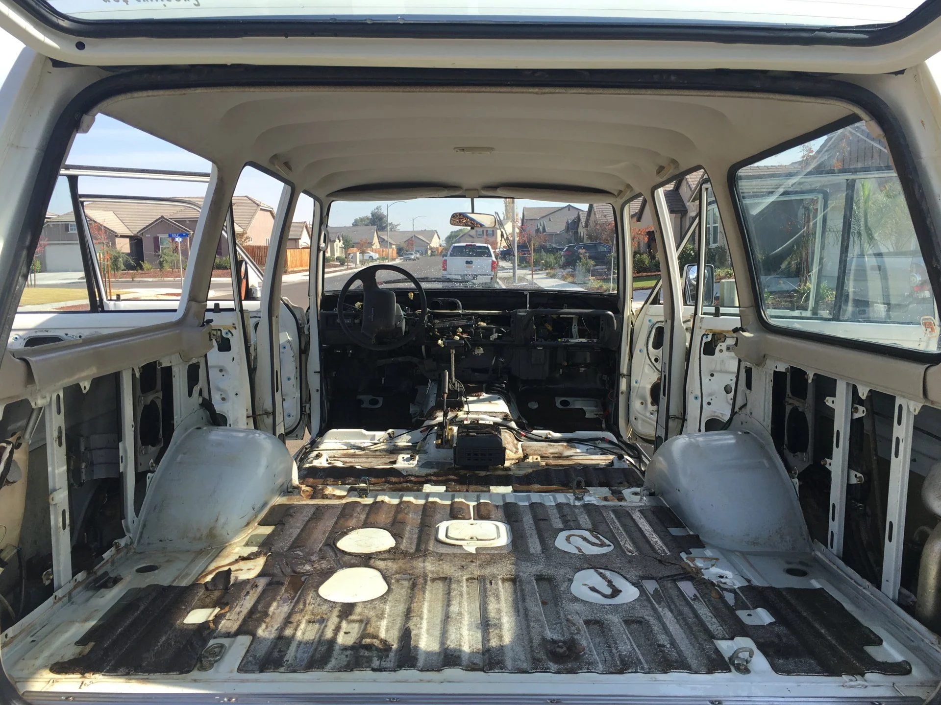

2 pretty solid days of scrubbing and dismantling...it's ready to make its way into the garage.

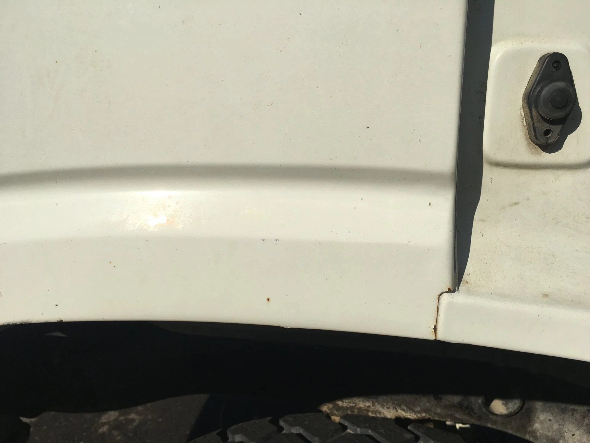

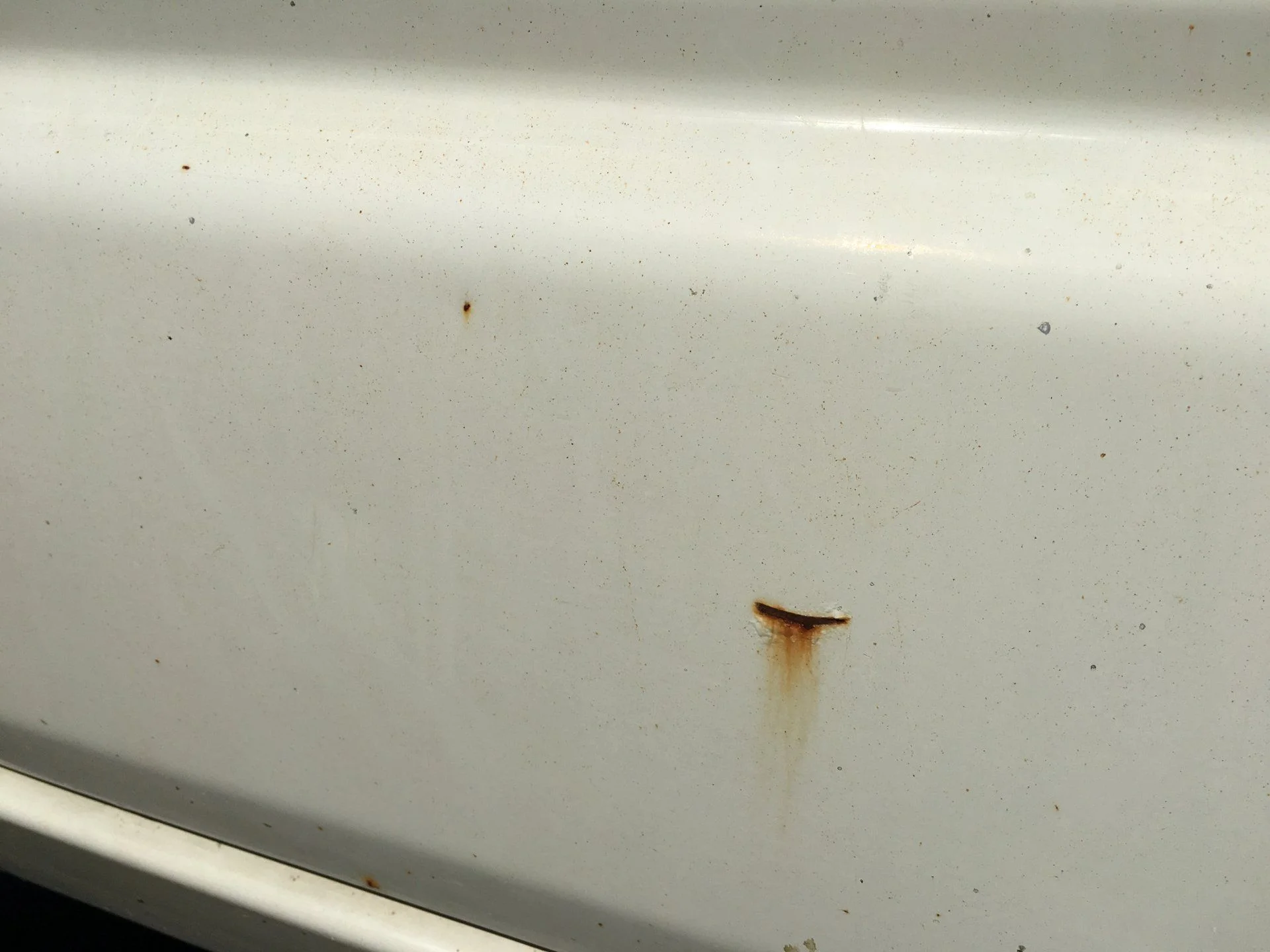

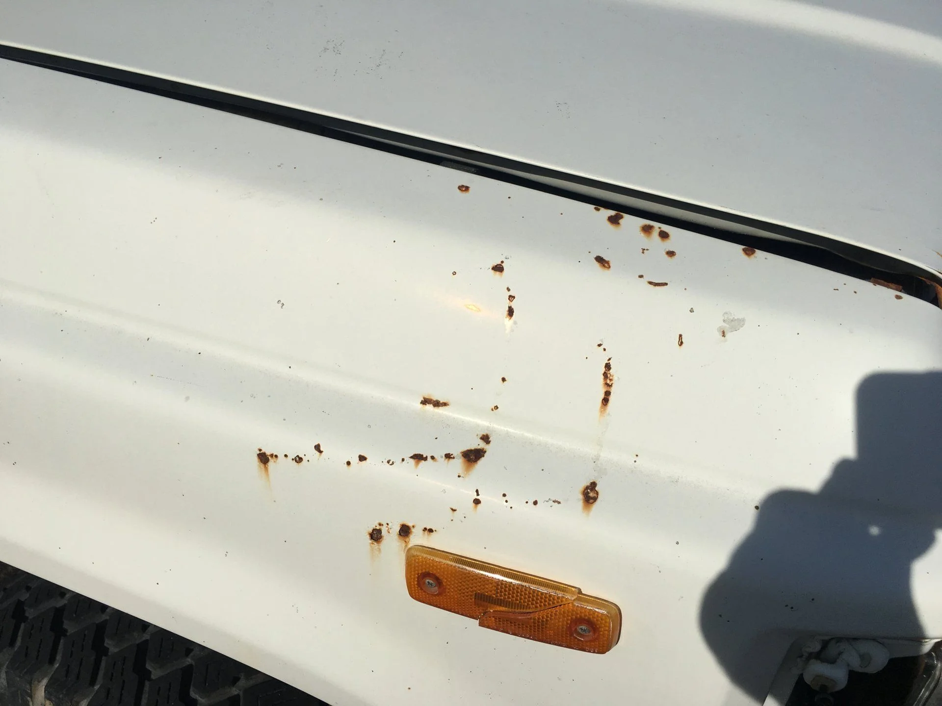

Getting a decade of dirt and funk off revealed quite a bit of good and quite a bit of small issues. There are quite a few little spots like this and who knows what happened to the passenger fender.
You sir are a lucky man. Set her straight... she look like a great truck!
Is that your blue 60 also? Progress is looking good. I hope the mechanical side of things treat you well. That looks like minor Cali rust not east coast cancer.
Yeah, that's my first entry into this madness. I wish I had done a build thread on it.

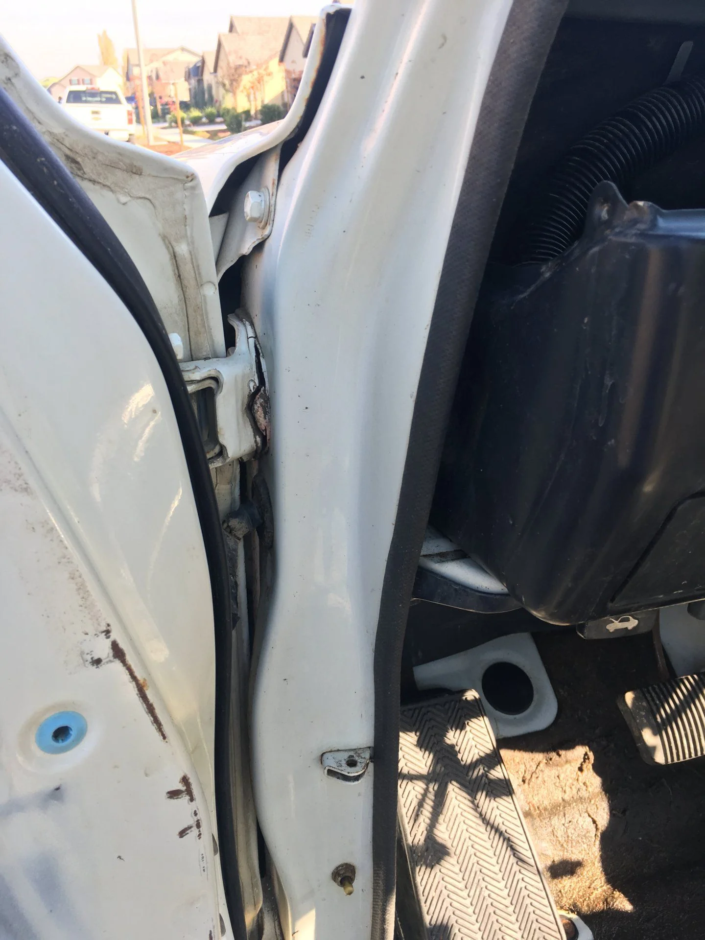

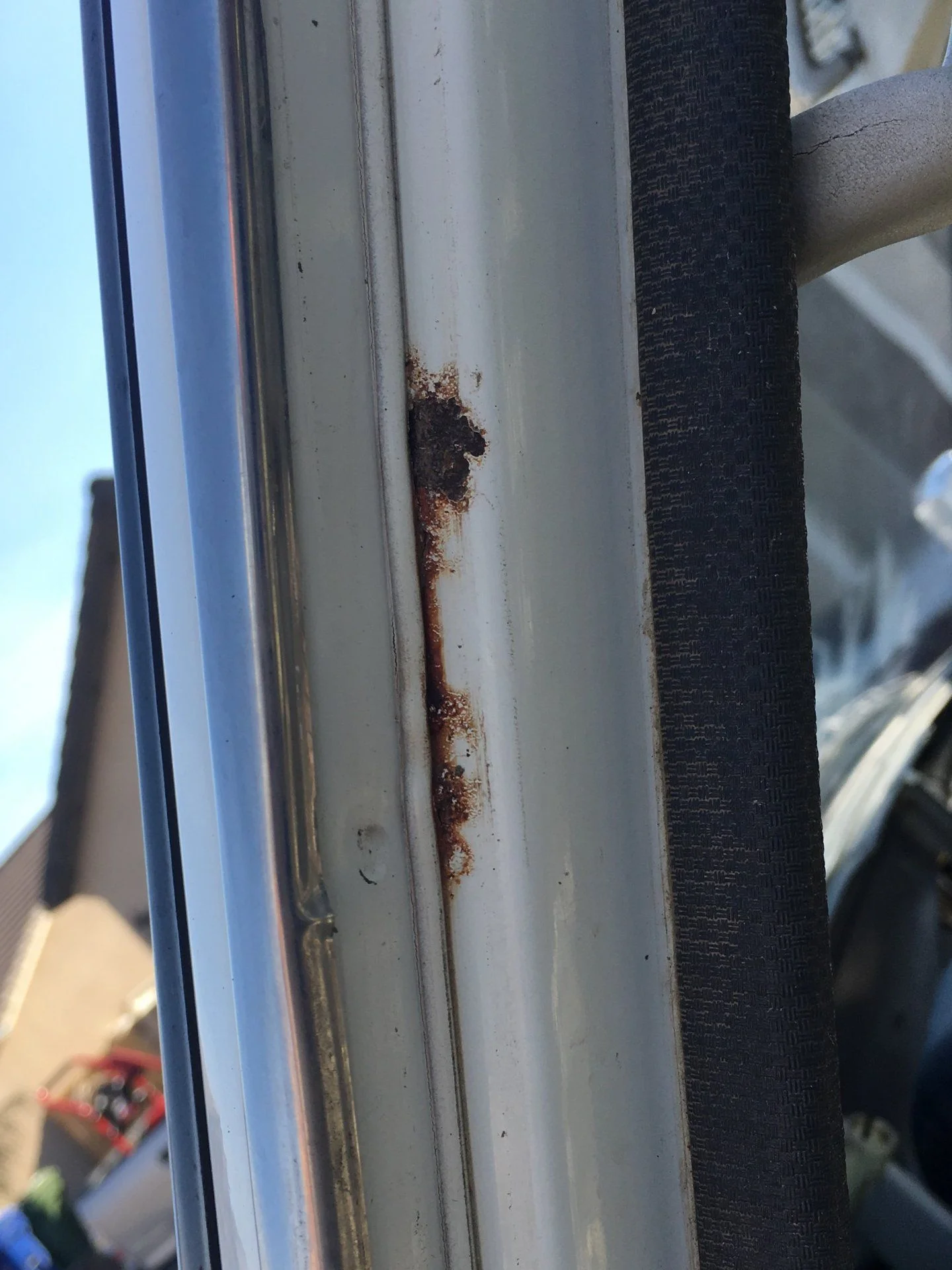

I wasn't happy to find the rust on the pillar under the dirt but its not bad. Overall I'm happy with the exterior.

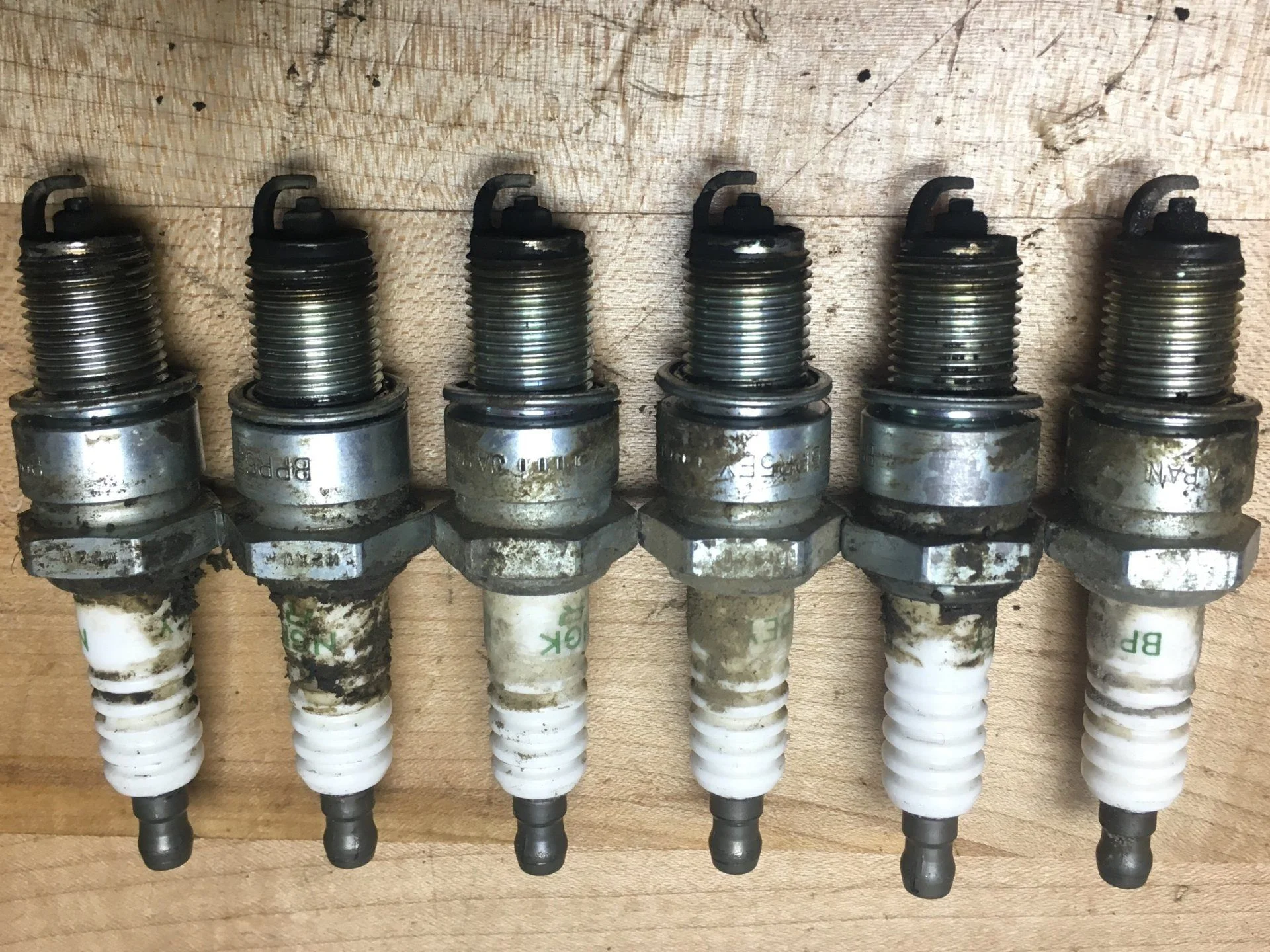

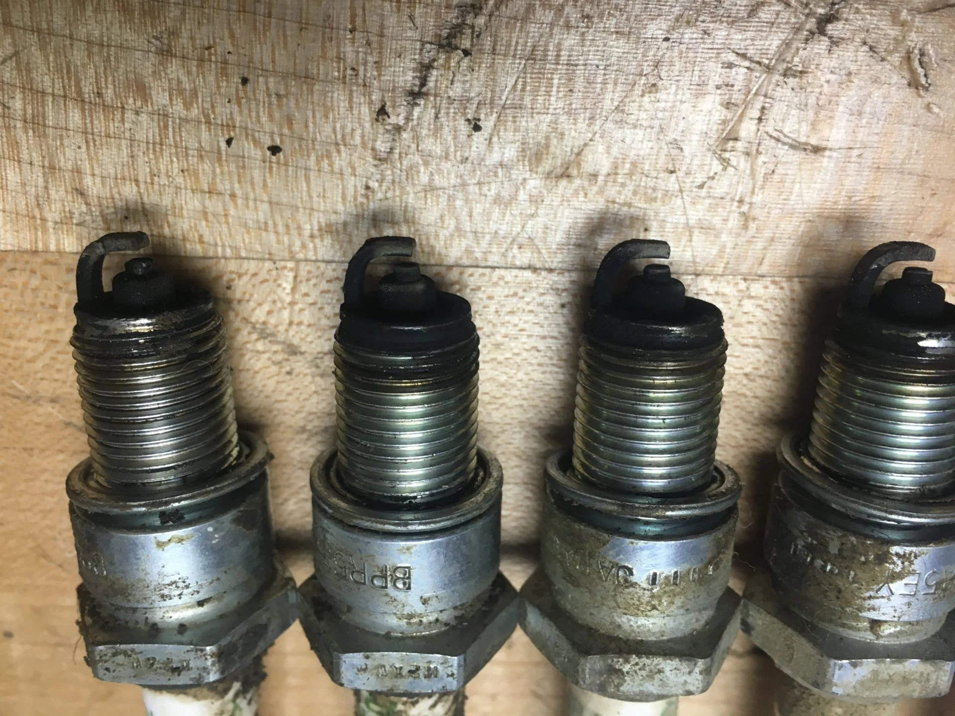

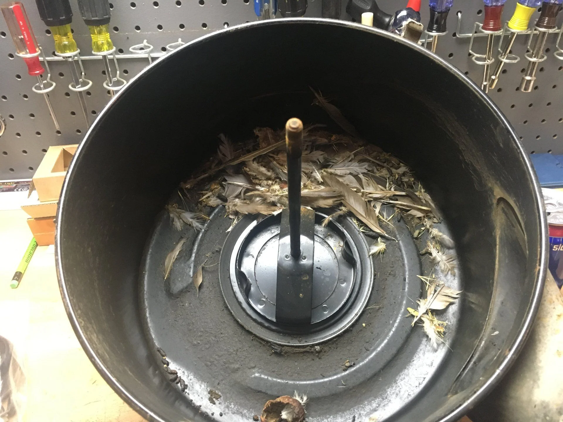

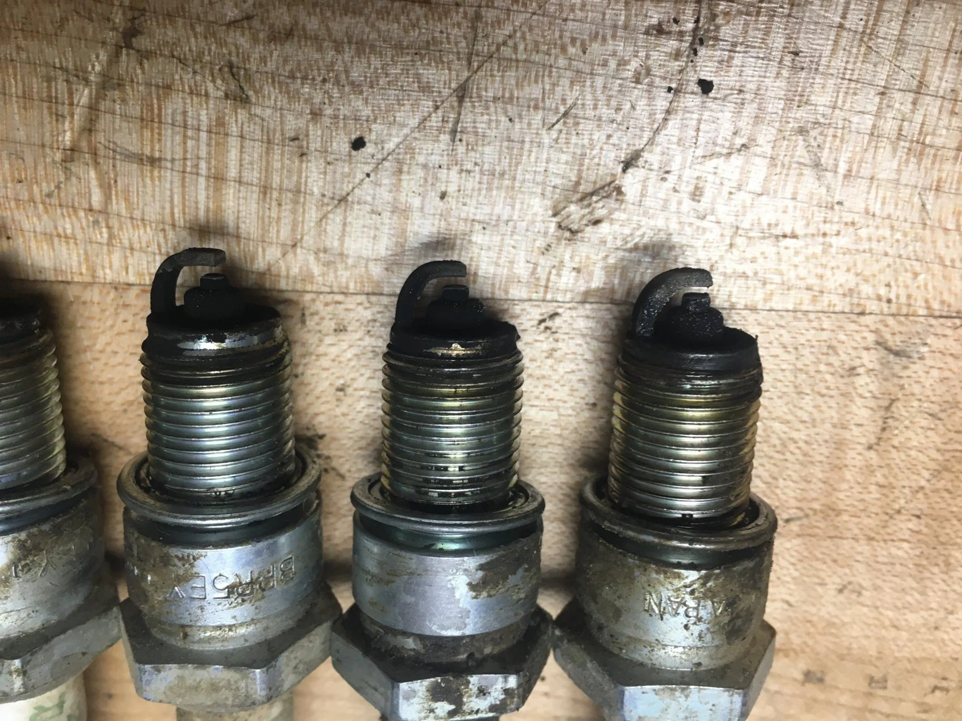

This was my first find under the hood making my way to the plugs...
We will know in the next day or two about the motor, going to check the plugs tonight and maybe get a look under the valve cover.

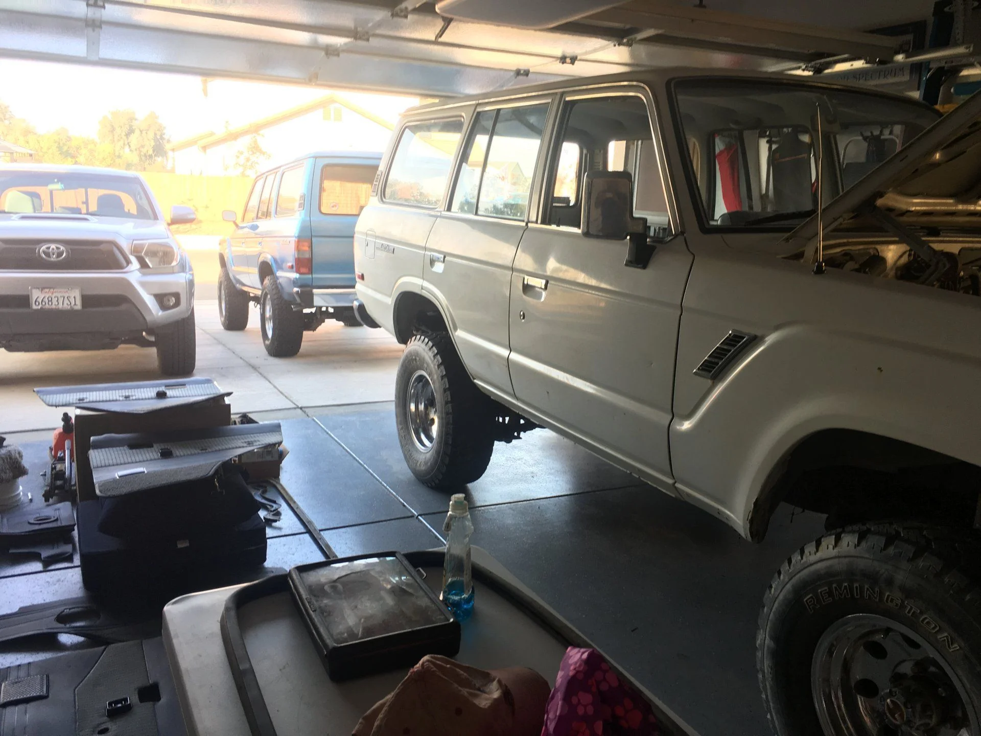

Got the valve cover off, seemed like a good amount of work more than the 2F. Granted my 2F is desmogged for now, have a year to resmog, but I don't see ever getting close to my valve cover off times. It's really cool though how the systems are similar. I'm excited to learn how all this works together.
Removed
Air Cleaner Top and all Air Intake Hoses and attached air hoses, left Air Pump hose attached to pump and swung out of the way.
Air Flow Sensor Connector
Air Cleaner Box, figured the three bolts were worth not having to deal with it in the way
Vacuum lines off Charcoal Canister VCV, removed large line Y from the spaghetti too, left S attached to spaghetti
Just swung all small vacuum lines over onto heater control valve
PCV hose completely
Brake booster line from intake
3 coolant hard line bolts
14 mm nuts
Had to lift up to clear studs, go back to clear the spaghetti, get the front up, swing it out toward passenger side, got the rear lip passed the coolant line, and kind of pulled forward and rolled it out.
This isn't my original order I did things, I didn't remove the hoses from the intake or spaghetti or the 3 coolant hardline bolts the first time I tried to lift it off.
