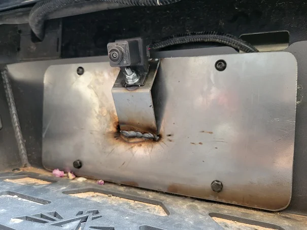

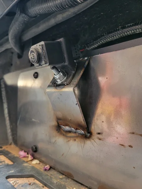

When I installed the rear tire/gas swings I blocked my rear camera which is mounted on the tailgate handle. Long story short is I bought another camera and tailgate harness from Toyota. I teased out the camera wire from the tailgate harness and installed the camera on the back of the bumper where the license plate should go. I went through several iterations, and I'm actually pleased with my current mounting. Yes, my welding sucks.
Me likie. I think this will do. Unfortunately, now I have dash codes for the radar sensor.

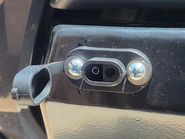

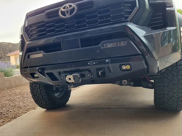

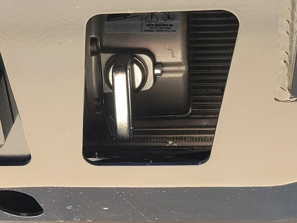

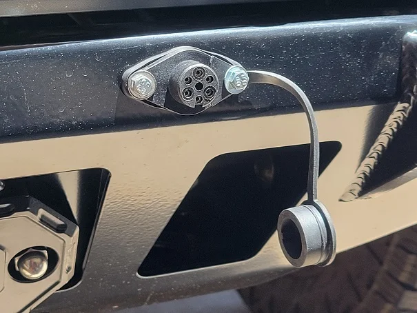

I made two modifications to the front bumper before I installed it. First, I installed a SAE port on the front for my solar panel. That way I don't need to pop the hood and use alligator clips. Second, this style of bumper makes access to the control box impossible. I bought the extension cable from Warn (stupid $$$$) and installed the port on the front. I also clocked the gearbox so the handle was easy to get to.
SAE port for the solar.

Clocked gearbox handle.

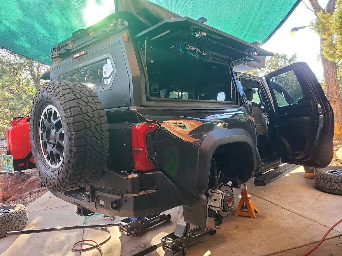

Billy got a tiny butt lift ;) . Beer needs to come out before any work begins in this heat!

Thanks for the assist Ash. Now we just need to figure out why the driver's side is an inch higher than the passenger side.
An inch? You obviously aren't drinking enough beer 😁
Dang that's a huge difference. Let's look at it the breakfast where the ground is level. Might have to have a yard sale and empty out the rig to see what the natural lean looks like. Then stick you inside plus a full tank of fuel then go from there.

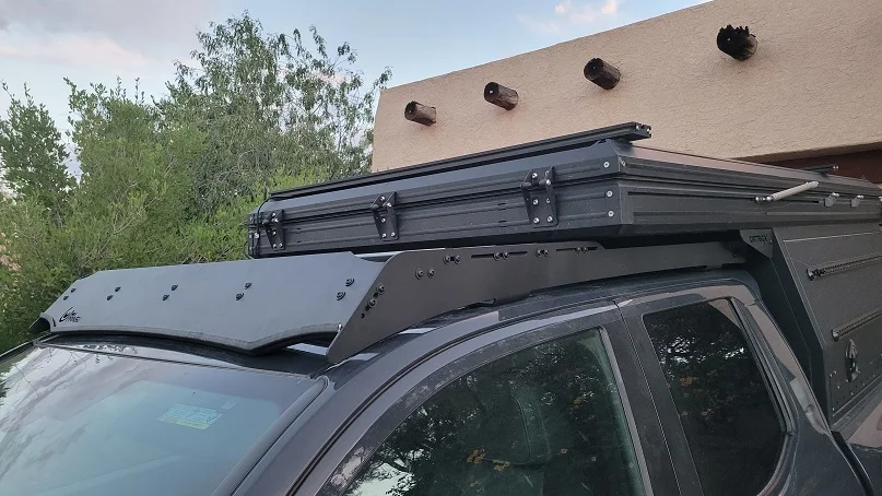

On my two shake down runs in Billy I noticed the camper caused a lot of wind noise. Mostly at the back window. I started looking at options, everything from some kind of deflector on the camper, to a roof rack with a deflector.
From my research there were only two potential roof rack options. Prinsu, and Front Runner. I contacted both companies. FR said not a chance will it clear under the camper. Prinsu wasn't sure. I asked the folks at Prinsu if I could stop by their place in Idaho Falls after the event and see if the rack would fit. They said they didn't have one, and it would be two weeks out. I told them I would be at Expo and would visit their display.

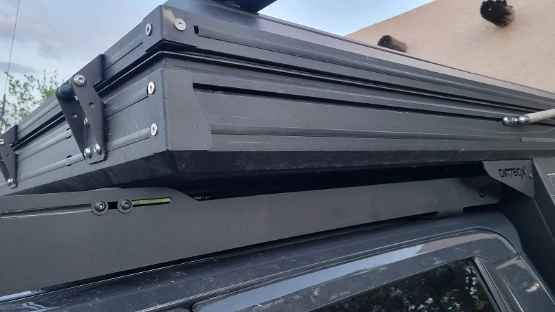

Both FR, and Prinsu, were at Expo in Oregon this last weekend. Looking at the FR I thought it was clear it would not fit under the camper. The Prinsu was going to be tight. As luck would have it, Prinsu had a rack for my truck in the booth. Between the event discount, and no sales tax in Oregon, I jumped on it (~$80 saved). A camp neighbor helped me get it installed. It was tight, as in real tight. It was also a challenge to install the back bolts under the camper. On the drive home the wind noise was significantly reduced. I also saw an increase in gas mileage over several tanks.
When I got home I pulled the rack and modified it to clear the camper. Much better, though I might need to tweak one corner. One advantage to the Prinsu rack was it allowed me to move all of the crossbars forward.

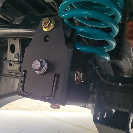

After Ali helped me with the rear springs he educated me on coil spring suspensions. He had two suggestions. First, get skids on the trailing arms. Second, correct the angle on the track bar. As much as I give this fella crap for spending other people's money, he was right on these two. Thanks Ali for shrinking my wallet, but also helping me build the truck right.
Track bar correction kit from Dr. KDSS. Looks level to me.
DV8 skid plate on the forward trailing arm mount. I probably should do the rear too, but they can wait. I was dragging the fronts in Utah, which Ali noted.

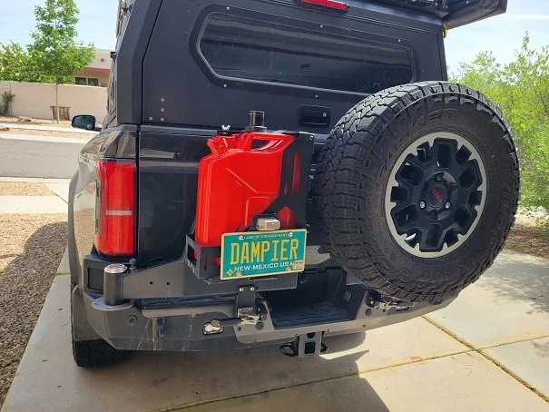

The other project was remounting the gas can carrier on the back bumper. By design, Victory 4x4 bolted their mount perpendicular to the swing-out. I really didn't like it, so with a little measuring, drilling, and new hardware, I mounted the can flat on the swing-out.
Another victim of mine, baaawwwwaaahhaaaaa :flipoff2:

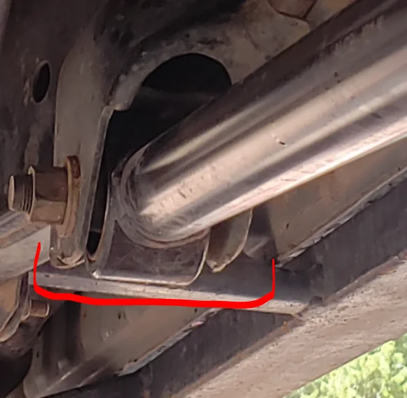

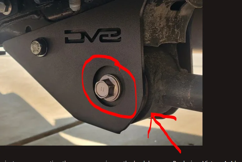

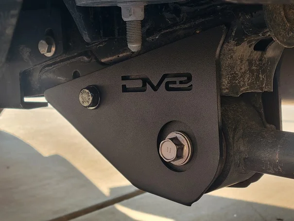

I love how the bolt sits inside the protection system (circled). This is a key piece of detail that I think other companies might ignore. This puts the hardware exactly where they belong after they're torqued down.
Incidentally, there is a second way to protect this mounting area from rock rash, and that's the route I took on the 80. I bought a set of lower rear trailing arm with an extra large eye (arrow) so it hits the rock first and lifts the vehicle up and over in order to not hit the mounting solution. Second pic is from my 80 and you can see the larger eye.
There was another reason for recessing the bolt head. It's hard to describe, but essentially, they had to double the metal in that spot to accommodate the design of the factory mount.
My 4runner probably has a similar recessed mount and the skid protection I got from Eimkeith doesn't account for it. I need to mimic your design before installation.
