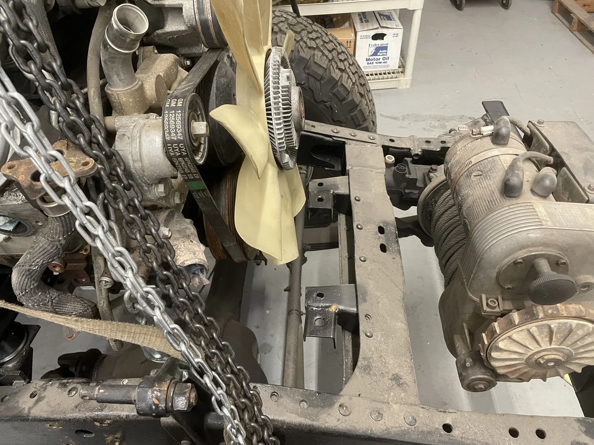

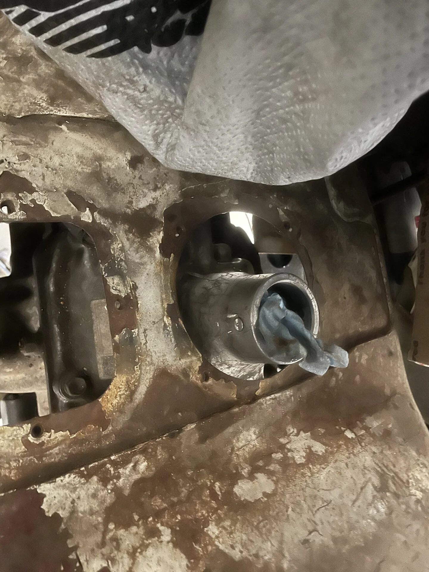

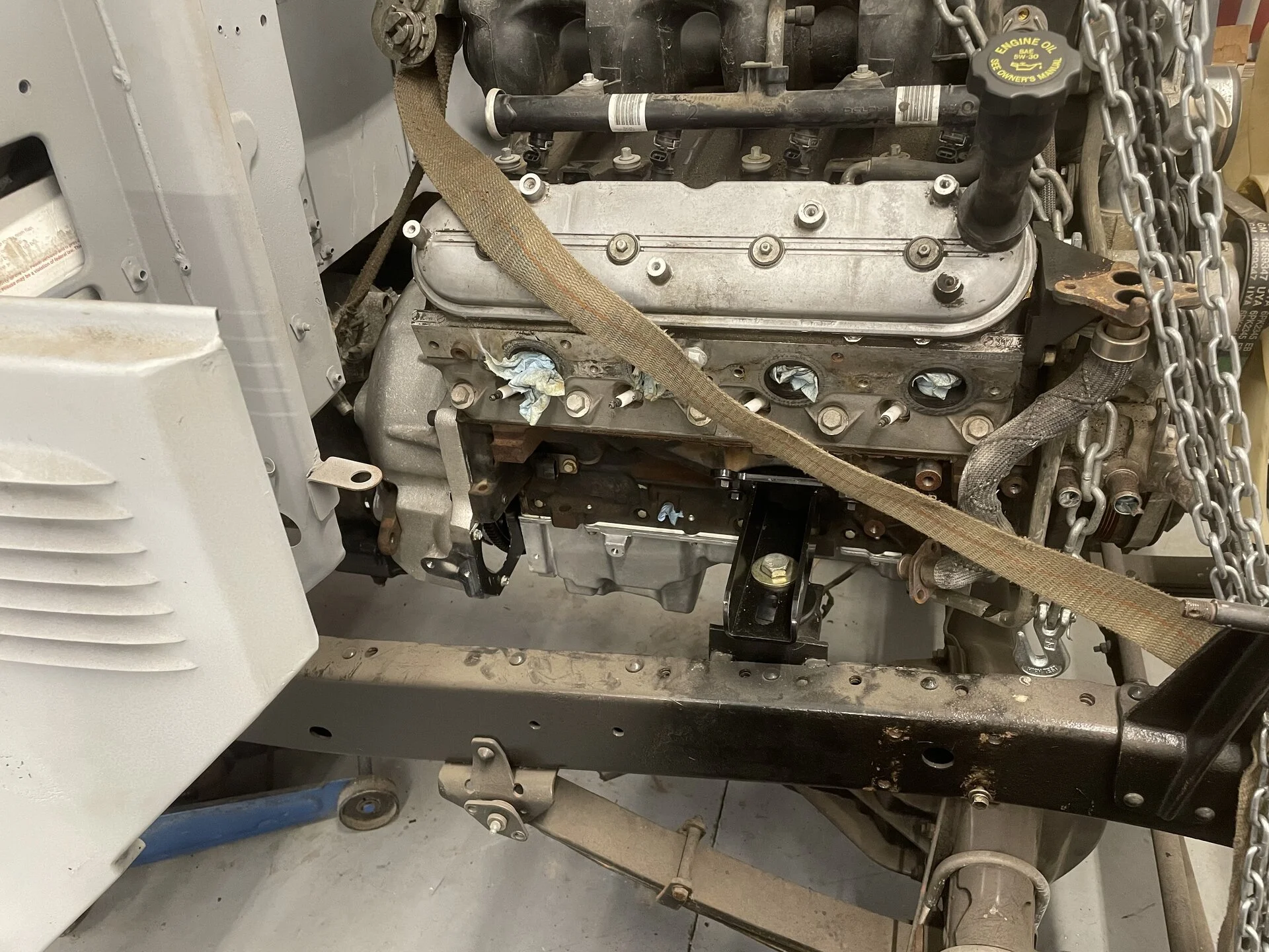

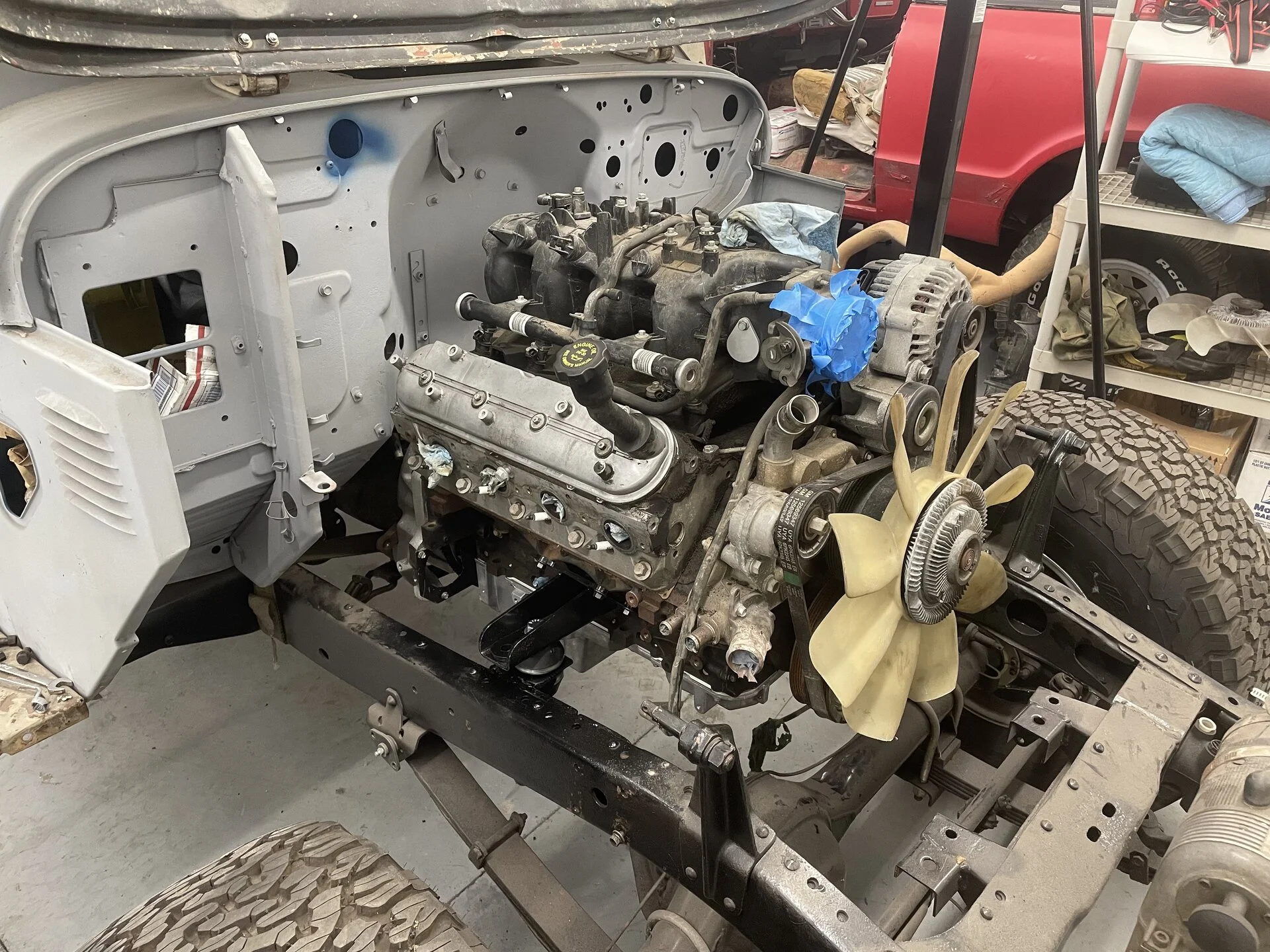

So much for a bolt in swap! Engine sits a good 3" too far forward from the 350. Looks like I am going to cut the mounts out and move them back a bit...
With the 60 series top plate on trans, shifter should come out about in stock location..

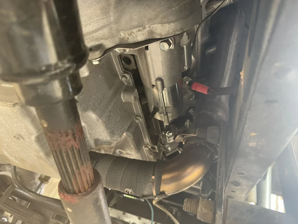

Really hard to get any good shots from the ground:

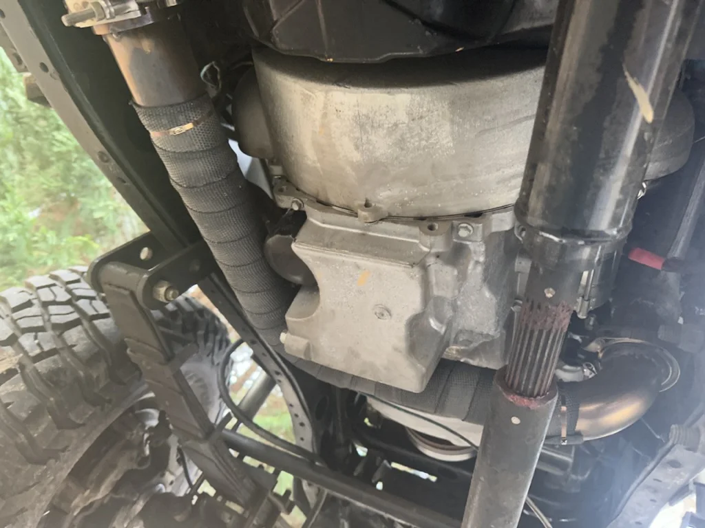

This is the passenger side manifold and how it drops straight down and across the oil pain just in front of the sump:
Despite an RTI ramp telling me there was clearance, you can see where the front driveshaft kissed the exhaust wrap first real wheelin' trip.
This shows how the p.s. collector turns back and the v-band at the top left is where it merges with the d.s. dump. Hard to see.

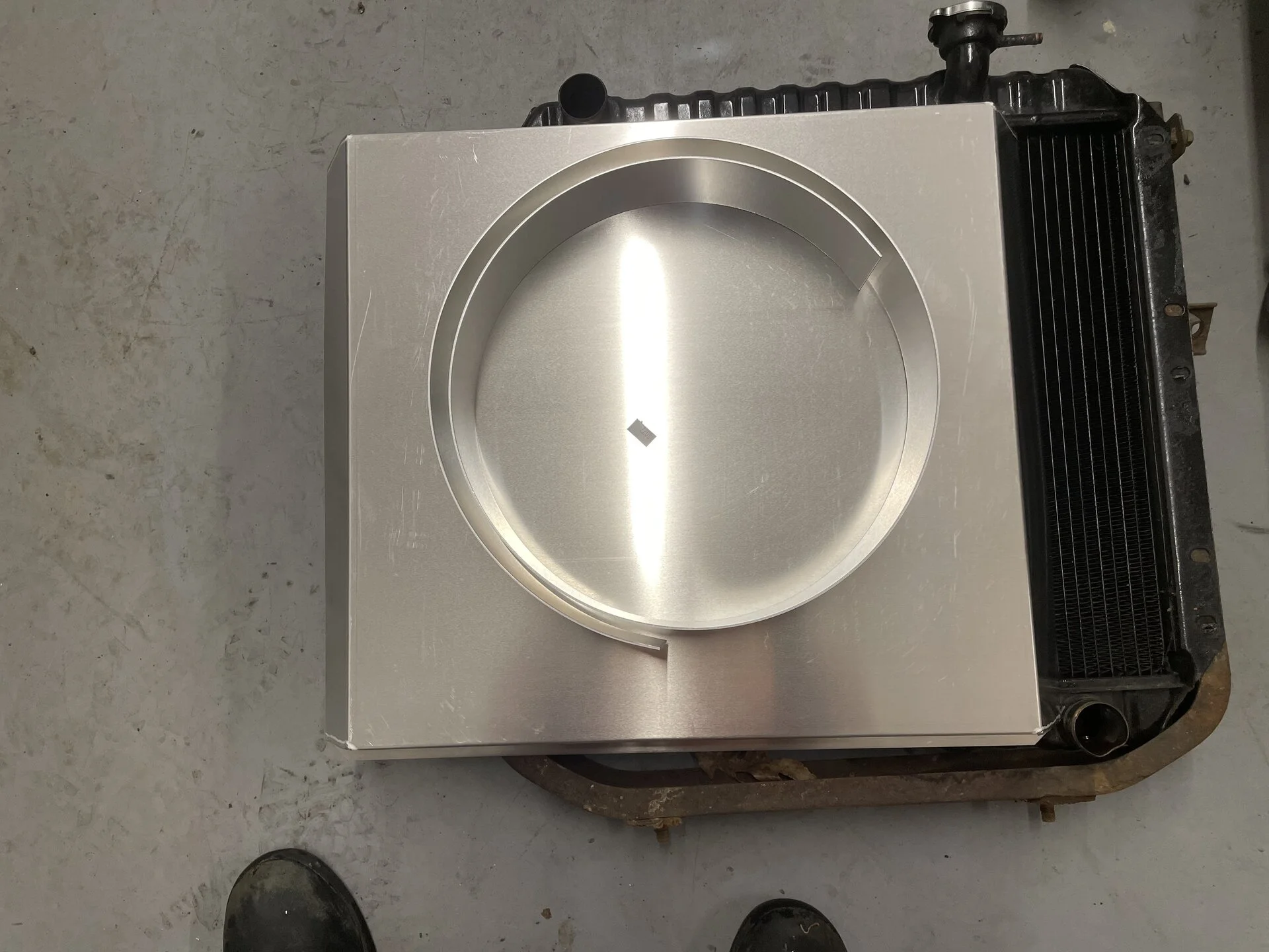

I have the 3 core version without fan for my 350 swap. I still need to build a shroud but saw this with the elec fan option. I really do like the mechanical fan for simplicity.
I need that manifold on the ps side, my rear dump gets in the way of the starter bolt and has another 90* bend, I'd like to replace with that one you used, C5 manifold, correct ? Looks like you added a short down tube to it ?
Yup, exactly. The c5 don't dump straight down, but that's fairly easily modified and I added v-band clamps at the same time.
my front driveline has exact same stop point going up, my oil pan skid sheared the zerk off and as the skid and dline are parallel and flat its a good fit, they never rub because mt front diff dont go up that far but the dline clearance and u joints can so its good, mine dont rub exhaust cause mine is smaller tube 2.5, i wrapped it too. I had to build a heat shield for the clutch slave as it sits on top of the collector on ds. I am wanting to switch to 3 " so this is a good map.

Do you have any problems with the exhaust cooking the crap out of your oil pan? I’m with you. I don’t see any other way to route the exhaust on my truck too. I’m using Hooker manifolds from Holley and then I picked up a new swap pan from Holley too.
Maybe not ideal, but I didn't see any option on my rig either. So I header wrapped that section. I guess we'll see in about 10 years if it's an issue, hopefully not sooner :D

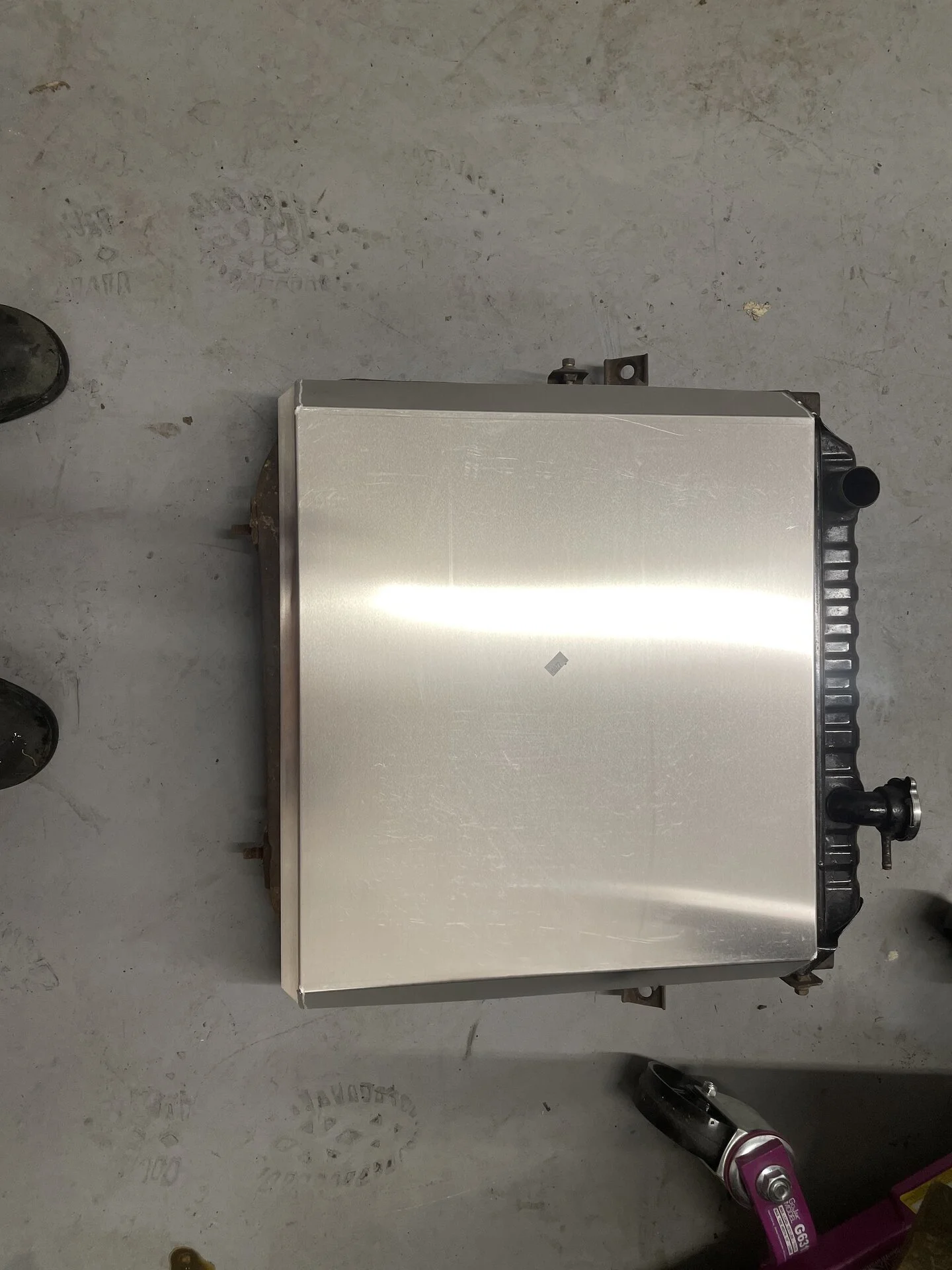

So I ordered a couple of fan shrouds from Summit but they made them wrong. Flange on wrong side. They are going to remake them. I will notch for lower radiator hose and hope it works.
