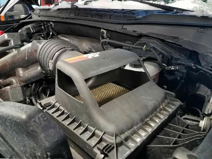

That intake/air box system looks like it’s choking the motor anything is better than what it is now.
Easy fix:
