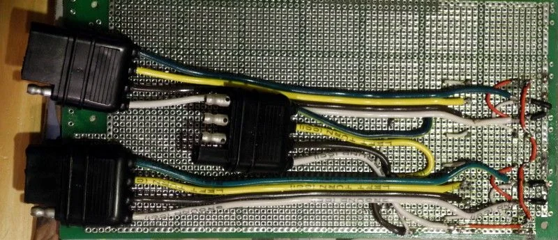

We tested the controller and both channels are 100%. I cut it down to size (4"x3"x1.75") and got a metal box that it fits in, so I have to mount it, connect it to the switch (headlight switch) and figure out where I'm going to put some "locked" indicators. They're either going into the OEM triple indicator for belts and brakes, or maybe right into the face of the headlamp switch if they'll fit. I need to find some 12v LEDs.
I've been working on hand controls on the shifter for the throttle and the lockers. Not sure if I'm going to continue to work on them or punt for this trip. Depends on when I get my carb.
My new Napa clutch master is leaking, so I'll probably have to swap that out before I go, and the Rubicon thread guys told me I should have a proper spare tire mount instead of strapping it to my cage, which was my plan. Lot's to do...
Ok, Marvin has two working e-lockers; ready for Rubicon. We'll add some grease to the knuckles if the stars align this evening.
The controller is in the aluminum box, which is now mounted to the floor and cowl below the passenger-side kick vent. The wiring is under the floor mat, kind of messy, but out of sight.

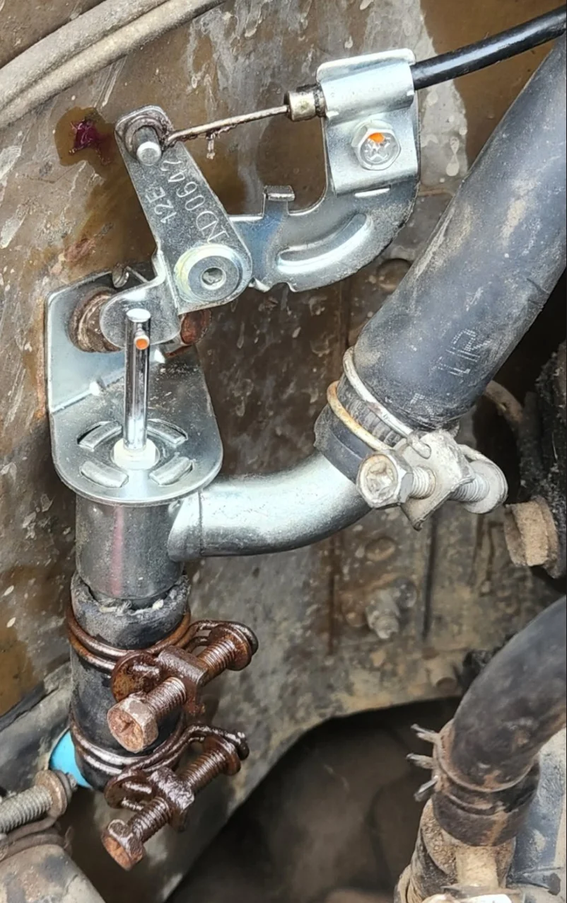

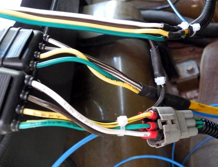

This is the wiring between the switch (an FJ40 headlight switch) and the controller. The rear locker is connected to the yellow 5-wire trailer cable. The rear locker gets it's ground from the chassis at the back.
The front locker uses an OEM harness I got somewhere. I used crimp connectors stuffed into the OEM connector so I didn't have to cut it off.

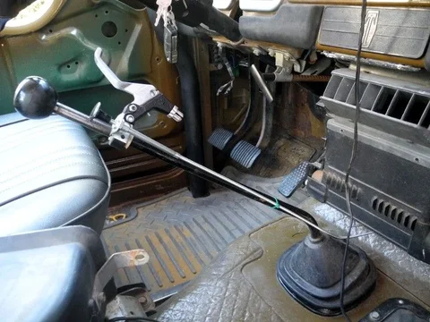

It is actuated with a choke cable mounted on the gearshift where there is also a hand throttle. It looks pretty hokey, so I'm not sure how long I'm going to keep it. It seems solid, but will depend on how it all performs on the trail.
So the parking light position engages the rear locker, and the headlight position engages both? Pretty slick.
Yup.
After wheeling this setup through Rubicon I find it hard to believe that everyone isn't running something like this. I can disengage the lockers just as I crest an obstacle without taking my hand off the throttle or wheel. I am sold.
As an alternative to the brake lever, some have used a smaller thumb shift lever mounted to the stick shift. I've not done it... Yet.
