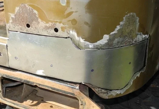

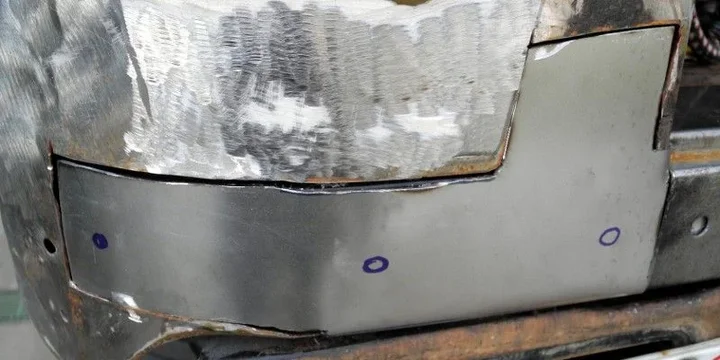

Here are the patches I made from 16ga sheet metal over the weekend.
Left side:
Right side:
Little 1"x3" spot on the right, to the right of the amby door hinge where it rusted at the back edge of the wheel well. I drilled a hole to attach it to the wheel well.

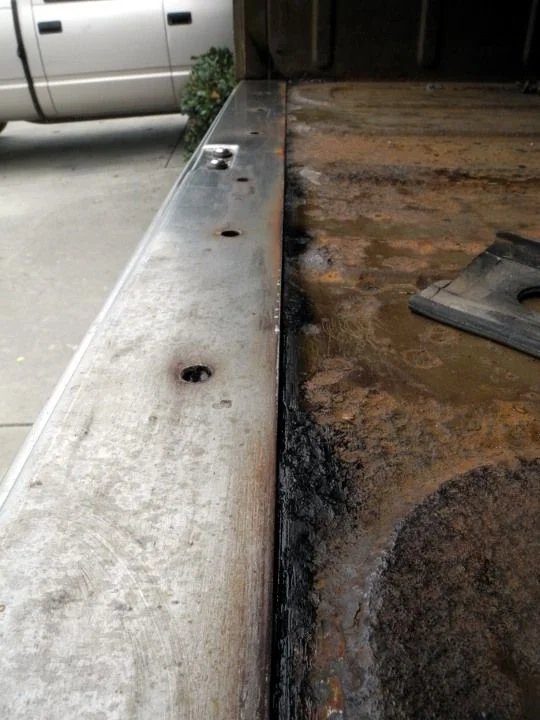

A buddy who welds coincidentally responded to an old request this week, so I offered to pay him to come over and weld. He didn't show. I really wanted to use adhesives to install the sill to the underlying new steel, so I got my wish.
This is a lot more like how a new car body would be put together and the adhesives will keep water from between the metal layers. I repaired my bib this way on my '78 too.

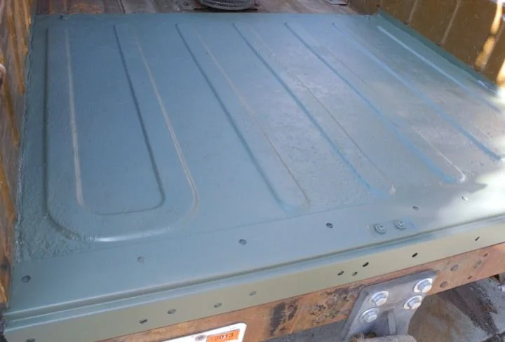

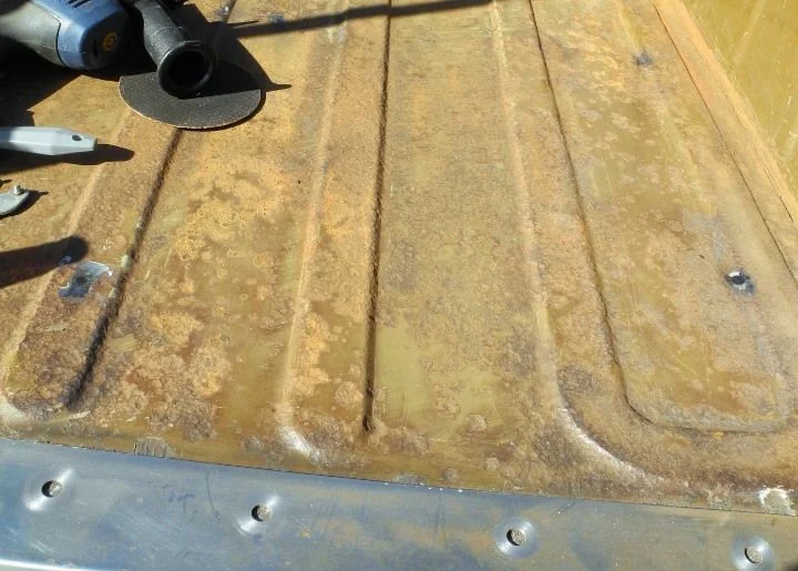

The bed is rusty, but solid. I'm going to patch a couple holes, wire-wheel it and coat it with something like color-matched Monstaliner.

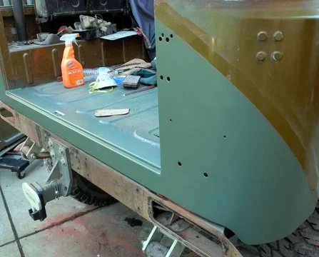

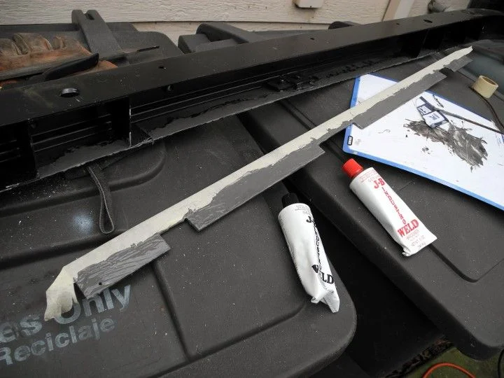

I added a 1.5"x1/8" steel 'shelf' to hold up the floor. JB Weld and rivets on this side.
I didn't get a picture with that piece attached but not yet installed. I rushed through painting it so I could get it installed before dark. Here it is with just the sill brace installed. There is FIPG between the floor and the added steel. I decided I didn't need rivets on the bed side since it's sandwiched between the sill and the bracing below.
Then I stuck on the sill with FIPG. It will still get tacked at the holes and welded to the sides of the tub where they intersect and the body panels when they get welded up. I'm ordering my welder today.

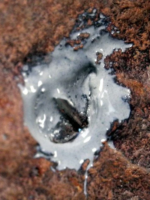

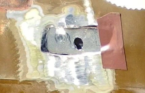

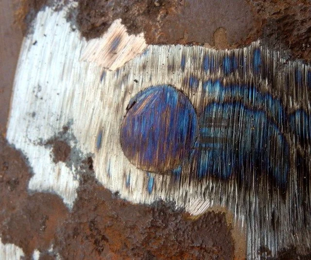

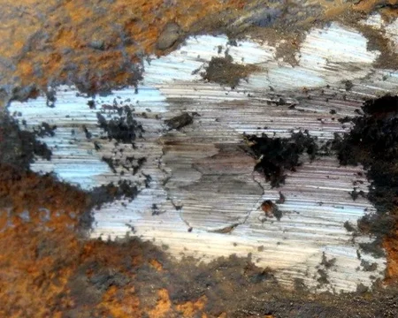

I fixed six holes in the bed floor by tapping and screwing in a stub of a bolt. Some I cut a slot for a screw driver and some I used a wrench to screw them in and cut them in place. I used JB Weld on most of them. They turn out nice. You can only find a couple of them once painted.
Sloppy JB and you can see the screwdriver slot.
And here's what they look like grinded off:

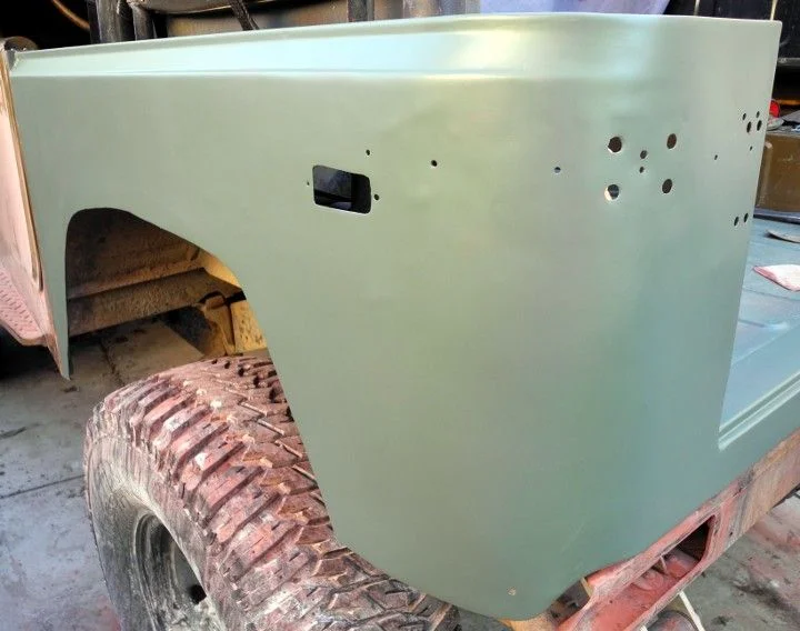

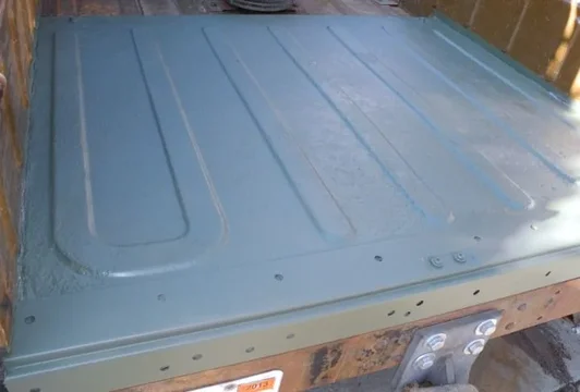

Here's how my body work turned out on the rear. :) I could have done more bondo and made it smoother, but I didn't want it to be thick, like it was. Any bumps you see are metal. This is after tons of steps of which I didn't take pictures, bondo, putty, filling primer, a ton of sanding and finally wet-sanding with 320.
