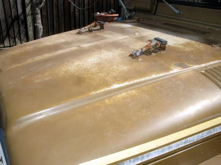

A picture of my hood that I posted in another thread. Hardcore, eh?

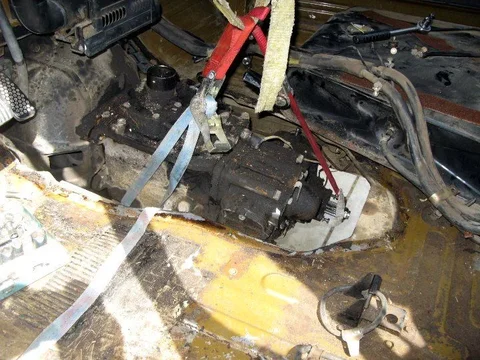

The tranny is going to be out within about half an hour. Should be shifting the h41 and Orion by next weekend.
It is soooo tempting to let it leak out the rear main, leave the clutch alone and just stab the new trans in there. I could be putting it back together this afternoon instead of scraping off 25yo oil pan gasket.

Tranny's out. The clutch and pressure plate are new. Glad I didn't order them. The pilot bearing is good too. I'm going to replace the throwout bearing.
I'm having a hard time deciding to replace a rear main seal that's not leaking. I guess I'm doing it. :confused:
The perfectly good, but 25yo rear main is replaced, the oil pan is all buttoned back up, and I pressed the throwout bearing together. The flywheel is turned, but it started pissing down rain before I got that bolted up. I decided to come to work and save up some brownie points so I can stay home and work on it later in the week when it's not raining.
I'm going to swap over the top cover and some Toyota bolts from the original trans and install Georg's nose cone saver, then it will be all ready to poke in there and put back about a hundred bolts in the e-brake, drive shafts, tranny tunnel cover and seats.
