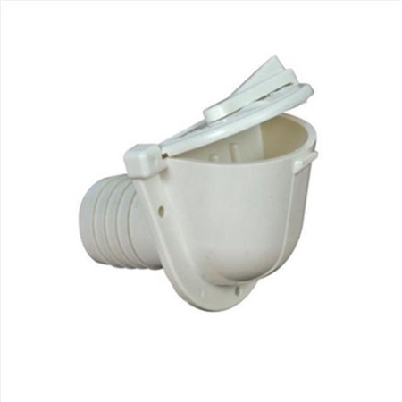

Writing on the inside calls it a “spring a spout”. No luck with google. 🤔🤔
Nice truck. Glad your fixing it! I think the Spring Spout looks like a vintage RV freshwater fill port. Was there any kind of tank mountings inside of it? Save it.
Looks like a metal version of one of these as @HelloKitty65 noted
