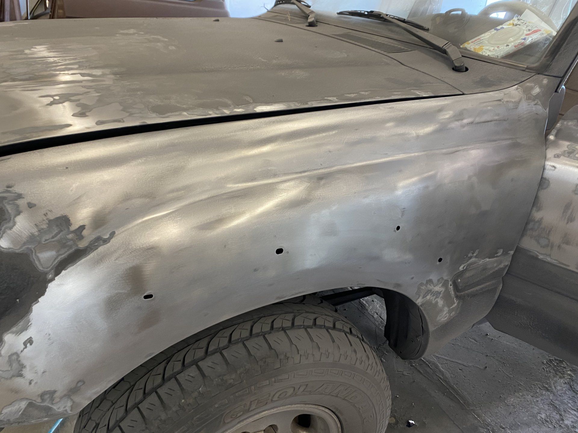

you should be in good hands for paint.... once you get there. I imagine you could sweet talk him in to one of those grills too ;)
The surfacing tool you landed with is one of the better tools I’d imagine. And maybe ask if a high build primer won’t cover those scratches. Might just have to find the magic combo of grit and supplementary detail tools..... oh and patience. @GLTHFJ60 just went through a similar process for raptor liner I believe. Maybe he could shed some light.
only other idea would be a wet sandblaster but not sure it will tackle the lining? Plus you need some room to make a mess

That Eastwood SCT is great ! ! Heavy and somewhat awkward though. I wish I had all of the drums for mine.
You've made an impressive amount of progress here. Thanks for sharing the photos, this thread is bound to be helpful for others looking to remove bedliner in the future.

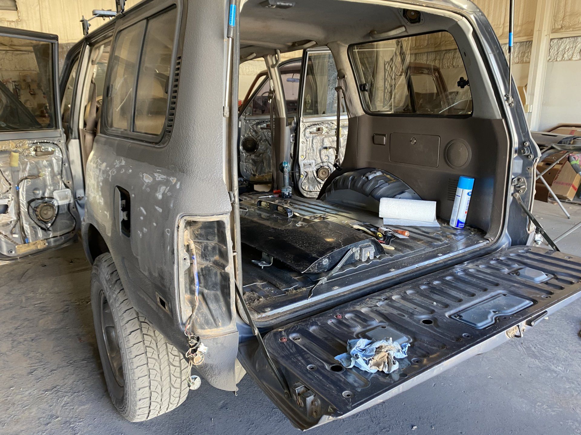

Bummer someone linered what looks like a Nightshadow 80 from the jambs - I secretly hope you decide to back but if you don’t, I hope you spray the jambs & doors where you see the blue.
Incomplete color changes are odd, but if you do all but the engine bay are nice.
——— You have more stones than me attacking liner with handtools ;) :cool: ;) - but I do expect as values climb we’ll see more people doing the un-linering.

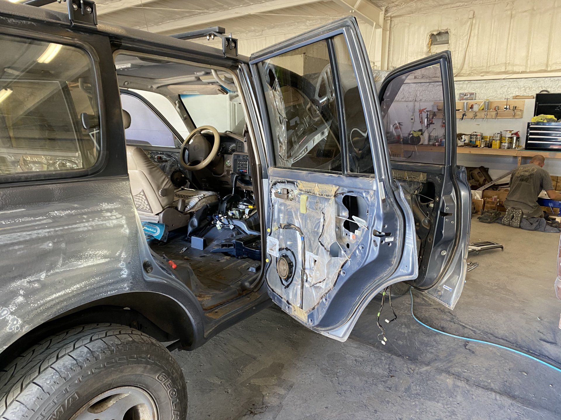

Thank you! This is my 1st attempt at anything like this...I am a Nurse! lol. I think I lost 10 pounds in water weight yesterday sweating, and my biceps are sore. I will definitely do a full re-paint, engine Rebuild, cover all the old blue color etc...This is insane and fun and I am learning a lot. I will check out the link you shared...thanks! Wish me luck

Thank you! I think I will try 80 grit on the sander, then 120. I like the look as well, but there is rust and other things needing repair underneath...like you said....for maintainability and repairs, it is too difficult.
Knotted wire wheels, paint eater discs, DIY contour SCT tool with paint eater drums, and a lot of time. Keep it up, you'll get there.

something else ***if*** you bedliner your 80:
Plan on buying brand new hood & hatch shock/struts.
The added weight on my green 450 hood (real Rhino, but just on center hump) - was enough weight that I went from decent struts to no-go immediately.
Hidden cost. ;)
