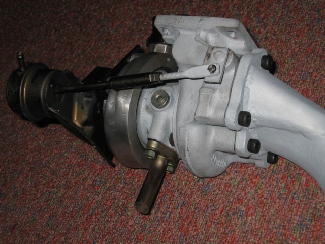

Here's my turbo back when the paint was fresh.

the pic Dougal has up is what Alamo supplies with the turbos i buy. it works and works well.
down side is the initial adjustments since the rod is between the block and the turbo on the HZ/PZ. on the 3B it is one of the best adjustment tools you can invest in.
