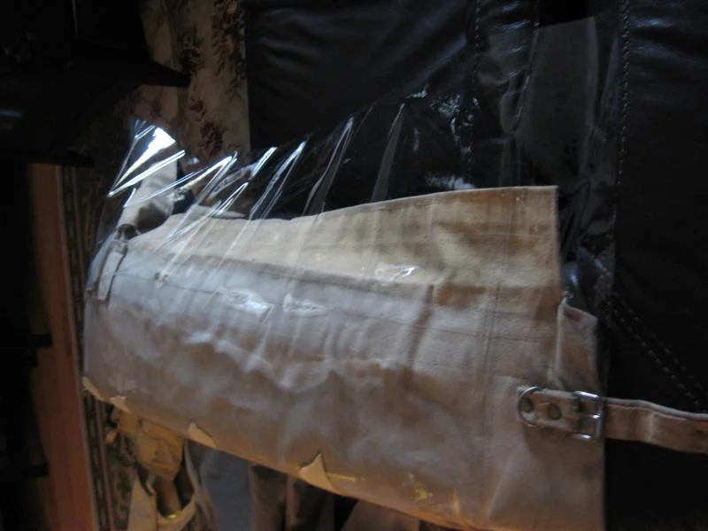

Step 1: make a pattern
I used clear vinyl from walmart to make my pattern - about 1.90 a yard and you only need about 4 yards (i think). I got 10 yards and that was way too much.
I laid out my reference top and took a few measurements of the top piece just to back up the copy method. My old top never wanted to sit right so you have to make your pattern material sit as flush against the reference top as possible to make sure the pattern is the right size/shape. for some pieces you have to improvise.

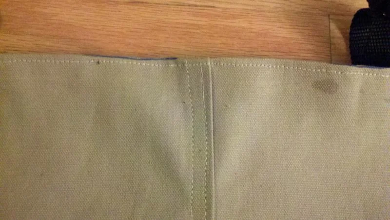

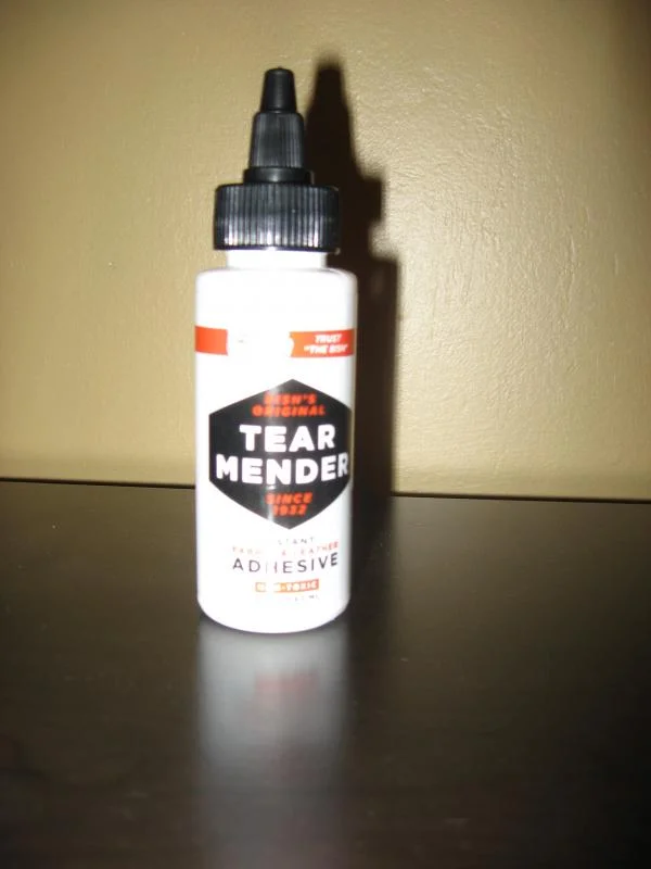

I use an iron to get the seam made nice and then use this vinyl glue which dries almost instantly to set the seam before i sew it... final step.. sew the seam down (about 1 cm away from the edge... the thread you see on your top right next to the edge is the thread that actually holds the fabric together. (see below))

i first glue the pieces together - it is actually very strong stuff and dries in a few minutes. i then make sure it's lined up properly and then go sew it.

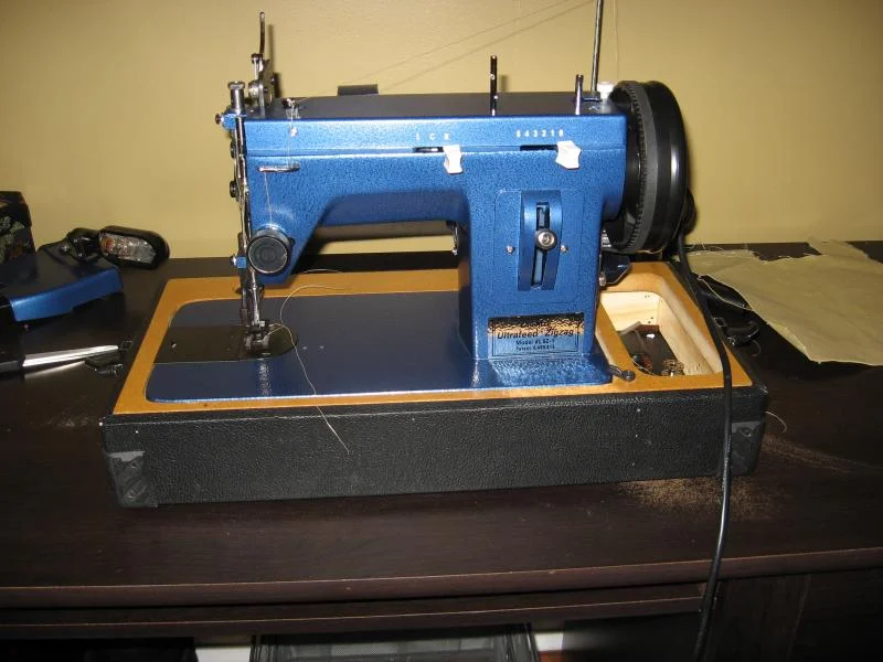

here is the machine I bought used off ebay for around Sailrite LSZ-1

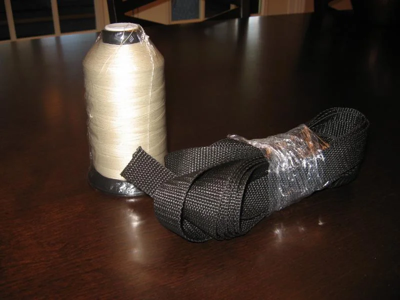

the thread UV resistant polyester
some 1'' webbing

Do you have any problems with the glue gumming up the machine?

the glue doesn't gum up the machine at all! I used sticky velcro (since I have the rear amby doors instead of the rear hatch) and that gummed up the needle a little bit. but the glue itself once it dries is just like any other vinyl and the machine sews through it with ease

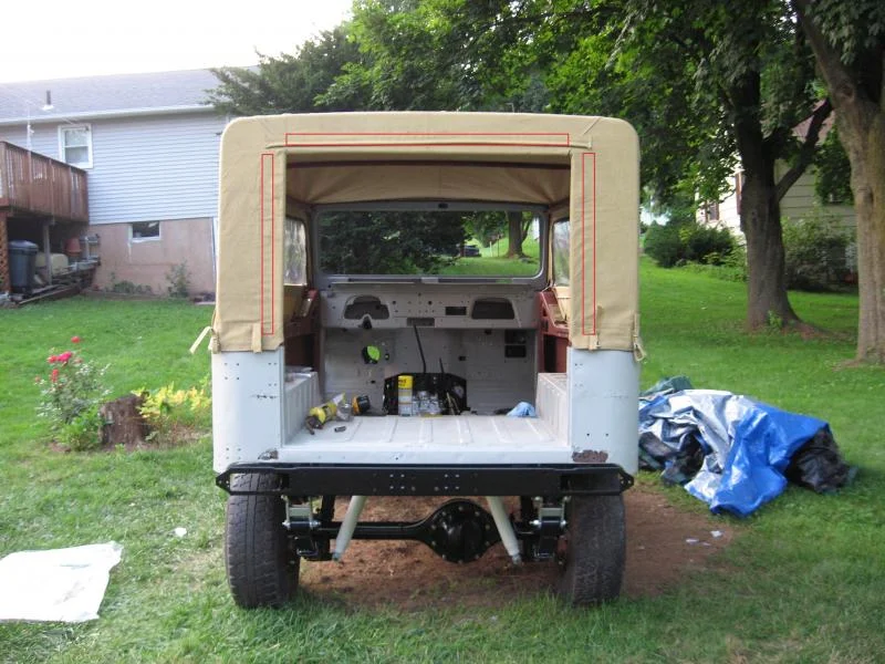

for my type of soft top you need to use velcro.. otherwise you'd have to use rope like the factory ones... - I've had this top for 3 years and have never had an issue with the velcro (i'm talking about the rear of the truck not the flaps)
EDIT: below is my paki top
