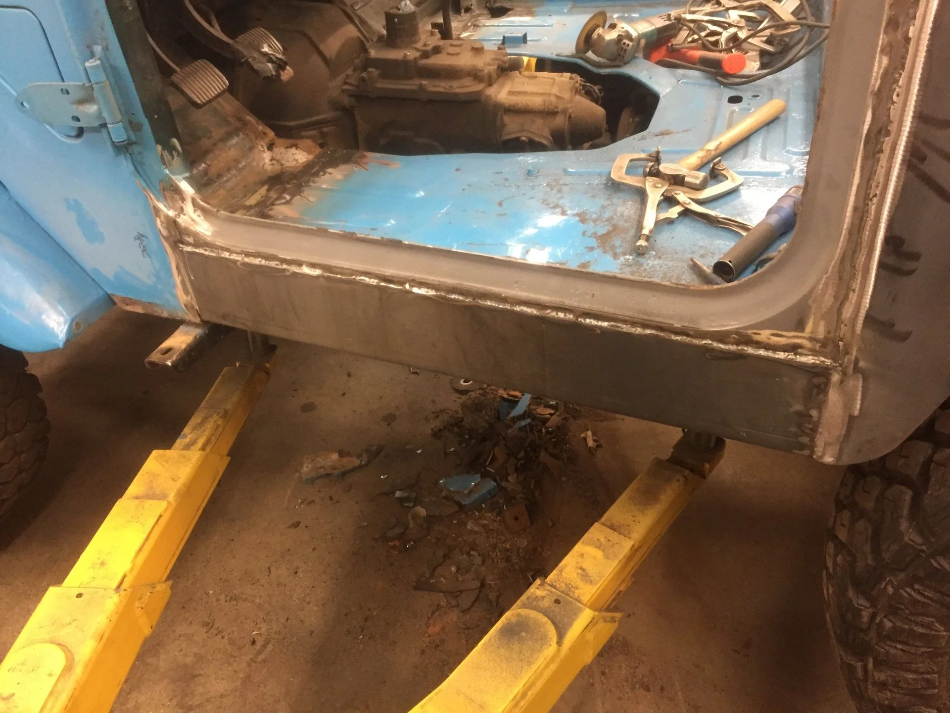

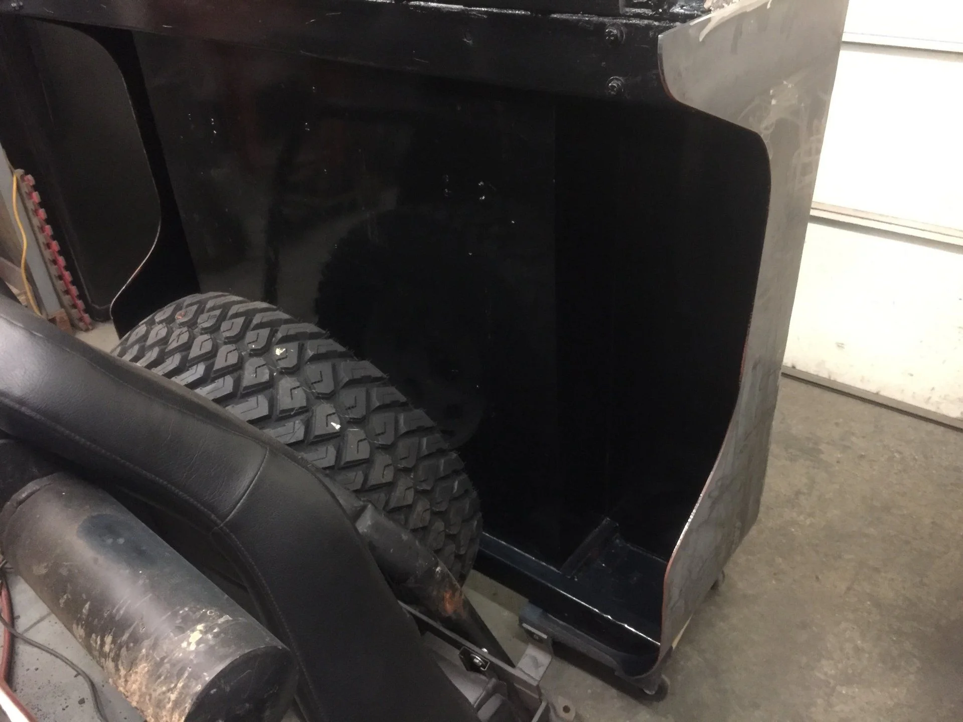

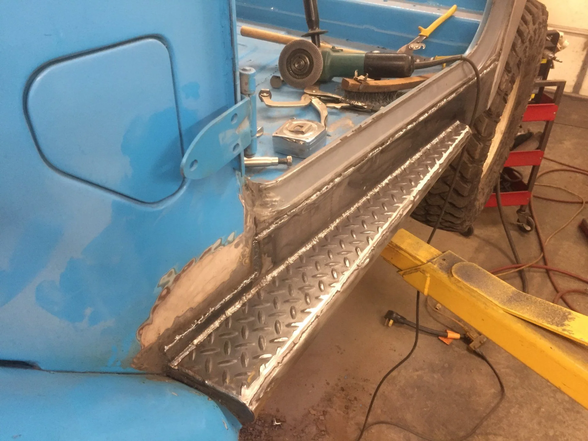

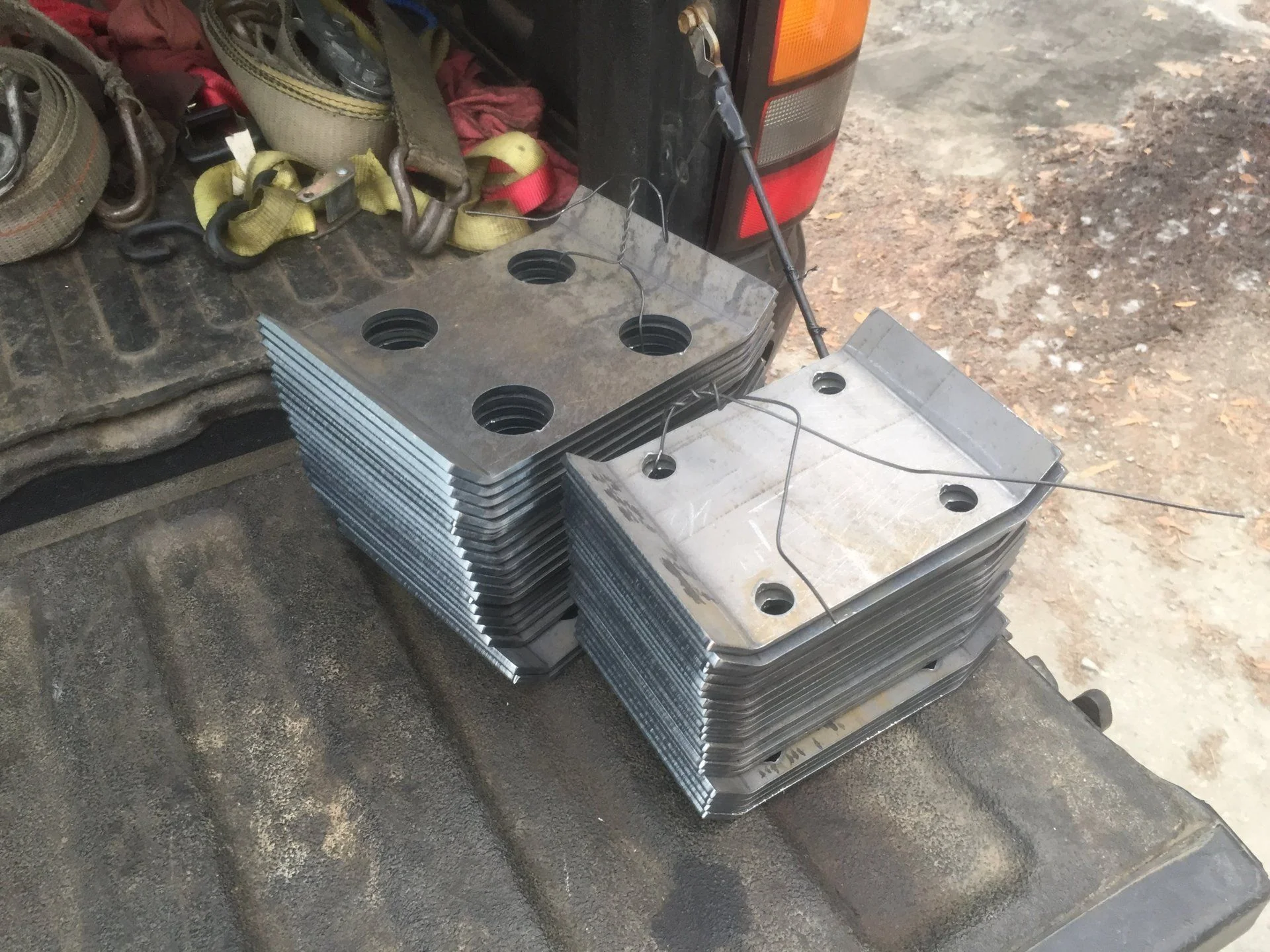

I picked up another couple of sets of quarters today. I had them burn me some ubolt skids with the extra! Only problem is I forgot about the spring center pin. I will have to drill that.
Seriously, Rob... you make it look so easy! Awesome work!!!

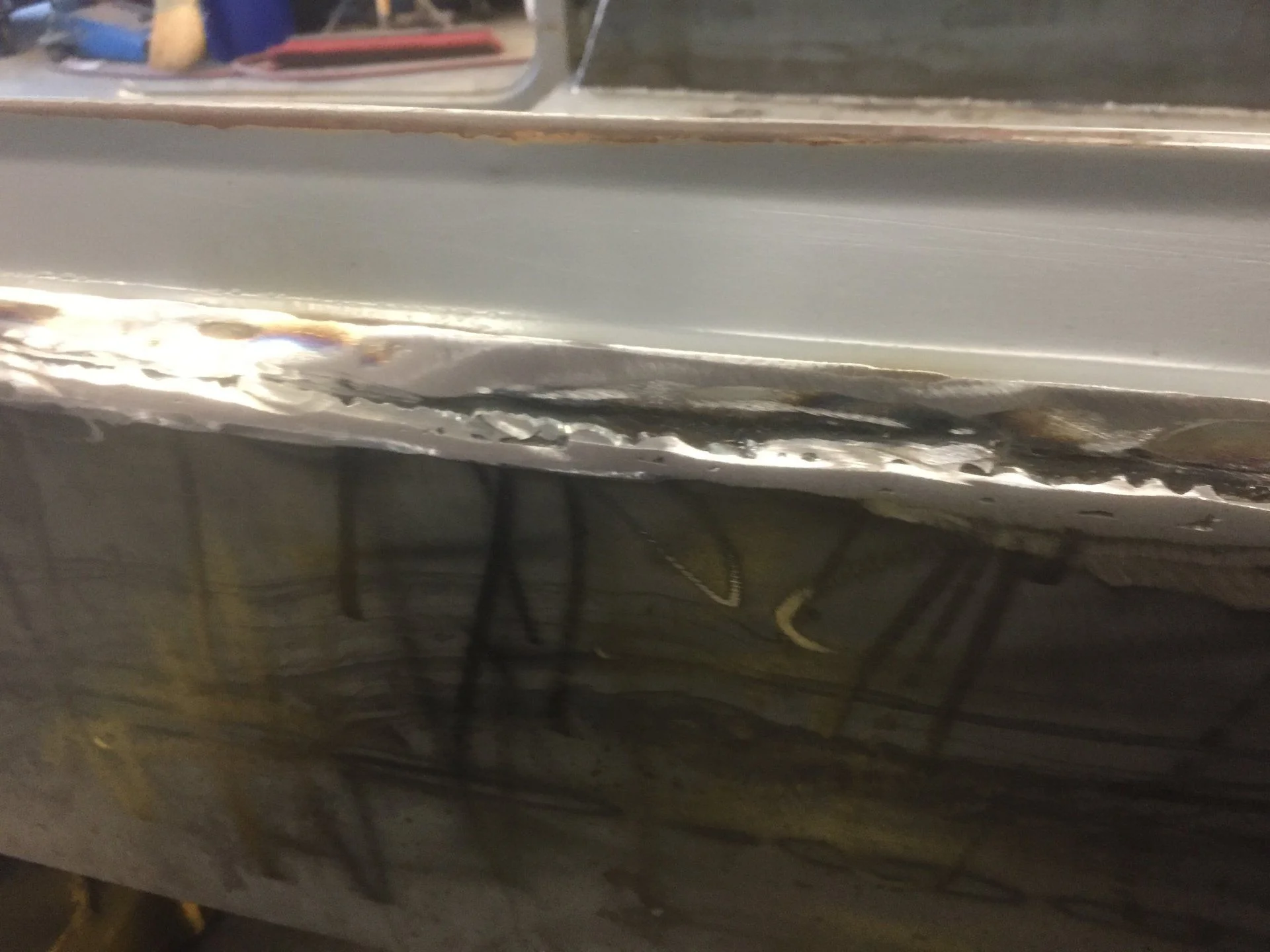

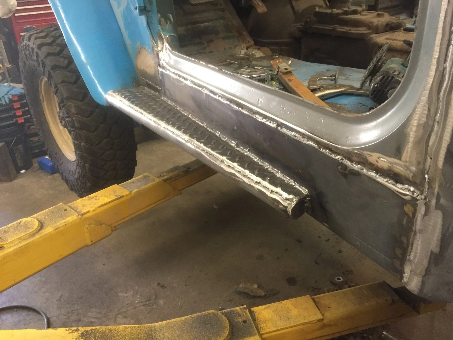

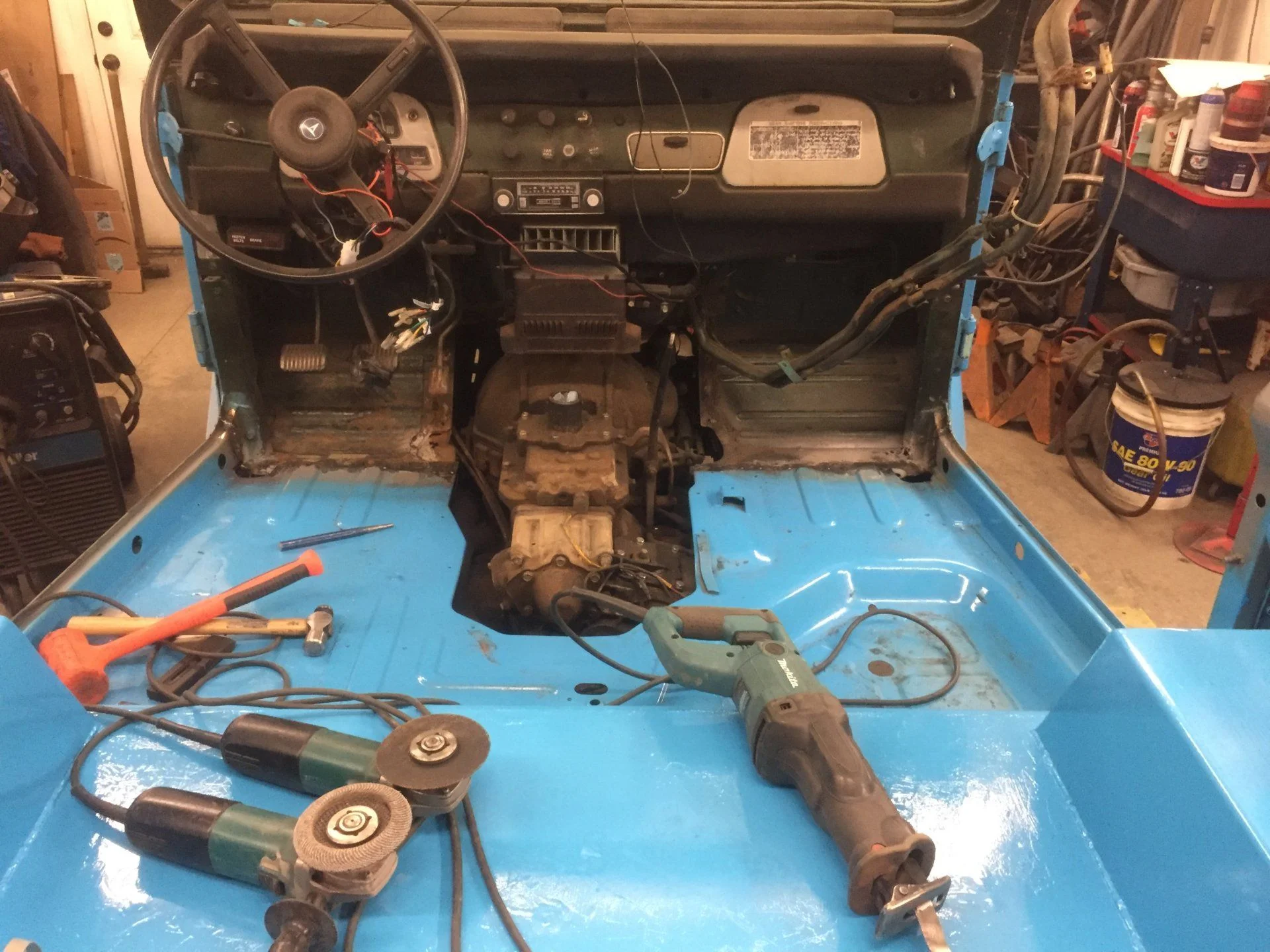

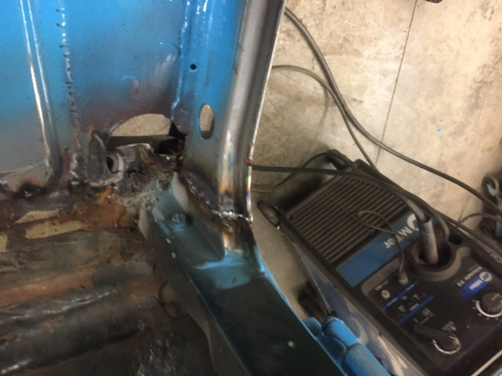

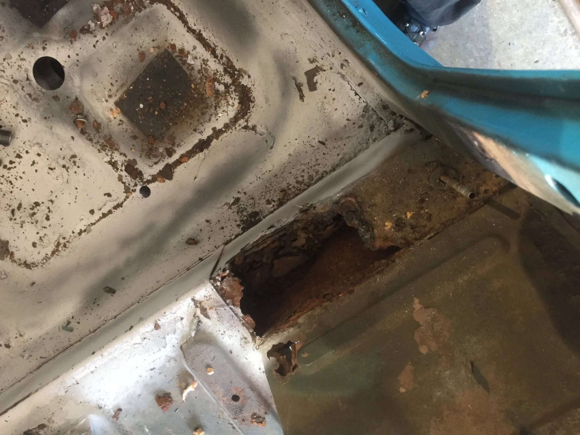

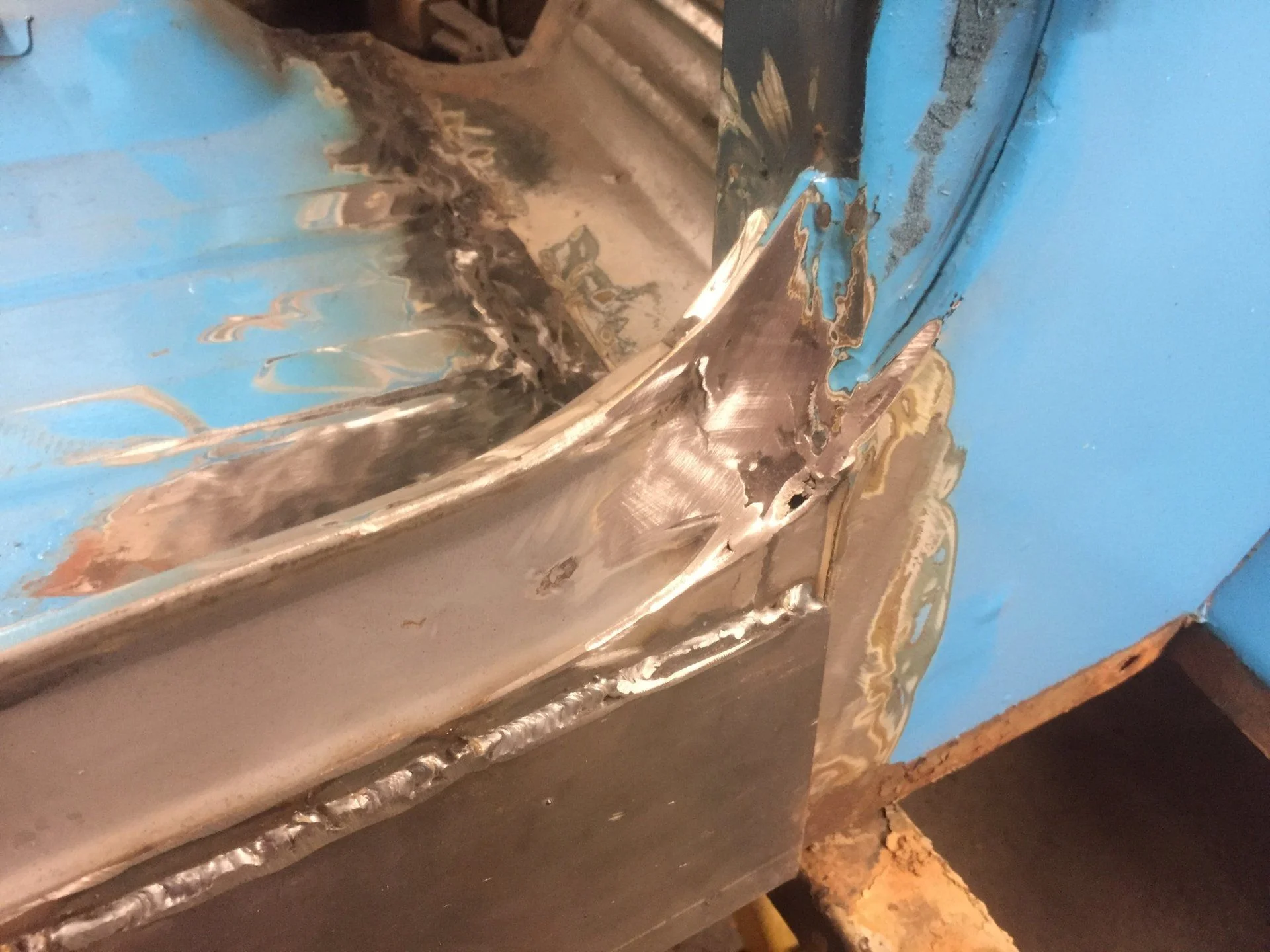

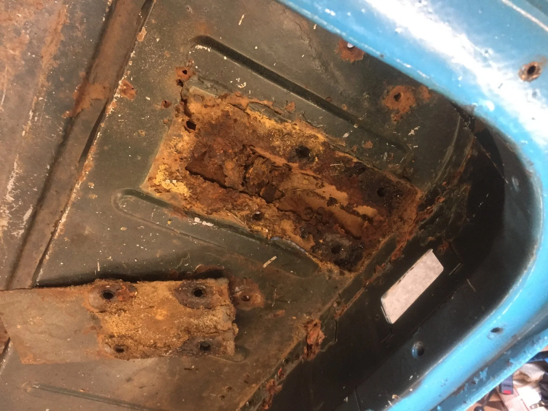

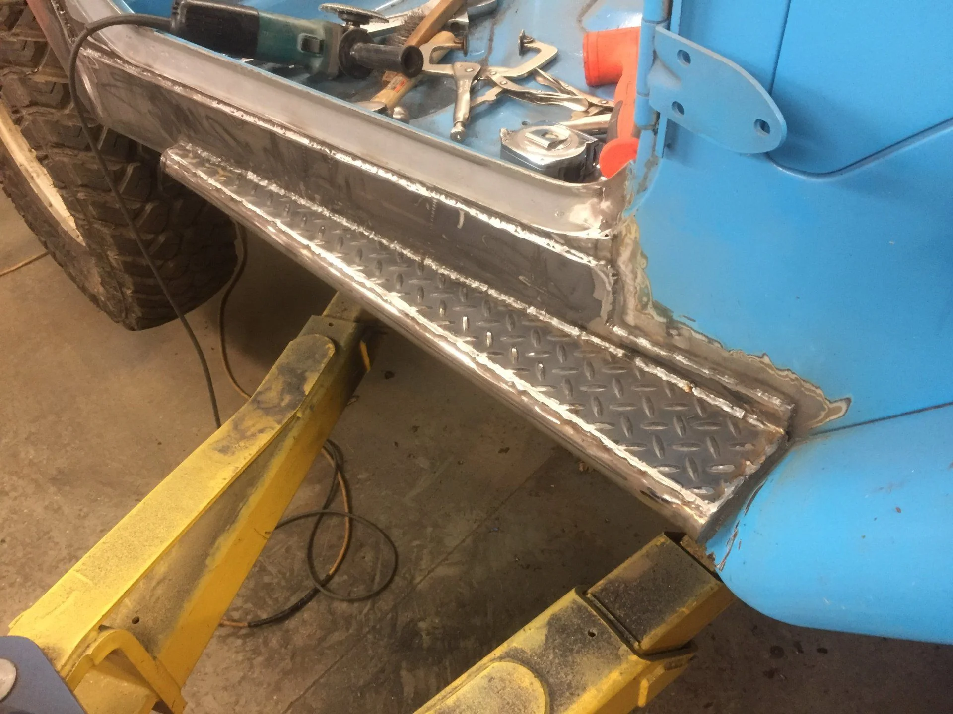

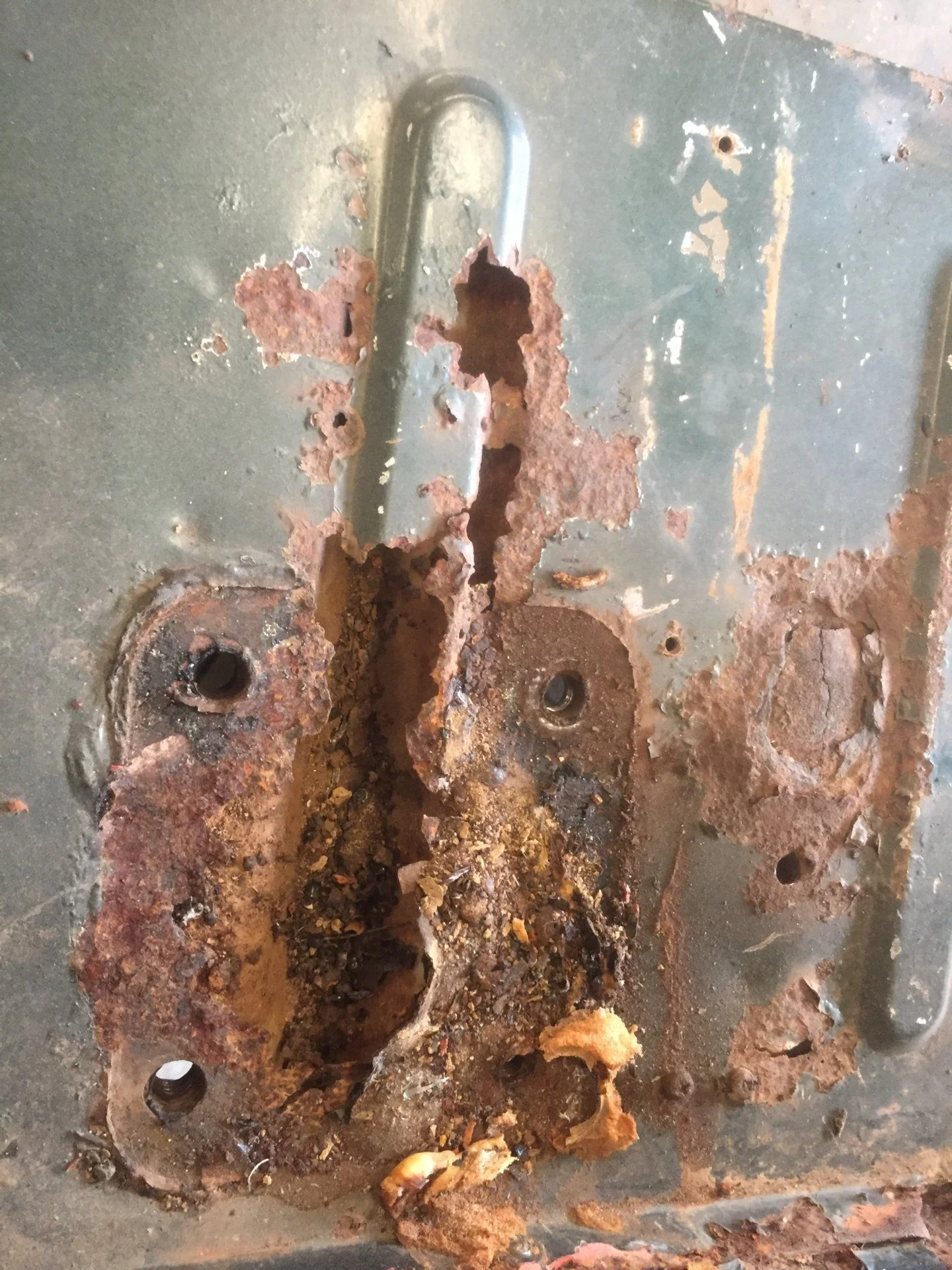

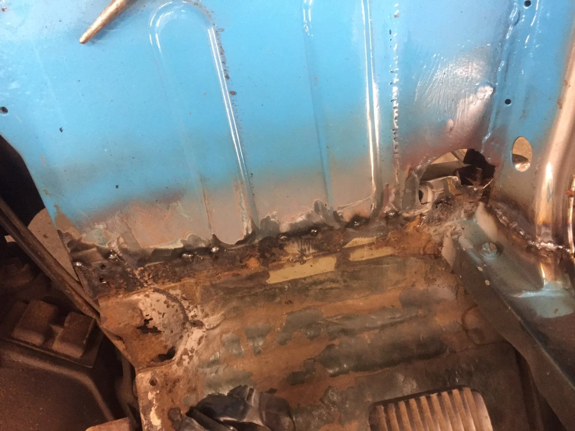

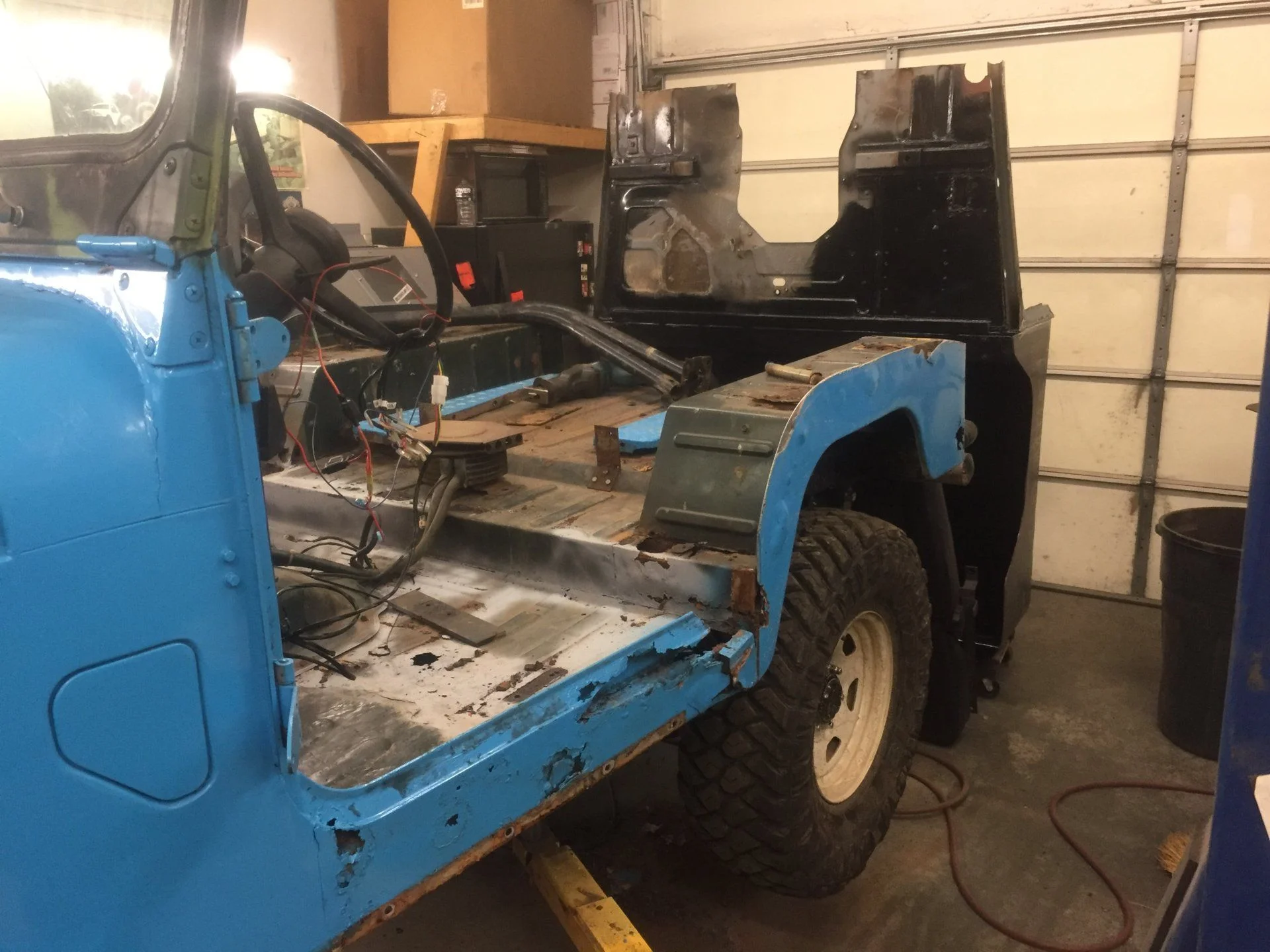

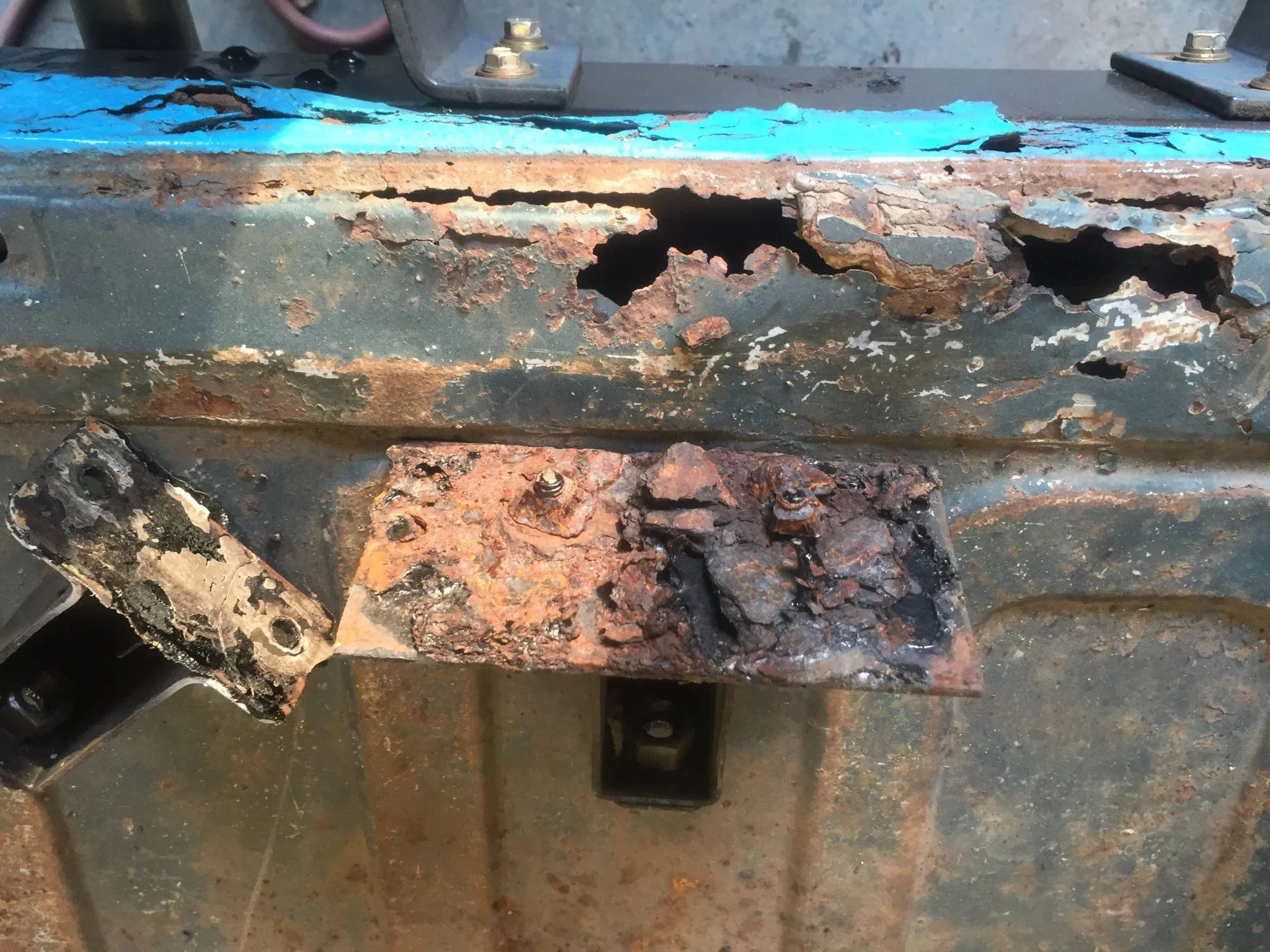

Thanks! I have had the vision for this tub for a while, as I looked at the rotten tub on this project I knew I had to do something. I picked up this gray tub this past spring and figured I would do something with it one day. The biggest hurdle was the quarters. Once I found the right guys to make them the rest fell into place. I spent a lot of time with the welder in my hand yesterday! I did get to play with my plasma cutter some too, trimming the inner wheel wells and then the finish work with a angle grinder. I hope to have few hours today to clean up the drivers side and then start patching more holes in the floor boards. I am not sure what was bolted to the floor but I have already filled a dozen holes and have at least a dozen more to fill. I have figured out where to cut the floor so that I should just have one seam to butt weld together to join the two tubs.
It may look easy but it is still a lot of work. I have almost 10 hours in it so far. Having the right tools helps too! :)

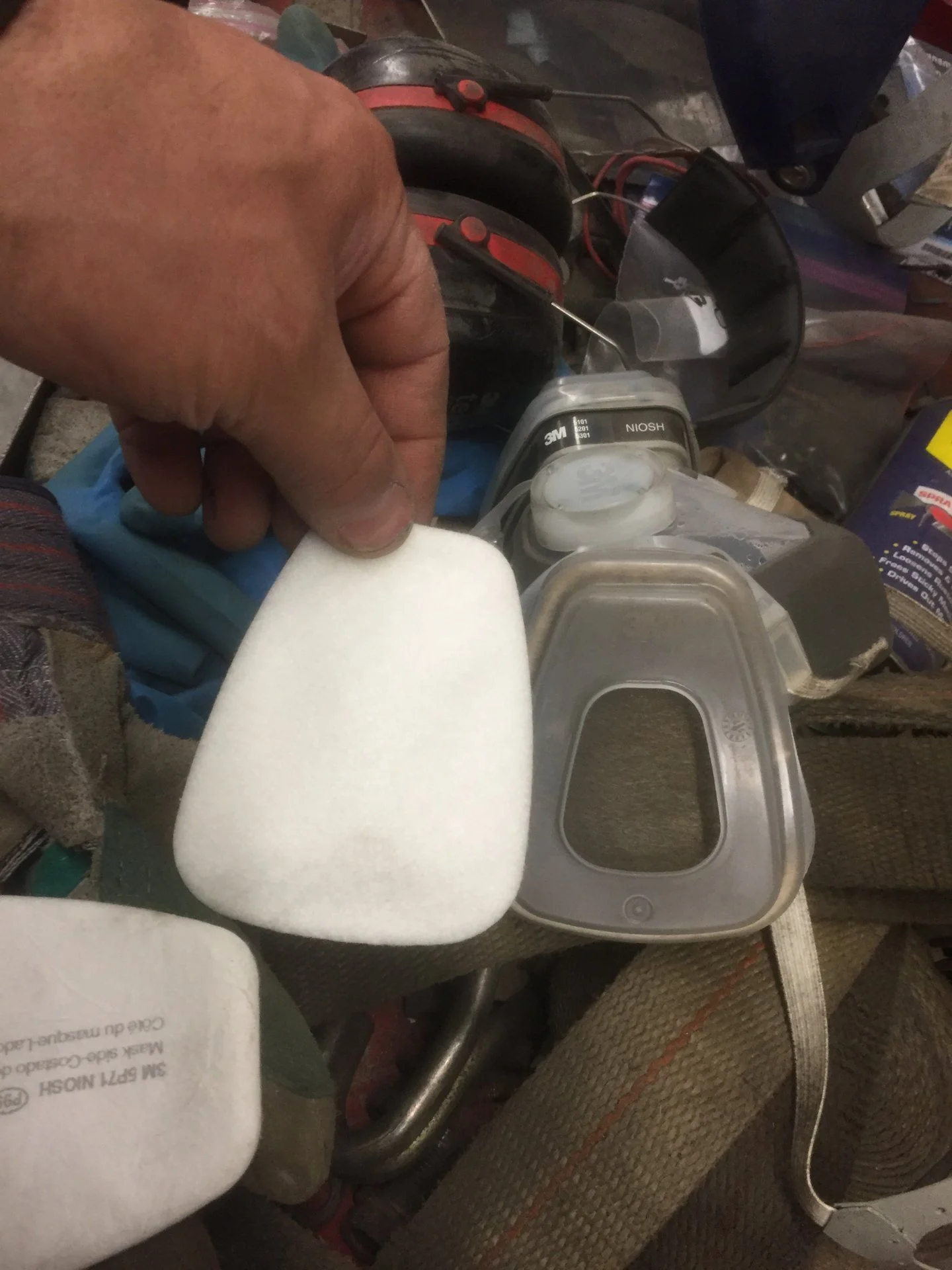

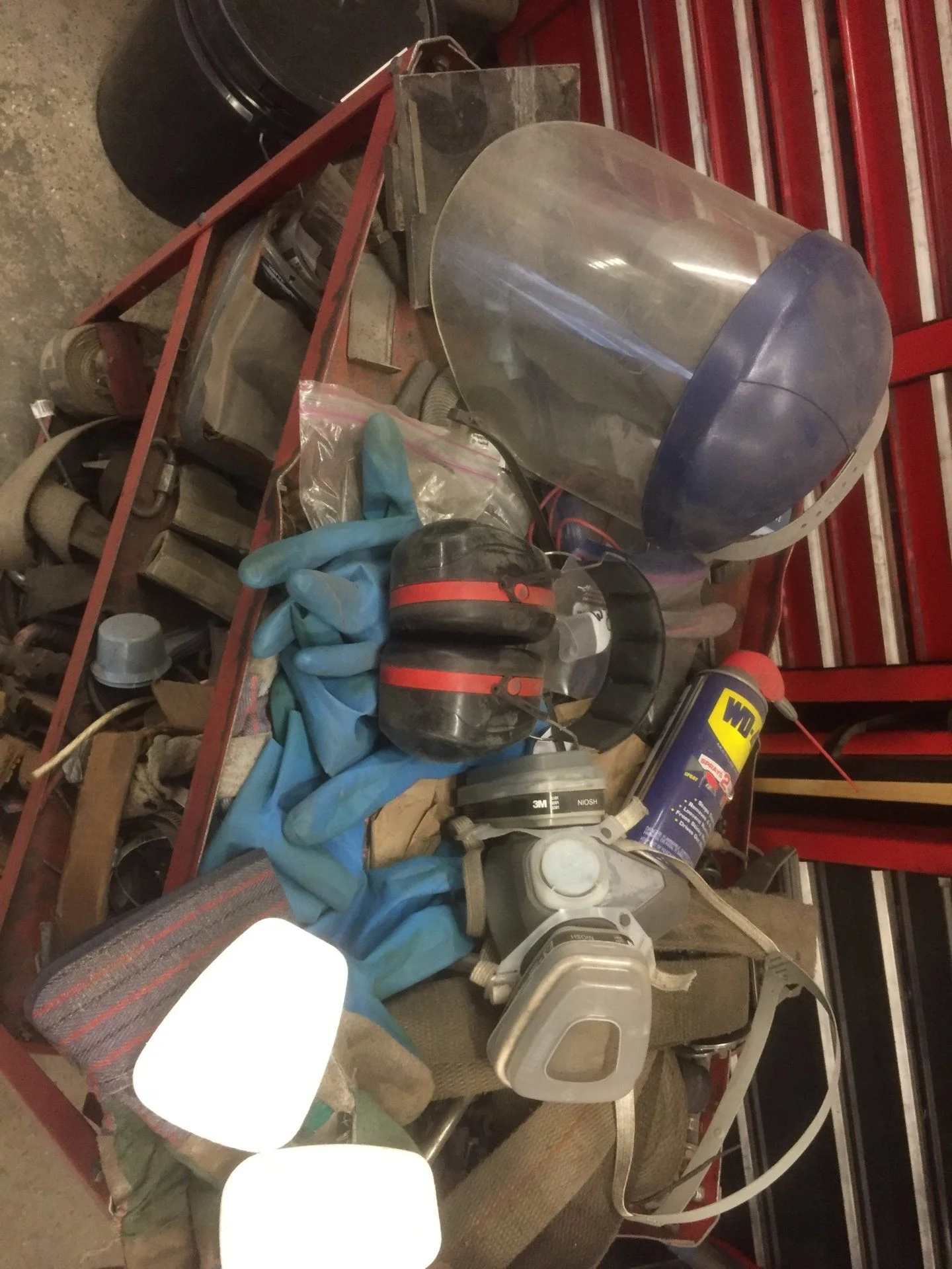

Ok boys and girls. Todays safety course. I always try to wear these four main pieces. Full face shield, dust mask with charcoal filters, ear muffs, as well as gloves. This mask did its job! It takes a little longer to get ready but to breath clean air, not loose your hearing and not only keep your eyes protected but your whole face it is worth it. 3M makes great gear and you can pick it all up at Home Depot or other stores. I like the respirator because I can get extra filters for it without replacing the whole thing. It cost about $25 but well worth it.

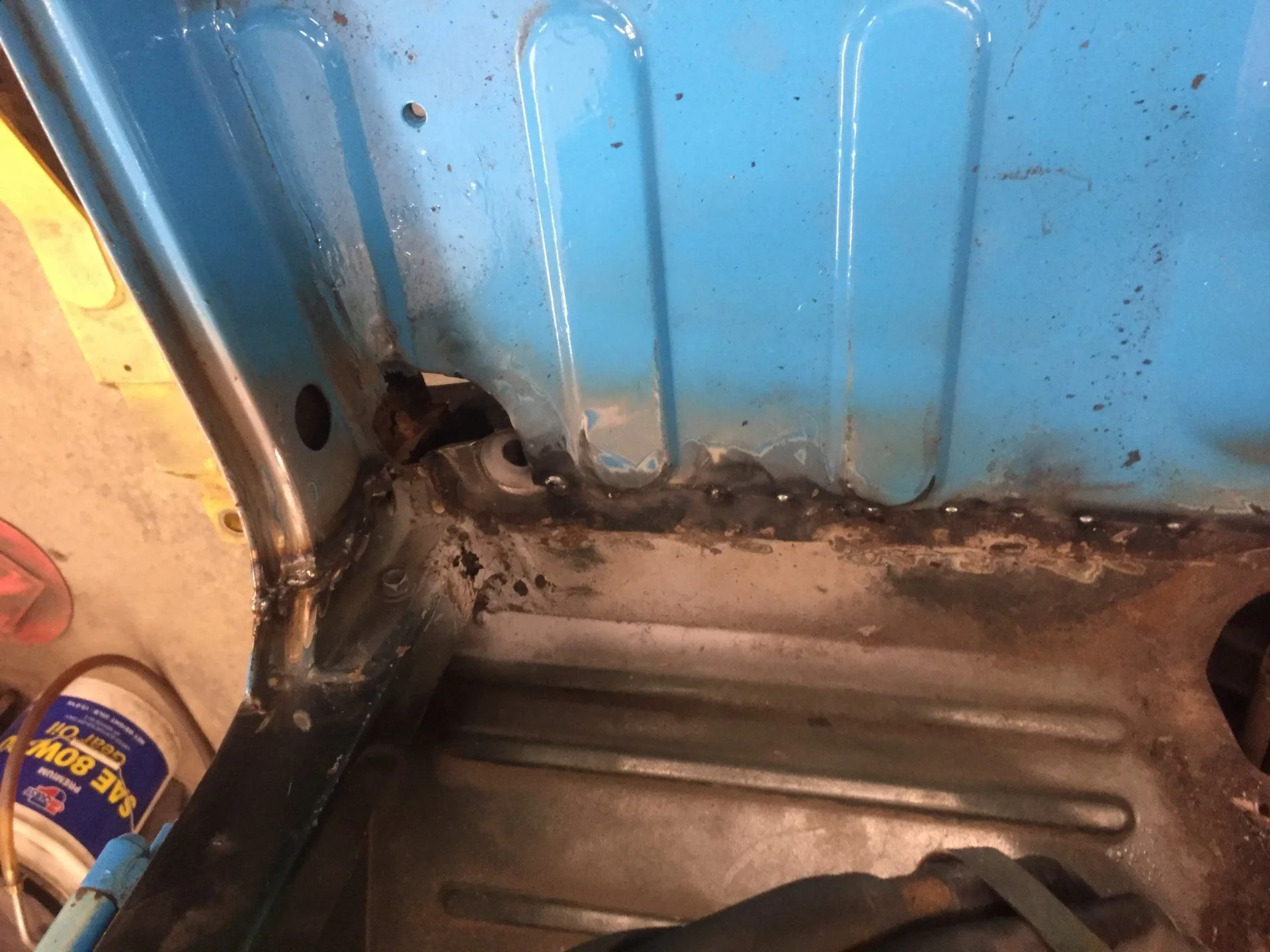

As most know with a set of top rails, B pilar and cowl you can build a new tub. May be later. New tub ready to go on. I seam sealed all the seams inside the cab and under to prevent moisture and rust build up. Then painted it with Rustoleum Industrial paint. I do not like undercoating as it is hard to get off it you have to do a repair.

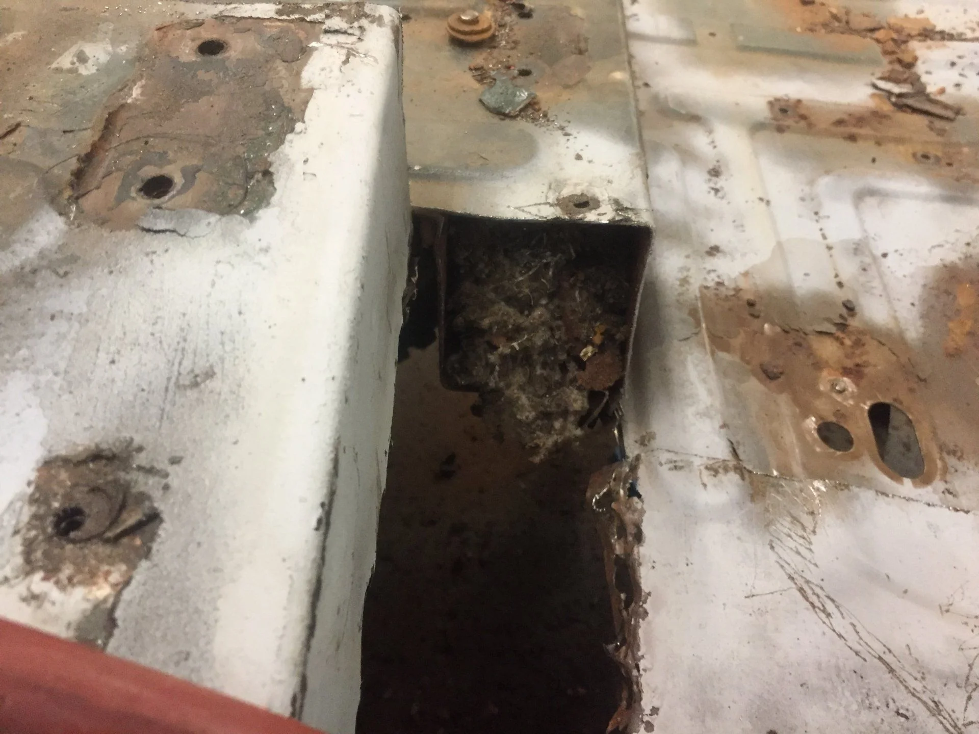

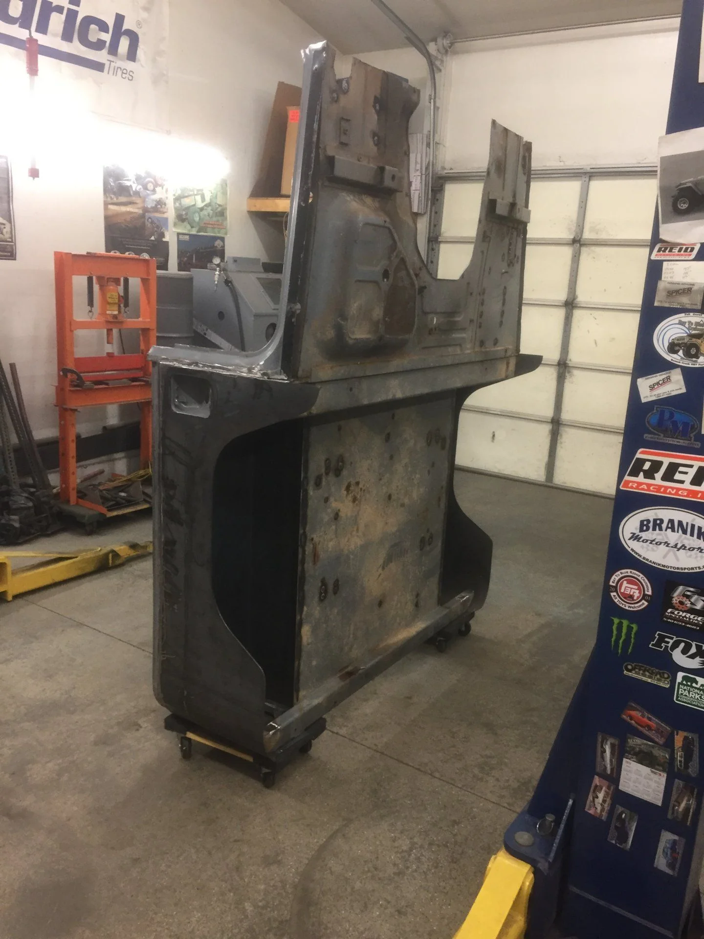

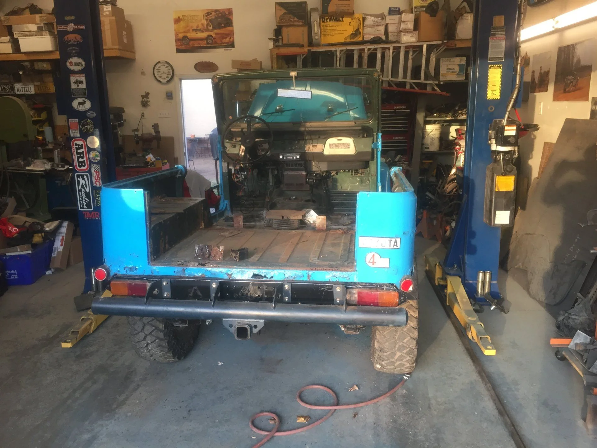

Body came off ok. I cut in four pieces to make it easier to carry. I found yet another nest.

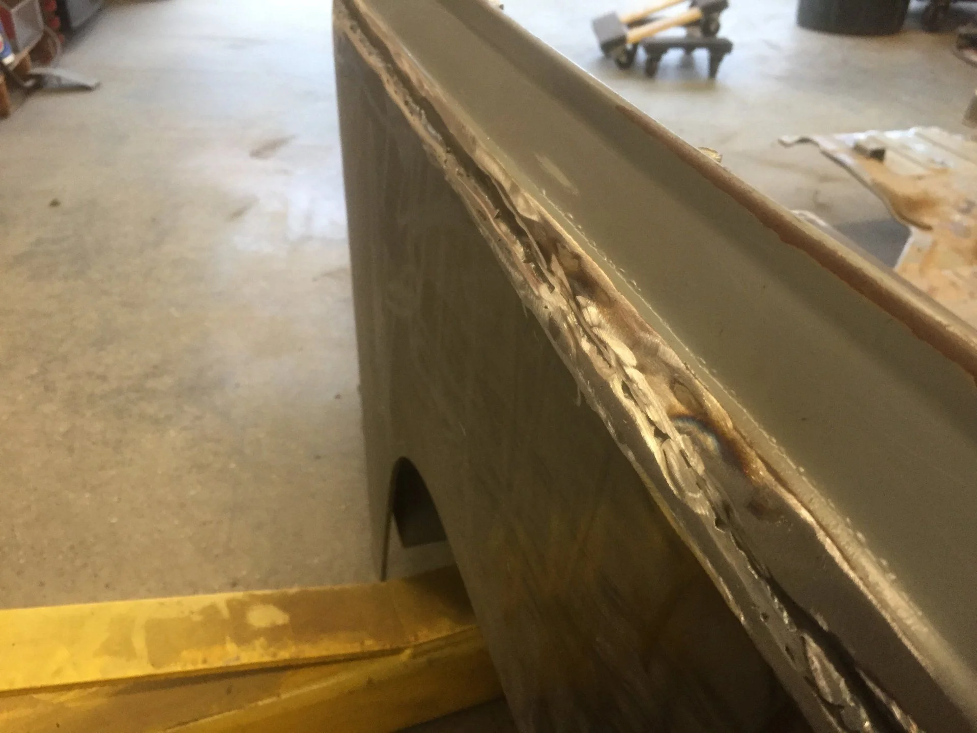

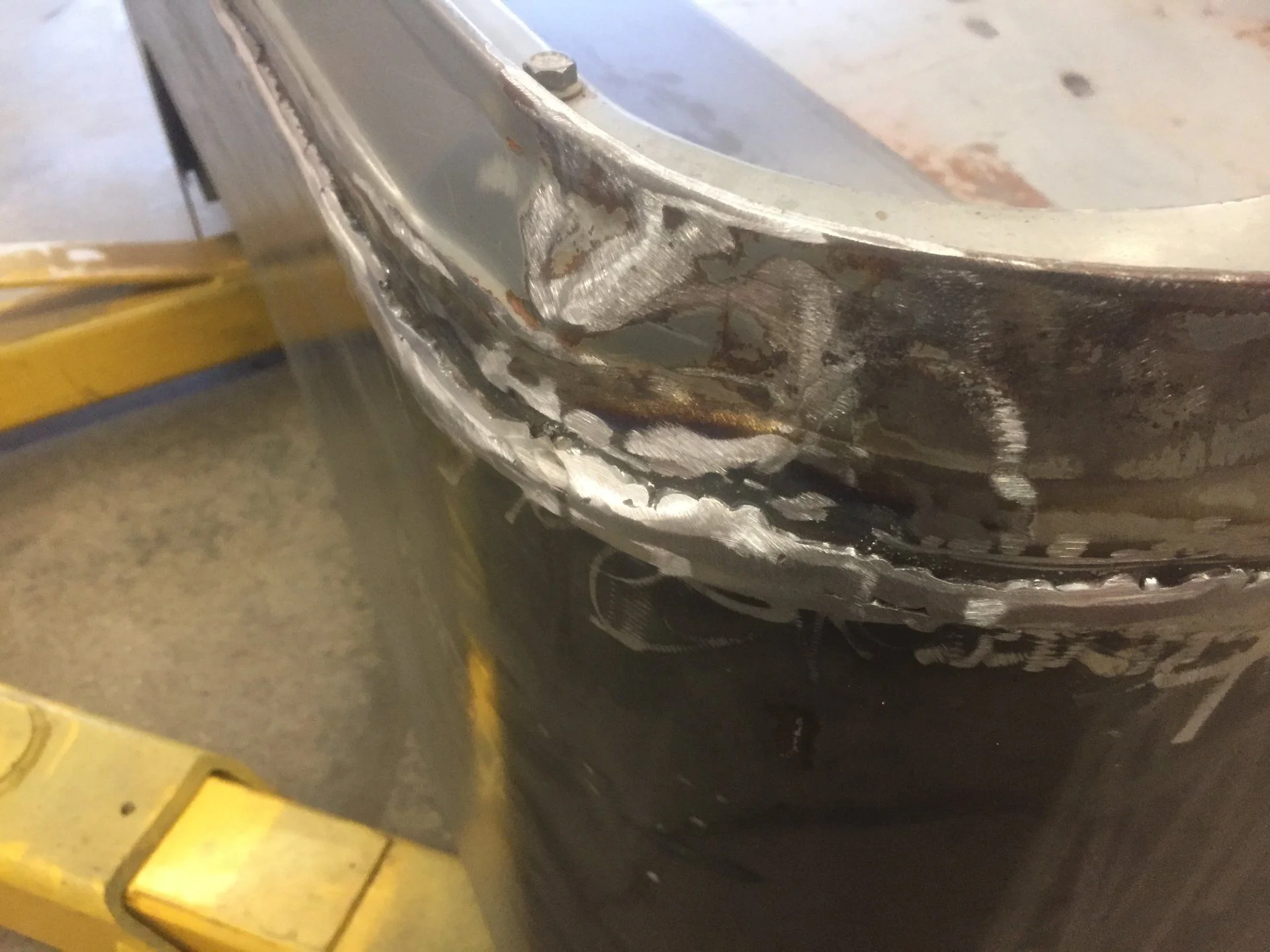

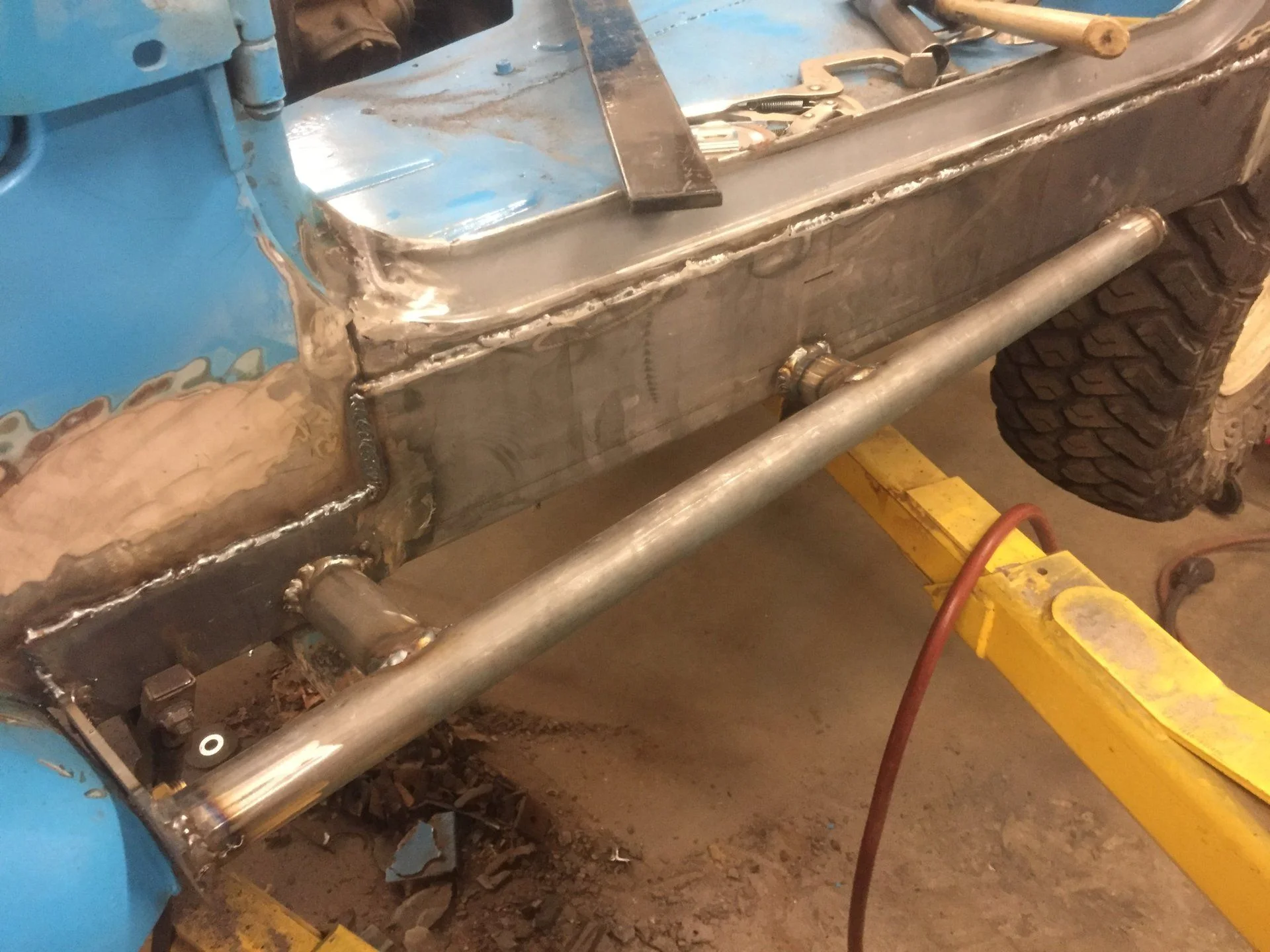

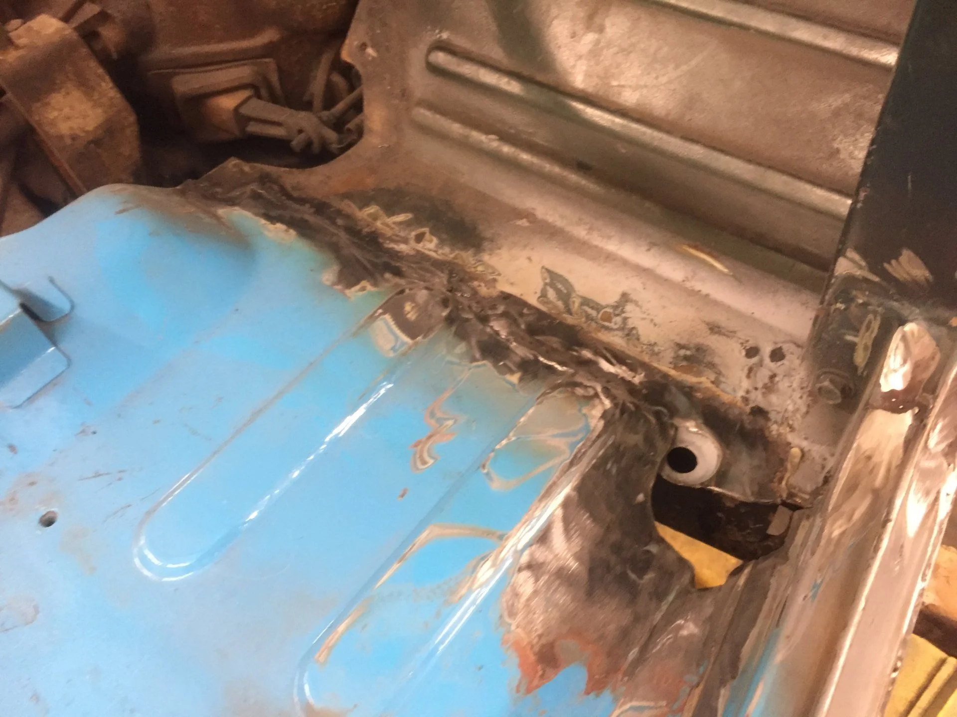

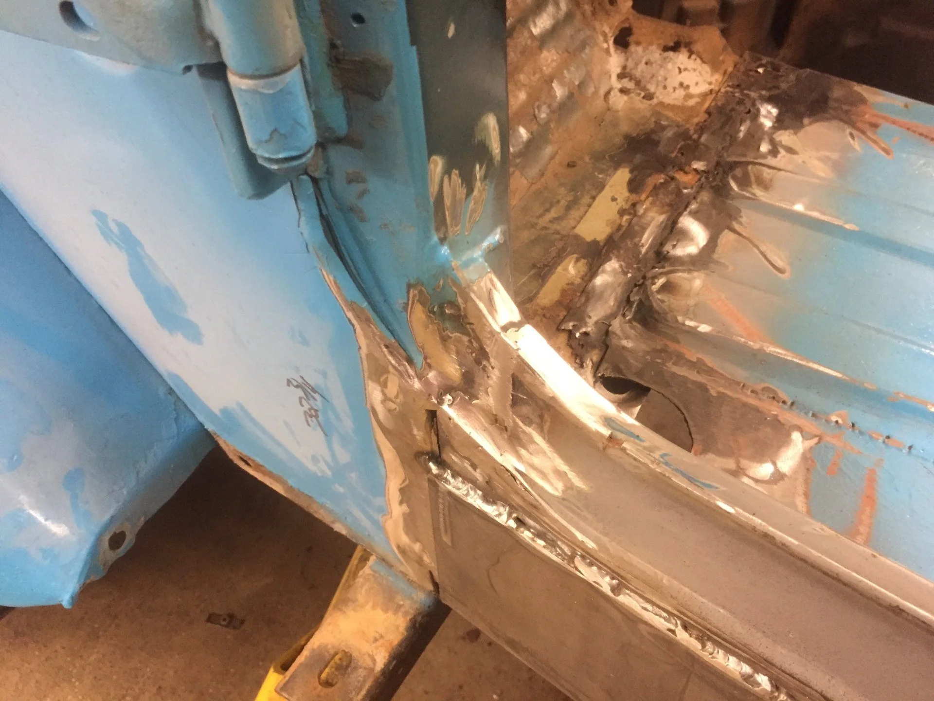

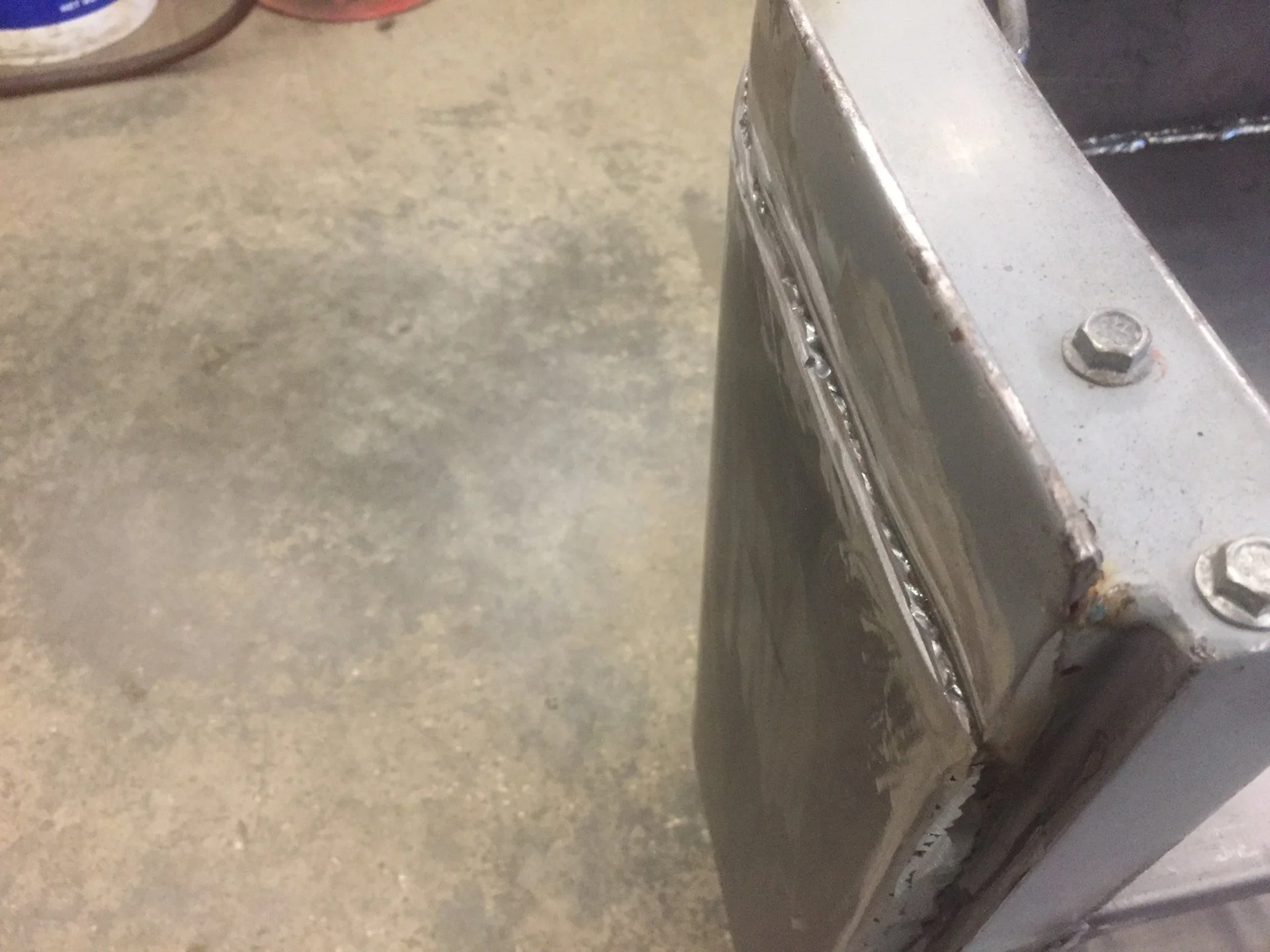

The hard part is done. Whoever said measure twice cut once was not a body man. I am not sure how many times I measured but decided to overlap the two pieces by 1" at the floor. I need to patch the rollbar holes and finish welding it out then grind it smooth with a flap disc.

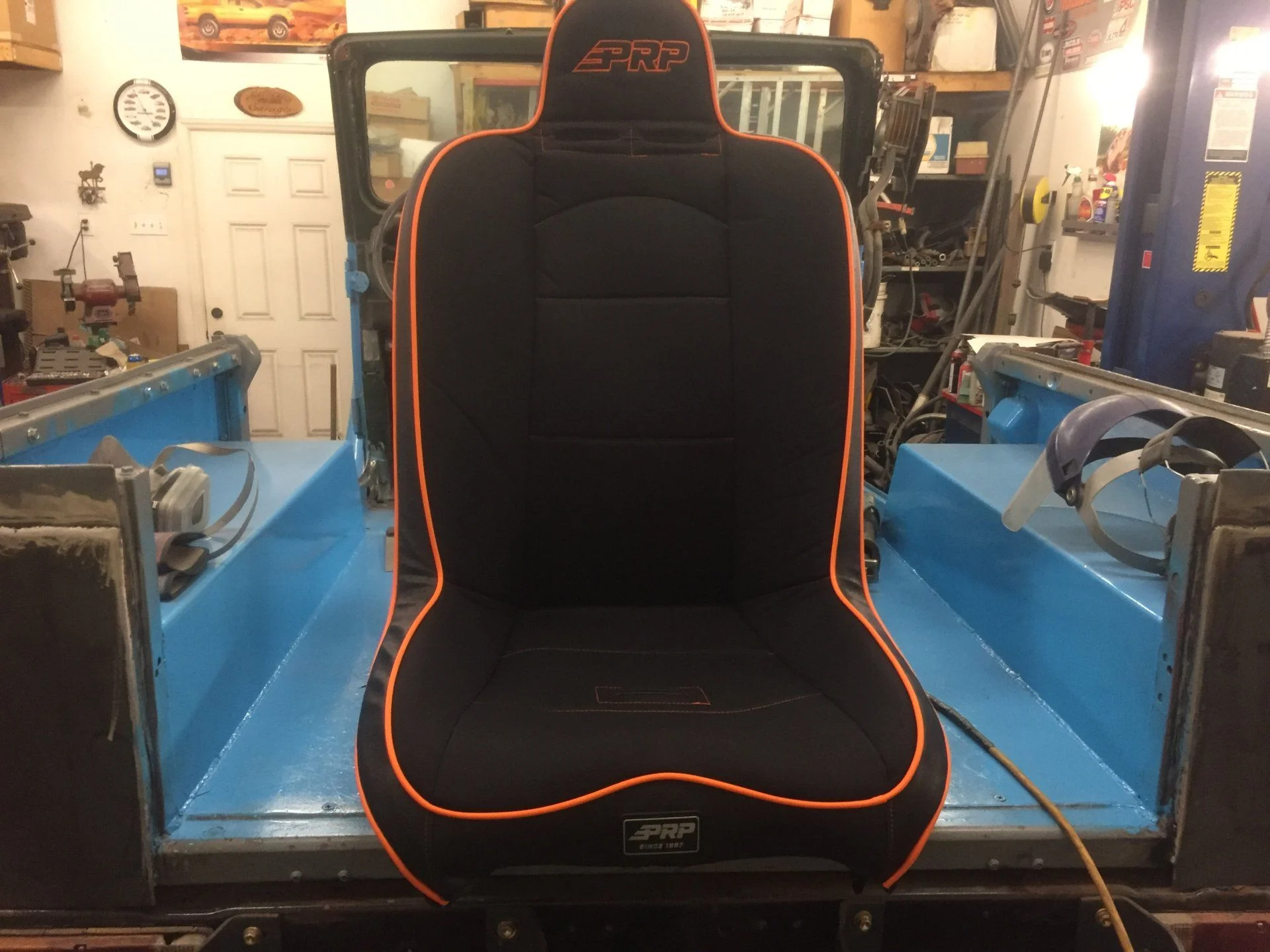

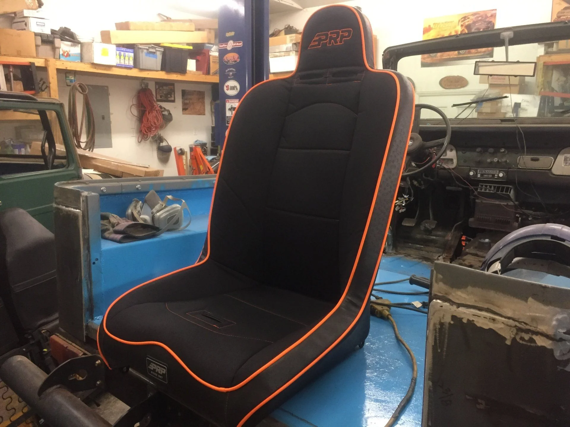

One thing I have learned from the race car is to have good seats! I took advantage of the Black Friday sale and picked up a set of PRP daily drivers in the plus size! These will fit nicely in here.
