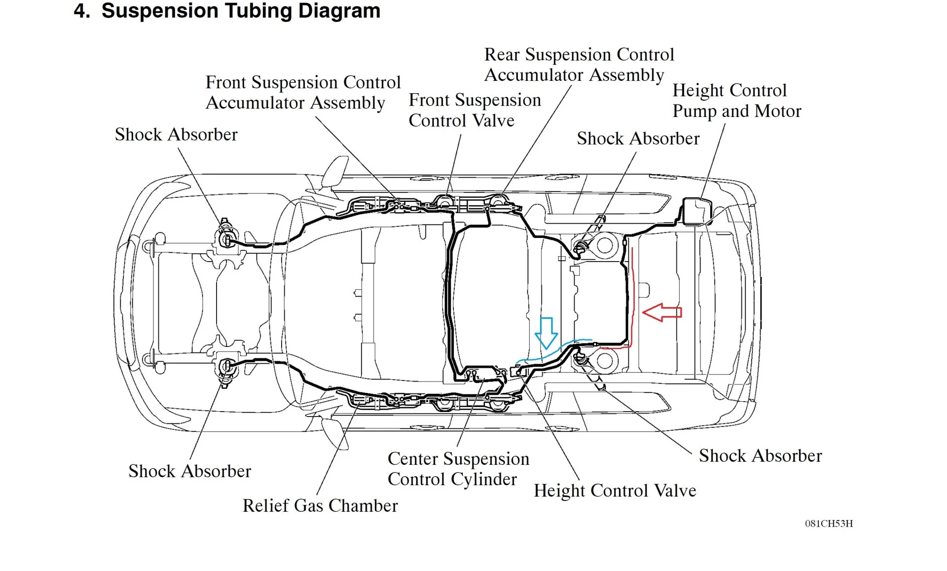

To help ease the shock. Here is a picture of all the hydraulic lines. I think it’s usually the one I marked in blue that leaks. Possibly the red one. A few people here have had to replace it and will know better. I’m sure whichever is the common one, the truck doesn’t need to be removed from the frame to replace.
Just hoping to demystify it a bit. Nothing a good brake repair shop probably couldn’t repair, plus I’m pretty sure all the replacement tubes are still available from Lexus/Toyota. All of the parts in the system that aren’t hydraulic lines are readily replaceable as well in case it’s leaking from something else.
