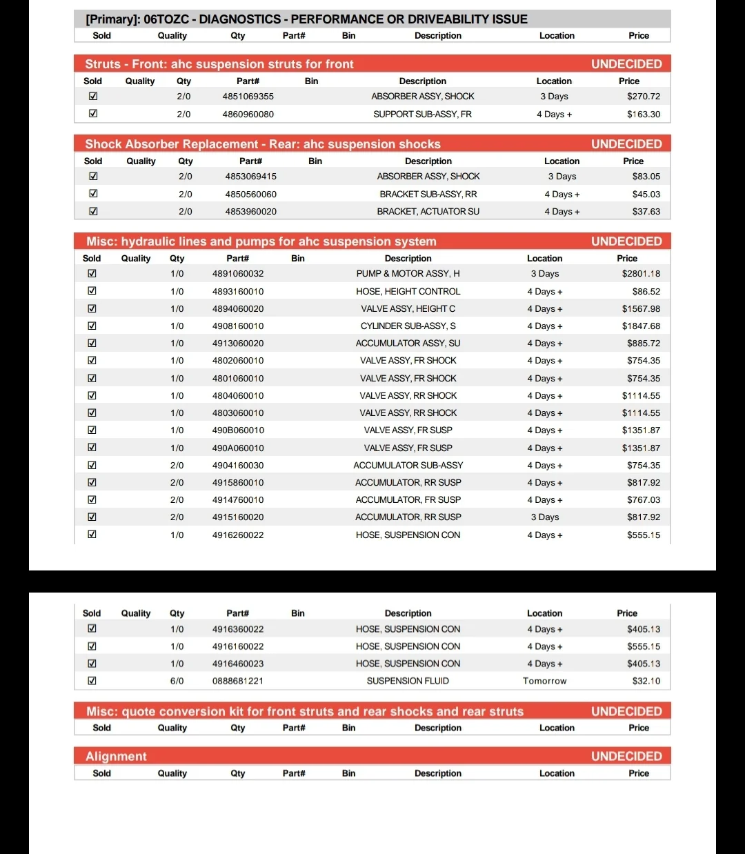

Was directed here from a Lexus forum re '09 LX570. This past weekend, my AHC failed, the car was stuck in "Lo" and leaked it's insides all over the outside onto the driveway (I'm guessing this is the hydraulic fluid). I managed to creep it down to the Toyota dealer, which is literally at the end of my street. Lexus is about 12 miles away. Toyota was baffled so they called Lexus (we have two in the area, and they called the dealer I do not use) and received a $29,000 quote for repair. I knew this was going to be expensive based on everything I've read here over the years, and I fully accepted that when I bought the car, but $29k?!? I was quoted $4k for a conversion kit, but none are available because...parts. As it sits, the Toyota dealer is going to give me $12k to walk away from it. This doesn't make sense - don't get me wrong, I'm happy to walk with $12k - possiblyget into a CPO (or a Volvo). But again, $29k? Are they trying to rip me off? I have this nightmare they will fix it and sit it on the lot $10k over what they gave me and I'm out my beloved LX570. If anyone out there thinks "yep, this is accurate" I'd love for you to chime in. Details - 2009 LX570, 205k miles.

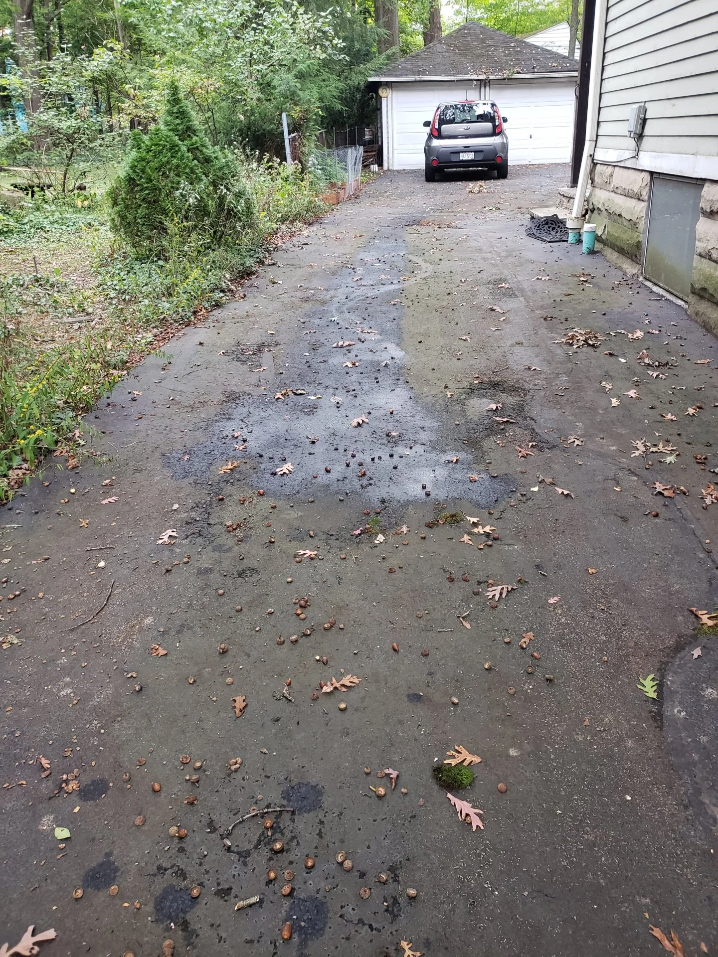

Did you take any pictures of where the leak was coming from?
Did they give an itemized list? I'm guessing not because they have to be charging like 200 hrs of labor or some BS.
I didnt, but you can somewhat see the vicinity from the driveway pic (drivers side, rear). I backed it out when I realized what was happening, I stopped. Its the rear, doesn't look troubled at the front.

They gave me a parts list but wouldn't let me have a copy of anything else. I loved my old dealership and mechanic. The places around here are awful

How bad are the lines rusted? That would explain some of the cost, but that would be like 5k total to replace. Maybe you can find some used parts from someone who took their AHC out.
