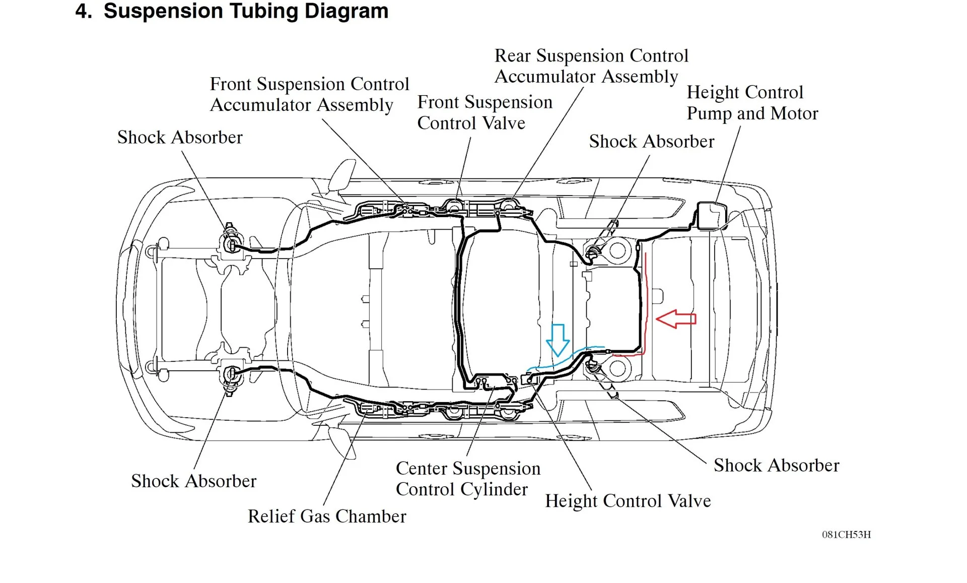

View attachment 2834849To help ease the shock. Here is a picture of all the hydraulic lines. I think it’s usually the one I marked in blue that leaks. Possibly the red one. A few people here have had to replace it and will know better. I’m sure whichever is the common one, the truck doesn’t need to be removed from the frame to replace.
Just hoping to demystify it a bit. Nothing a good brake repair shop probably couldn’t repair, plus I’m pretty sure all the replacement tubes are still available from Lexus/Toyota. All of the parts in the system that aren’t hydraulic lines are readily replaceable as well in case it’s leaking from something else.
That is a very helpful diagram! I think it's the red line that burst. I'll see if I can determine the part number.

Can they send you a picture of the rusted line? Most of us have had a specific line fail from rust. The rest of failed lines have been one-offs.
Thank you for the tip, I will ask. I am also going to ask if I can see the underside once it's on a lift, and have them point out to me all the parts they think need to be replaced. Then I'll ask for a cost breakdown sheet.
Does anyone have a part number on the blue line?
