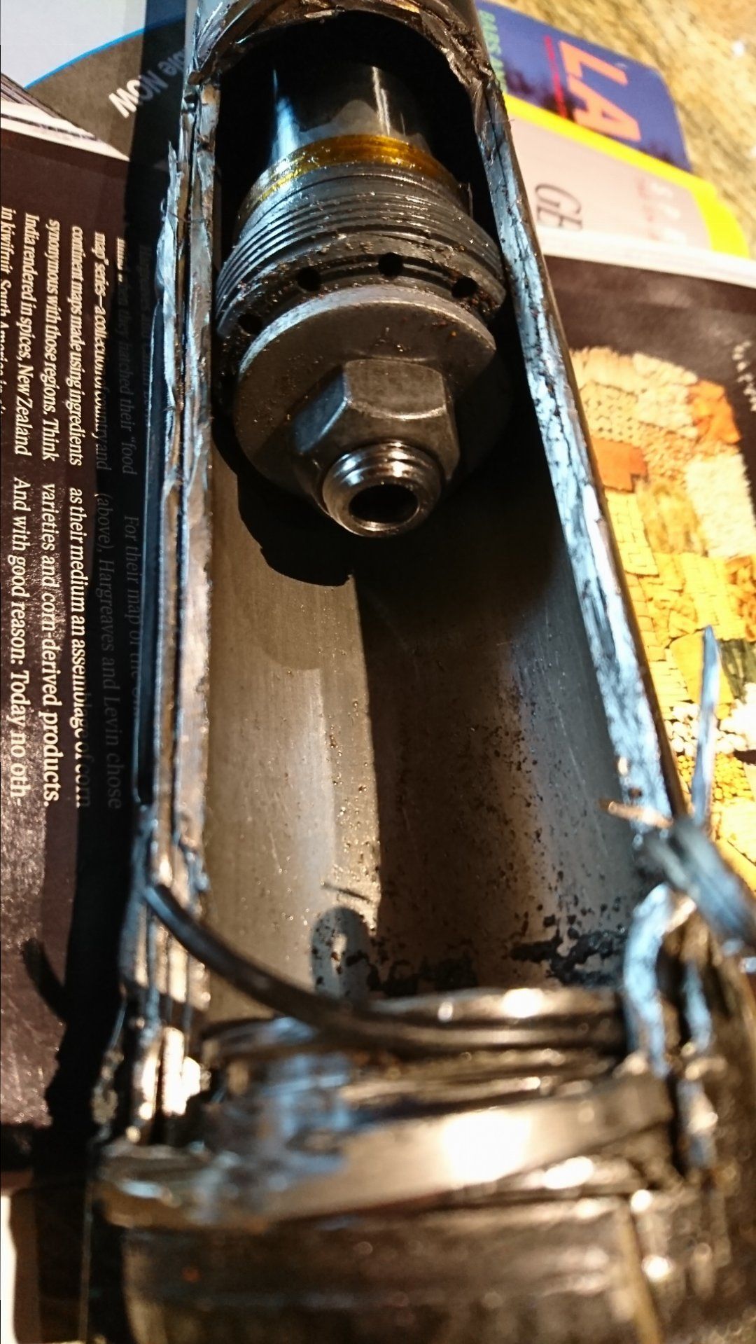

i bought arear shovk for my 08 lexus cut it open and found that its simply a monotube shock inside, so will be having 2 inch extended units made and will use the factory piston and valves, along with this you will need the following.

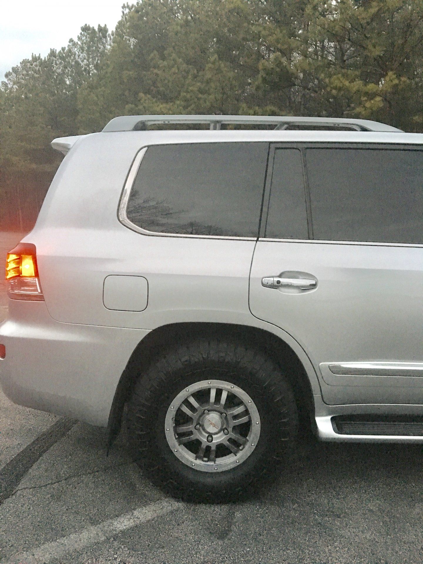

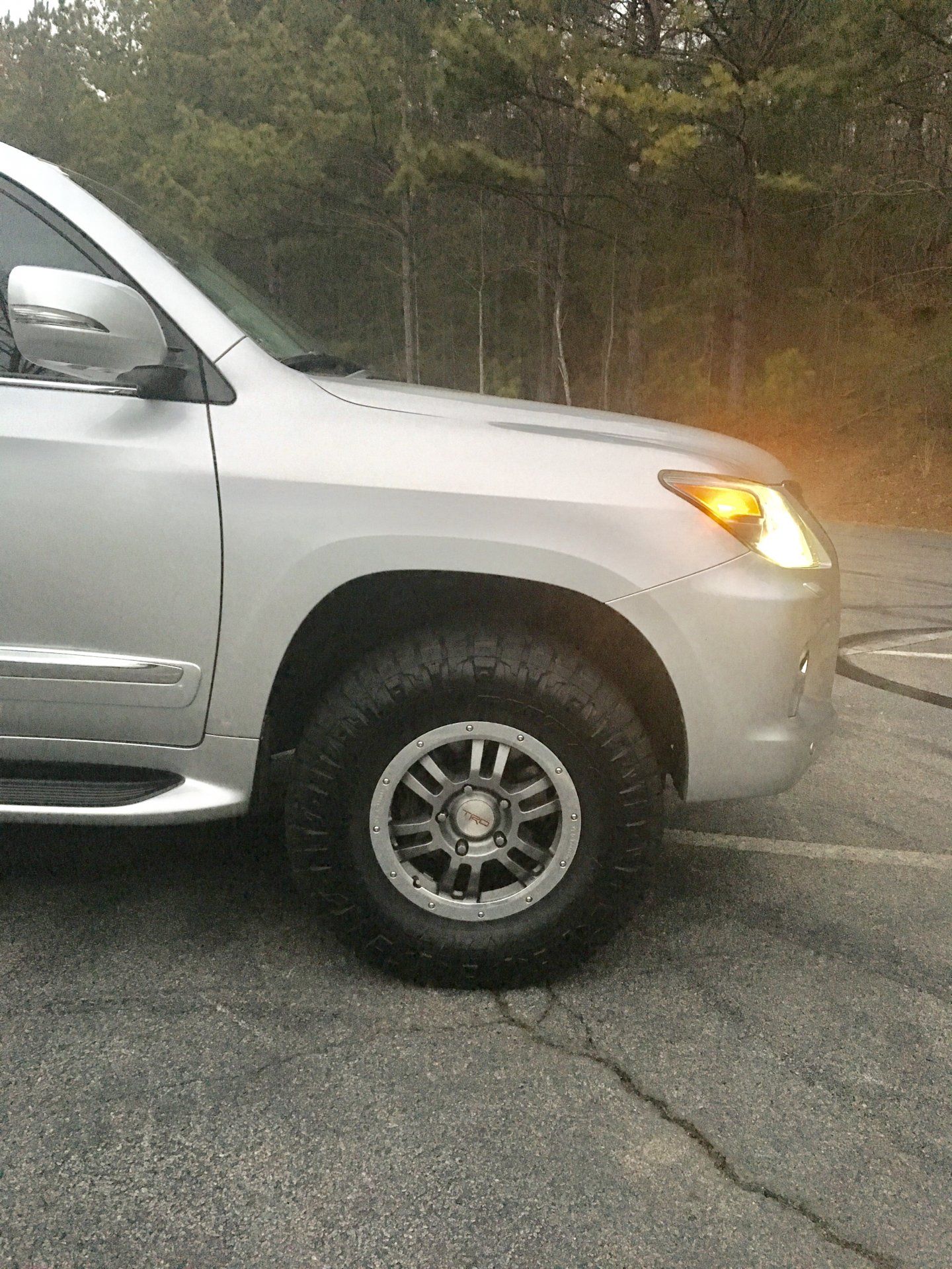

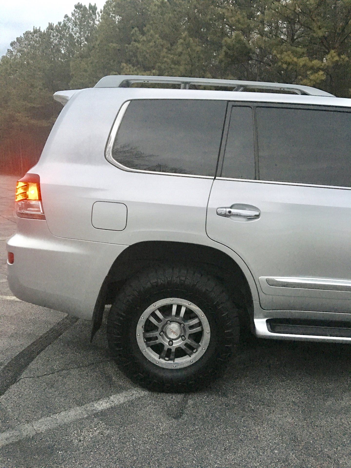

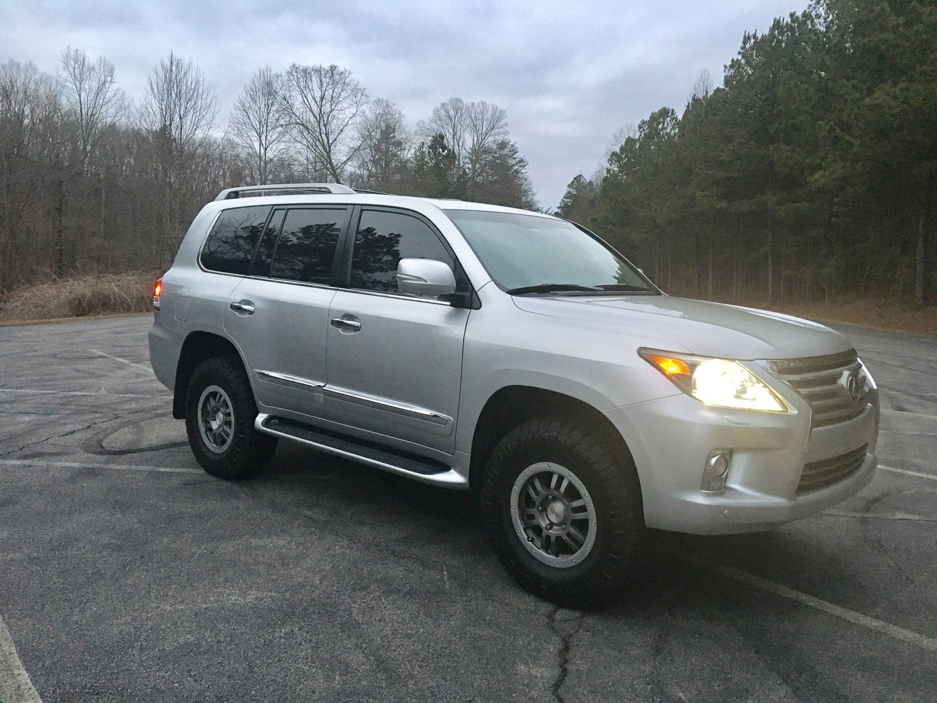

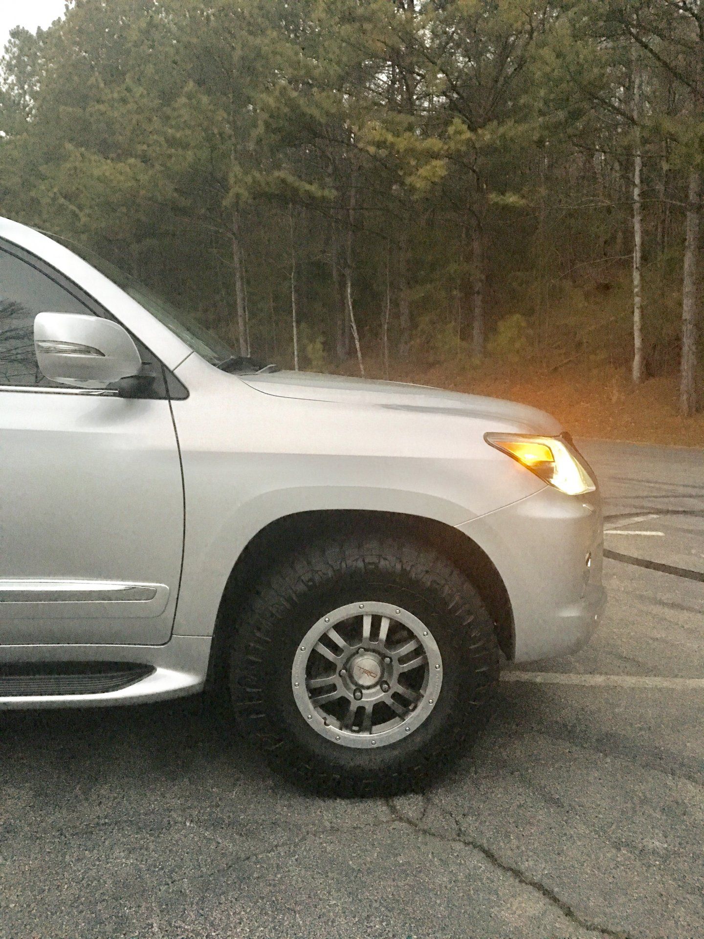

OK fellow LX'rs (we need a cool nickname). I Adjusted the sensor on each corner of the truck and achieved 1.25" of lift roughly. I measured each corner from the fender to the top of the rim. It measured 10" before and 11''1/8-1/4 after in the front and similar in the rear. It also helped to level the rake. Its now 11.25" +-1/8" all around. See Pics. Hope this helps! Its not a massive difference but for 10min in the driveway, i'll take it.
First pics are in H and second pics are in N
Last is in H

any of you wondering wat the shock connections and internals look like hears the rear one i opened up
