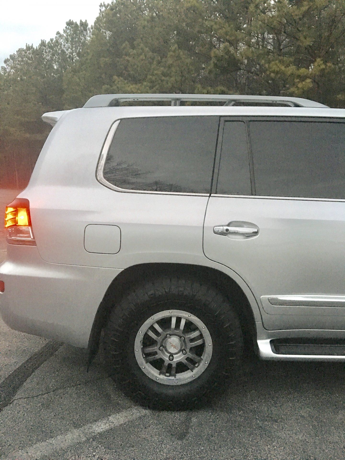

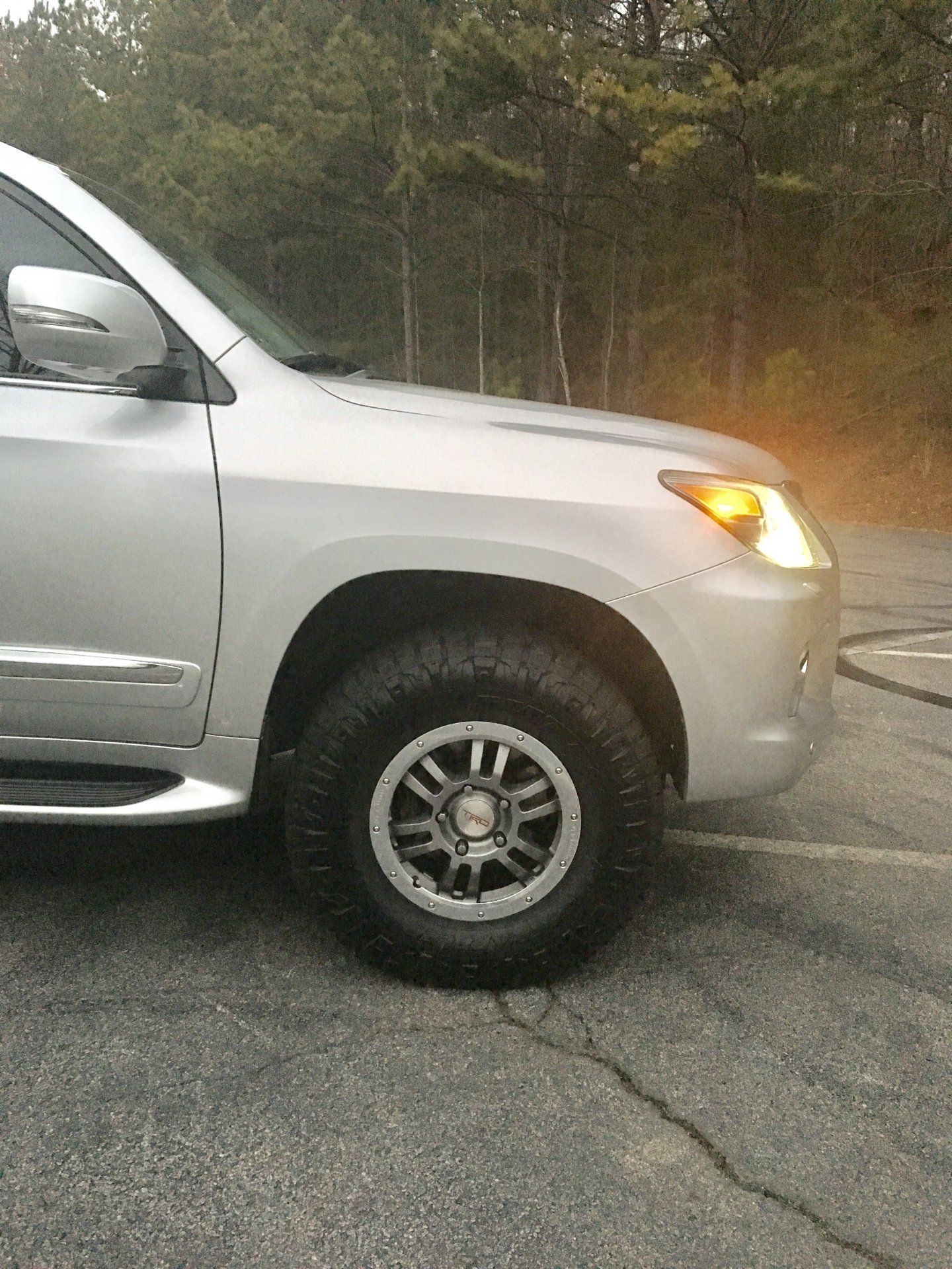

OK fellow LX'rs (we need a cool nickname). I Adjusted the sensor on each corner of the truck and achieved 1.25" of lift roughly. I measured each corner from the fender to the top of the rim. It measured 10" before and 11''1/8-1/4 after in the front and similar in the rear. It also helped to level the rake. Its now 11.25" +-1/8" all around. See Pics. Hope this helps! Its not a massive difference but for 10min in the driveway, i'll take it.
First pics are in H and second pics are in N
Last is in H
Ive only been able to drive it around the corner a mile or two. I am going to have it checked but it isn't pulling or anything like that but we shall see.

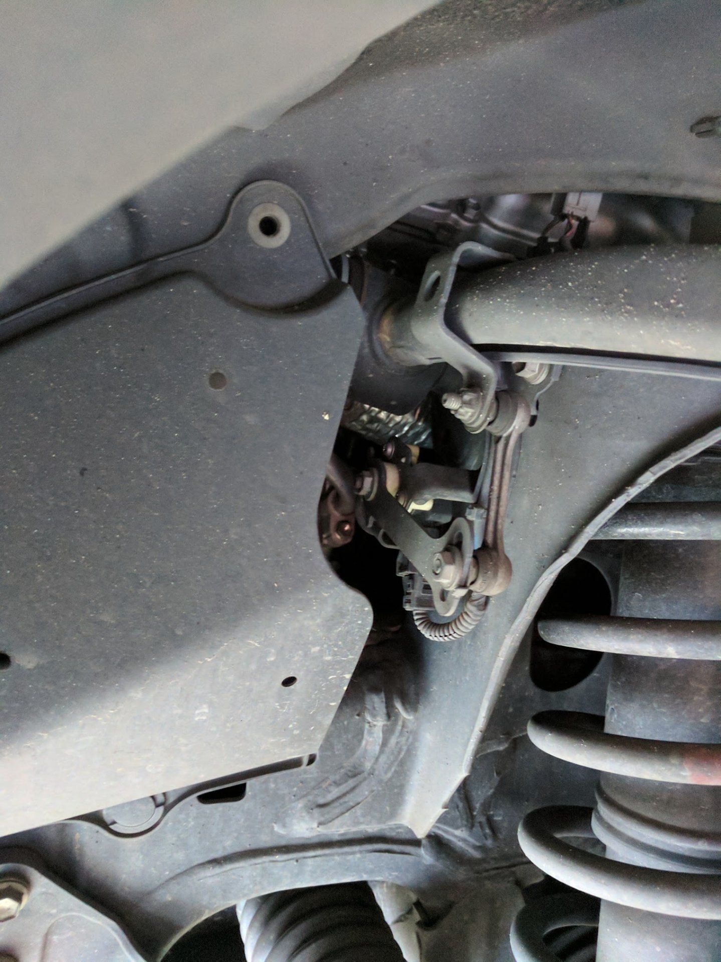

How did you do it? Just by moving the sensor up the guide?
The first picture is the front sensor stock
The second pic is how i moved it.
It was rather simple. I didn't even take the wheels off. I Set the system to High to give myself room.
I pressed the Off button on the AHC system so it didn't move and then turned the car off. The front sensors you slide all the way DOWN (see pics for reference). I didn't get a pic of the rear, but you do the OPPOSITE. You slide them all the way UP. the end.

The AHC still works exactly the same. It lifted everything equally. It's still 2" higher in H.
