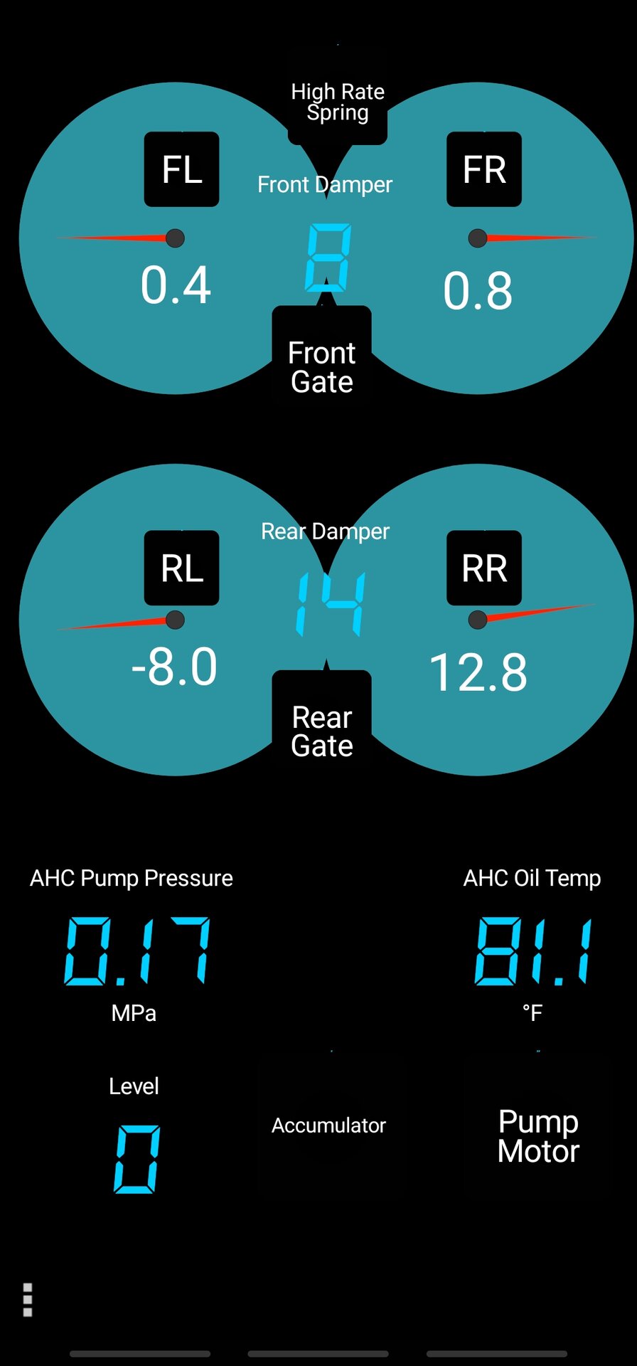

Some initial thoughts:
The Front and Rear Damper Step fields have breakouts for the left and right, as well as the high rate spring valve, but in driving around for 30 min or so, i never saw the left and right have a different value, so i decided to remove the second PID for each setting to save on refresh rate and duplicate data.
I was surprised how often the pump turns on. It's not "all the time" but it definitely makes fine adjustments from time to time. It also uses the pump to raise back up after lowering for highway speed. I wish the refresh rate was faster, i wonder how many changes happen in under 1-2 seconds. The screen refresh is definitely in that 2-3 second range, so it's easily possible the polling can miss an action.
So far I've seen the high spring rate (No. 2 Gas Chamber) turns on during hard braking and during turns.
Damping rate. I'm not 100% sure, but i believe the higher the number the higher the damping force. It moved around quite a bit while driving. And changing the comfort/sport switch definitely changes the values.
I haven't seen the gate valves open much, but they definitely did open once when I was slowing to a stop light. That pretty much verifies that the truck expects the pressure in the left and right sides of the same axle to be the same pressure. I don't' know if the gate valves triggered because of my slowing down, or if they just open and close periodically.
That's all the interesting stuff I've seen for now. Obviously, I need to fix my RR height adjust senor arm, it does stay consistently about 20-25mm higher than the other 3, no matter what mode I'm in.. The truck doesn't really seem to care though.

Did you ever fix your RR height adjust sensor arm? Mine is in a similar situation... just curious what you did to resolve it. Here's min in Normal. I did a front sensor lift only.
I haven't spent much time on it. But at this point I’m not sure there is anything to fix. I think yours is now the 3rd or 4th output to have this same discrepancy. This might be functioning as designed. It might be a function of the longer spring on the gas tank side, but that’s just conjecture.
Looking forward to running your dashboard when my life settles a bit soon.
That side is also the sensor slide bracket with the most length adjustment. There is something going on for sure, and I personally believe its built for RHD and not reengineered for USA. I know thats a ludicrous theory, but at this point im convinced.
The RHD models share so much weight on that one side that I believe it had to be compensated for. And it wasn’t uncompensated for LHD LXs at least.
