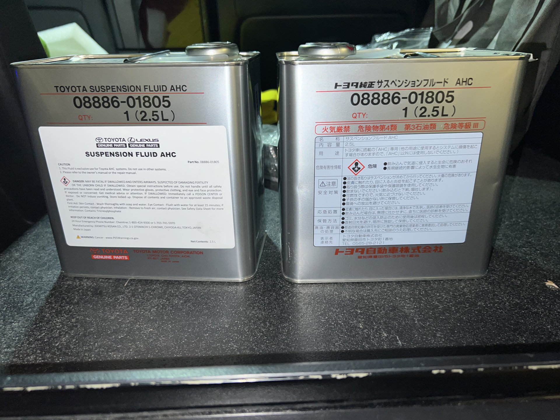

I just bought two 2.5L cans from McGeorge Toyota for $106.40 shipped. Will be here tomorrow.

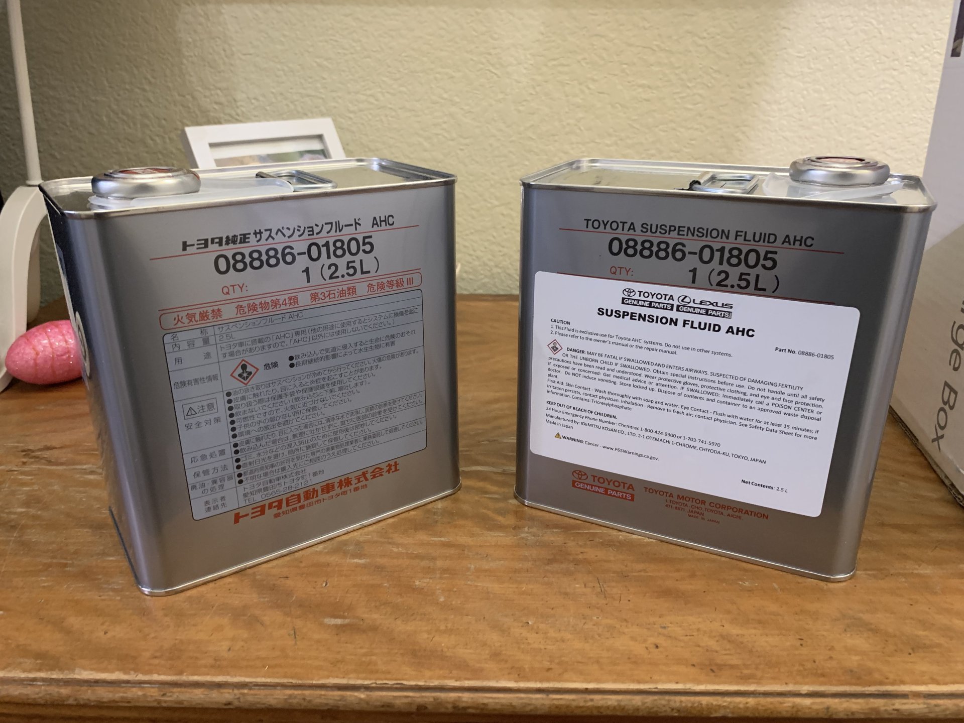

I just bought two 2.5L cans from Westside Lexus in Houston for $155. Looks exactly like the old Japanese cans that got discontinued a while ago. Asked for a discount since I had purchased some bad fluid, and figured it would be easier to return locally if it was contaminated.

I guess I’ll follow @Bryanmc and order from McGeorge…. Thanks for the lead and photo evidence!
