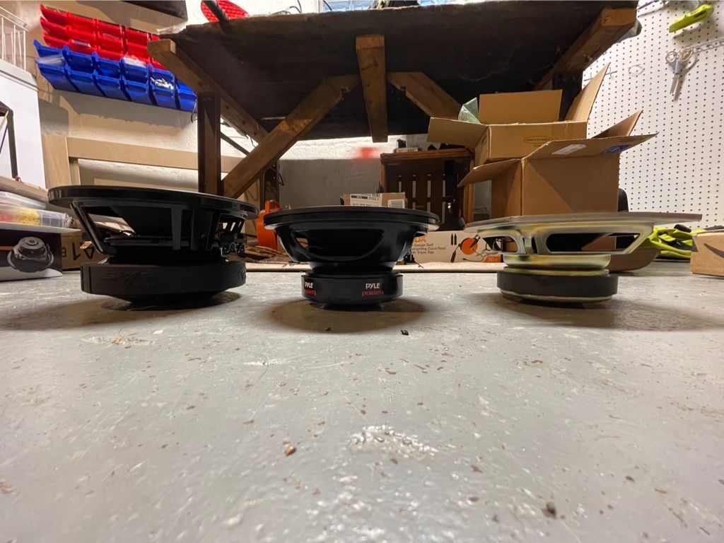

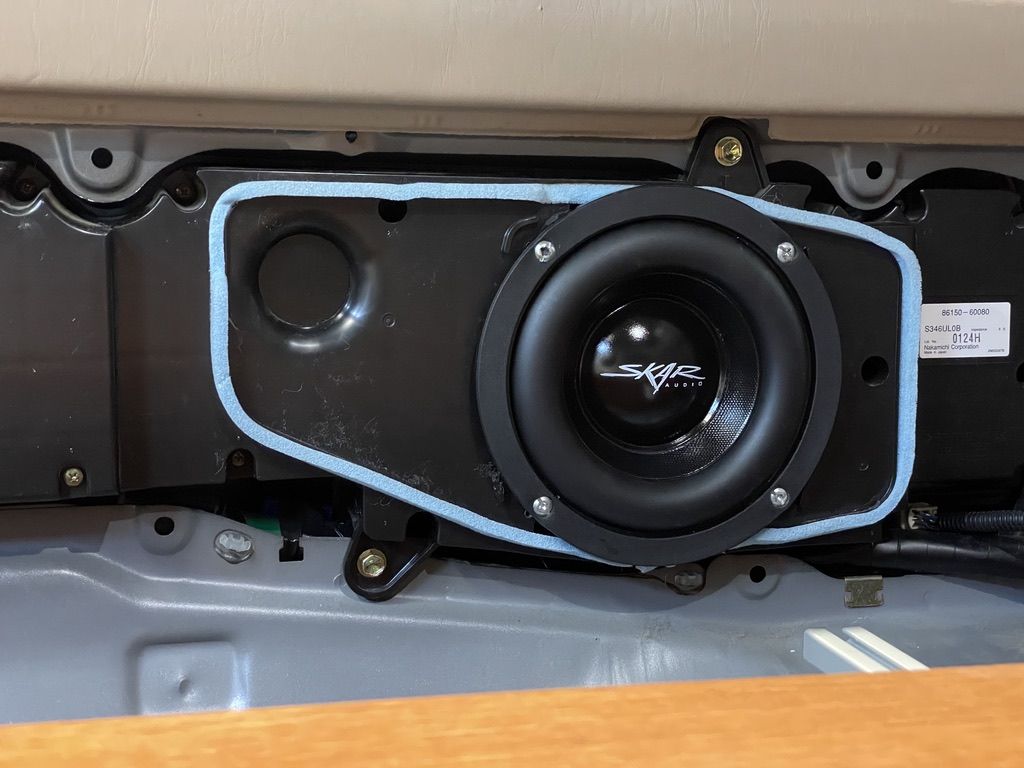

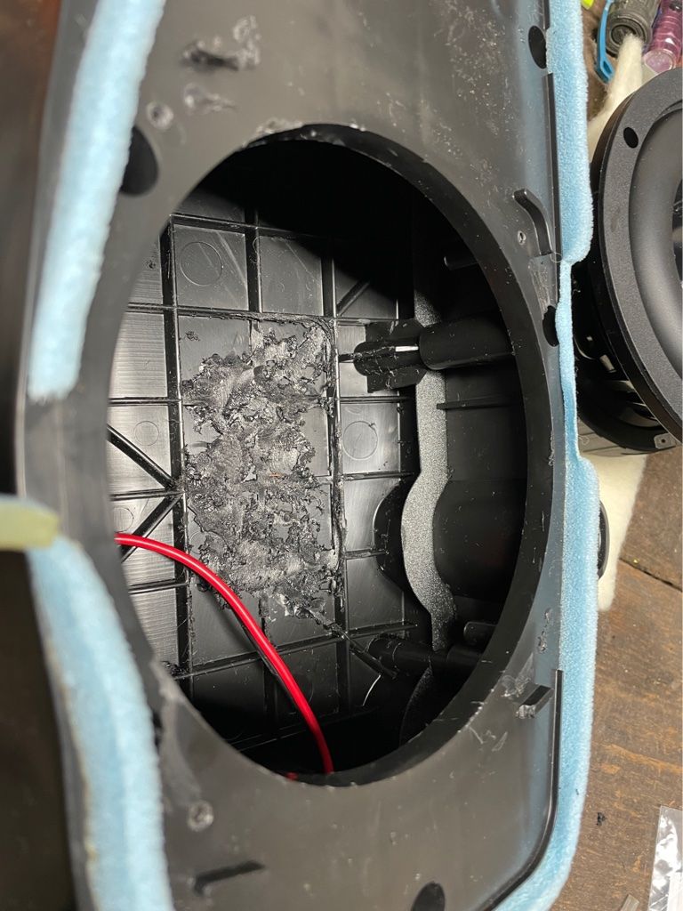

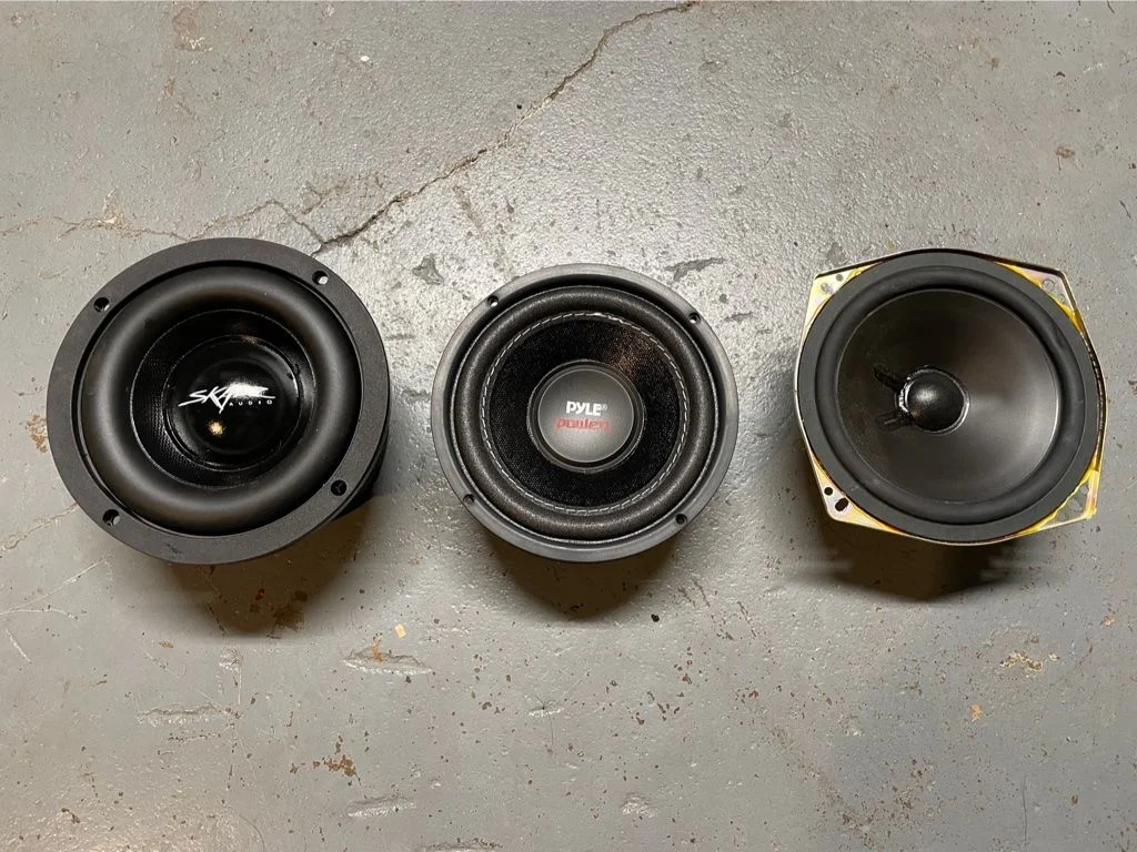

I went with the Skar Audio 6.5" sub. Dual voice coil, 4 ohms each coil. Checked out the (less than) $20 Pyle sub as well, but it was a paper piece of junk. The Skar replaced my Nakamichi sub pretty easily, but did require grinding a couple tabs and the back of the box down a bit:

Probably, but you wont get the trim panel/speaker cover back on if you do that. It's already tight with the fatter rim of the Skar sub

Totally agree with the above. I tried it because I was already working in that space, and to be honest the sub upgrade is a modest improvement. For a few bucks, it was worth the experiment. I wouldn’t do anything more intensive to fit a new sub than the grinding I did in the pics in my first post.
