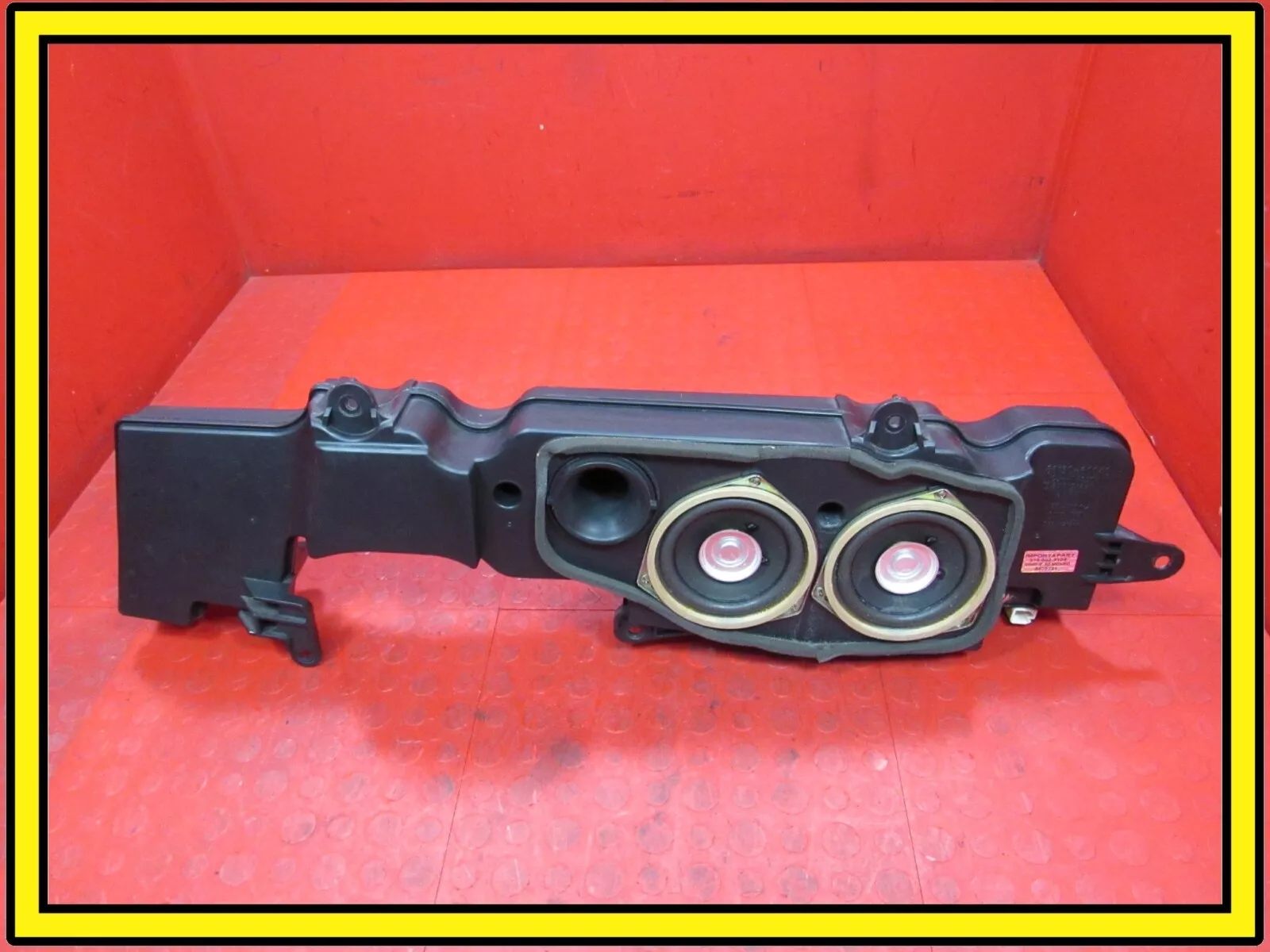

This is the factory front speaker
No, I am in Australia
wonder if one could order that part# hmm. You guys have a lot of cool parts over there. I just saw on ozbestdealz a pair of 300 series style headlights for the 100 series. Looks so good
This one look about right? $22.98?!
This actually works very nicely. No trimming needed. just need to drill new screw holes and use longer screws

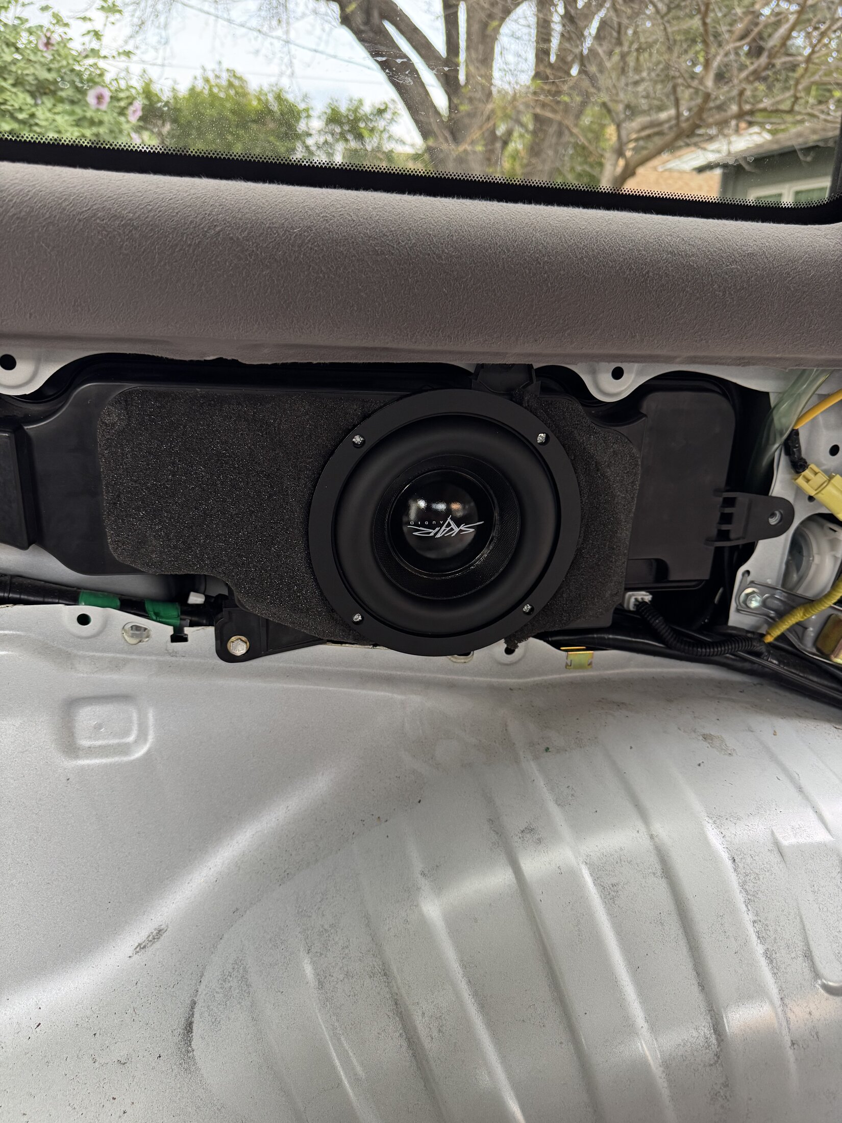

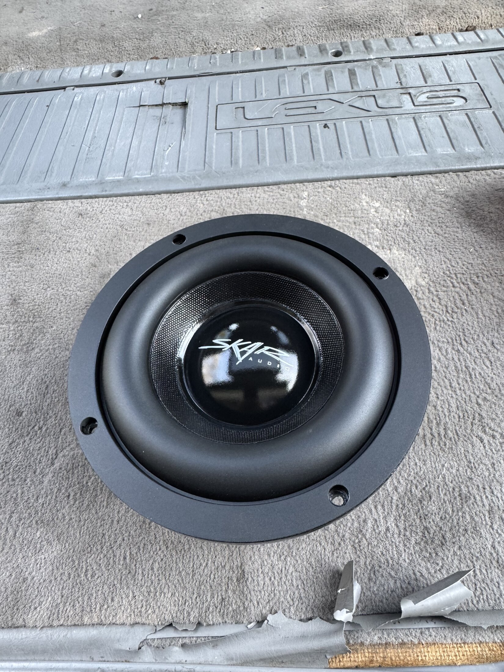

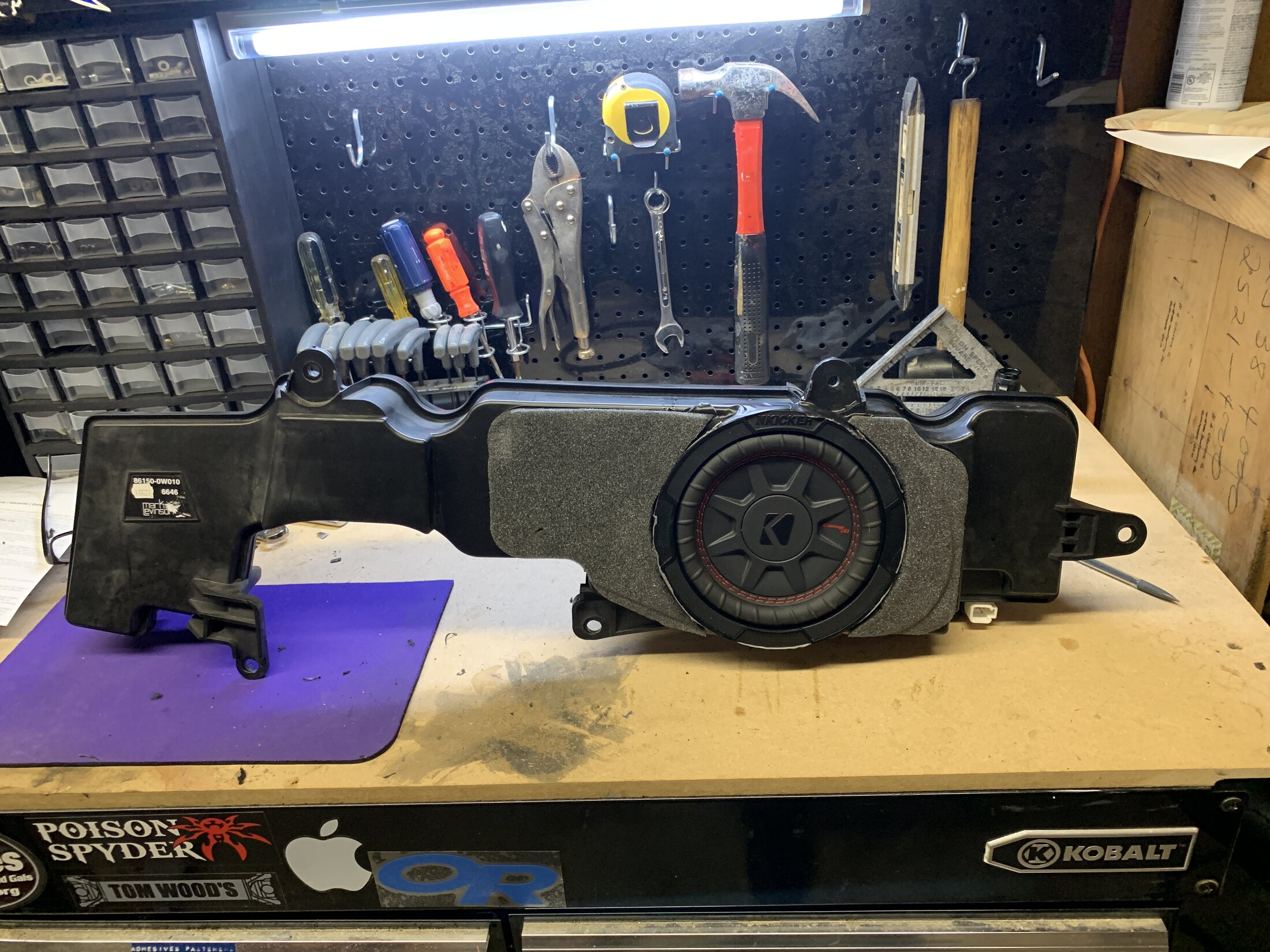

Going to be tackling this soon with that same sub, what were the mods you had to make?
Hello just had to grind or break off some of the ribbing inside the enclosure for it to fit. I would also do the same to the sub cover to avoid any rattling. The sub sounds great and hits quite hard for such a small package.
I followed these instructions
Bought the sub from here.
It's stated in the video but make sure you wire the sub in sequence to make it the 4 ohm necessary to be compatible with the ML sub.
Awesome, thank you! Going to save to watch before I tackle the job. Doesn't sound to bad.

I'd make sure your sub isn't smacking that panel it's behind like TahoeZ said; after replacing my ML with a Skar I still needed to find a way to add a little more space there
