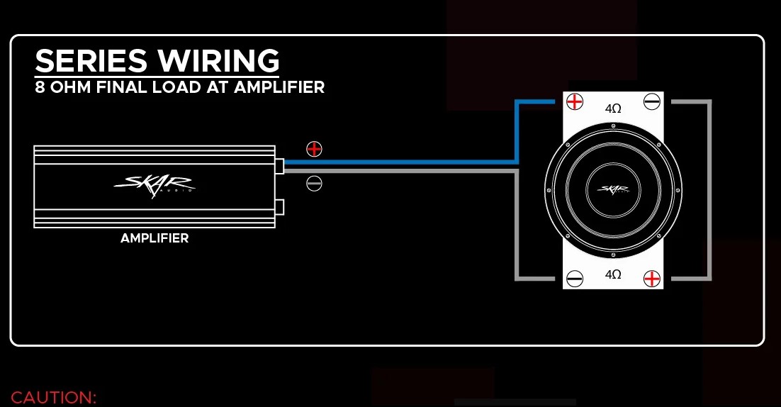

*Editing as I resolved the wiring issue. I had mistakenly wired both the positive and negative wires from the amp to the same voice coil. I moved the negative wire from voice coil 1 to voice coil 2 and then attached the bridge connection from negative VC1 to positive VC2 for 8 ohm operation. All is working well now and it sounds great!
— original post —
I’m tackling this today. I ordered the Skar replacement sub but I believe I made a mistake when wiring it. Per Skar’s website, I wired the positive and negative to one of the voice coils and then attached the other voice coil in parallel. When my audio is turned up or a song draws a lot of bass, the sound cuts out. Here’s the only photo I took. If you’ve done this install, how did you wire your speaker? View attachment 3129049

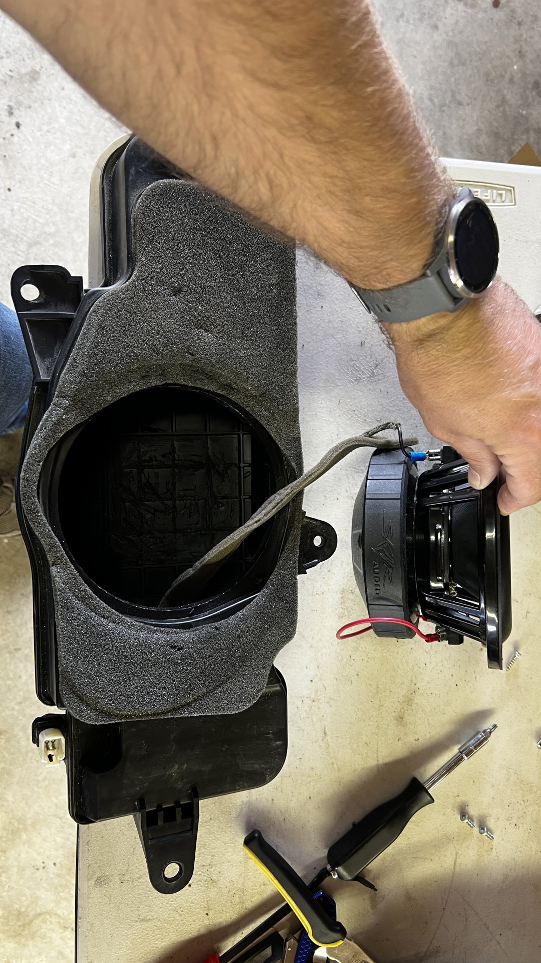

Hey I sent you a PM. How did you get the SKAR to sit flush with the surface of the sub box and make a good seal?
I got the Skar to sit flush by using a Dremel to carve down the ridges on the bottom. I needed longer screws also.

Depends on your old sub and amp. The nakamichi was 6 ohm with one sub channel. Options with a dual 4 ohm sub include 2, 4 and 8 ohm total resistance:
2 - wire both coils in parallel
4 - wire only one coil (or both coils separately from two sub channels)
8 - wire both coils in series
I chose the 4 ohm route which puts a bit more strain on my amp in exchange for a bit more juice. If it’s ever a problem, I’ll switch to the 8 ohm setup.

It will be here tomorrow. Can you confirm that this is the wiring you followed:
Yes. That’s how I wired it . I soldered the little jumper.
You will need longer screws hold the speaker in and a little bit of foam to seal arround the base of the speaker and the box.
This is the foam I used and this is the style of cut off when I used to trim the ribs from the inside of the speaker box. You can use a battery to find the polarity of the factory wires so you wire it correctly.

Thank you! Soldering. Polarity. :oops: This is going to be fun!
lol, just connect it like it looks in the picture. Here is how you check the polarity of the old speaker so you know which wire is + and which is -
This is how I wired it and it seems to be working perfectly! I took the factory harness apart so that I could fully remove the speaker from the box and it allowed me to check the polarity. Once I confirmed the polarity was correct, I put the harness back together, hooked it up and cranked some Rage on my CD player and it sounded beautiful.
