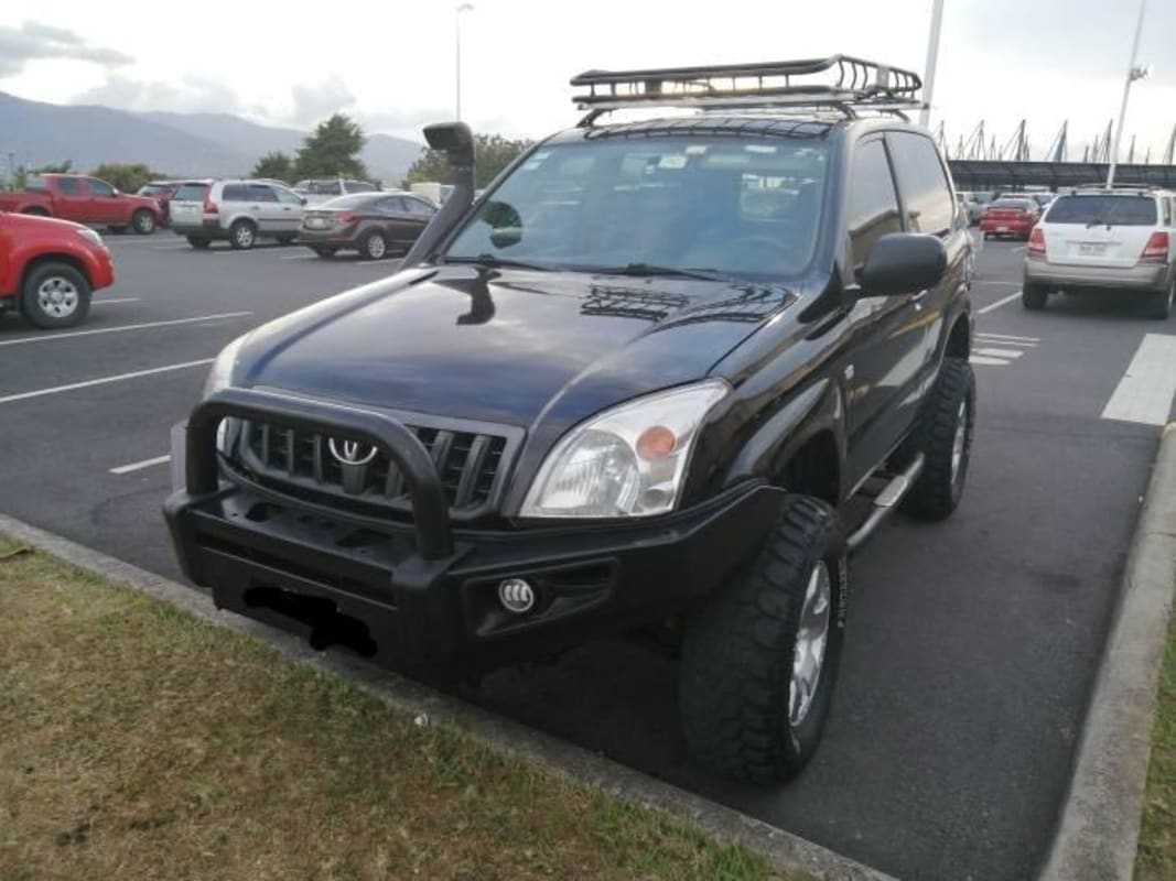

Good looking out on the Prado find... it's actually kind of tempting. That's a good example of our situation. A $20k+ rig i know nothing about vs $9k in fees+5K-10k upgrades for a rig that i know has been babied it's whole life.
