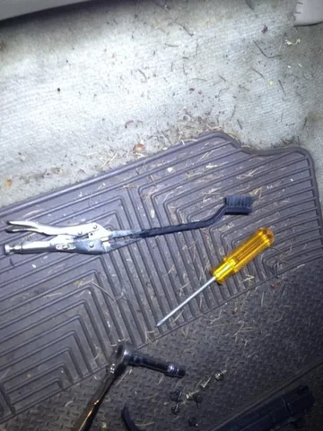

2000 LC and had the door / slot but had no filter. This is what came out when I blew it out with compressed air. Off to order filters. Found them on eBay for 14.88 delivered for the pair. image-3864059539.webp
