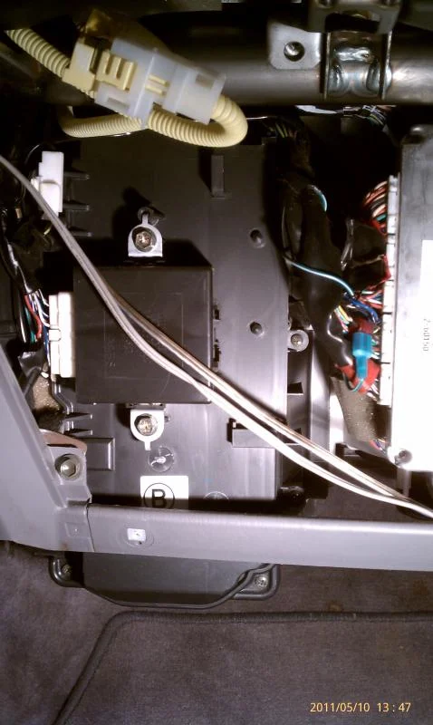

Stumbled across this thread while doing a google search for 2002 toyota land cruiser cabin filter location. Was at the dealer today for 75k service. When going over the 'Quality Vehicle Inspection' sheet, they circled a yellow dot next to the Cabin air filter. I asked about that, said it would cost $80 because they had to take the dashboard apart to replace. So either that service tech didn't know that certain year LCs did not have a cabin air filter or maybe there is some filtration component that is just buried a bit further than what is posted in this thread. Any one have first hand experience with changing a cabin air filter on a 2002 LC that DOES NOT have the access panel pictured in the original post?? The attached pics are from behind the glove box of my 2002 LC.

The black box with the B on it is the evaporator. That is where water would condense within your a/c system.
Maybe I'm looking at the wrong photos? Look a few above your post. The tall narrowish black box houses the evaporator unit. The small black box is the antenna relay / controller.

What is the Black unit beneath the #1 on the first photo? I have a water leak. What is the fix?
Yep, beneath the #1 on the first photo is the evaporator.
The fix is to clean your drain at the firewall. it is a small rubber port on the passenger's side. Look along the curve as the panel turns towards the rear of the car.

interesting, but I believe wrong. The whole bottom of the box is tipped forward so it drains toward the firewall. I don't believe it is designed to be full of water or water tight. The seal is not like an aquarium. I removed my seal as it broke and I didn't have a replacement and I'm not leaking water into the interior. Just a month ago I changed my evaporator.
I'd check the drain again.
