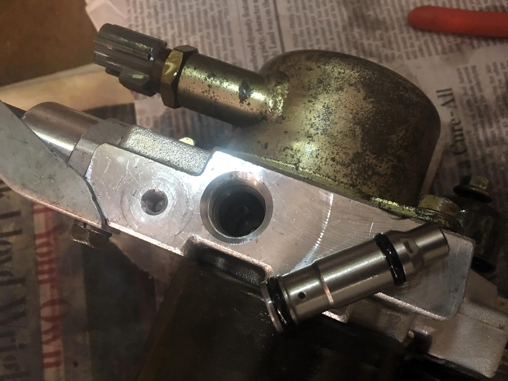

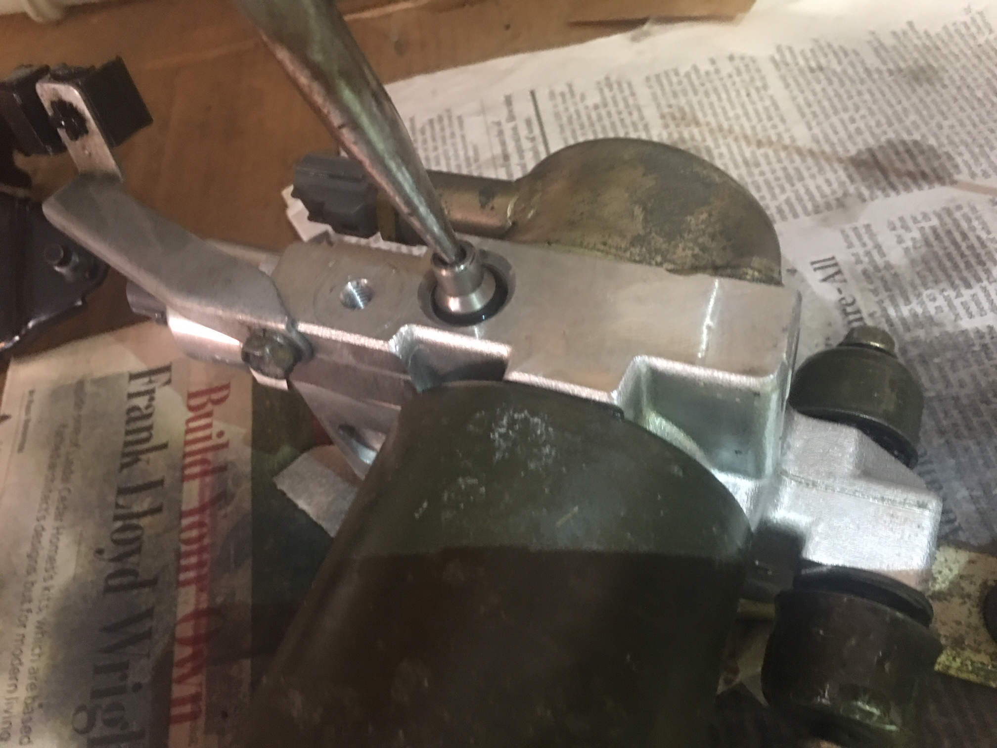

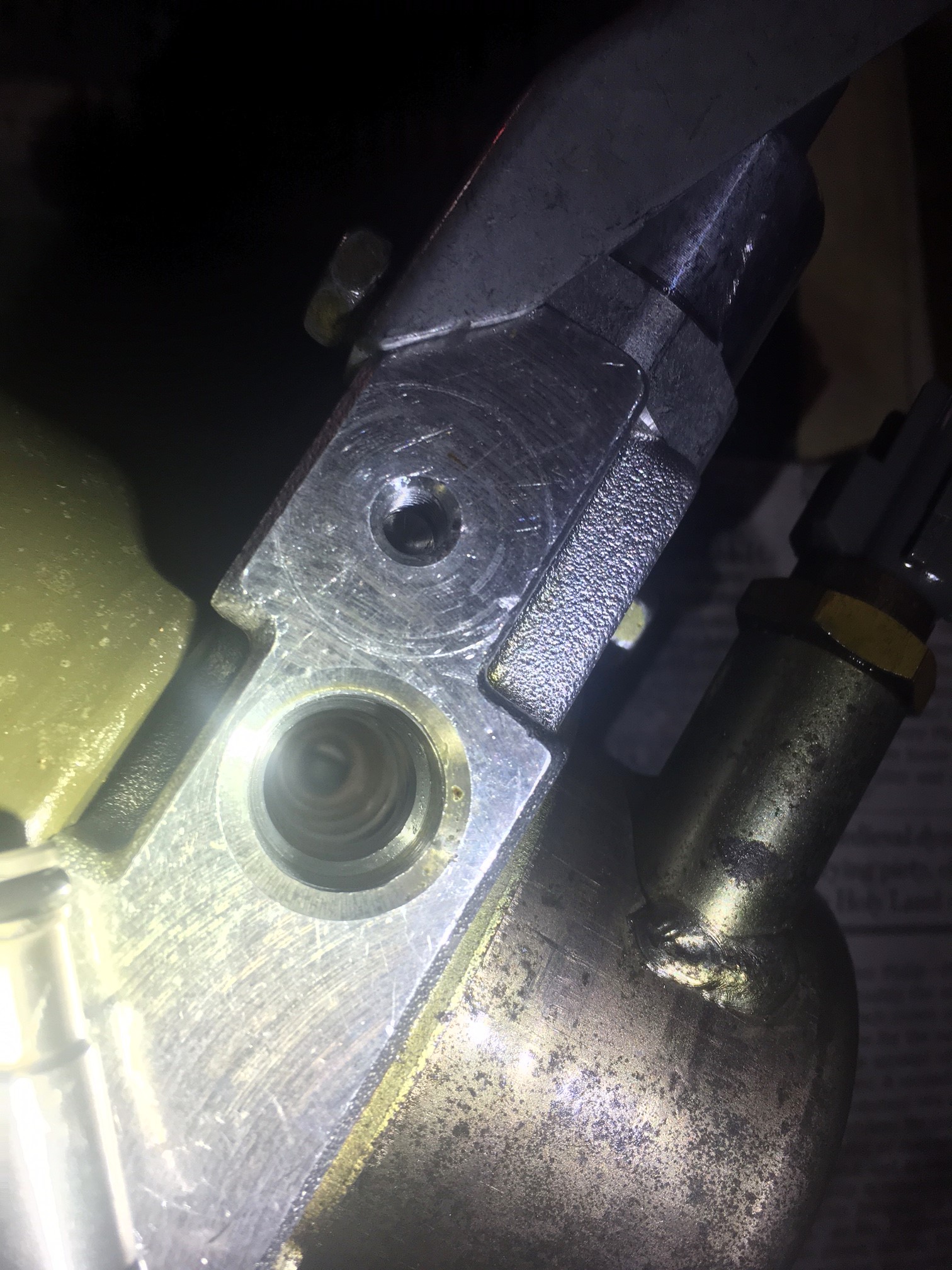

I removed the return valve based on the pictures from Russia last night and attached photos of what it looks like. I too, think something is messed up , and blocking this little valve from functioning. I think the screen in it would prevent such damage since fluid returning to the tank WILL pick up contaminants from a disturbed, open system...like mine. Now that I see how the Russians disassembled the end of it, by prying the end off with a screwdriver as a wedge, I will attempt that today. I cannot understand Russian, but I sure can follow the pictures and his hand gestures as to what to do. IF THIS DOES NOT WORK AND UPON REASSEMBLY, IT CAN NOT PRODUCE PRESSURE, THEN I WILL BE LOOKING FOR A USED PUMP FULL ASSY, & use the part 48905-60010 ($800 ) from a used full assy hole Pump assembly 48910-60012! Indocruise, I am willing to purchase one of your old pump assy, or just the return valve from a working pump, if you are willing to sell it. This is going to be a rare find unless someone from this group is reading this.
View attachment 3673487View attachment 3673488View attachment 3673489View attachment 3673490

GREAT ORIGINAL PICTURES @suprasvobodea !! My old AHC Pump Assembly 48910-60012 is reserved for my son-in-law in Western Australia, so I am not able to let it go. Hopefully you can find an alternative closer to you in Dallas, Texas?
It may be worthwhile to check or post a request in the "Classified" sections of this Forum??
Just thinking about your words -- "I think the screen in it would prevent such damage since fluid returning to the tank WILL pick up contaminants from a disturbed, open system...like mine".

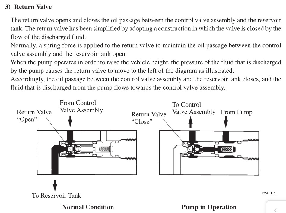

This is true for AHC Fluid already in the AHC Tank. AHC Fluid returning from elsewhere in the system (for example, after auto self-levelling or dropping N > LO or HI > N) must first pass through the Return Valve on its way to the AHC Tank, as indicated in the diagram and explanation below.
This returning AHC Fluid does not pass through the strainer in the Return Valve until it is recirculated later, from the AHC Tank by the AHC Pump.
It seems that all was well until repairs some months ago, such as your change-outs of all 'shock absorbers', all 'globes' and the Height Control Accumulator. It seems possible that you have been unlucky enough for sludge or debris in returning Fluid from elsewhere in the system to have affected your Return Valve at that time. Or it may be that there is a fault in the Return Valve.
Now that the Return Valve is out of the vehicle, it may be possible to replicate and test the two different flow directions [meaning, (1) Fluid returning from the AHC system to the Tank, and, (2) Fluid being sent by the Pump from the Tank tp the AHC system]. Maybe this could be done in both directions by blowing through the Return Valve, or using a jet of compressed air, or devising a method to pump fluid.
Otherwise, dis-assembling then examining and cleaning the Return Valve seems to be the next best step.
Aside from the YouTube clips provided previously, reported problems with the Return Valve are unusual. More pictures of the dis-assembled Return Valve would be very interesting to see -- please post more pictures when you can ....

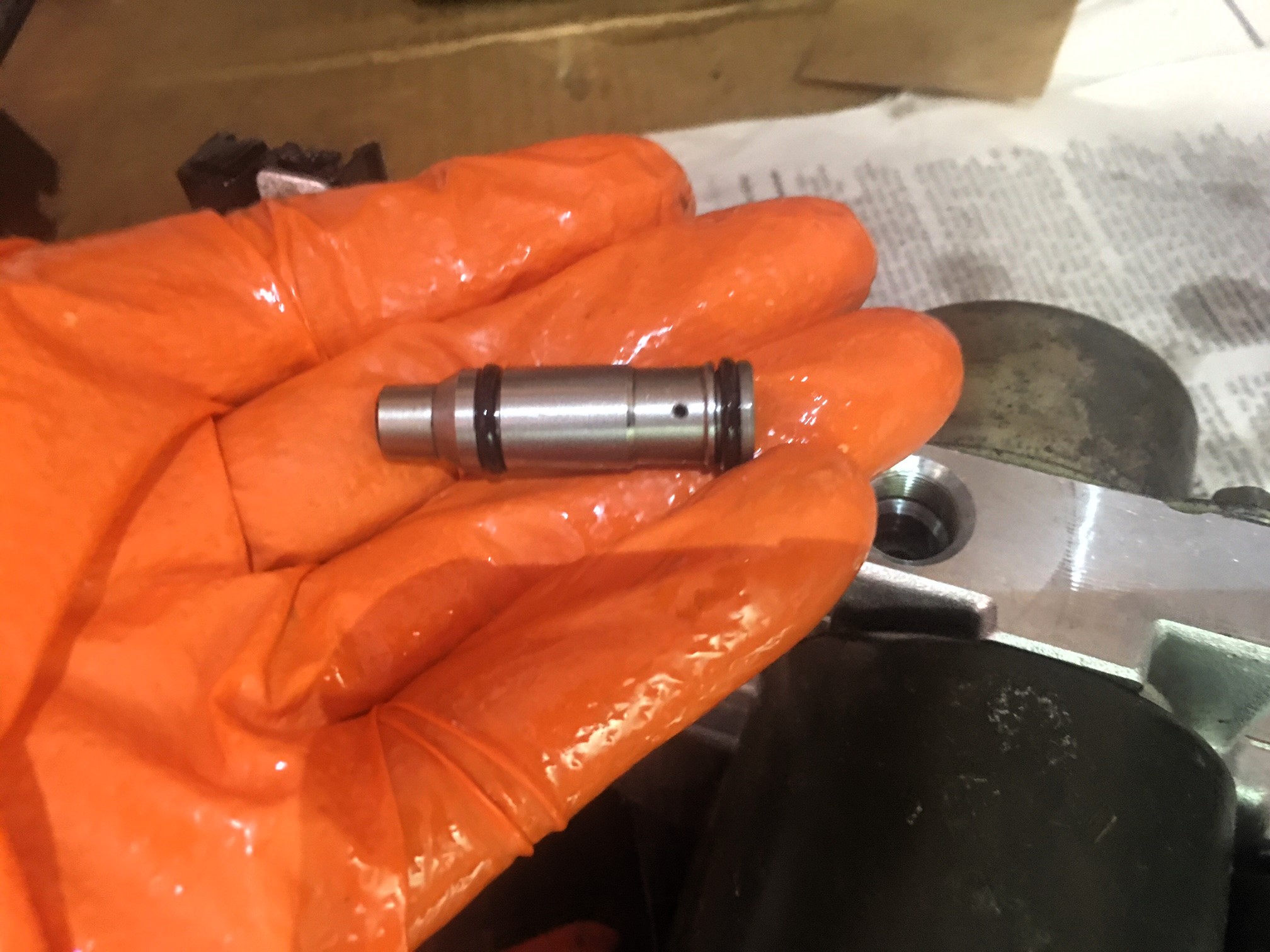

Well, you were right about the RETURN VALVE !!! The simple fact that I could block the outlet with my finger was the HUGE RED FLAG !! After removing the return valve, I just inserted the little tube into the nozzle on a break cleaner can (it is high-pressure aerosol!!) and squirted it out the side holes ( seen in the diagram picture above !) I then re-inserted the valve back into the body and put the tank on with some fluid. I applied 12V to the pump and it shot out a stream, Then I attempted to "deadhead" the outlet and there was NO WAY I COULD STOP THE FLUID! IT SPRAYED ALL OVER! 🤠 😁. So I KNEW that this was one of the issues! I re-inserted the valve & then used the active test and pressed DOWN 5 times to start the test. I pressed UP and the front shocks started to rise! I had a pressure of ~ 3 on TECHSTREAM! I then stopped holding the UP switch. I pressed down then and it went back down, but then I got the 1762 code again. :mad:

It WAS the return valve that was blocked with .... something !! After I removed it, I inserted a tube from brake cleaner in the end, and with the high pressure in the brake cleaner cans, it shot out both side holes ( see the diagram ) After I installed it back in the assembly . primed the base by pouring oil in the small opening where the tank sits in, and angelling it so bubbles would come out the opening.... I tested with 12V and WOW!! I finally could not hold back the outflow... with my thumb !!!!! SO... I knew that was ONE of the issues that was finally resolved. So I do not need a spare return valve.! 🙏

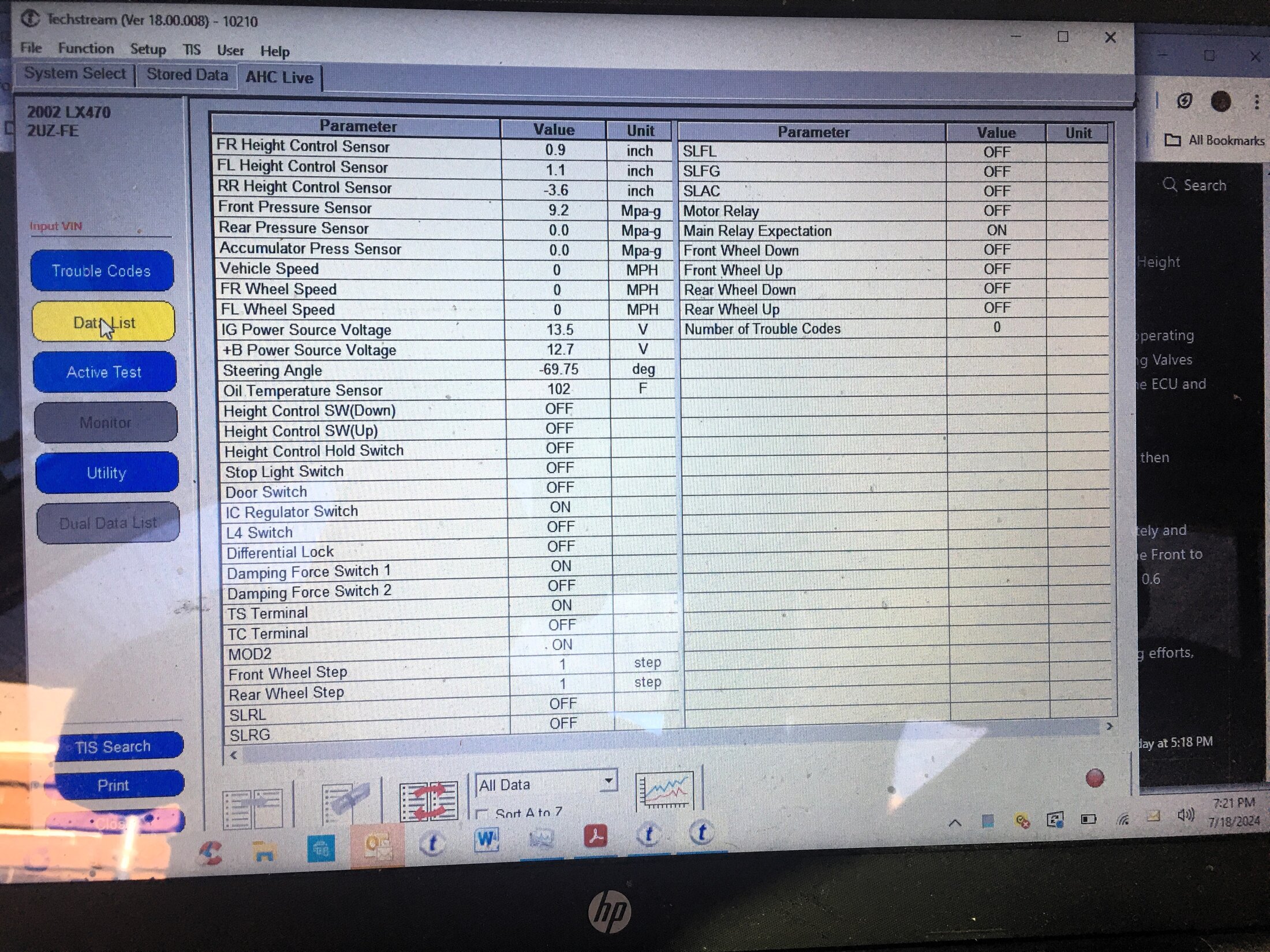

Next, I performed the ACTIVE TEST and pressed DOWN 5+ times immediately to initiate the test. When I pressed UP - once ( not holding ) the FRONT started pumping and RISING !!! 😁:) I got it to almost 0.4 height control sensor on TECHStream readout and 3+ Kpa pressure! & 0.0 on the accumulator sensor.
However, when I pressed and HOLD the UP switch to activate the rear shocks, ... the front struts dropped back to the stops and the rears did NOTHING! I checked the front globes, there was a tiny bit of air. I then check the accumulator - NOTHING. then the rear globes... NOTHING ...
Since I have TECHSTREAM, I did all the ACTIVE tests,,, life the front & rear Leveling solenoids,(SLFL) (SLRL) the Front and rear gates (SLFG) & SLRG)
The funny thing is, the REAR SLRL won't activate..?!!! Which I thought was strange.
This might be the reason why the REAR shocks failed to rise after the fronts did!! There is NO OIL BEING PUMPED TO THE REAR SHOCKS! OR THE ACCUMULATOR.
What are your thoughts and questions about why the REAR globes won't work, but the fronts will? What should I check next?? I NEED TO GET THIS LX WORKING SO I CAN LEAVE FOR WISCONSIN TO SEE MY MOTHER BY THIS SUNDAY! I feel I am SO CLOSE ...... I have all the new parts... i can get the fronts to raise and NOT throw a 1762 code for a while ( eventually it does !! :mad: :mad:

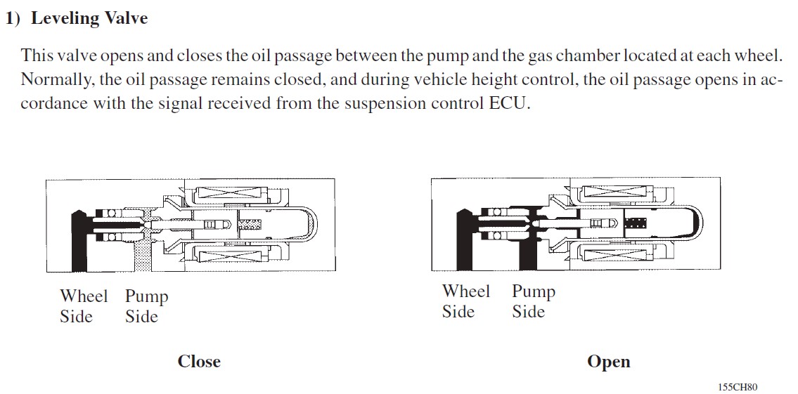

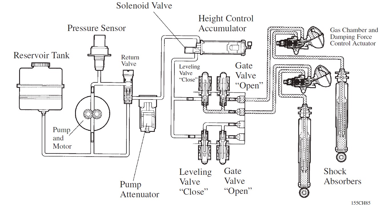

AHC Hydraulic Circuit with vehicle at rest, AHC system not operating, Levelling Valves closed, operating as check valves to hold vehicle height:

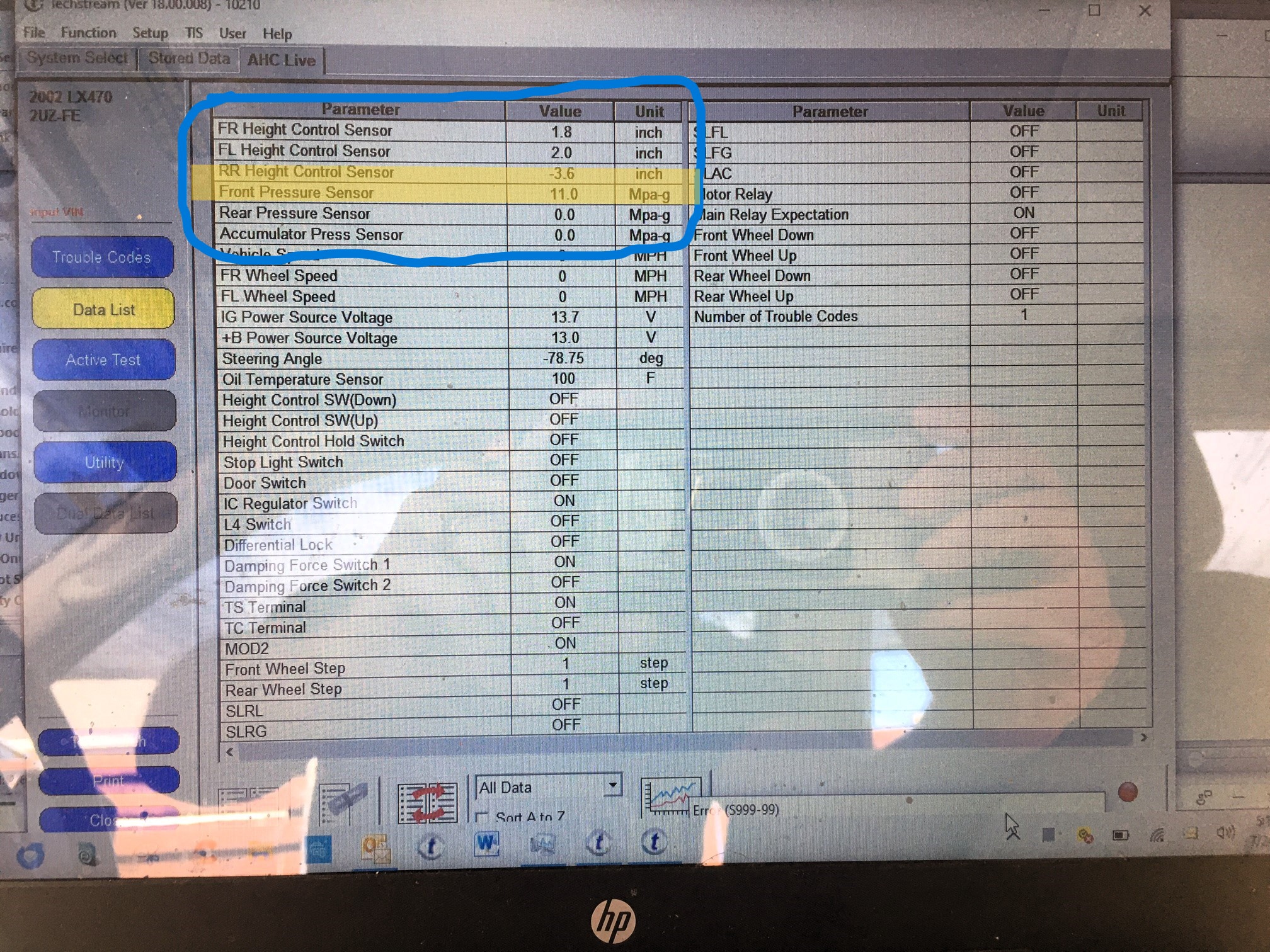

This is worrysome, as i could NOT get the leveling for rear to move. HOWEVER< when i performe the ACTIVE TEST featur of teck stream , which allows you to trigger the Motor relay, AHC relay, and the 4 leveling and gate valves. I did get them fronts to turn on and off. however only the rear gate valves would function ... which is VERY strange. Thats probably why the rears did not raise...... so whatsup with that ,,??

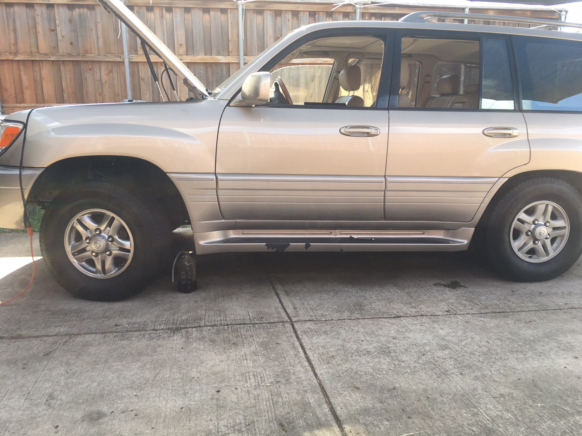

GOOD NEW UPDATES 7/26 >>>>
I did some more testing and have new updates. ( with pictures of Techstream and my LX. I did the ACTIVE TEST from Techstream's dashboard and posted the results below.
This is the FIRST TIME in 5 months that the FRONT globe has held pressure and the height indicators are POSTIVE! :) 🙏 The pressure on the front is good as well. (11.0) I tested the 4 Gate and Level valves ( SLRL, SLRG, SLFL, SLFG) The results are as follows: Both front SLFL, and SLFG did switch from OFF to ON momentarily - which makes sense since the fronts have pressure and the truck lifted 3.5" !! However, the REAR pressure would not increase and the rear did not raise as all. ( See photo)
That is my LX which now has the Front at normal height and the rear on the bump stops. The Issue seems to be the REAR SLRL - the rear lift valve is not getting a signal to open. So I disconnected the connector and tested the continuity of both the connector and the control valve body itself. ( See photo)

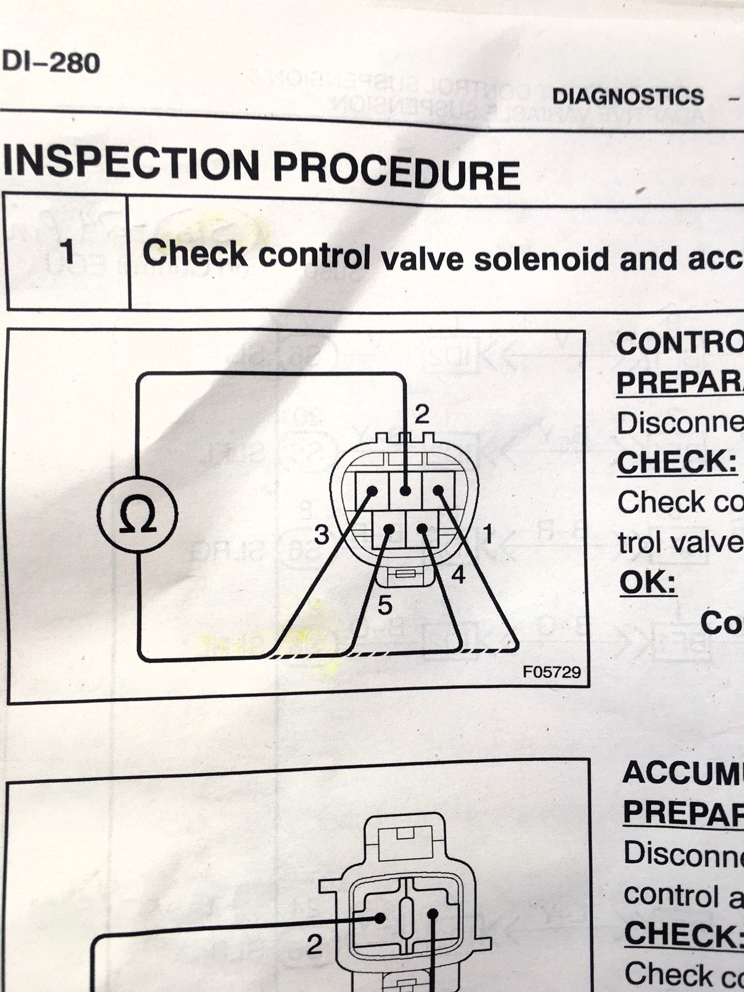

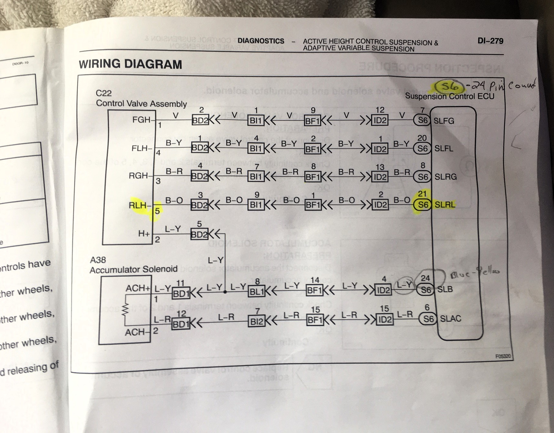

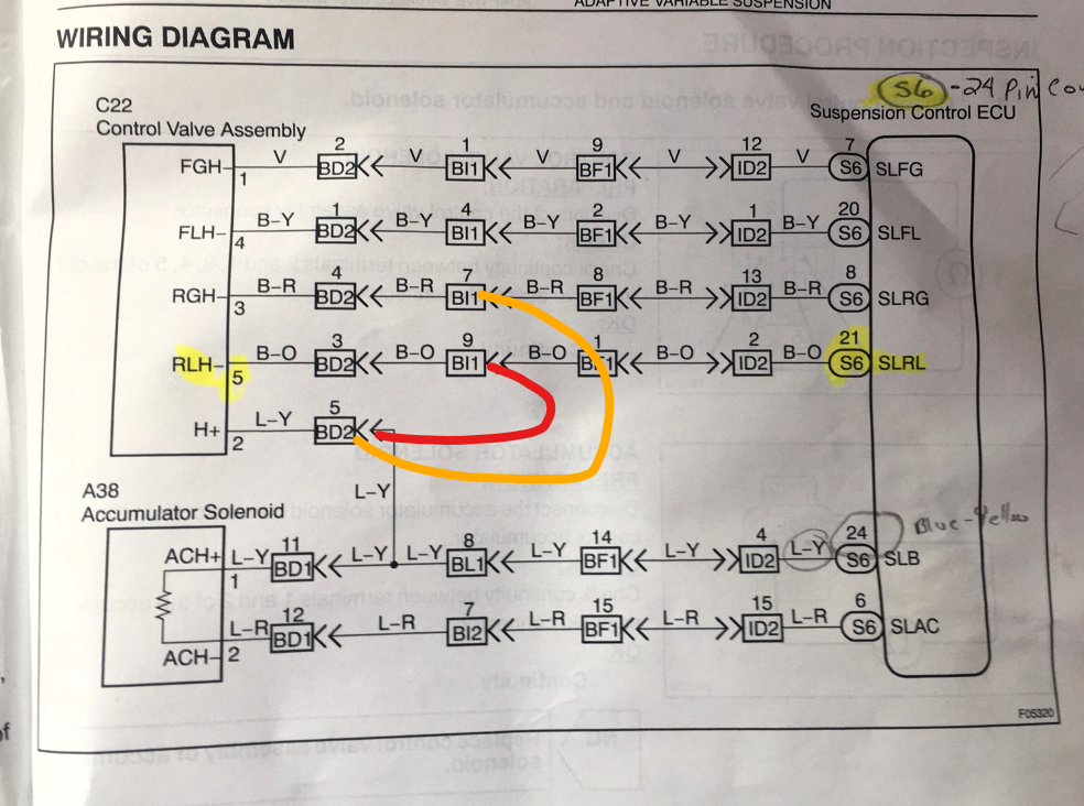

I got continuity from #2 >> to 1,3,4,5. I tried to check continuity from the connector from the Control valve through the wire harness to the AHC computer, especially the RHL lead on the control valve (#5) B-O wire >> AHC connector (#21 B-O) wire but I didn't have a small pin to stick in the AHC connector. However, in the previous test, I checked #2 on the control valve to the other 4 pins, and all showed continuity. This leads me to the last question, and maybe the final, unanswered question as to WHY the ACTIVE SLRL test I did with Techstream, did NOT WORK?!?!?!? I NEED THE ANSWER TO THIS TO FINALLY GET TO THE 1762 CODE CONSTANTLY RETURNING.
Indocruise, or anyone on this, what do you think I should check out next??

I just developed a NEW code, 1731 which the TSM says is a FRONT Lift valve. I tried repeatedly to delete with both tech stream and doing the jumper system in the engine bay, and it WOULD NOT DELETE. I then checked the description and it mentions B+ <10 V it will trigger the "fail safe" system .
When I checked the Volts at pins #13 (W-L) and #22 (W-B) it supposed to be 11-14V and mine is just 1.7 and slowly drained down to 0.2 V . My question is , WHAT IS B+ VOLTAGE AND WHERE DOES IT COME FROM ON THE ACH COMPUTER?
I didn't understand, did the SLRL & SLRG switch with the Active test or not? If they did not - use a piece of wire or a paperclip to stick in the AHC plug and check continuity.
  • If you don't have continuity - BD1/2 are notorious for corroding inside the plug. They are in a super sh1tty place too.
  • If you have continuity - apply power directly to the solenoid pins on the control valve and see if it will switch.
    • If it doesn't switch - bad control valve assembly
    • If it does switch and you have continuity - bad AHC ECU

The coloured Electrical Wiring Diagram (EWD) may be of assistance in tracing the relevant circuits. By the way, please note that the circuit for the Rear Height Control Sensor also passes through the BI1 connector and loss of continuity here can be a cause of aberrant behaviour of the AHC system.

I did some more testing and have new updates. ( with pictures of Techstream and my LX. I did the ACTIVE TEST from Techstream's dashboard and posted the results below. View attachment 3686965
This is the FIRST TIME in 5 months that the FRONT globe has held pressure and the height indicators are POSTIVE! :) 🙏 The pressure on the front is good as well. (11.0) I tested the 4 Gate and Level valves ( SLRL, SLRG, SLFL, SLFG) The results are as follows: Both front SLFL, and SLFG did switch from OFF to ON momentarily - which makes sense since the fronts have pressure and the truck lifted 3.5" !! However, the REAR pressure would not increase and the rear did not raise as all. ( See photo) View attachment 3686966
I got continuity from #2 >> to 1,3,4,5. I tried to check continuity from the connector from the Control valve through the wire harness to the AHC computer, especially the RHL lead on the control valve (#5) B-O wire >> AHC connector (#21 B-O) wire but I didn't have a small pin to stick in the AHC connector. However, in the previous test I checked #2 on the control valve to the other 4 pins, and all showed continuity . This leads me to the last question, and maybe the final, unanswered question as to WHY the ACTIVE SLRL test I did with Techstream , did NOT WORK?!?!?!? I NEED THE ANSWER TO THIS TO FINALLY GET TO THE 1762 CODE CONSTANTLY RETURNING.
Great update. Pictures are helpful.
My approach, having seen multiple harness faults in this area:
Pull the BI1 connector apart. It's in the rear driver quarter of the frame. It can help to spray those connectors down with water to clean off dried dirt. You should measure the continuity checks from there. You don't need to measure towards the ECU. The ECUs are essentially bulletproof. The wiring in this area is the complete opposite.
You should get all the same measurements from BI1 to the solenoid as what you measured right on the control valve. If not, there's your issue. I repaired a customers car by running a new lead from the connector at BI1 (or perhaps the other big one right there) straight to the height control accumulator. The harness in between had shorted to ground and was causing problems, including code 1762. He checked back in a year or so after the repair and all was still well.
If the wiring doesn't show any problems, then I'd apply power manually and force that valve to actuate. Perhaps it just needs to flick on and off a bunch to clear a bit of debris.

Low B+ is pretty much 100% sign for wiring harness issues. I have seen it as a symptom in many failed AHC issues and it always was caused by broken wire or corroded plug.
My bad, BI1/2 are the easiest to access, they are under the rear bumper. The BDs between the frame and body, right next to the wheel, are the hard to access ones.
Anyway, check continuity from ECU to valve assembly, then ECU to BI and BI to valve assembly, somewhere along the way you should find the problem.

SupraRXnut:
So you are saying I disconnect the Bl1 back by the bumper and check the 4 wires at the Bl1 >> to the solenoid ( basically testing impedance THRU the BD2 connector > to the corresponding pin on the disconnected control valve 5 pin connector I show in the picture in post #152? is that correct? I also realized fro the wiring diagram that B+ is the output of the main AHC relay!!! So I am going back outside to test this relay - again. It was working, but that output feeds right into B+ on the AHC control computer pin #13. "I'll BE BAAAAAACK ! 🤠
That sounds like a solenoid issue. Have you tried the active test in Techstream that opens and closes it? It keeps it open for about a second and then automatically closes it. You can hear it click. If that doesn't work you could apply 12V directly and see if that does it, combined with forcing the pump to run.
Considering you had debris in the return valve, it is possible that there might be a contamination in the system that affects the solenoids.
