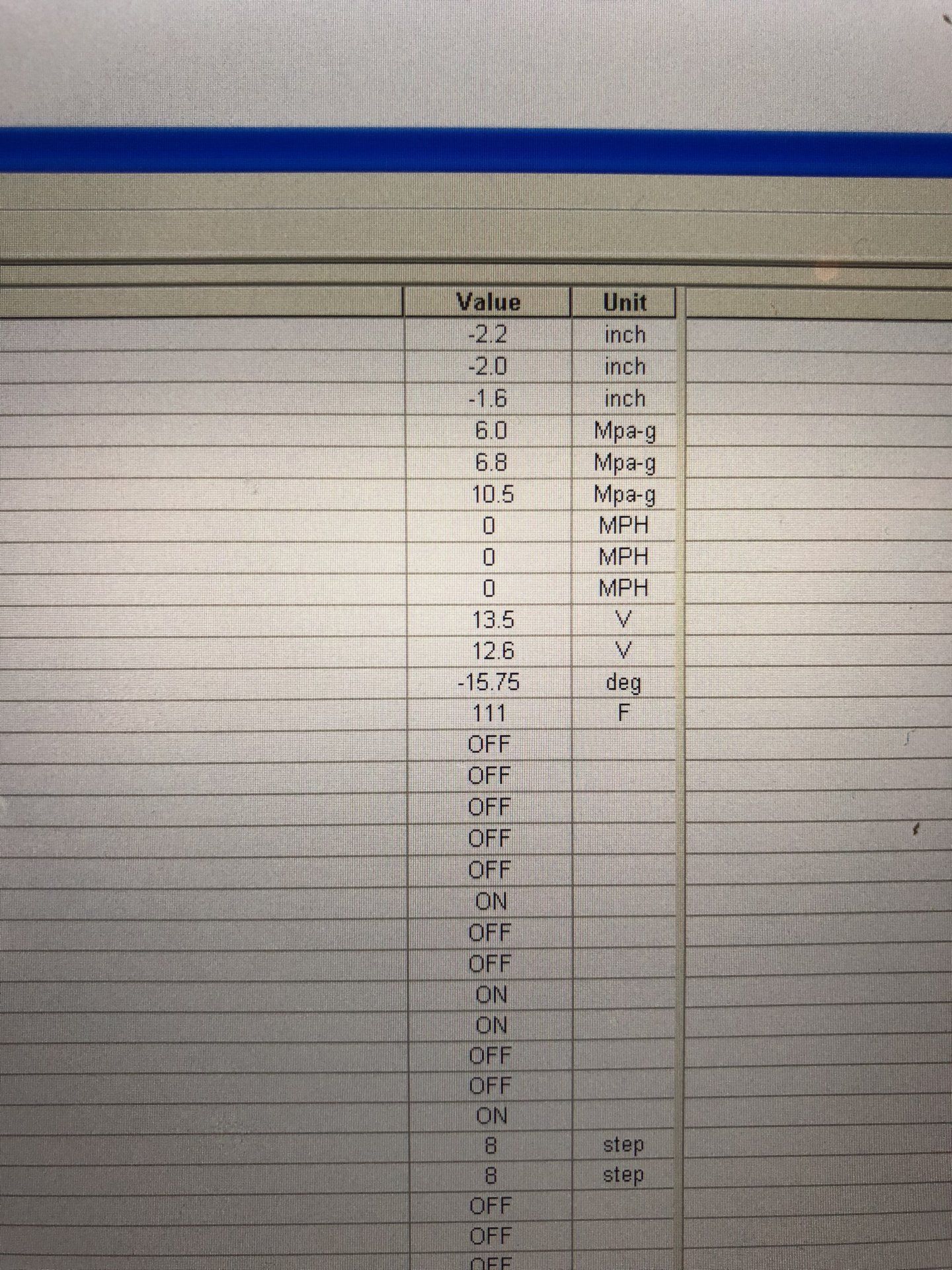

I cant answer as well as Paddo, but have u measured hub to fender and looked at torsion bar corrections?.
I have. But, I'm going to do it all again. My problem is I haven't had enough time to do this evolution all at once. I get some time here or there to take care of one aspect.
In the front I was 485 mm on one side and 490mm on the other, 500mm being ideal. I have small tweaking to do there. My main concern is the rear at this point.
I guess what I'm really trying to do is validate my understanding of how the system operates. Now that I have new coils and spacers installed, my assumption is that reducing the height in the rear (via sensor adjustment) will bring the pressure down. I have read the "Definitive AHC Maintenance" thread at least twice, but probably need to do it again...
Also, where did you get your AHC springs? I will be looking for some soon.
See @beno for all your OEM part needs. I purchased the spacers from @cruiseroutfit.
@ChuckB either extra height or extra weight or a combo of both in the rear will give higher than desired pressure readings. Check your heights and adjust if necessary. Also the FSM call for the temperature sensor to be disconnected when you raise from L to N to read rear pressures. Personally it doesn’t make a difference on my vehicle and several others I’ve worked on but some here have done it the FSM way and read lower rear pressures that were in line with expectations.

@ChuckB Also the FSM call for the temperature sensor to be disconnected when you raise from L to N to read rear pressures. Personally it doesn’t make a difference on my vehicle and several others I’ve worked on but some here have done it the FSM way and read lower rear pressures that were in line with expectations.
Thanks!
@PADDO, learn something new everyday. Will check heights and then go from there.

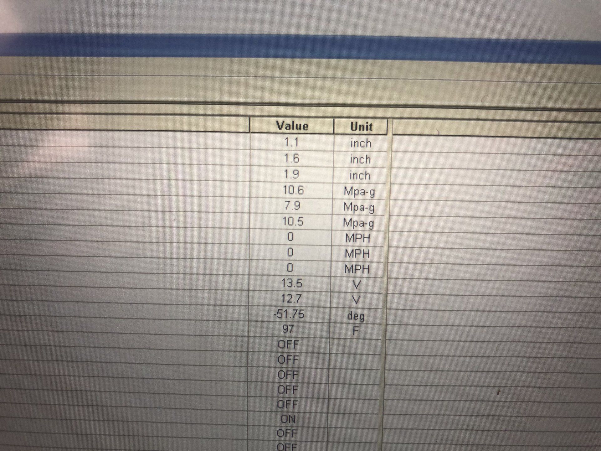

High position
Neutral height
Low height
Back to Neutral height
Are these pressures within normal limits?
That looks normal if you haven't adjusted your torsion bars yet. You might need a rear spacer to help if your springs are sagging.
My vehicle would lift rear then front before the globe/accumulator swap, but still functioned pretty quickly from L to H. Now it lifts evenly.
So a normal functioning AHC drops and lifts the vehicle front/rear evenly?
No, not to my experience. Lifting is random, in all variations. Lowering is more even.
