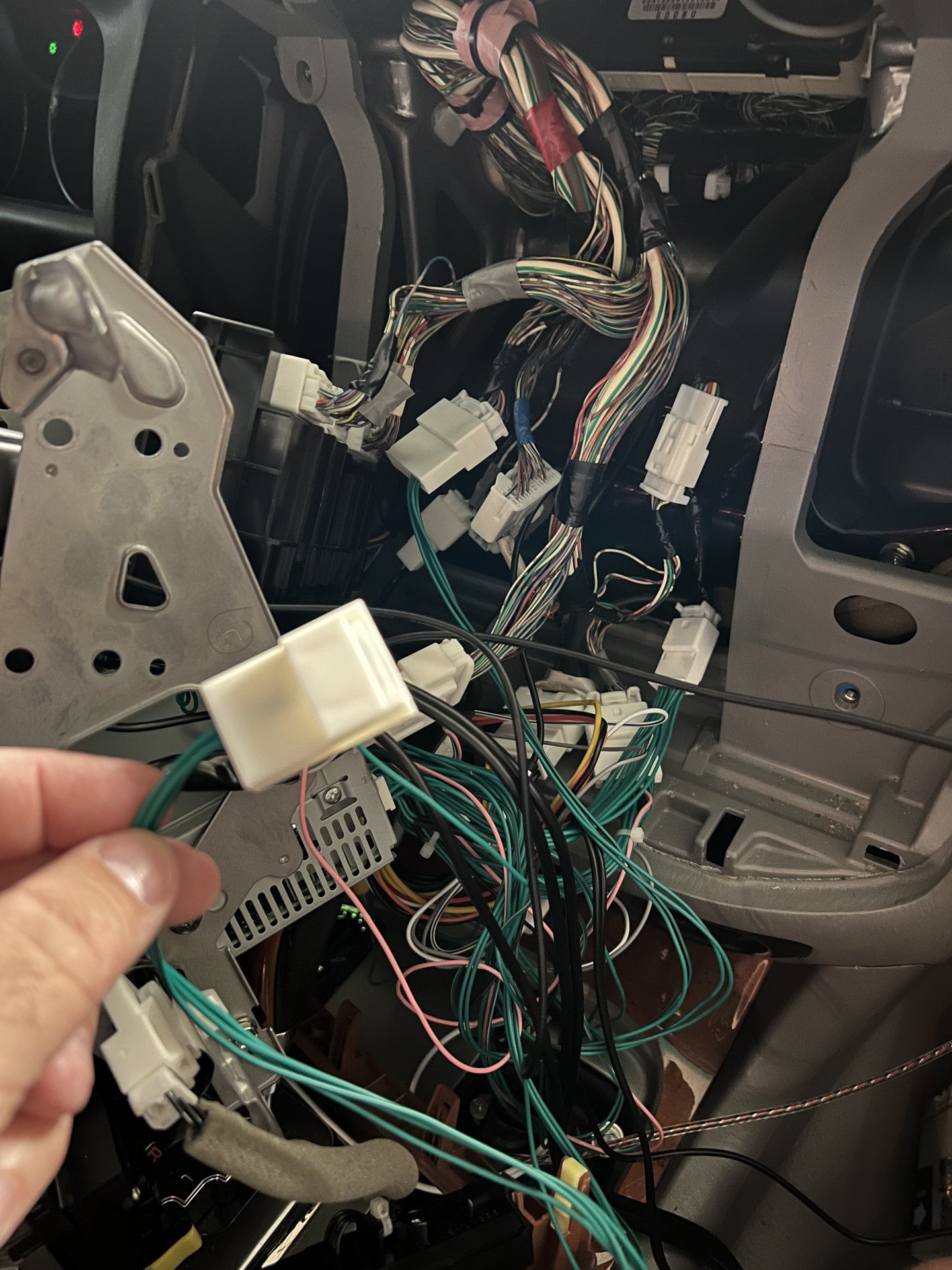

For those that have installed this, I'm curious what extra plugs you had. There were two that I couldn't find a home for and this one from the harness is the one that concerns me.
That was missing on mine also. Nothing works. lol

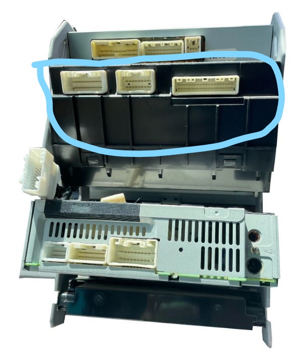

@DMCTX would you please post a few pictures of the back of your OE nav system and what the boxes looked like? And you were April 2006 production date correct?
