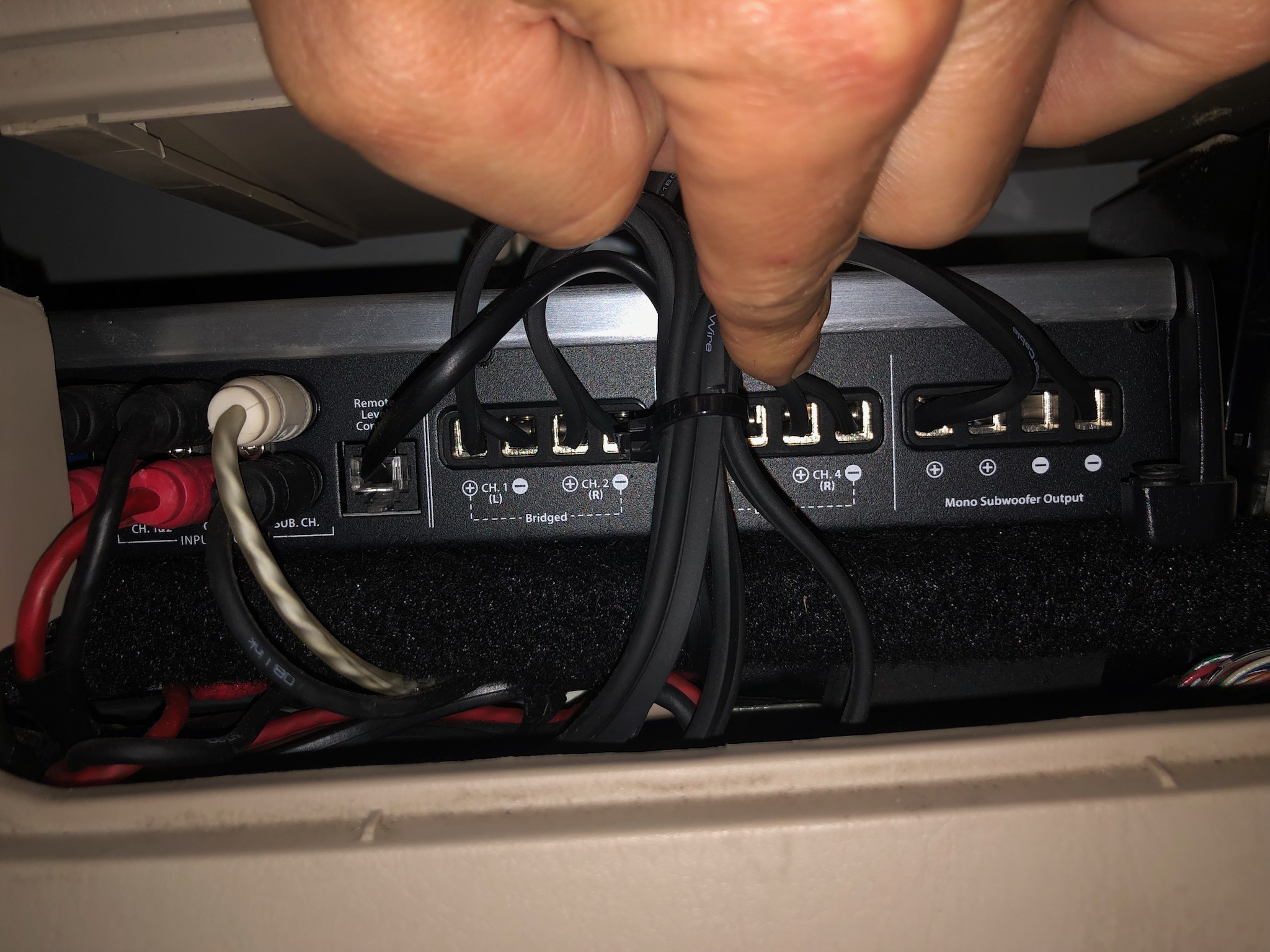

Probably best to just show you the invoice. Since the amp (Link to Crutchfield) is only a 5 channel, probably best to just leave as is until I want to get a new amp and run new wires?
Amp
Amp
That’s nice equipment you have. You have a very expensive set of 3 way components and a nice amp too. Yes, you can remove the ML amp and that LC8i line out converter, which was used to send the audio signal from the ML amp to the aftermarket amp. Then you can run 5 channels of rca signal from the t’eyes to the amp. You probably won’t gain much by doing this other than simplifying the system and removing failure points (ML amp and line out converter). If you want to step up the system, get a DSP amp to run the front midbass and rear speakers and then use the existing amp to power the front 2–3/4” midrange, tweeters, and subwoofer.

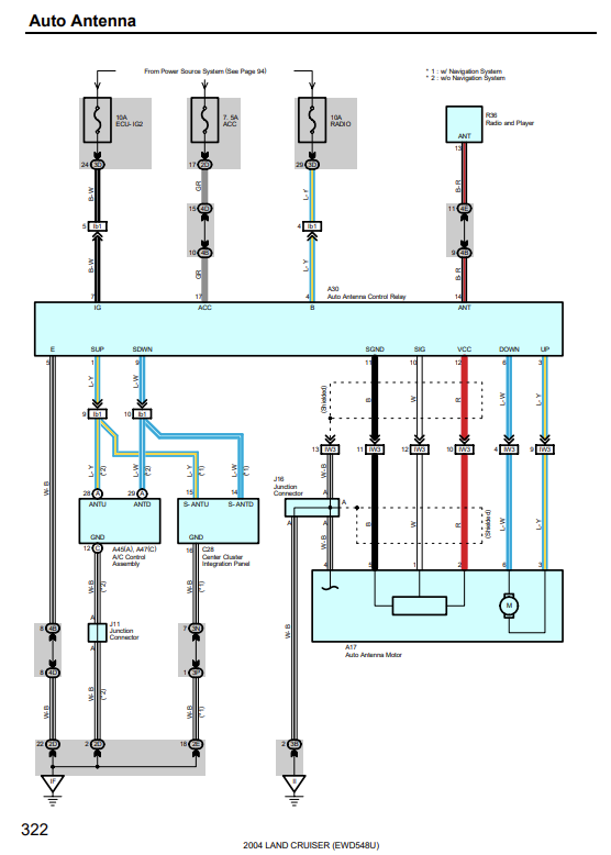

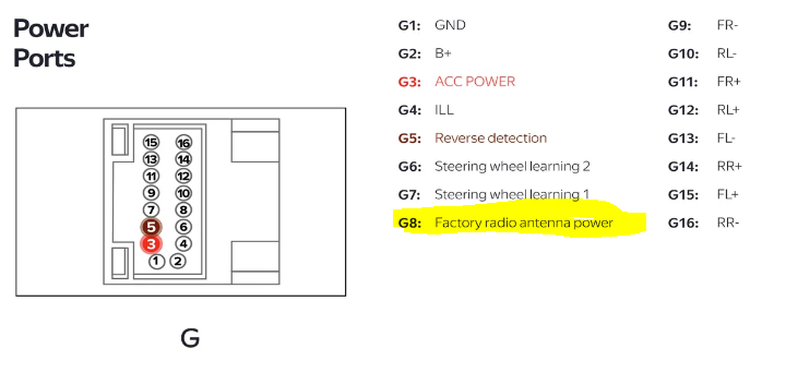

Has anyone gotten the power antenna to work correctly? I have installed a "Y" in order to connect both stock antenna wires to the Teyes. The radio reception is much better; however, the antenna does not raise and the button on the dash does not work. I noticed the Teyes unit has a blue antenna wire that is not connected to anything, it just hangs out of the back of a harness. I'm betting this needs to be connected to a wire somewhere, but I have no idea where. Can anyone help?
Here is the antenna wiring diagram:
And here is the Teyes diagram: note the blue wire I am speaking of is G8.
Maybe G8 to pin 14 on the Auto Antenna Control Relay? Maybe pin 12?
Blue wire might actually be an antenna in the wire harness for the Teyes - I'd double check.
