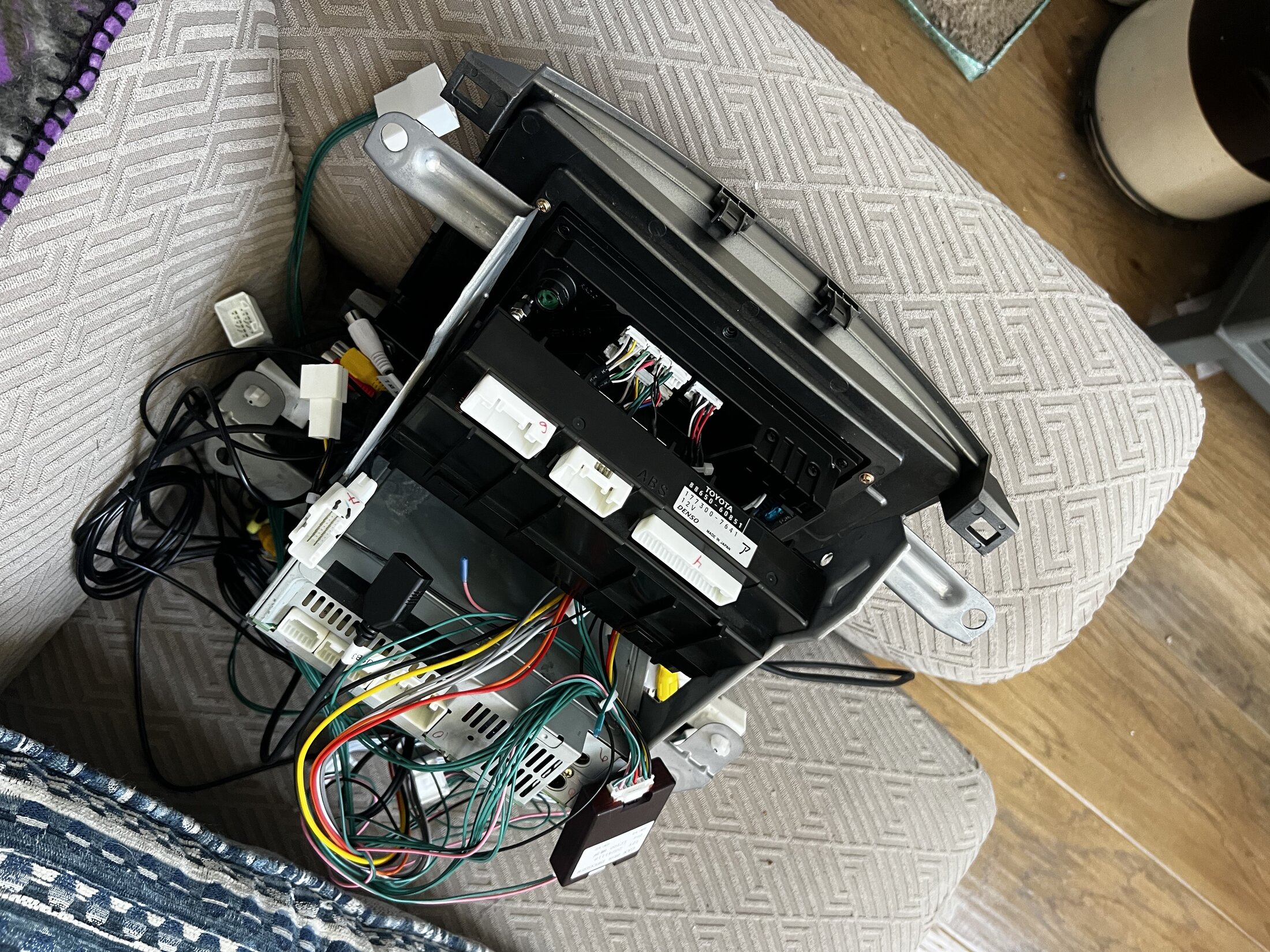

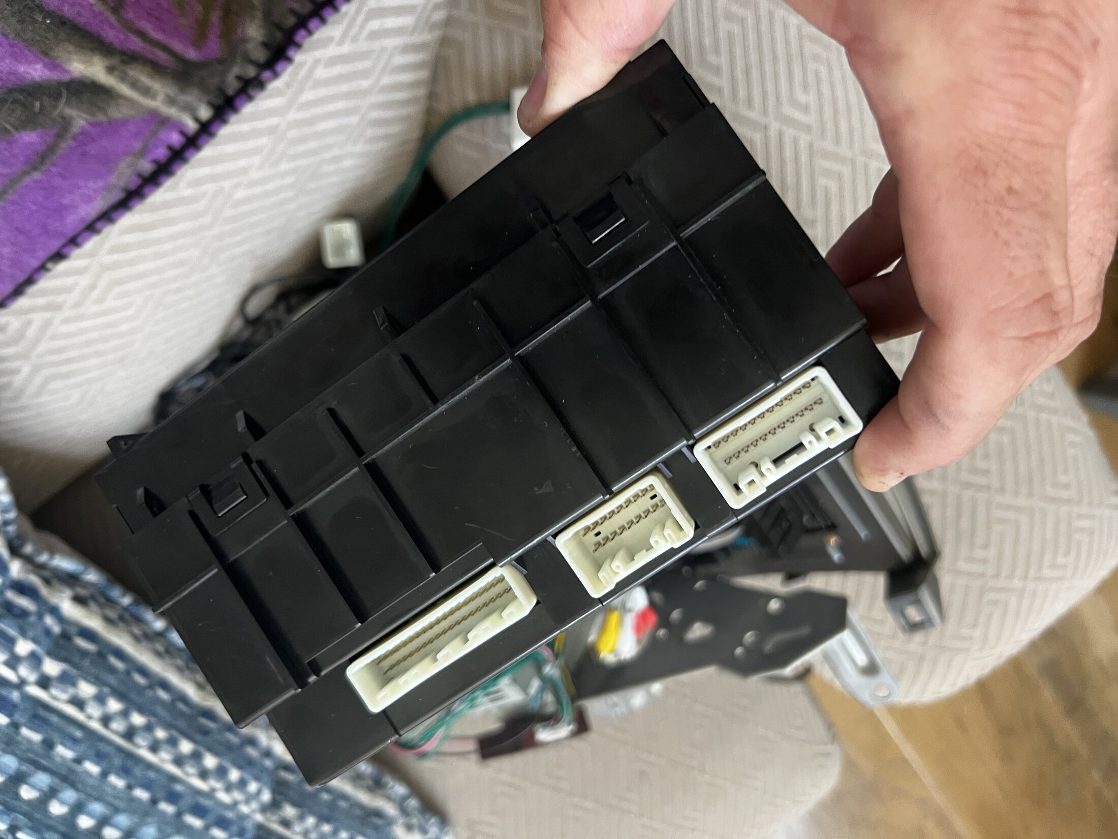

2004 LC with NAV
Its my turn now, Im Knee deep in this so I can confirm the functionality of most of the install, Some before me installed a funky blue tooth system into called a parrot, Im in the process of undoing all of that (including where they spliced this think into all the speakers just short of the amp, bit of a mess.
I have hung the whole assembly in and confined I have air conditioning functions and looks like most everything else, no sound yet but I have a lot of wire repairs to be done.
When I ordered the teyes c3 it noted I had to split the nav screen in order for it to work, I discovered that I needed the board that plugged into the original harness on the top (that is part of the original nav display)
I am not space challenged, so I have a couple of questions
do I need the black stand alone a/c amplifier that is with the nav screen and tape deck
AC would not function or come up without the original nav screen attached I was able to program and use with that attached and I broke the screen down to the single card and found that with everything plugged in, the card for screen control and the amp everything worked, and worked well
if I do need that does anyone have any images of how they included that black box as well and the remains of the original nav display
If I need all that its space challenged in there, any tips on how to mount/relocate it all
any help would be appreciated, all the 42 pages in here are been very very helpful but found no descriptions or images on which reinstilation
I have included a couple of pictures to see the wiring I have to put back to stock before I can even see if I have the audio hiss or now
^^This is how I have mine put back in - plug what fits back into that black box and shove it behind the Teyes screen.
