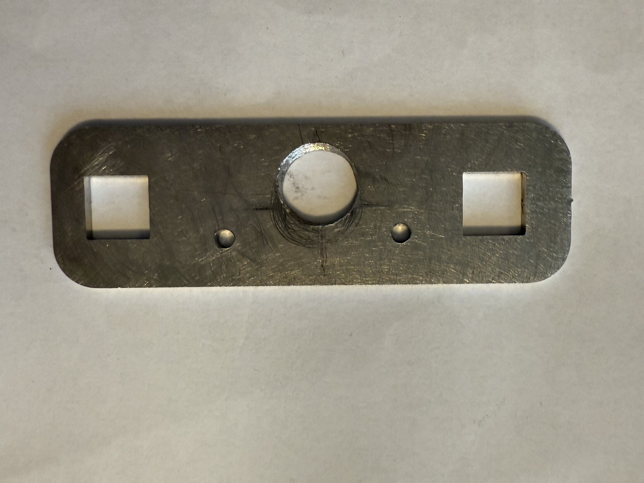

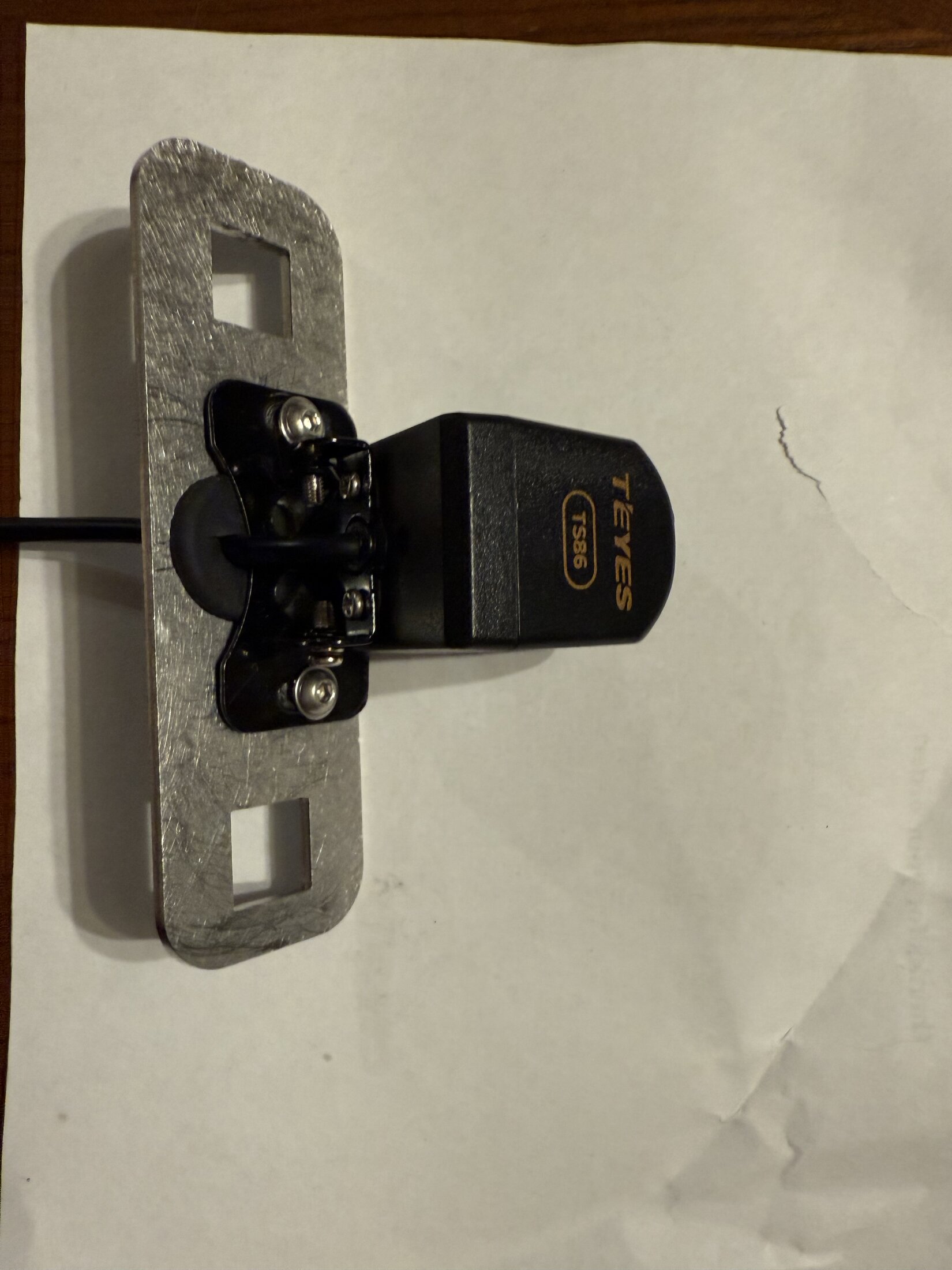

Working on my rearview camera setup. Wanted OEM+ fit and finish. I modified the block off plate from a Slee camera relocation kit to accept the Teyes camera.
Modified blanking plate:
With camera and gasket installed.
I used M3 hardware to mount the camera and used the supplied adhesive mount modified to fit around the gasket. 1/2in hole is required to allow the RCA connector and wiring to pass through.

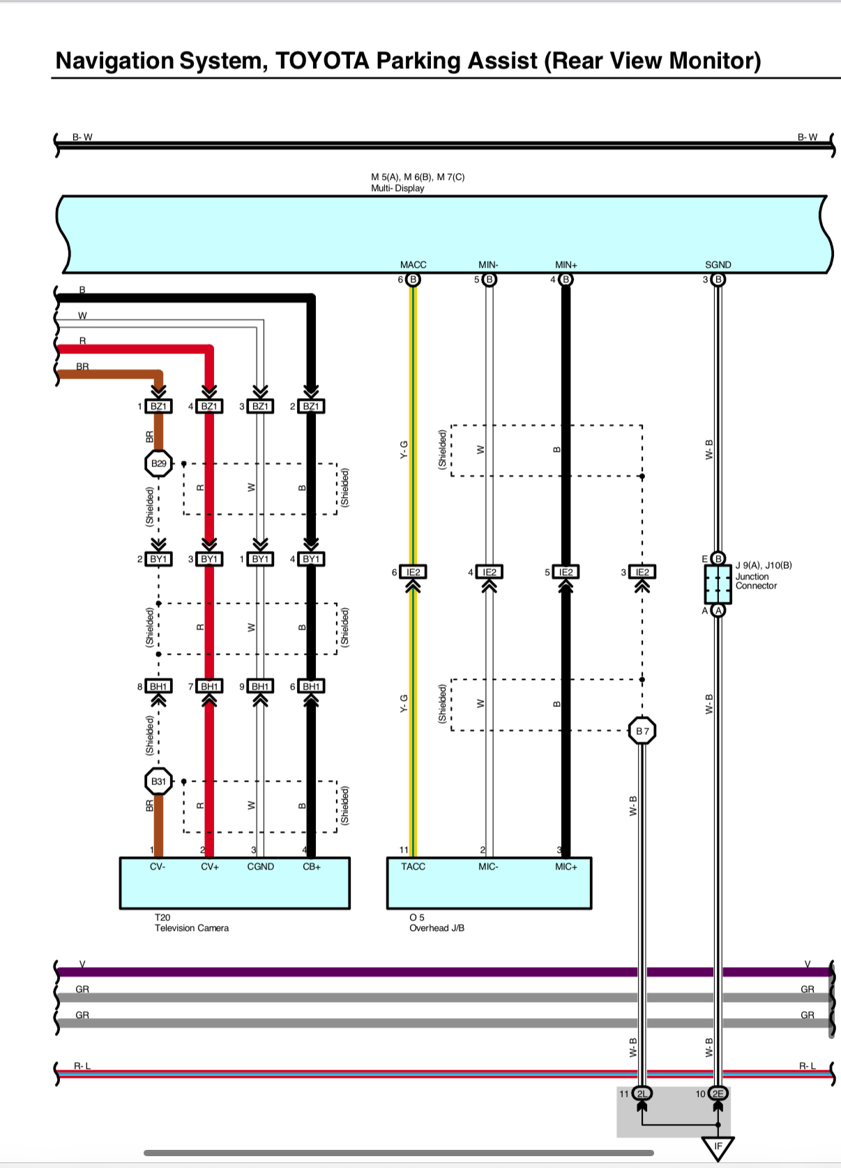

Does anyone know if the OEM camera wiring harness has provision for a reverse signal? I pulled the EWD - below.
I didn't have any luck finding a reverse signal in the upper tailgate. I ended up tapping the blk/red wire found on top of the big bundle that runs through the tire jack cubby.
Yep, that’s the backup plan. Need to dig out my voltage tester to test the backup cam harness, but if I can’t find a signal there I’ll route to the rear quarter/tire jack.

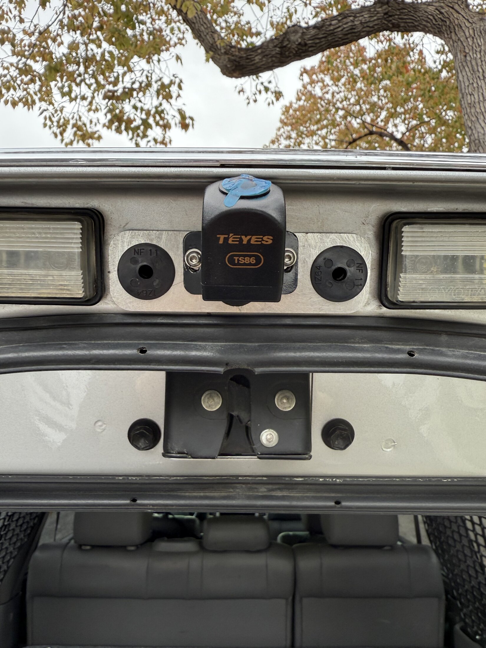

Camera installed.
A couple of small modifications had to be made for perfectly flush fitment to the hatch.
There are two small tabs that protrude into the opening for the camera. These will need to be removed or bent inwards.
I had to trim a sliver off of the rear inside of the gasket I installed in the Slee blank plate. It was just barely catching the lip of the mounting hole in the hatch.
Nice that came out great - love the OEM+ look. Looks factory. Way better than the double sided tape I used to slap mine underneath my old camera.
