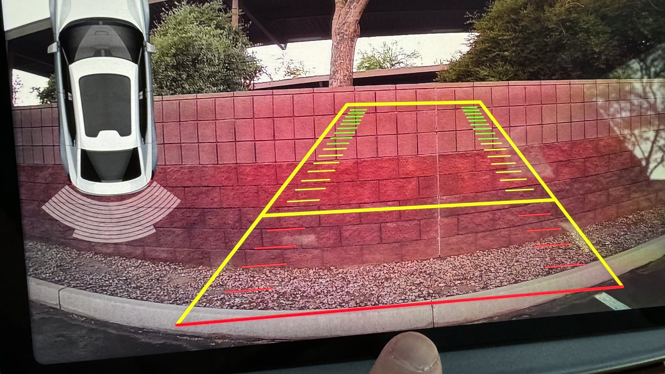

Hi, anyone else has this problem with not being able to adjust the reverse guide lines? I saw this video where after he taps the “Line Settings” button, there’s a little window with all the reverse line parameters he could adjust. But I don’t get that little window after I tap the “Line Settings” button?
This is the video: Adjust reverse guide lines

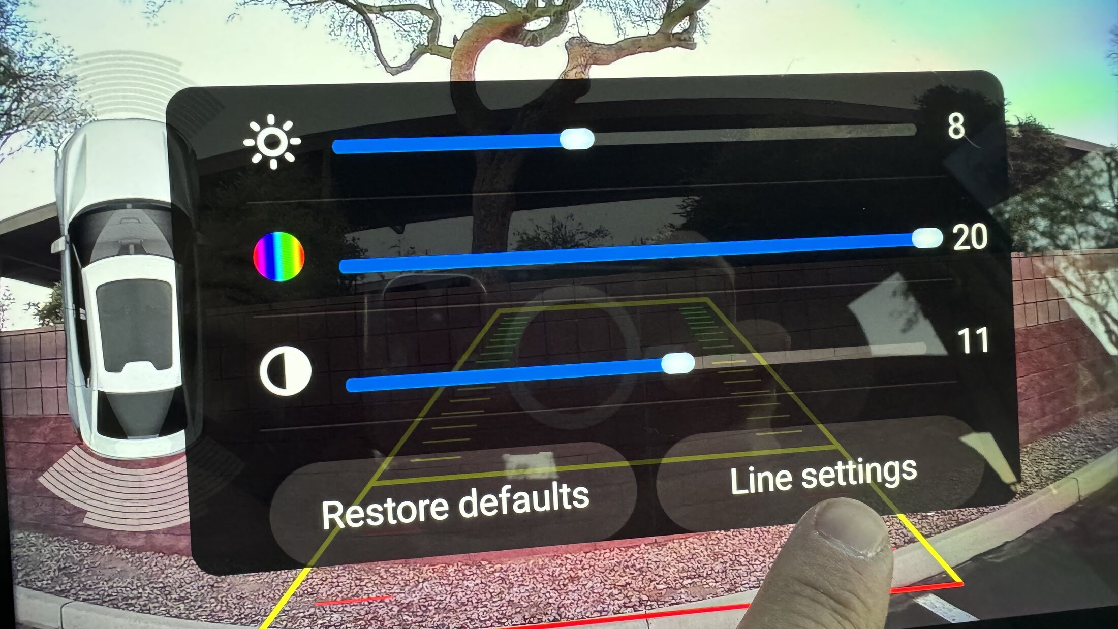

I have the Line Settings button:
But I get this when I tap the Line Settings button:
If I tap it again, it goes back to the previous screen with the Line Settings button.
Anyone has experiences with this? Thank you!

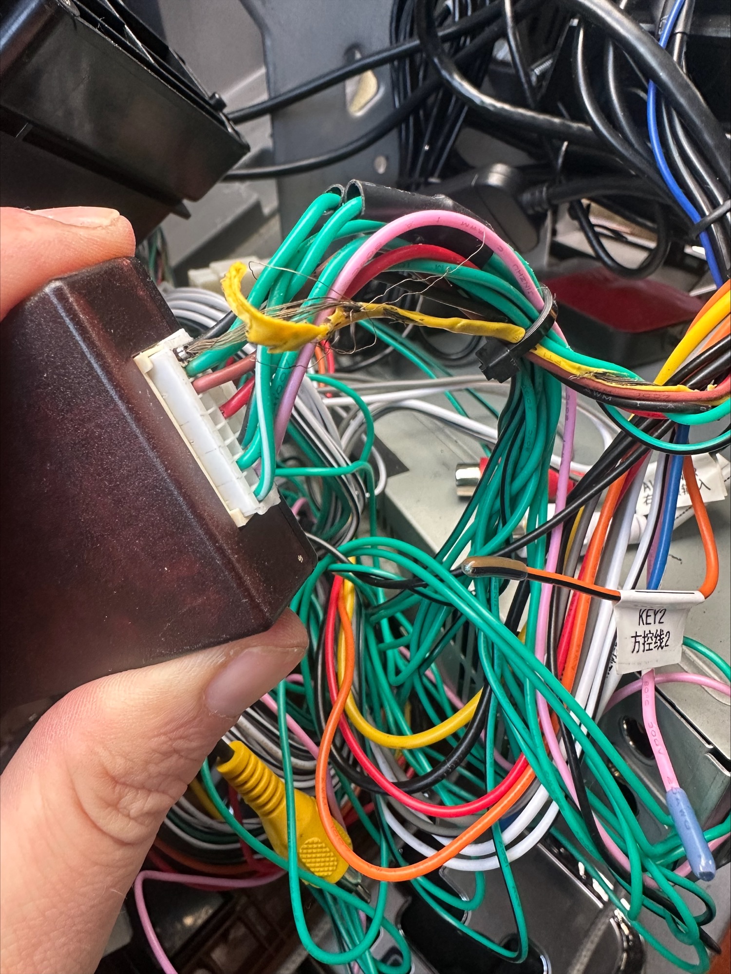

So my A/C controls recently quit working and I'm stuck on hot/defrost. Sucks having to roll down my windows to suck the hot air out occasionally.
I think my harness was bad, as I caught a frayed wire/pin during the install. (see pic) I remember when I taped it up during the install, the A/C started working. I've pinged Teyes to see if they will send a new wiring harness.
In potentially related news (no idea), my entire instrument cluster is not working. No fuel gauge, speedometer, RPM guage. Some of the lights turn on when I crank the car, but nothing else works. Anybody think this is related? It seemed to happen when the A/C controls quit working.
I would check your fuses if you had exposed wires it could cause a short.
