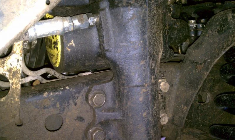

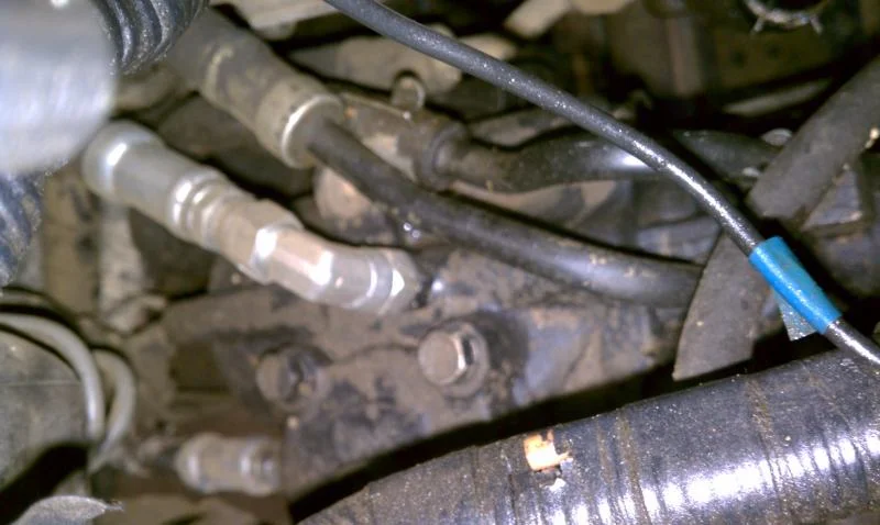

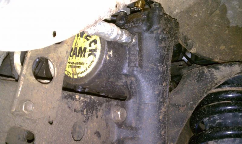

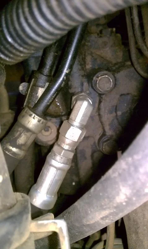

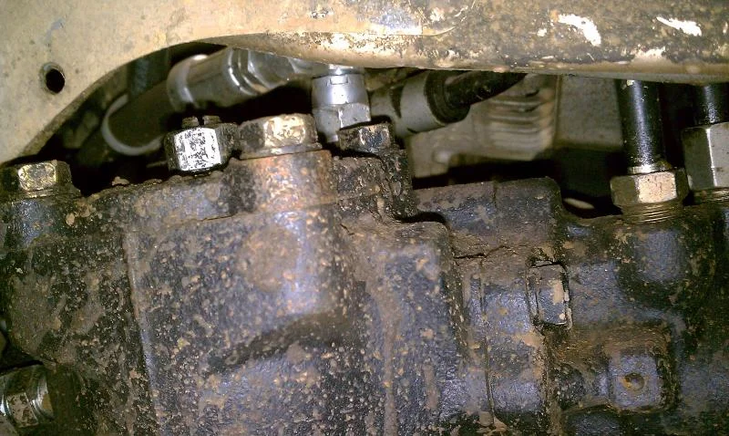

so im posting my experience so far. i had redneck ram (west texas offroawanted to post some pics and info about my hydro assist set up. there wasnt much info out there about how well the stock 80 steering system works with hydro assistd) rebuild my box with a new sector shaft and seals from toyota and then port and tap it for the assist..

here's a few pics of where the box is tapped.

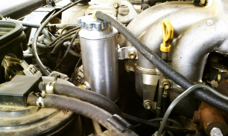

how much oil you put into ram assist system ? Are you replace the hydraulic reservoir tank with the bigger one ?

im not sure how much fluid i used after i put the ram and bigger res on. i think i put around 2 quarts in but its been a while and i could be wrong. i used the trail gear reservoir (just had to bend one of the tabs to make it fit) and drilled a hole in the cap to put a fitting in to vent the system. im also running 2 small coolers behind the grill.
